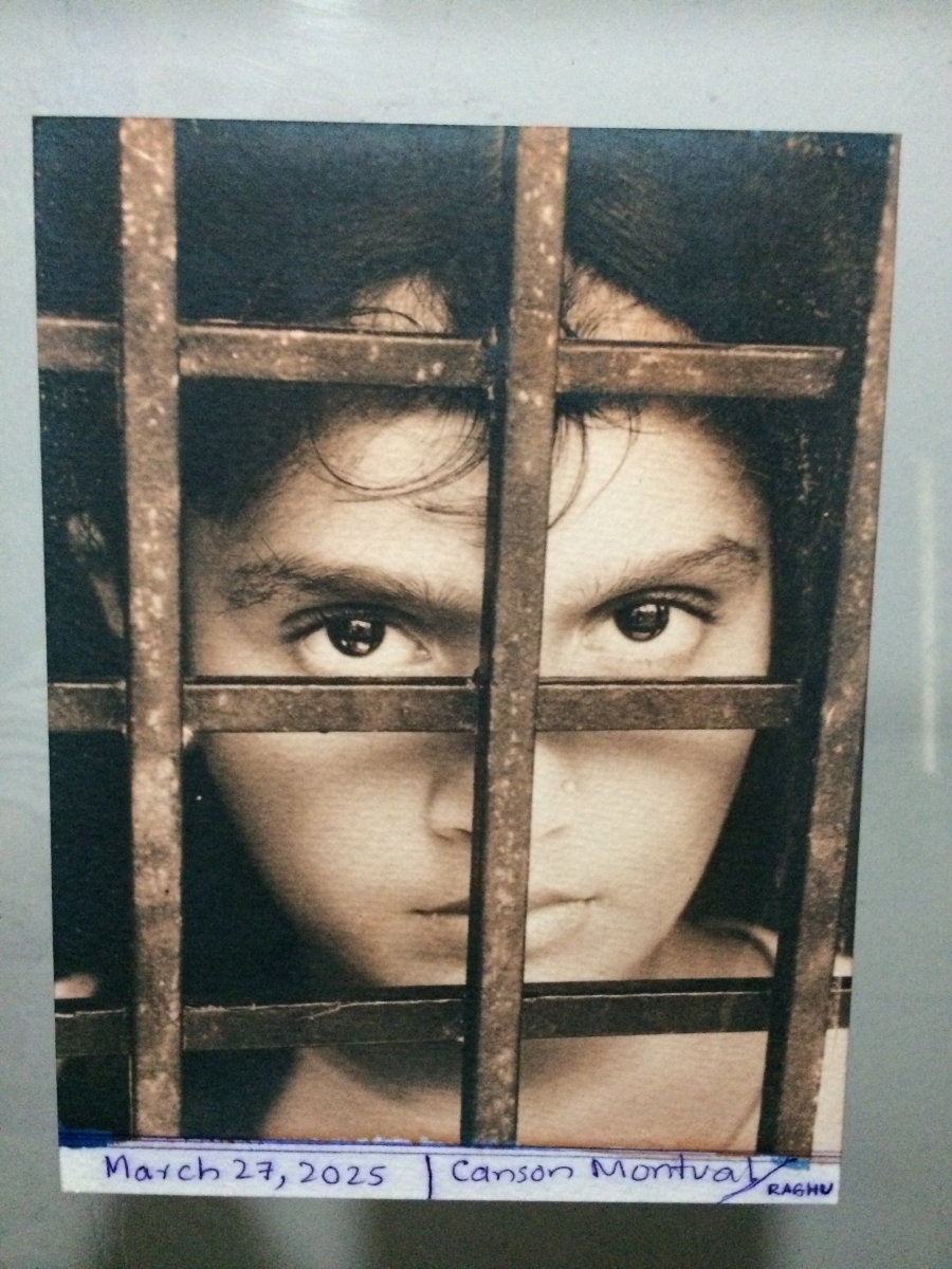

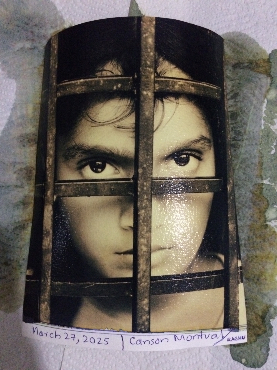

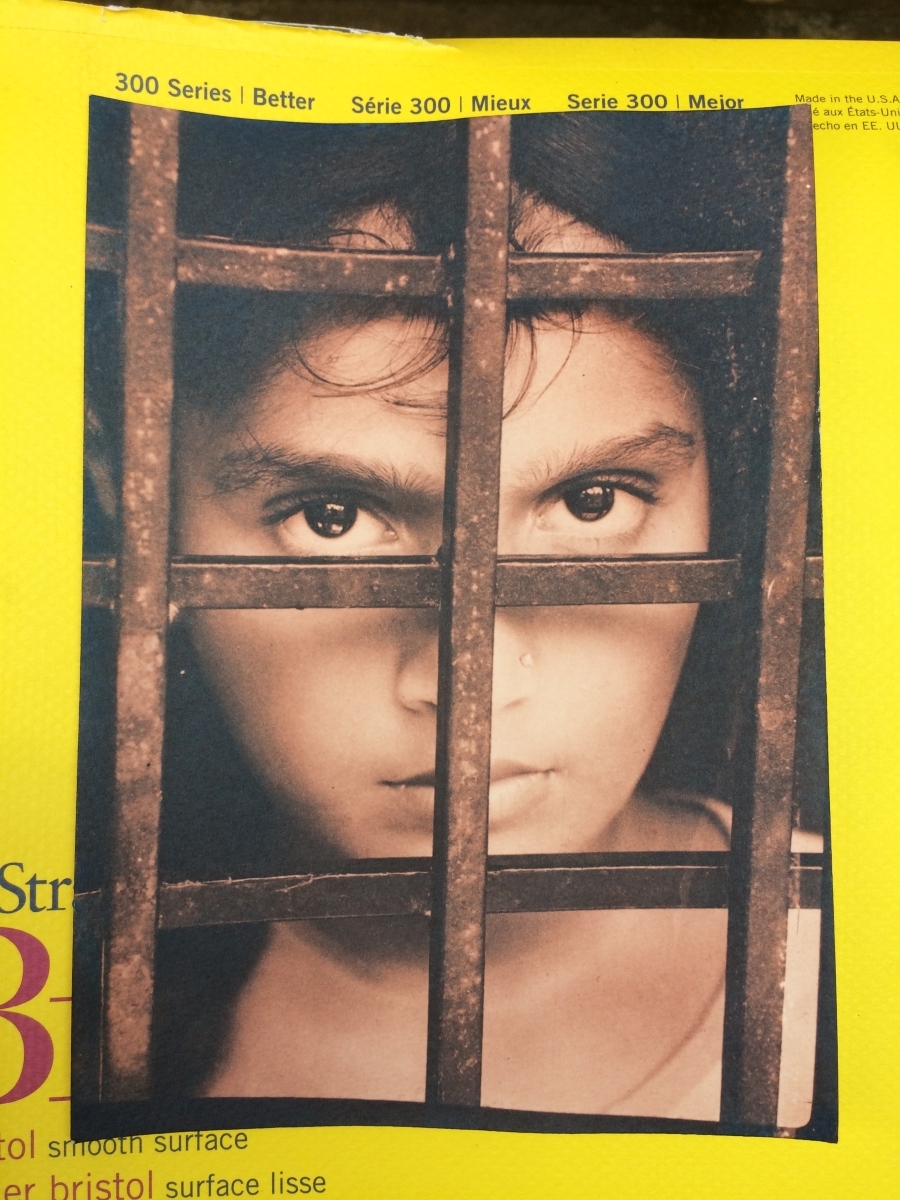

I have attached phone camera scans of two FerroBlend prints on two different papers. I used an inter-negative made on 8×10 Carestream X-ray film from an original 35mm Orwo UN54 B&W film slide. The inter-negative is kind of beaten with several blemishes on its surface.

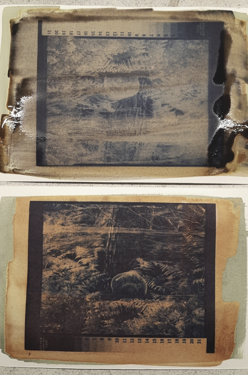

I've done some very quick tests as I don't have much time today. No joy as of yet. I think it's going to be kind of picky when it comes to papers.
Top print is test #1 without any ammonium chloride. Bottom is #2 with ca. 10% w/v ammonium chloride in the sensitizer. This cuts down rogue pigment formation dramatically, although not entirely.
Images above are after brushing on the developer; the top print had been sitting like that for 5 minutes or so at that point.
This is after 20 minutes or so (out of time, have to go), after a brief rinse in acidified tap water and another brief rinse in plain tap water:
Something's happening alright, although it's mostly red fog. I'll have to re-try later on with a more suitable paper, I think.
Sorry if the images don't show up properly; somethings off with the color profiling on my end and I didn't have time to solve it. In reality the colors are pretty saturated.

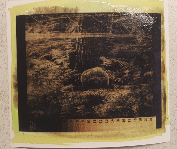

Edit: did some more tests just now; they're still developing, but they don't look like an improvement. Tried acid-soaking a sheet of paper, but this doesn't seem to make much of a difference. I also tried a different kind of paper that usually works better, but it gave similarly poor results in this test. I also tried coating a sheet of heavily gelatin-sized paper, but the result seems to be pretty much the same. The developer itself doesn't throw down any pigment if some ferricyanide is dropped into it, so it seems to be sequestering OK.
Edit 2: these are some more tests, but as indicated above, no real progress so far.
The second print from the left is somewhat promising; this is the one made on a heavily gelatin-sized paper. But that also doesn't really show much real conversion of the blues; more like a copper overlay. And there's a lot of fog going on still, although less than in the unsized prints.
Just did another one on paper soaked in 1% sulfamic acid, but that performed even worse than the paper I soaked in citric acid.
I think I'm going to call it a day with this and see what others come up with. I don't have any of the papers at hand that @Raghu Kuvempunagar has used for his tests, but given the wide range of papers he has used, I can't imagine that the papers I've tried so far wouldn't work at all. There's some aspect to the process that I'm not getting right and that I can't get from the description so far, so maybe if others would want to give this a try and share their experiences, I can glean some hints from that. I have a feeling this process will turn out to be very, very finicky.

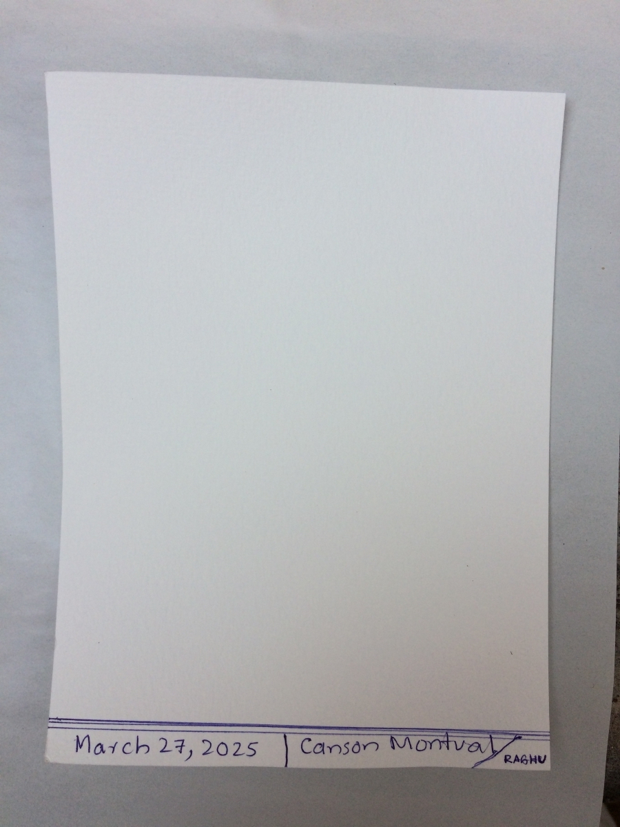

Hi @koraks,
My sincere gratitude for being one of the first persons outside of my milieu to try my process and share your experience. I share your disappointment that these first attempts didn't produce the good results we were hoping to get. But I hope you'll give it a try again sometime soon when the stars are properly aligned. Unfortunately I don't have access to Schut papers that you used in your tests. If you can send me a few sheets, I'll pay for the item and shipping, I promise I will do testing at my end and figure out what is going on.
Every process has its challenges despite best efforts to make it simple and repeatable. But I respectfully disagree with the following comment of yours:

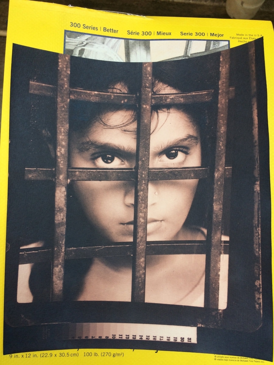

Immediately after reading the post on your latest round of testing, I followed the exact same instructions that I posted in OP and made a print:
1. Sheet of Canson Montval 300 gsm Watercolour Paper
I had given this sheet a pre-wash in dilute Sulfamic Acid solution to neutralise the buffer, removed the residual acid by giving the sheet a good wash and dried it some time ago.
2. After coating with the sensitizer
3. After 15 minutes exposure
4. Immediately after brushing the developer on the exposed sheet.
Note that there are no loose pigments.
5. Ten minutes after brushing the developer.
6. After the final wash and wiping with blotting paper.
Hope others following this thread will find this step-by-step pic sequence encouraging and helpful.
And please do let Cor know about this process. Thanks in advance.
-- Raghu
This already looks very different from my post-exposure sheets, which look much more like typical cyanotypes after exposure: more pale hues, more cyan. Yours look more saturated, the solarized/bronzed shadows are darker and the hue is more magenta.
The resulting prints I've made so far on critical examination show no signs of any conversion/capture of copper into a ferro/ferri-based compound. They really just show a copper nanoparticle fog overlayed on top of a cyanotype print. I've a feeling I'm missing something very crucial, but re-reading your process steps I can't seem to put my finger on it.
If you PM me your address, I'll get some sheets of paper in the mail so you can play with them; don't worry about payment, I expect none.
I hope to be doing more tests later! In the meantime thanks once more for your diligence in documenting this process and communicating about it; this speeds things up considerably!

Thanks Niranjan for the links.
I'm familiar with this process and I've made some Cuprotypes following Cor's instructions. I think in this process, UV light reduces Ferricyanide to Ferrocyanide which then forms CF with Cu2+. This is a completely printing-out process using a variant of (concentrated) Copper Toner as the sensitiser. Quite a simple process from the pov of practitioners compared to other Cuprotype processes. However, the coated paper starts fogging very quickly and needs to be exposed as soon as it is dry. There's noticeable stain too.
In my explorations, one of the processes I studied initially was a simple adaption of Cor's process. I added a little FAC to the sensitizer and developed the print in dilute Sulfamic acid after the exposure. Depending on how long one develops, different shades of purple brown can be obtained. During exposure both CF and PW are formed to different degree based on the proportions. Development in Sulfamic acid converts PW to PB and the combination of CF and PB gives the print the hue I mentioned. I didn't explore further as I found the results of the process described in OP more compelling (to me). :smile:

This is on Schut Laurier, which is what I've used for cyanotypes, salt prints and Van Dyke, always with excellent results without pre-treatment:
Freshly sensitized; color doesn't shift upon drying.
After exposing; exposure is definitely on the marginal side, but for a test this should not matter much. Note that the unexposed area does not fog. Note also that the shadows are starting to solarize, but there's no shift towards magenta as shown in @Raghu Kuvempunagar's example. The above is how my cyanotypes always look, so nothing odd so far AFAIK.
This is immediately after brushing on the developer. Rogue pigment formation starts almost immediately. I brush very quickly to cover the entire sheet and then stop, because from that point I'm just pushing mud about.
I've just done the same process on the same paper that I soaked in 1% sulfamic acid for ~5 minutes, then rinsed under the tap, dried and sensitized. The result is identical.
In this example I had added ammonium chloride to the sensitizer, but not to the developer. The pigment formation is a little less pronounced with ammonium chloride also added to the developer, but the prints don't really get any better when doing this.
Here's some (not all) of the tests I've done so far when dry:
They all show the same pattern: a classic cyanotype with some copper precipitate overlayed onto it, with the copper deposition being stronger in highlight areas; the copper fogging is under certain conditions (more ammonium chloride) suppressed somewhat in the shadow areas of the cyanotype. I see no other signs of actual interactions of the prussian blue image or a ferrocyanide print out image with the copper sulfate developer; there's no sign of an actual dark image being formed, only pink-over-cyanotype.
It's obvious I'm missing something very crucial here, since usually with processes like these, even on the failed attempts you see some hints of the basic mechanism taking place. I see none in this case.
