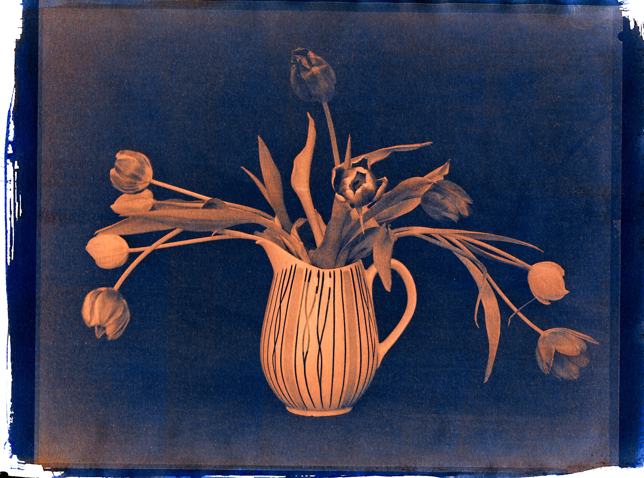

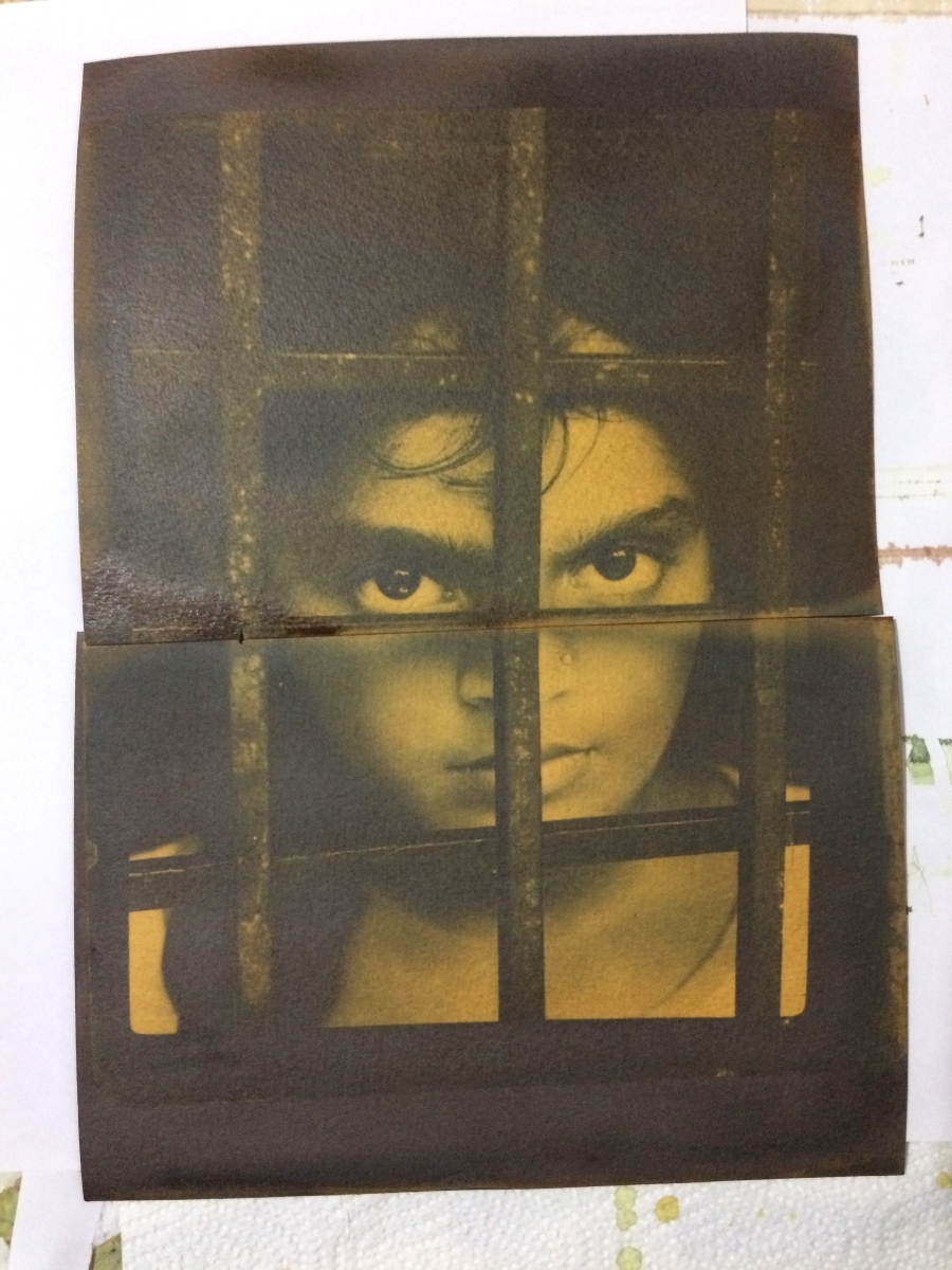

Have been printing this weekend, and would like to share my experiences. First; a big big thank to Raghu for opening up this new road !
  • I have been testing 2 papers I have: Simili Japon (https://www.vanbeekart.nl/papier-karton-tekenpapier-simili-japon/7987/)
  • Schut drawing paper (https://www.everycolor.nl/webshop/s...kenblok-a4-en-a3-180-gram-70-vel.html#consent)
  • Both papers stain when the developer is applied straight to the paper, this can be reduced (Simili) or get rid of (Schut) by using the developer 1+3 for 3 minutes
  • When the developer is applied on top of the Cyano there is considerable B+F, ie a stepwedge is not paper white in the higher steps
  • Adding 10% NaCl to the developer helps a lot on Schut (but not completly!) no difference on Simili.
  • The balance Cyano Cupro is heavy towards the Cupro side, ie only the deep shadows are dark blue.
  • Scanning these prints was not so straightforward, the highlights look brighter than they are, and is not easy to match the warm brown/orange tone.
  • In the stock solution of the AFC and ammonium chloride the ammonium chloride precipitated out as a rather nice fern shaped crystal,it was hard to get the ammonium chloride in solution I needed heating and stirring. Next time I leave it out since it did not do much on the papers I use (and also Koraks reported the same).

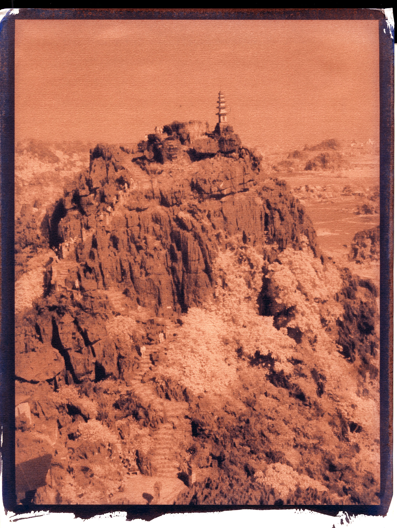

Below are 2 examples: the first is from a Pyro processed Fomapan 100 8*10 negative, although it is nice in his own way, subtilities are lost, and this image benefits from other printing options I think.(coating could be better, I used 2ml on this one). Print on Schut paper, no NaCL in developer.
Second image is from a digital IR file shot with an deep red filter printed on a big negative (thanks Korak)
Print on Schut paper, NaCL in developer. (12 min exposure)
Best,
Cor

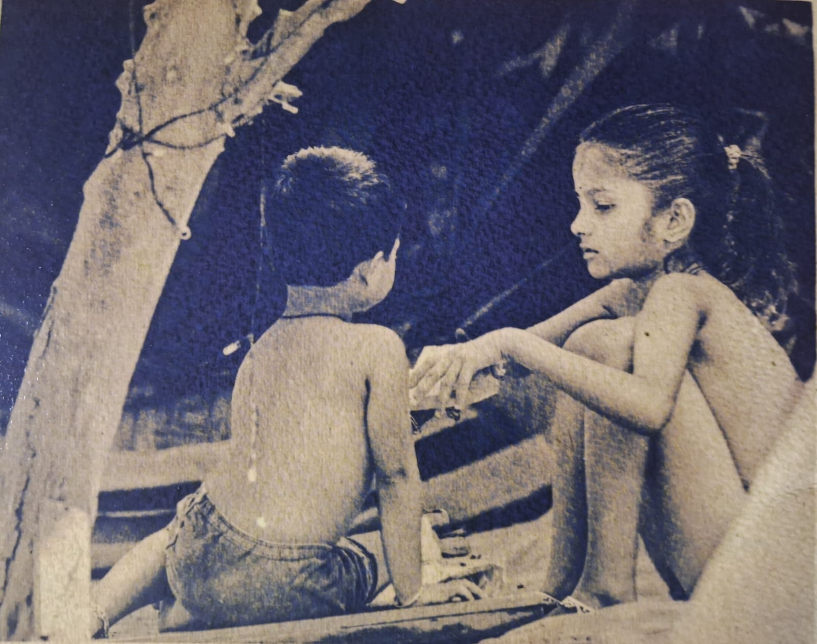

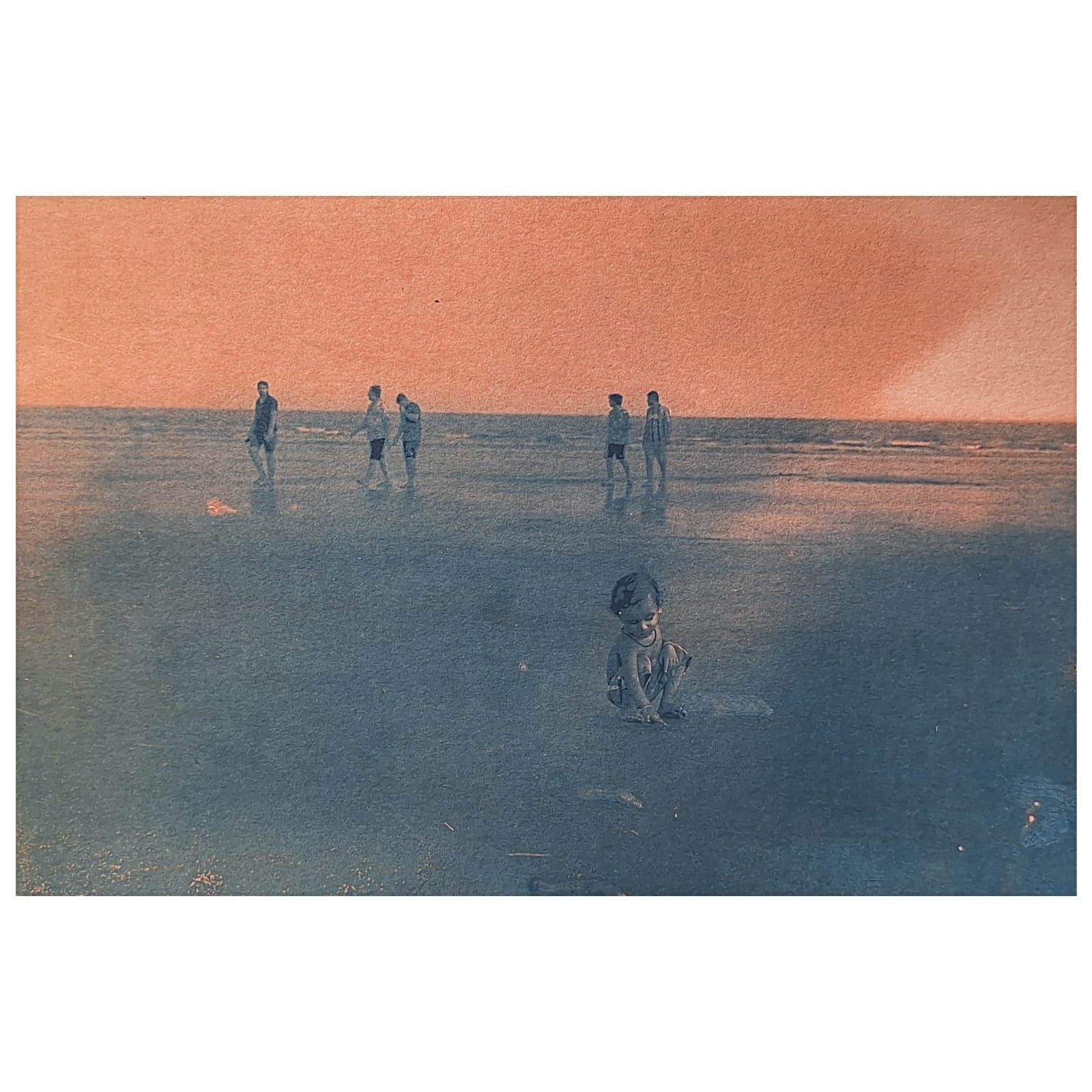

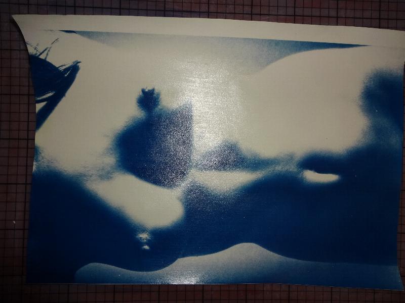

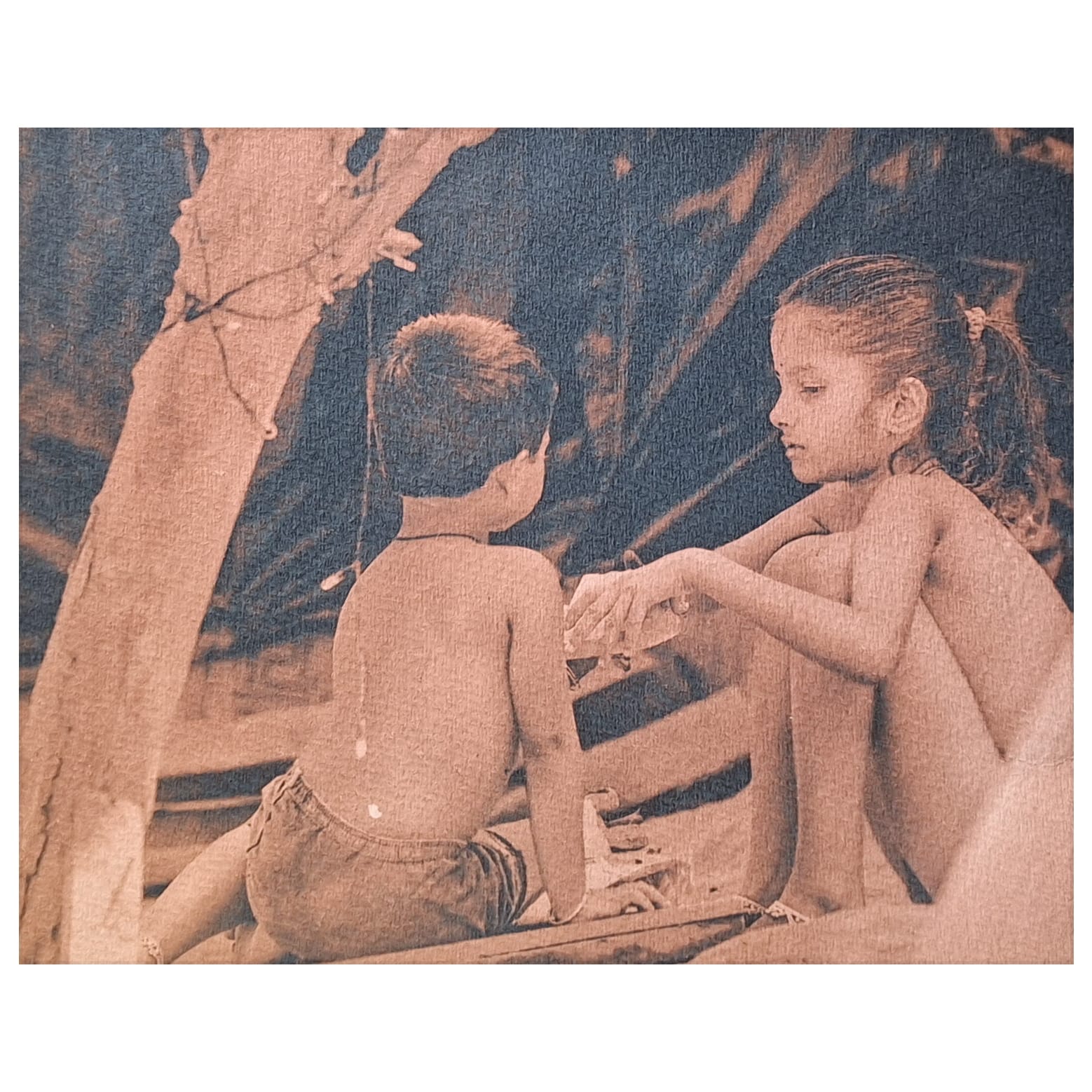

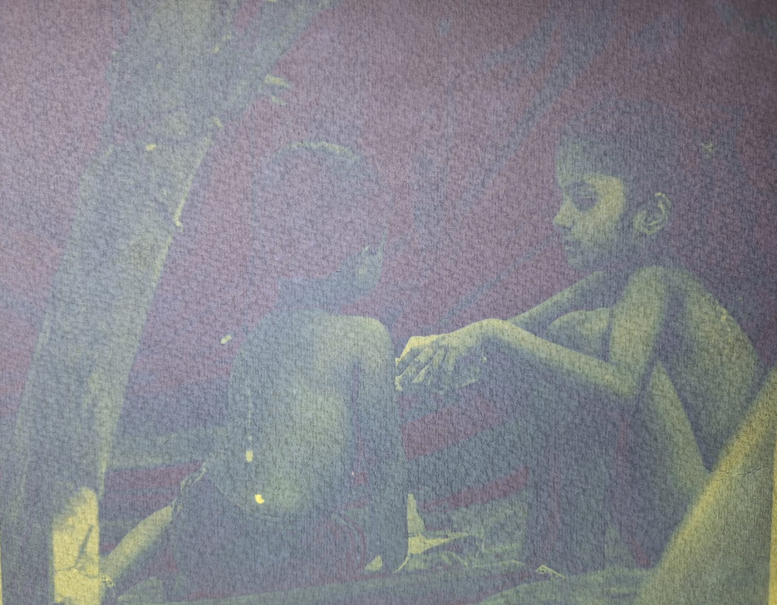

I got to know about the process from Raghavendra a couple of days back and ran some quick tests following the instructions in the OP. I see great possibilities and flexibility in the process. Paper used was Canson Montval -- I pre-soaked it in a Citric Acid bath to get rid of the alkaline buffers. Exposure used was ~60% more compared to Cyanotype exposure time for my setup.
1. The print after exposure
2. After brushing the sensitizer
3. After acid wash and water bath
4. After the print dried completely and in daylight

@Debanjan that's brilliant! What I find remarkable is that you seem to be getting the same tones/hues as @Raghu Kuvempunagar , in particular in the print-out image just after exposure as well as the print during development. Interestingly, the finished print looks closer to what I've been getting, although I feel my results are overall more magenta, while yours and Raghu's lean more towards yellow/orange. Maybe I should pick up some Montval to see if it's the paper that does this.
Debanjan
May 4, 2010
30
Kolkata, India
@koraks - yes, trying with Montval may help but I also got similar results with HPR .. no acid pre-wash was done since it is a buffer free paper.. the coating was not very good (some smudges here and there) but the outputs are similar.

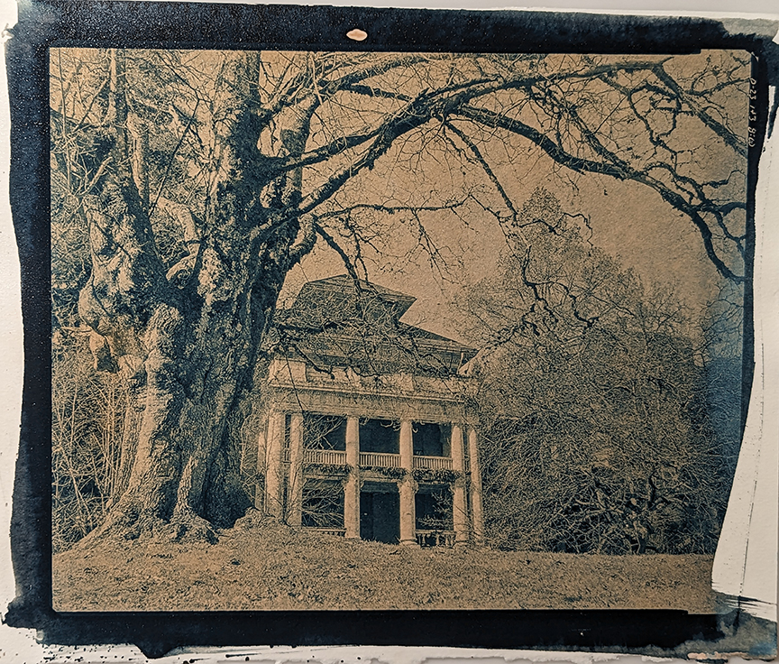

Andrew O'Neill
Jan 16, 2004
13,038
Coquitlam,BC Canada

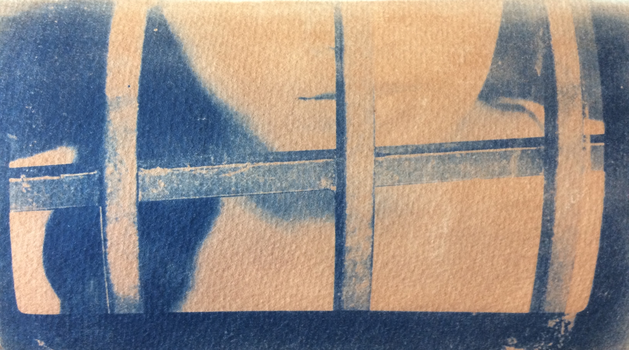

Chemicals arrived earlier than expect, so I was able to do a little bit of dabbling. I found out that I had to increase my Cyanotype exposure time by 30%, before I got something decent. Too much exposure and the Cyanotype blue dominated. To little, and it was the other way around and no detail. I also had to add Ammonium Chloride to Part A, as the Cyanotype was lifting off from the paper. I diluted the developer 1+5 (5ml + 25ml water), and brush it on using a foam brush. Letting the print sit for 30 min, or just rinsing it right away, showed zero difference in tone. I'm using Revere Platinum. It really didn't take me long to get to something kind of sort of decent... Anyways, here is the best one I could pull...
