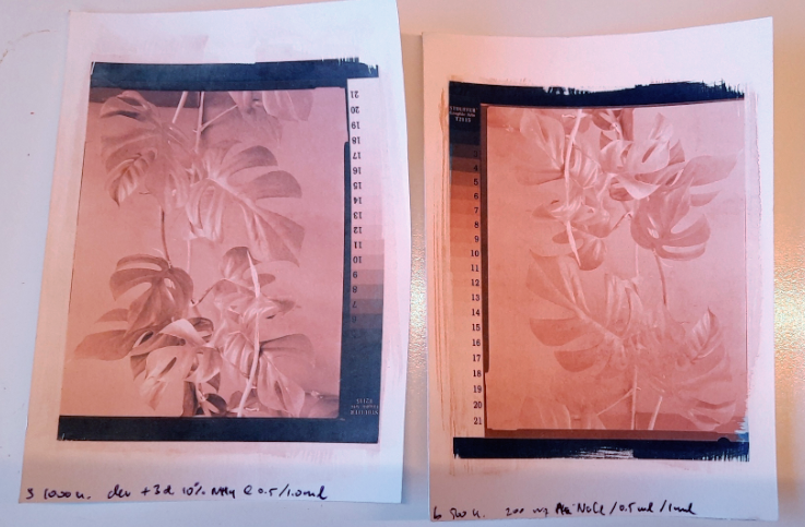

Played around with FerroBlend a little more yesterday to see what factors may help in reducing fog. Here's a test that contains an interesting clue:
(Ignore the density difference in the image itself; the left one received one stop more exposure than the right one.)
Note how in the right print, there's a streak of fairly dense fog along the left edge of the step wedge. On the right side of the image, there's likewise a band of fog that coincides with the edge of the area I brushed the developer onto. On the left print, these artefacts are also there, but much less reduced. There's still some copper fog, but it's more subtle.
The main difference in processing was that for the print on the right, I've added some sodium chloride to the developer. The print on the left had a small amount of ammonia added to the developer. I've also done a test with both the NaCl and NH3 added to the developer (effectively creating ammonium chloride in situ), which didn't give much improvement over just the sodium chloride.
Don't ask me to explain this, but for some reason, adding just a tiny bit of ammonia seemed to work best. It's still not down to pure paper white, though. But I used a buffered paper without any pre-treatment, so buffers in the paper likely play a role.
Mind you, this is just one quick test; more systematic testing would be needed to verify if this isn't a fluke and what the optimal concentrations are.

Development time was 2 minutes for both prints. This is actually still on the long side; I tried 30 seconds for the ammonia-developed print as well, which gave virtually identical results.
Very interesting result! Ammonia is also a chelator of Copper like Sodium Citrate and it could be that the combination is a more effective chelator than either. It is likely that stain is inhibited due to stronger chelation. If this is what is actually happening then a chelator that's stronger than Citrate but not as strong as NTA or EDTA could reduce the stain further.

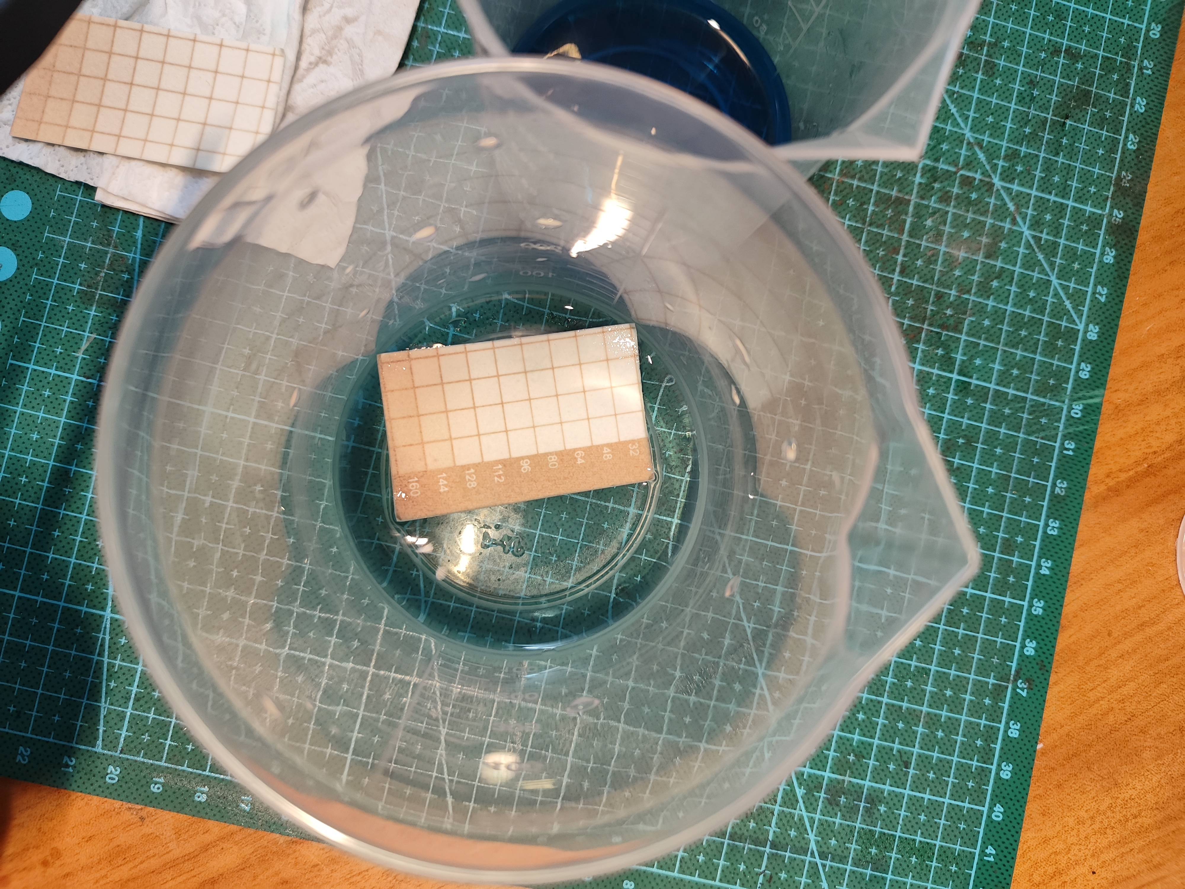

Since my native language is not English, this content was translated by DeepSeek.

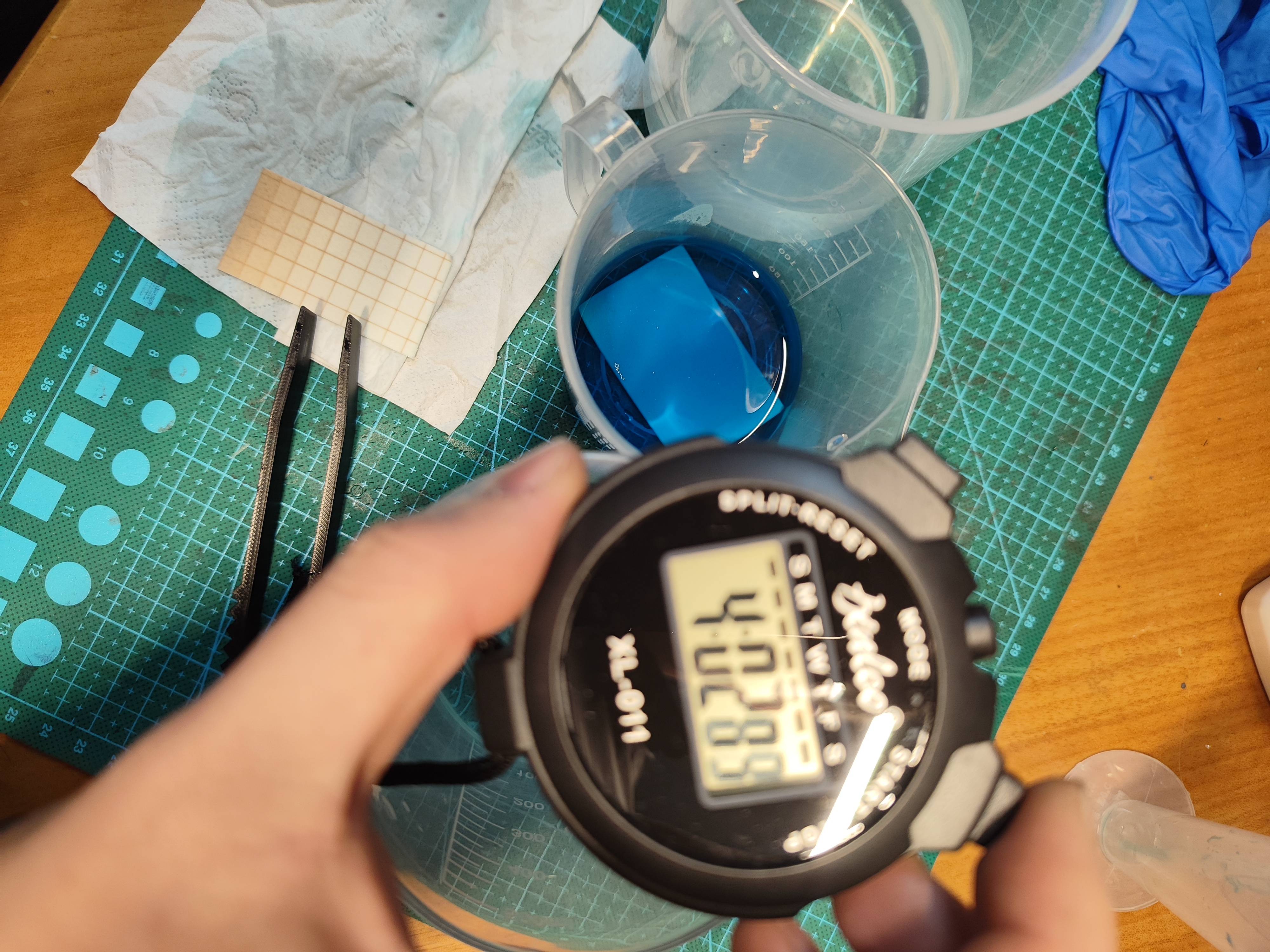

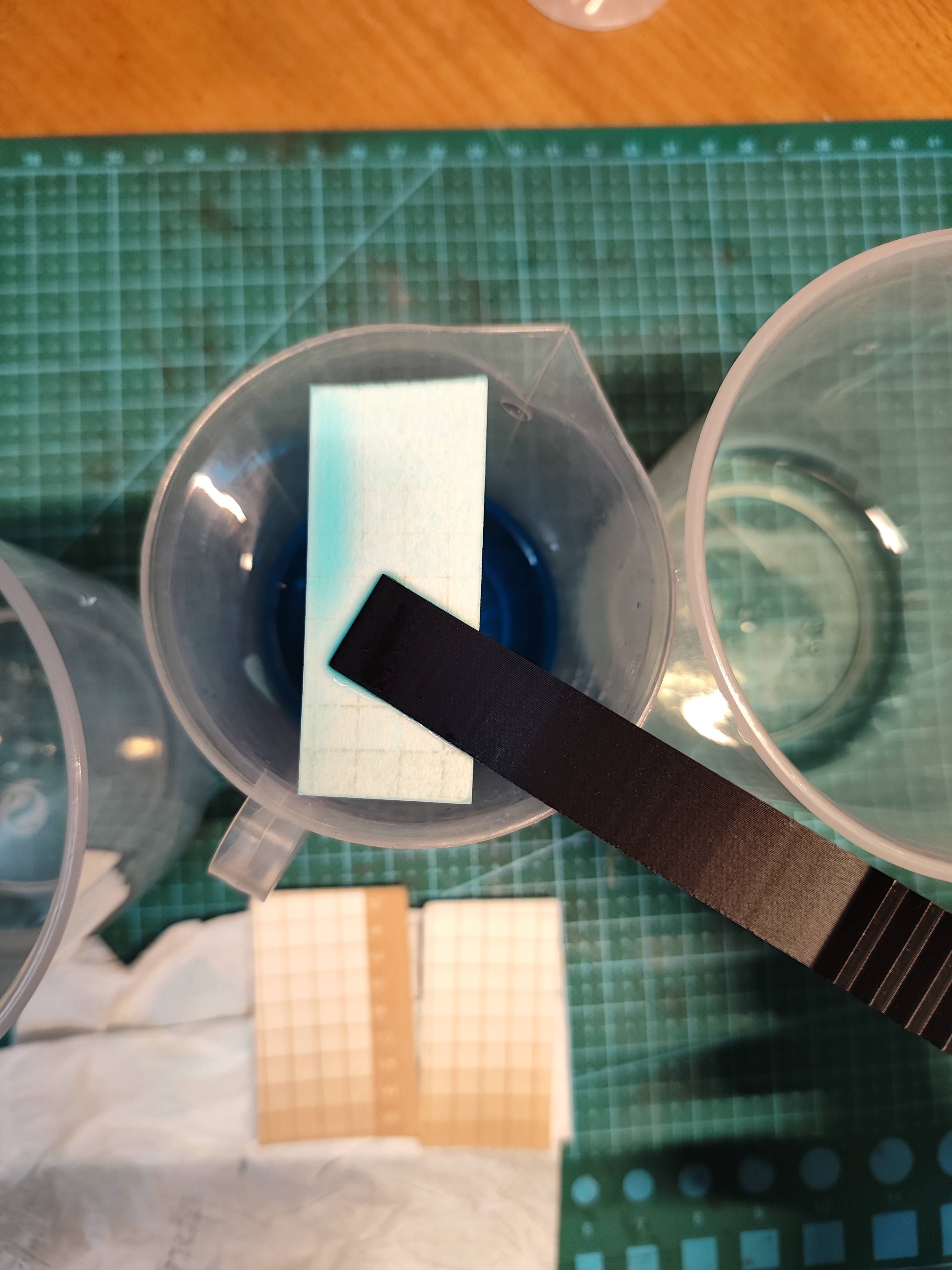

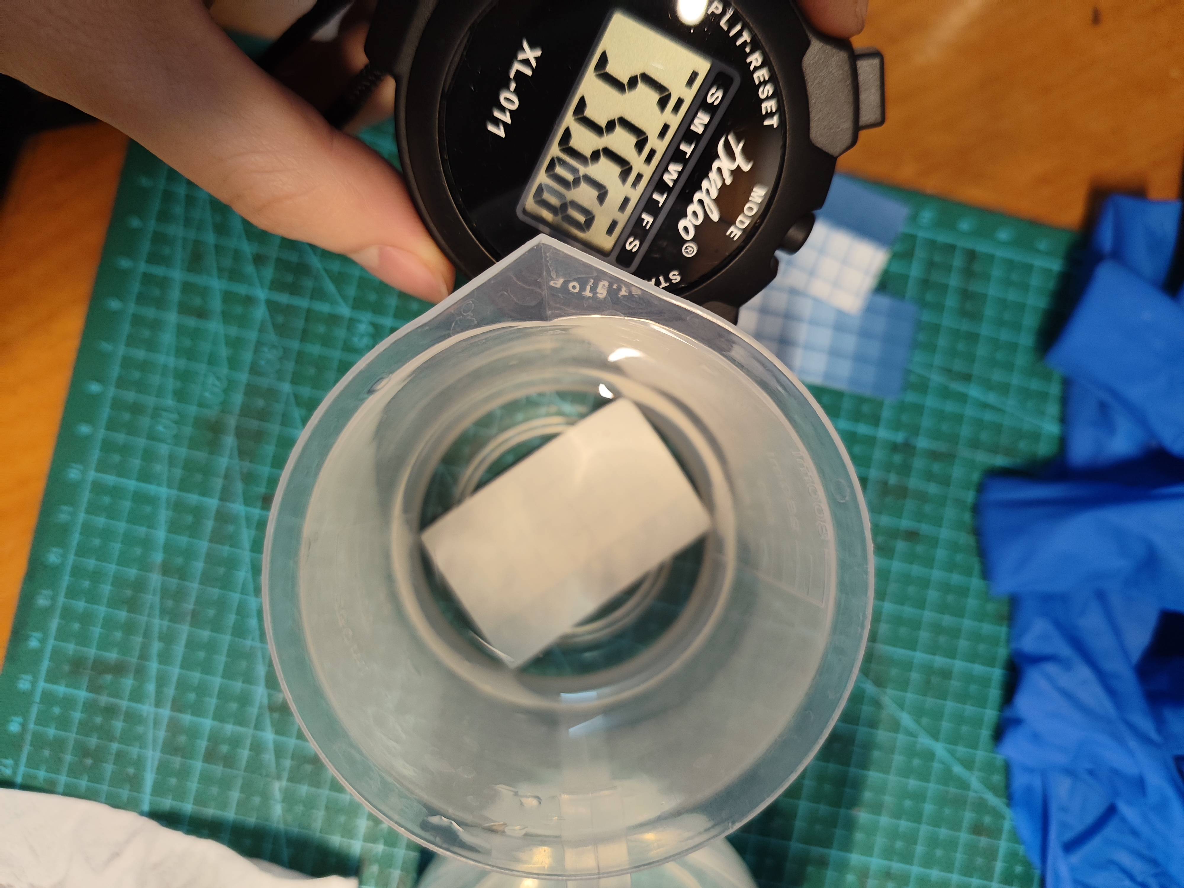

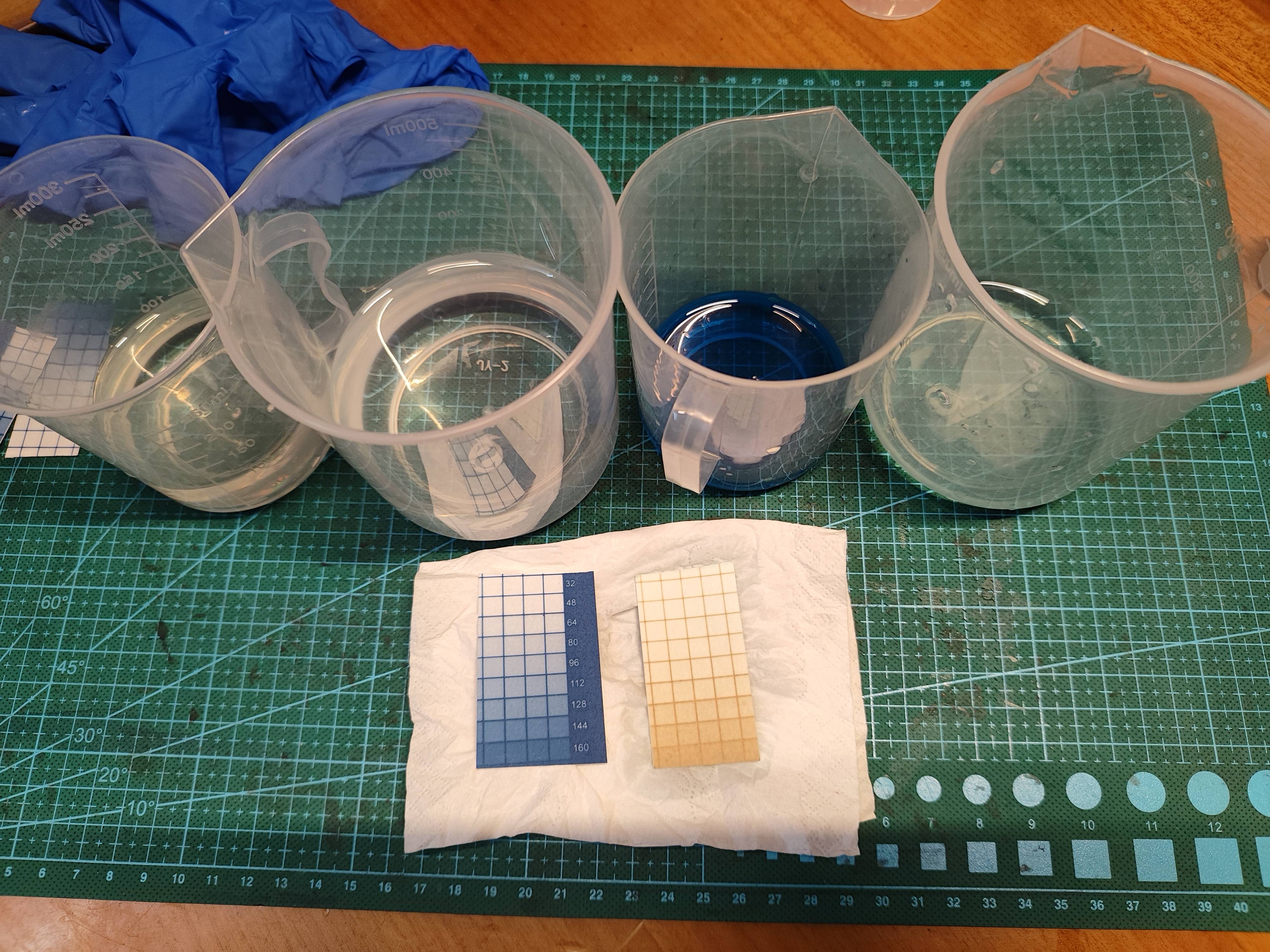

I believe the principle might involve a redox reaction between Prussian white and copper sulfate, forming a copper ferrocyanide precipitate. Therefore, I designed an experiment to tone a finished cyanotype using copper sulfate. After an afternoon of testing, I succeeded, but I don’t have much time to optimize the formula. I hope everyone can help test and refine it.
What you need:
  1. Bleaching solution: 6g potassium citrate + 6g ascorbic acid dissolved in 50mL distilled water. This solution can reduce Prussian blue to Prussian white.
  2. Toning solution: 15g potassium citrate + 5g copper sulfate dissolved in 50mL distilled water. This solution converts Prussian white into copper(I) ferrocyanide.
  3. Oxidation solution: Add some 3% hydrogen peroxide to water (amount can be adjusted freely). This oxidizes copper(I) ferrocyanide into red copper(II) ferrocyanide.
Experimental procedure:
  1. Soak the finished cyanotype in the bleaching solution for 5 minutes until the image turns completely white.
  2. Rinse the paper with water to remove residual bleaching solution.
  3. Soak the paper in the toning solution for 5 minutes (or longer if needed).
  4. After removing the paper, place it in the oxidation solution to develop the red color.
Experimental results are as follows:
The resulting image produced by this method does not exhibit any surface floating effects, and the details remain exceptionally sharp.
That's very interesting @xiaruan!! Thanks for doing this test and sharing your result.
I had previously done tests with steps 1-3 above but not oxidation with peroxide (step 4 above). Also in an earlier post, I have discussed some tests I did to validate the hypothetical redox reaction between Prussian White and Copper Sulphate. In those tests also I hadn't attempted oxidation with peroxide (your step #4). In my tests I didn't find an imagewise addition of Copper Ferrocyanide to the Cyanotype print. I should try doing those tests again with the final oxidation (your step #4) and see if it makes a difference. Do you rinse the print in water between steps #3 and #4 to remove excess Copper Sulphate?
I have a few additional comments:
1. The step tablet appears to have only yellow-brown tone without any hint of blue. Is this because all of Prussian White was converted to Copper Ferrocyanide?
2. Can you share the picture of the print after your step #3? i.e. before the final oxidation with peroxide. 3. The process in OP doesn't make use of an oxidising agent and yet the imagewise addition of Copper Ferrocyanide happens. So if the mechanism was indeed the same, I wonder why an oxidising agent isn't needed? Or could it be that the additional Ferricyanide in the sensitiser acts as the necessary oxidising agent?

在步骤 #3 和 #4 之间:

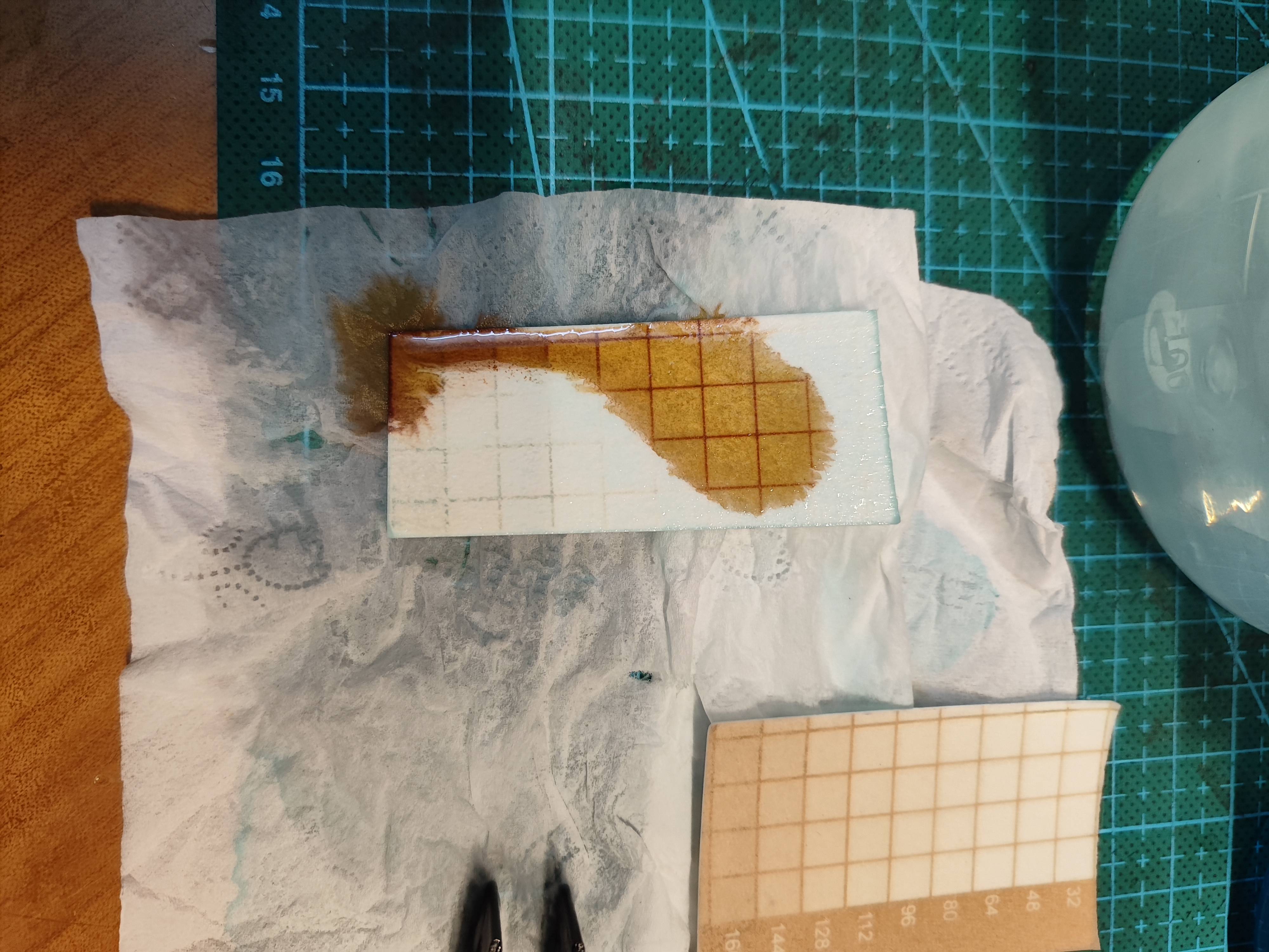

我尝试用铁氰化钾代替 #4(H₂O₂ 氧化液),发现它确实很快产生了红色图像。然而,它也导致了严重的、无法去除的染色,可能是因为我在涂抹铁氰化钾之前没有彻底洗掉硫酸铜
I believe that excess potassium ferricyanide may have acted as an oxidizer in the subsequent reaction. The process can be optimized as follows:
  1. Bleach the finished cyanotype in the bleaching solution.
  2. Rinse thoroughly and then immerse the bleached paper in the toning solution.
  3. After toning, wash the paper thoroughly to completely remove any residual copper sulfate (unless using hydrogen peroxide for oxidation, in which case this step may not be necessary).
  4. Finally, place the cleaned paper in the oxidizing agent (either hydrogen peroxide or potassium ferricyanide) to develop the image.
(Key Insight: This adjustment ensures better control over oxidation, preventing unwanted staining by eliminating excess copper sulfate before applying potassium ferricyanide. Hydrogen peroxide remains a gentler alternative for oxidation.)
