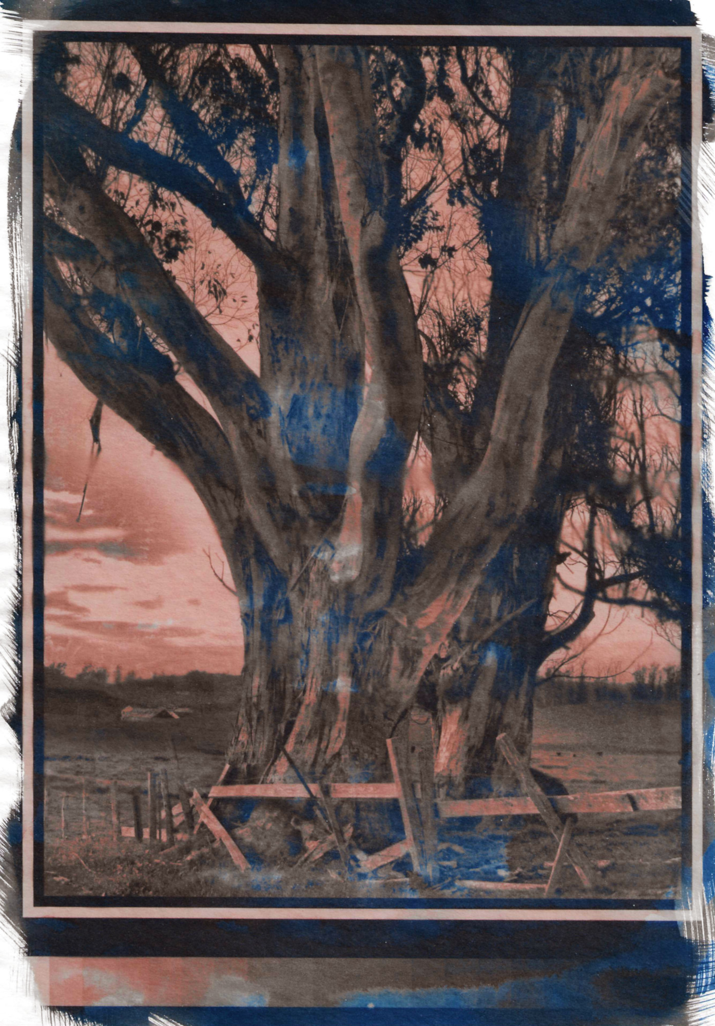

My wife is pissed at me for not focussing on trip stuff...but it was eating away at me, so.... I snuck down to the darkroom, and tried again, with Ferroblend chemistry...but this time I mixed up the 5ml one shot developer instead of using the 100ml stock. Seemed to work like a charm this time. I would like to make another one using the 100ml stock developer, just to see if perhaps this was the issue, but my wife would probably leave without me 😁
Anyway, here is the wet print... You can compare it to the fakeferroblend I previously uploaded.
I mean the copper image that makes up the highlights, specifically. There's very little gradation to that part of the tonal scale, at least going by the digital version. Maybe it looks different IRL? IDK, it just looks a lot like my early attempts in that regard.
I'm not really sure; in my case, I started trying different factors until the situation seemed to improve. I've documented what I did in those first few days here: https://tinker.koraks.nl/photography/fade-to-pink-a-brand-new-ferroblend-process/ There's a list of factors that I found or at least suspected to influence fog about 2/3 down the list. What makes this challenging is that the process is new, so there's just not a whole lot of experience to draw from, and we all have subtly different materials. For instance, variations in purity (qualitative and/or quantitative) of the FAC hasn't quite been ruled out at this point. Paper does indeed matter; that much is certain. BTW, I did some testing with acid-treated paper and for me, it didn't improve matters all that much. Some papers worked OK, some didn't work well at all.

Interesting... no excess pot ferri. I'm going to try soon... will start w/ OP recipe.
In OP I have mentioned that Classical Cyanotype sensitiser can be used in this process i.e. without excess Ferricyanide in the sensitiser (see Note #3). However, when Classical Cyanotype sensitiser is used, Ferricyanide must be added to the developer. I have mentioned the amount in OP. I am aware that use of Classical Cyanotype sensitiser could make life simpler for those who don't want to maintain different sensitisers. I didn't recommend this route as, it can, at times, produce brushing artifacts with some papers (mostly smooth papers). But please feel free to try.

I've been following this thread as a spectator, and I notice that the blue cyanotype part of the curve in some of the images posted here is much more contrasty than the orange cuprotype part of the curve, and that the contrast of each varies from person to person trying the process. "How does one control contrast in cyanotypes? and "How does one control contrast in cuprotypes?" might be interesting questions to help make this process easily reproducible. Perhaps the 'fog' some people are seeing is just a result of a low contrast copper portion of the image.
I think your test images should be printing a step wedge alongside the images you are using to test.
Printing the same image ( perhaps the OP would be willing to share a negative in digital form (that includes a step wedge and that he prints himself)) as a test that others can use as their first print to control and understand their process.
I don't see anyone doing it but I think digital linearisation would be a mistake at this stage ( you would do it at the end once you've done your best without it. )
Yes, you're certainly right about the questions. As to the low-contrast and/or foggy cuprotype: yes, that too, although in my own testing I make a point of masking the borders and indeed including a step wedge. It's just too difficult to figure out what's going on without such benchmarks. It makes problem-solving a lot quicker if you can see what you're doing.
Linearization: yeah, as always, that's only feasible on a well-controlled process.
