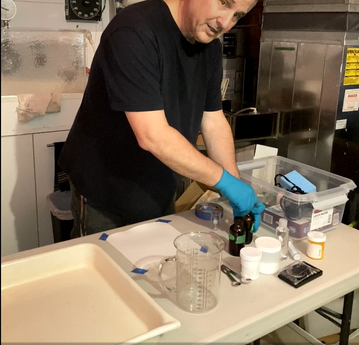

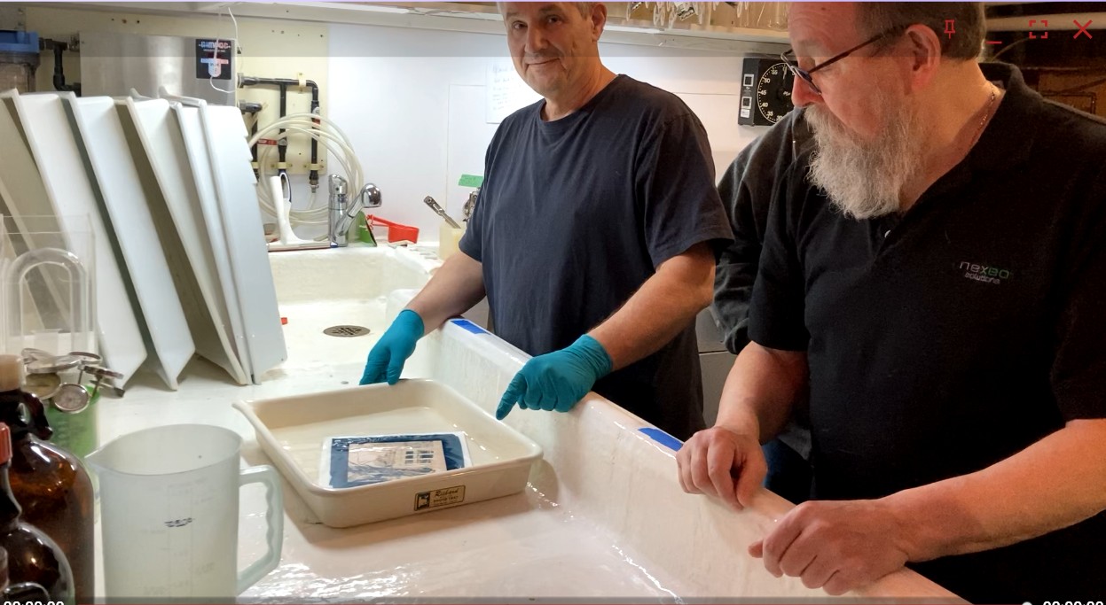

Today @Andrew O'Neill kindly provided our Darkroom Group with a demonstration of the Ferroblend process.
His first such demonstration since he began to attend more of the group meetings.
Thanks Andy - it was great to see it happen in real life!
And in case anyone needs proof, some photos of his demonstration, and most of the group watching!
