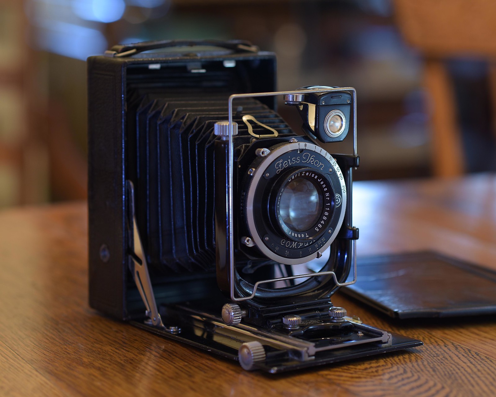

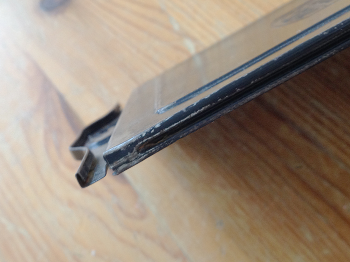

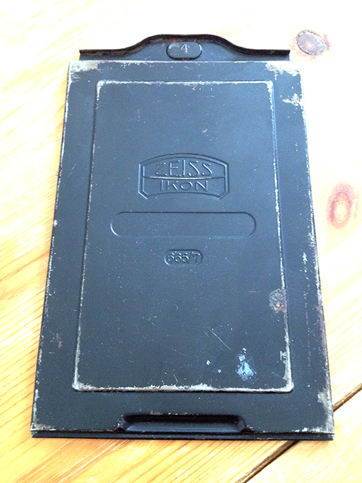

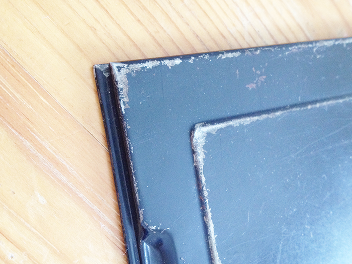

Zeiss Ikon 665/7 9x12 plate holder
works with Kodak Recomar 33

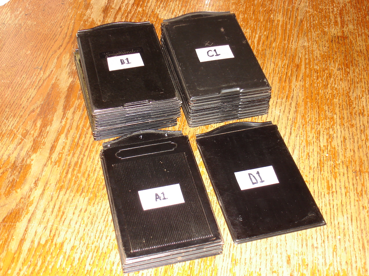

9x12cm "Normalfalz" Plate Holders
Here is my collection of 9x12cm "Normalfalz" Plate Holders.
I use these in my three Plaubel Makiflex cameras (see my avatar).
All of these holders have film sheaths inside them.
I have acquired alot of 9x12cm film over the past several years.
Top left: twelve Voigtlander holders.
Top right: ten holders from the Ukraine.
Lower Left: four RADA "Normalfalz" holders.
Lower right: unmarked 9x12 "Normalfalz" holder.
All of these holders fit in a Plaubel Makiflex 9x12cm film back.

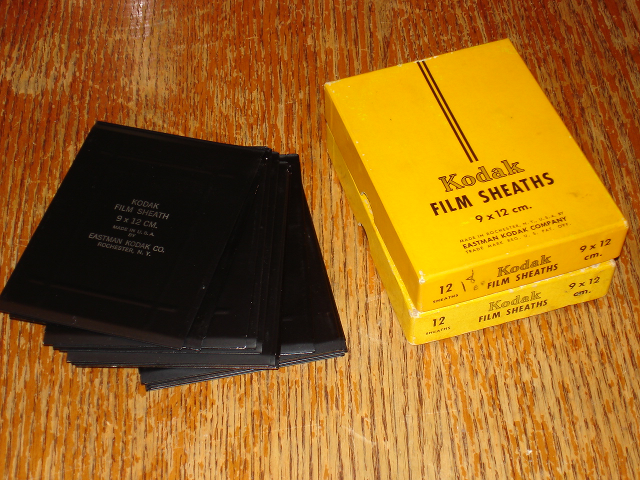

Thirteen "extra" 9x12cm Kodak film sheaths.
These will fit in the above holders.

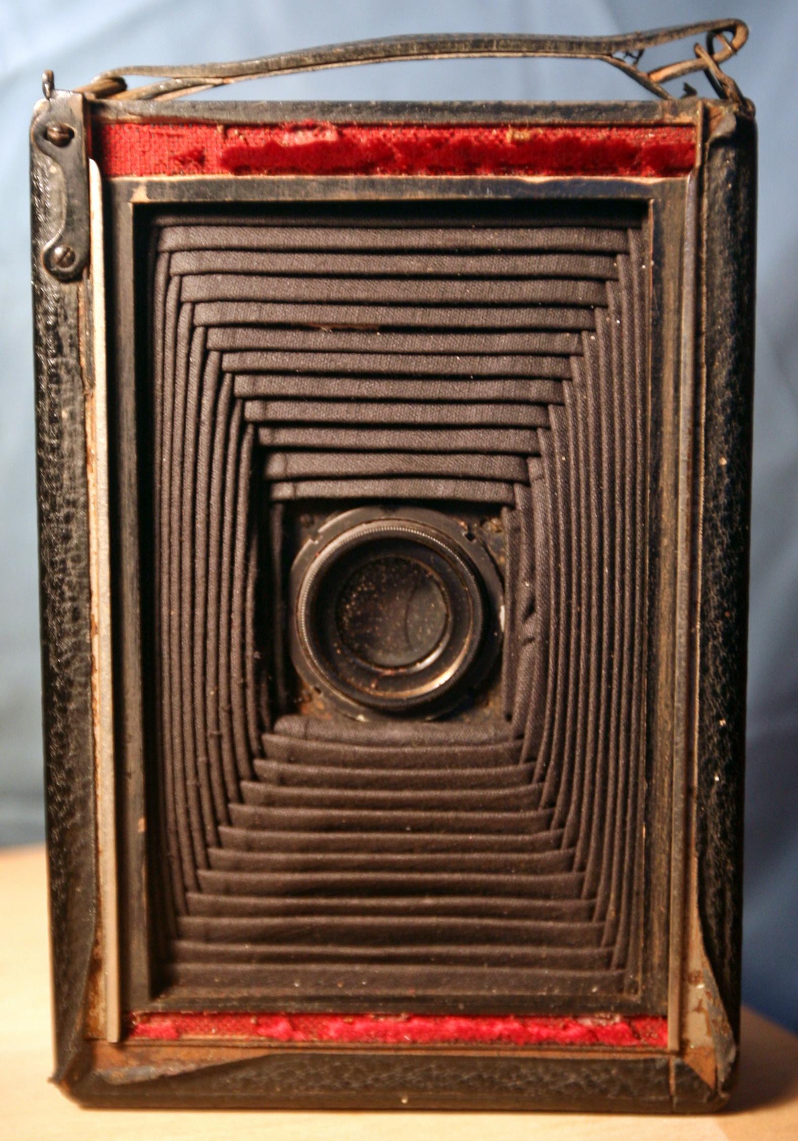

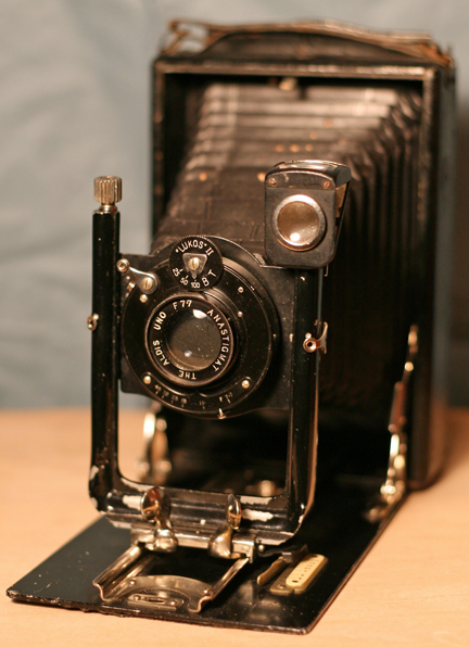

The Cameo 9x12 cm plate camera

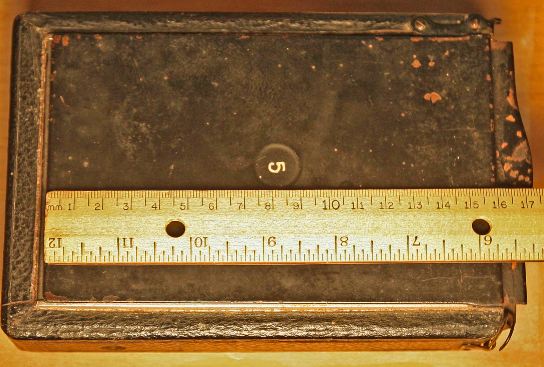

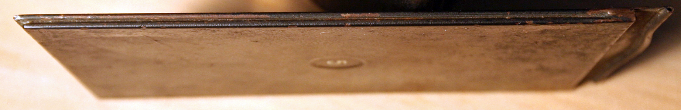

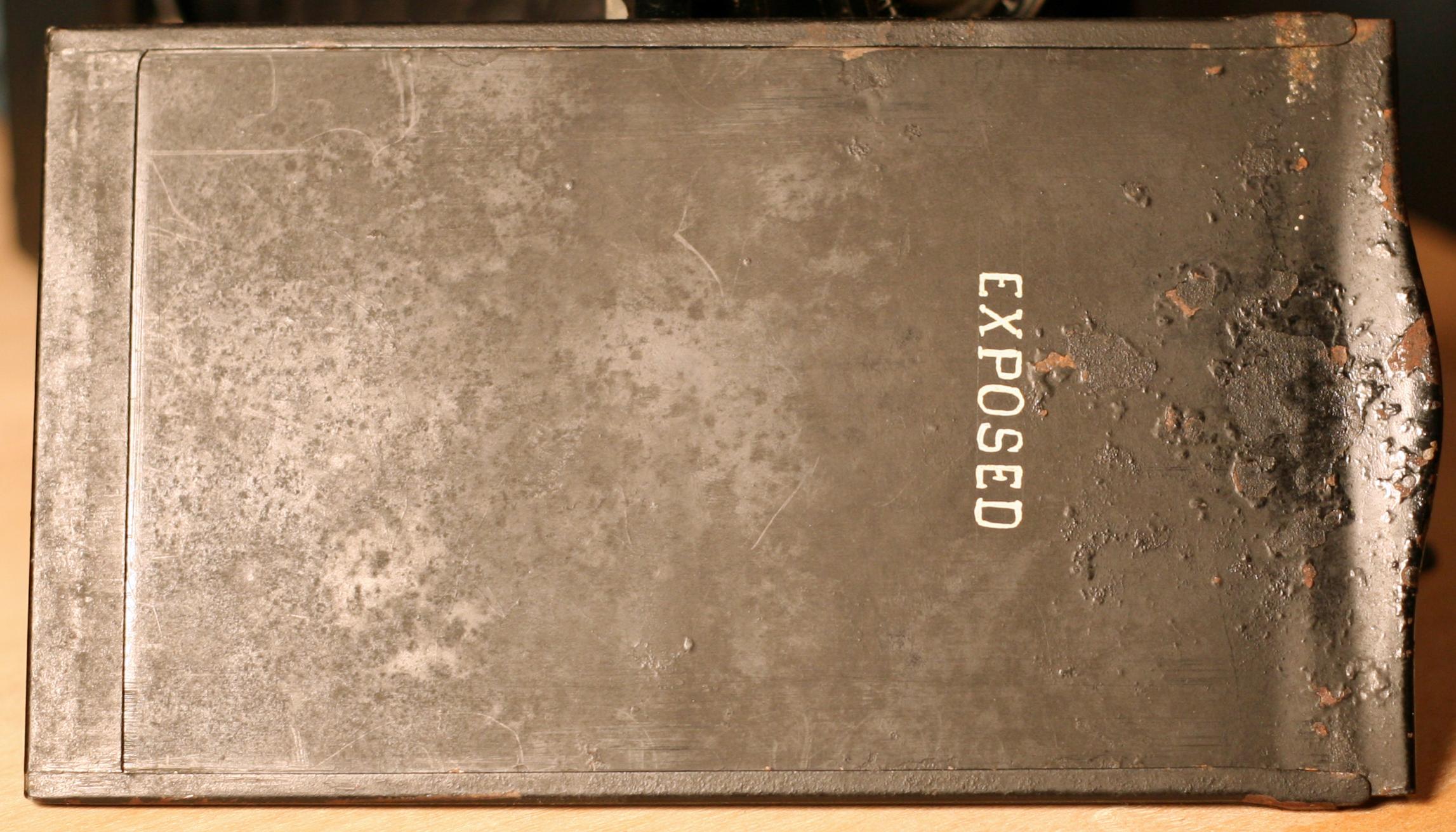

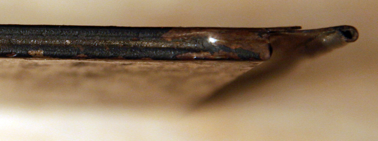

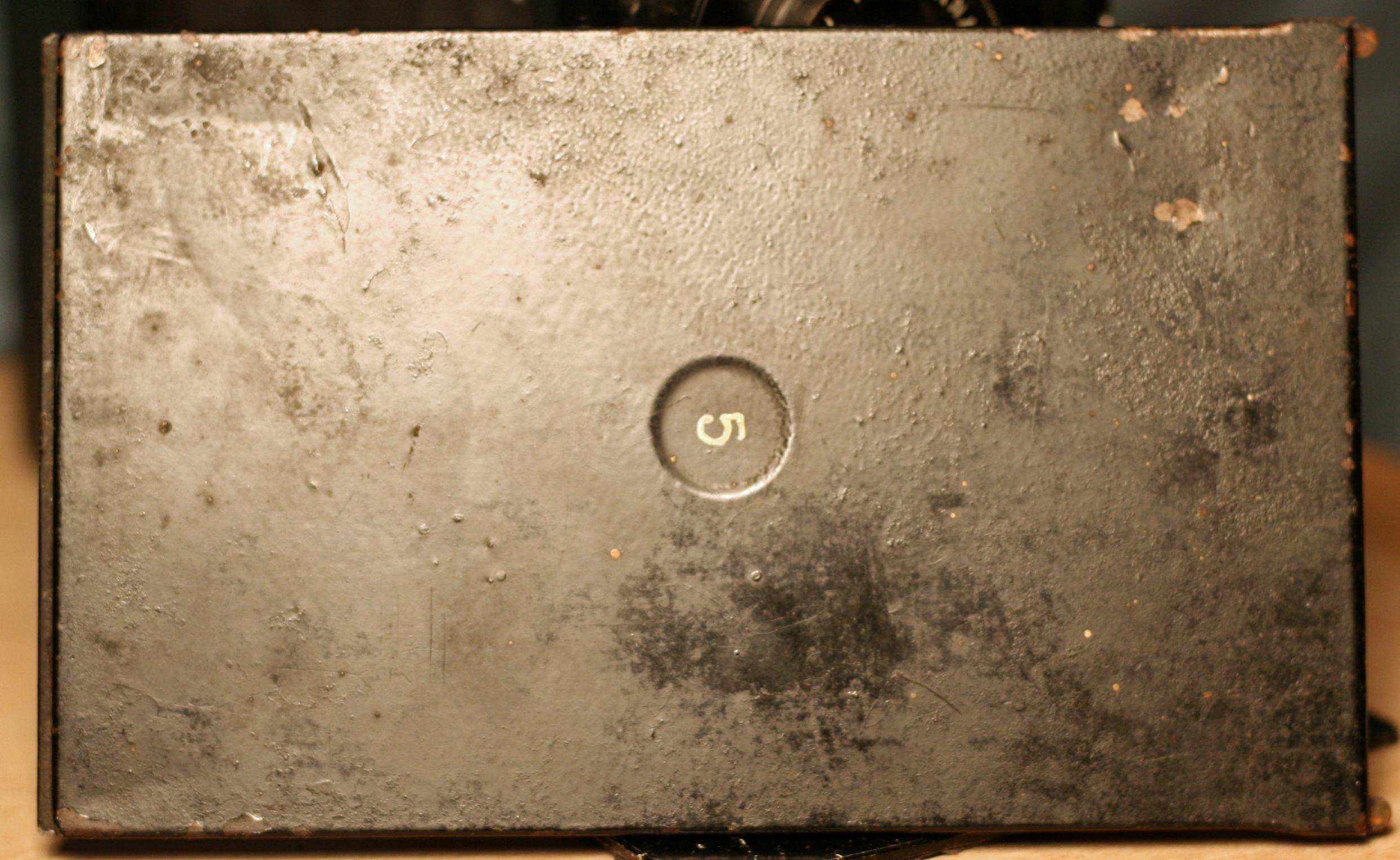

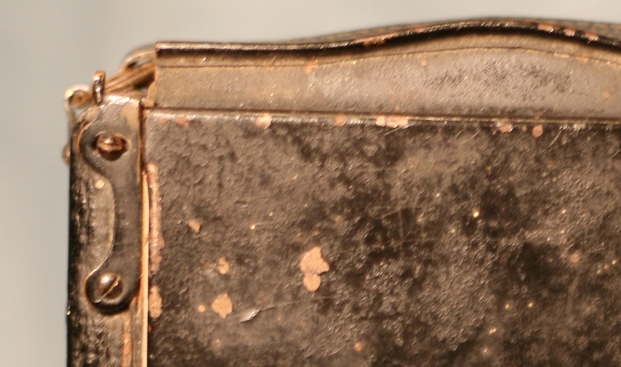

The plate holder is 10 cm wide and a total of 17.7 long to the top of the pull out slide in the middle.
Inside the plate holder, in-between the overlap lips is 13.6 cm long and 9 wide.
A piece of glass could be 14.5 cm long but should be shorter, say about a little less than 14 cm
There is a 2mm (.2cm) lip at the bottom of the plate holder
Two tabs stick up 4mm
The glass is clear and the shutter fires. The camera is labeled Cameo. The lens is THE ALDUS UNO F7.7 ANASTIGMAT
It does not have a ground glass attachment.
The Cameo supposedly has the same type of "falz" as my Agfa Isolar, the so-called "Normaldoppelfalz", but to be sure I'd need to see the sides of the inserts.

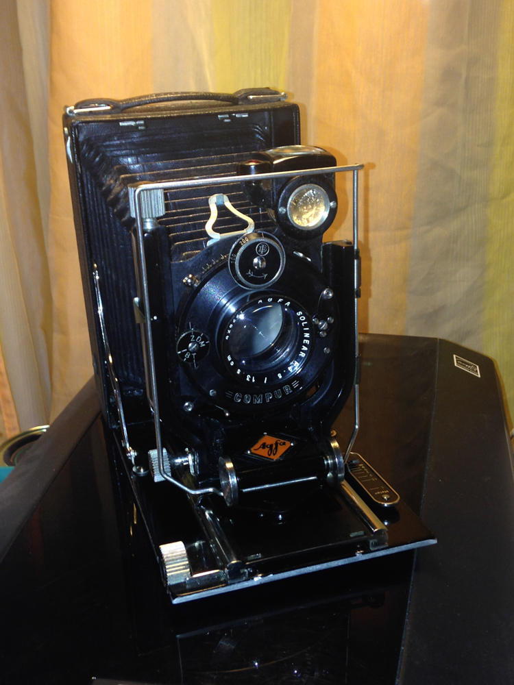

Here is my Agfa Isolar 408, restored her myself.
cheers

Well, nothing I've seen on eBay is specific enough to purchase, except that other Cameo 7.7 and it also lacks a glass. Measurements have been posted here for this Cameo in case someone has one like it or has a similar sized holder they do not know what is for.

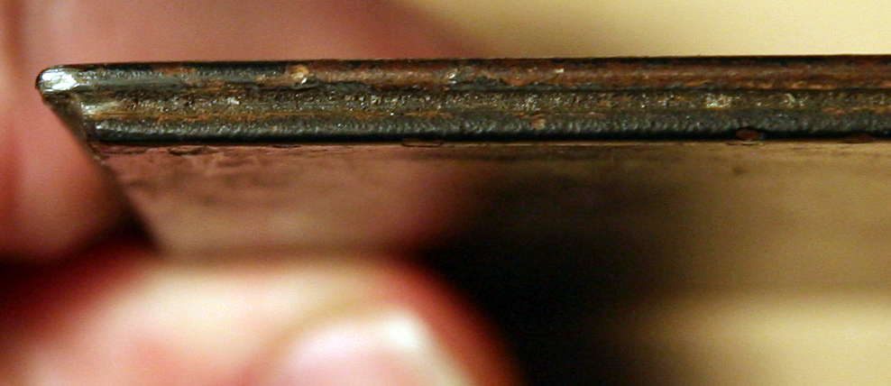

I'm posting dimensions again in the hopes someone has a plate holder or two in the size I need. The plate holder has a rectangular bump that sticks out in the back of the camera. It is 10cm wide or 3 7/8 inches wide by 16cm long or just over 6 1/4 inches long. That is plus draw slide handle and a 1/8 inch or 3cm lip on the bottom. There are pictures in the plate camera forum on page 9 showing the groove in the side. (there was a url link here which no longer exists)

That rang a bell and I had a look in a drawer. I found a few AP Paris holders, which though actually being real 9x12 are pencil labelled (in the dim and distant past, by some snapper) 3 1/2" x 4 3/4". This makes me wonder if yours are actually sized for the U.S. market and likely some plate-sized derivative. I know that many European 9x12 cameras were sold in the UK and US as being inch sizes and were supplied with holders for the local film sizes.
3 1/2 x 5 3/8 inch glass would fit but I'd have to cut some to be sure.
Do you think your holders would cover the length? 4 3/4 would be too short.
I've been looking on ebay and you are right that American sellers all list sizes in inches not cm. However they do not give enough measurements to know what size they actually are. Showing rulers really helps.
I stopped collecting the various '20s and '30s 9x12 film/plate holders when I had enough to match the ones I had. In the process I got lumbered with a few oddball sizes chucked in as part of lots. Yours are longer by a cm and wider by 5mm than any of mine, leading me to suspect a local variant.
The 5x4 standardisation post-war was the best thing to happen, removing all this hassle and uncertainty. Except for 9x12, which soldiered on, but at least it was contained in outwardly-appearing 5x4 holders and could be used in Linhofs and Graflexes, etc.
