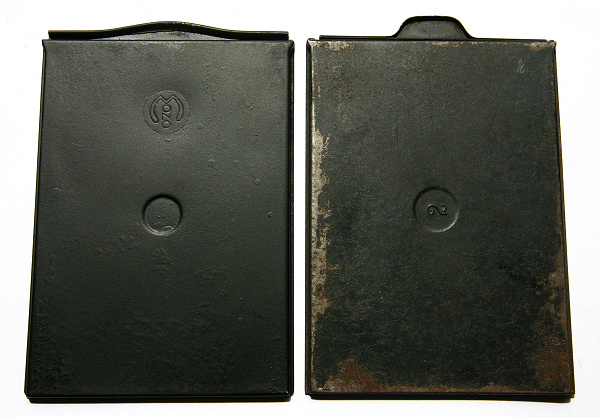

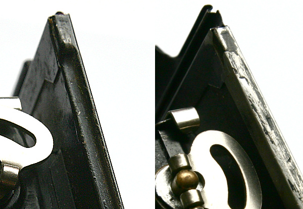

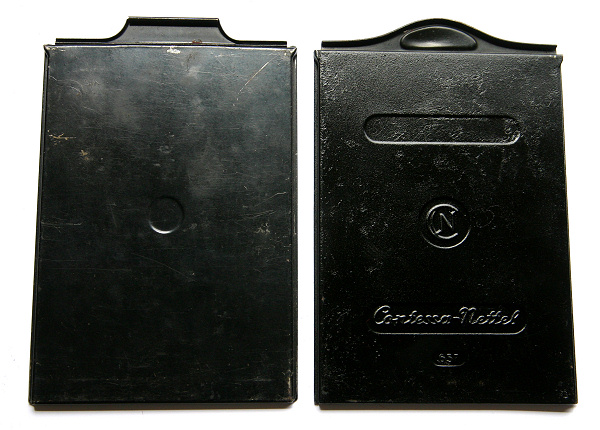

    Because there are so many variations of the holders I've measured & photographed what I currently own. It would be useful if anyone can add further variations and also the cameras they fit.
    These two fit a Rodenstock 9x12 and an Orion Werks 9x12
    [​IMG]
    details
    [​IMG]
    Width 100mm, length 139mm
    note the small locating lip at the top

    9x12 Plate holders 2
    Again these fit a Rodenstock & Orion Werks 9x12
    [​IMG]
    The Contessa Nettel code is 657
    details
    [​IMG]

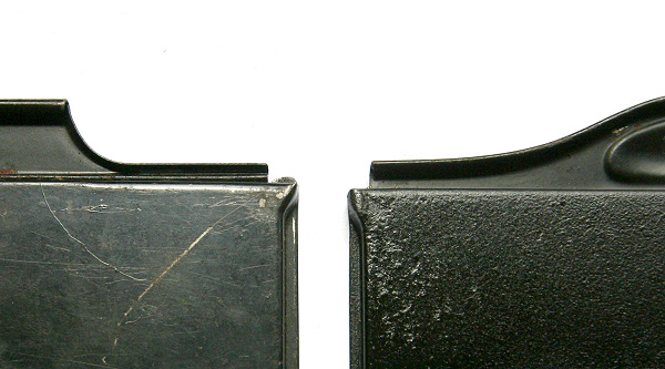

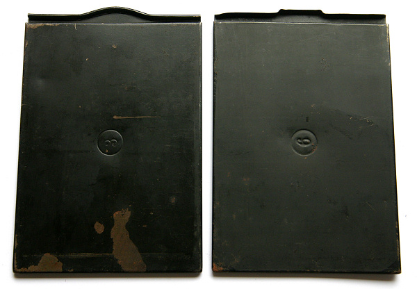

    9x12 Plate holders 3
    The first will fit the Rodenstock or Orion Werks 9x12's but is longer than normal.
    The details show why the second one won't fit.
    [​IMG]
    details
    [​IMG]
    First: Width 100mm, length 1145mm
    note the long locating lip at the top
    Second: Width 100mm, lenght 139
    note the long locating lip at the top, this prevents it's use in the Rodenstock & Orion Werks as it won't slide in afr enough and leaves a large gap at the bottom.

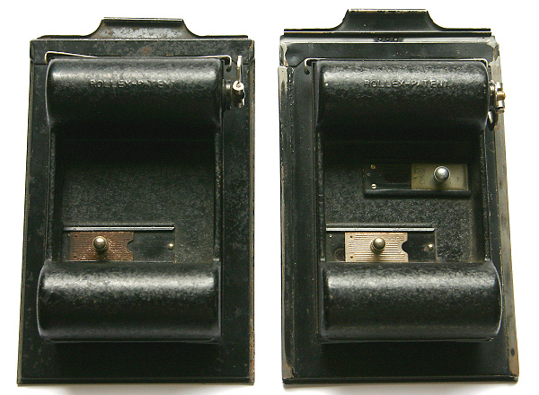

    Roll film holders
    Here's a couple of 9x12 fit Rollex roll film holders, nominally 6x9, both give a frame size of 56mm x85mm with slightly rounded corners.
    [​IMG]
    Edge details
    [​IMG]
    The left hand Rollex fits the Rodenstock & Orionwerks cameras, the edge details shown here are similar to the plate holders.
    The right hand Rollex fits an early 9x12 Linhof.
    Width of holders: 99mm (100mm Linhof fit) Length 150mm
    Any other information would be greatly appreciated.

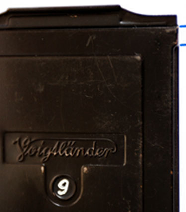

    I have a 9x12 Bergheil that came with four plate holders. There are some slight cosmetic differences in the backs but they all fit. As already stated the basic dimensions are 100 x 150 with a 7mm locating lip. The locating lip measurements are indicated by the blue lines I added to the photos. One of the holders came with a reducing insert to hold 6.5x9cm plates. That will come in handy as I have plenty of plates in that size. I don't have any 9x12 film inserts however & I'd really like to get some as I have film that I can't shoot because of this. I've nothing to trade but I do have money.

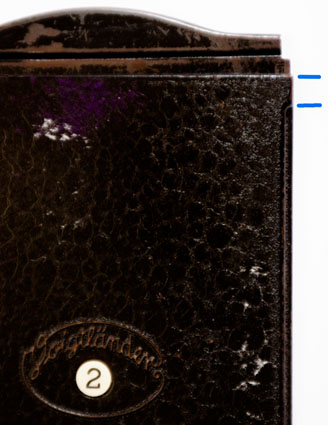

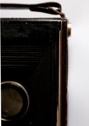

    I've also included a detail of the top corner of the camera back to show the cutaway that the locating lip has to fit with. Best advice I read when first researching plate cameras was to buy one that comes with holders that fit the camera. Unless you already have a good collection of holders it can be difficult to get the right ones. Thanks to Ole for that tip.
