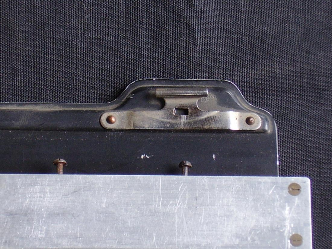

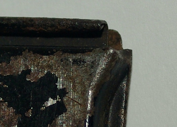

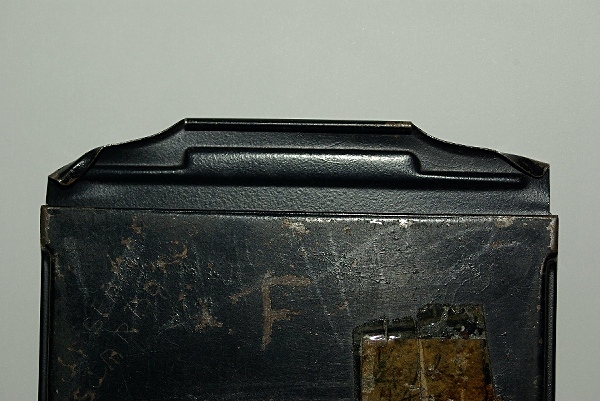

I've just acquired a Welta 9x12 and need to know what film holders would go with it. From what I can make out, it seems the narrow edged lip is the deciding factor and might be the one known as the "normalfalz", is this right?
I attach a couple of pics of the GGS holder and would like to draw attention to the step at the bottom of it - this step rides up onto a lip at the bottom of the camera back - does this make it an odd one out, or is this normal?
Many thanks for all pointers.

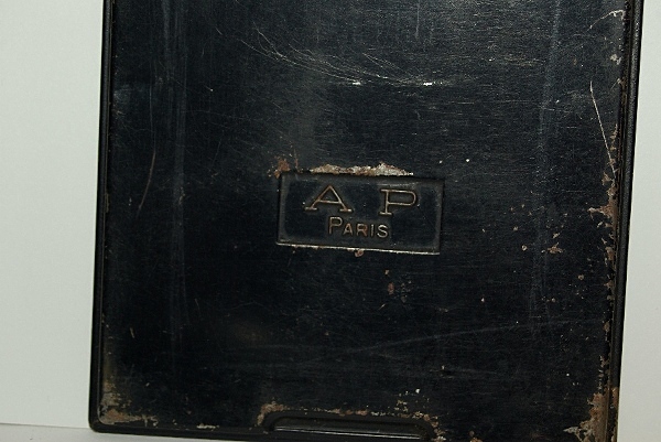

Welta holders

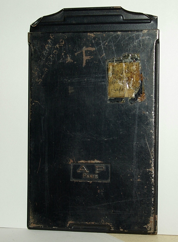

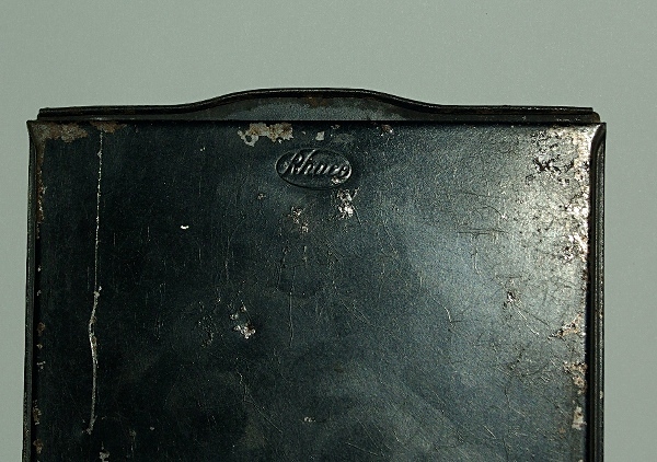

I recently bought another Welta which came with two Rhaco holders that fit the first one, although there's a difference in length, they being a bit short for the first camera.
Dimensions are 100mm wide x 138mm long with a 1mm lip on the long edges. Thumbnails one and two are of a Rhaco short plate.
Thumbnails three, four and five are of an AP Paris film holder that fits the Welta long body, but a slightly tight fit that will probably get a bit better with use and some candle wax on the edges. They have the internal dimensions for a 9x12 plate and not, as I first suspected, an old Imperial size. Overall size is 100mm wide and 150mm long with an edge lip of 1mm.
I also have a Rada rollfilm back that fits the second (short) camera, but because the Rada's got a groove instead of a lip the matching groove on the long body Welta is slightly too thick to accept it. This is a bit of a pita, as the Rada back would centre properly on the long body, whereas it's always a bit too far up on the short one.

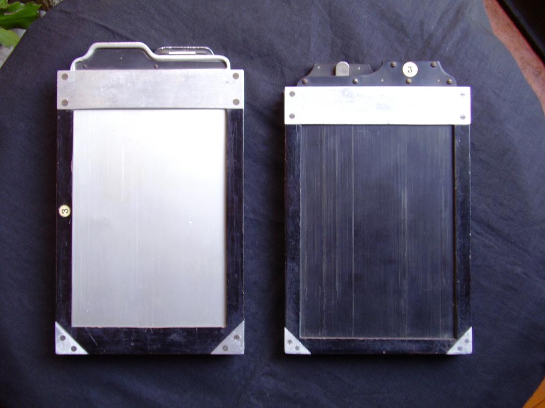

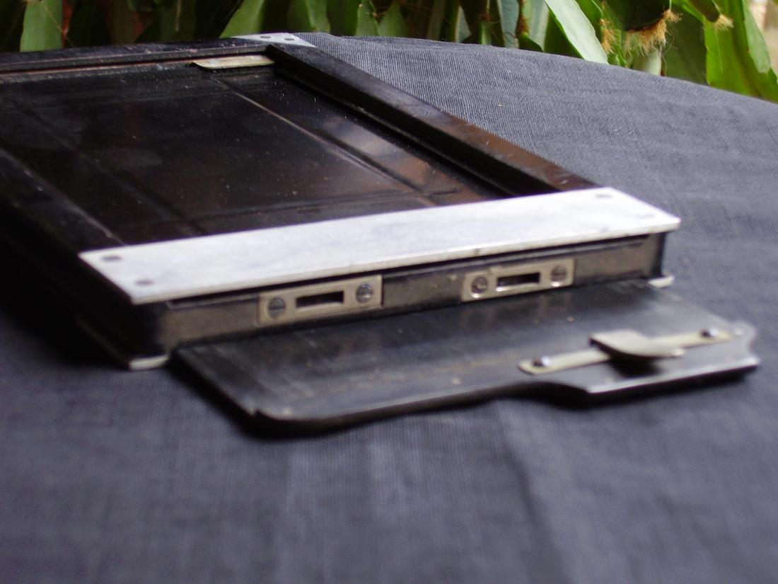

Unknown 9x12cm plate holders
I acquired these 9x12cm plate holders in order to obtain the film sheaths that were inside them. Although not quite up to the standards of Zeiss or ICA, these double sided holders are nevertheless precision built and have similar design features. They won't fit into any of my cameras. The larger model measures 111 x 167 x 15mm. The smaller is 111 x 158 x 12mm. Both have a 2mm wide lip along each long side. Both have small notches in the valley between the sides, to receive a locking pin on the camera body. Each dark slide is locked in place by a spring type mechanism that is squeezed to release it. The dark slides on the smaller model have metal "tongues" that fit into notches in the holder body. On the larger model two screws with round heads protrude from the body. The holders have metal handles with rectangular cut outs that "catch" the screw heads. Squeezing the handle releases it. Can anyone help to identify these holders?

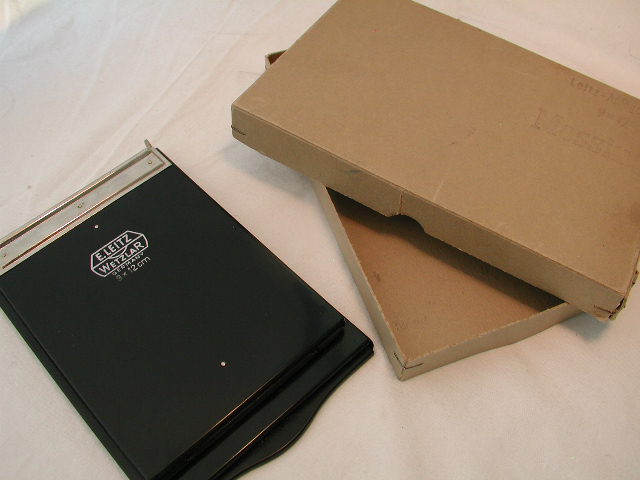

Having just acquired a very good condition Voigtlander Avus in 9x12 configuration and seeing some very lovely photos taken with another Avus on the internet (while researching this camera), now I want some film holders. Since I don't do plates, it is important to me to get holders that have those special sheaths Ian talks about.
So, anyone know if the Leitz Wetzlar anlegefalz 9x12 holders will work for a Voigtlander Avus? I've gone through all the other listings for sale and ruled everything else out. If anyone knows the answer to this question... then maybe I can get my hands on ONE film holder. Here's a photo of the one in question (this came from the seller).
It doesn't look so. I understand that you're eager to start using the camera, but relax and check eBay every day and you will soon find original Voigtländer plate holders. I bought around twenty 6,5x9 plate holders for my Voigtländer Bergheil within a few months after getting the camera, and nine 9x12 after I bought my 9x12 Avus (and later also bought another Avus plus a Bergheil 9x12).

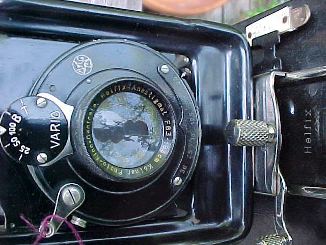

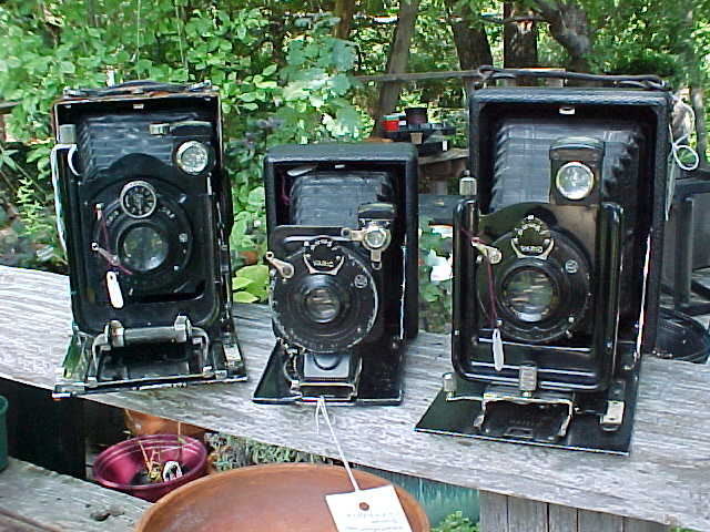

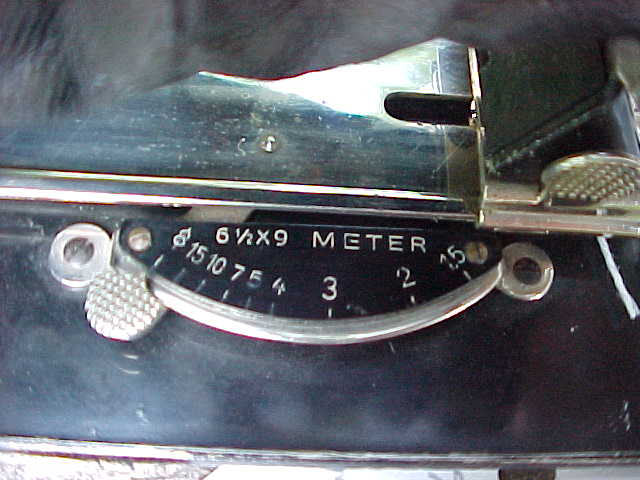

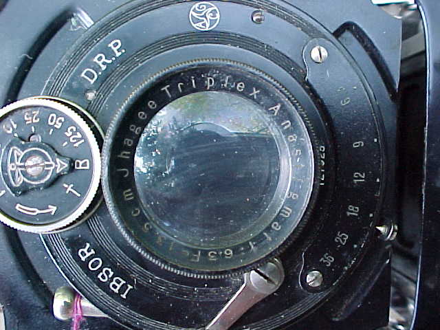

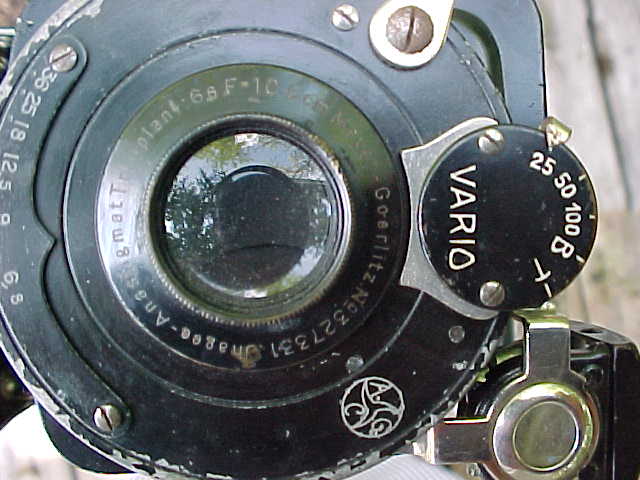

Need Holder help!
I have these three plate cameras that I traded with a Dutch Sergeant at Sheppard AFB back in the 80's. They seem to be w/o name except on the lenses. One of the larger ones has the name "HELFIX" on the bed but I can't get that to correspond to a brand name. One of the larger has an unmarked plate holder. The plate holder and the ground glass seem to interchange between the larger cameras. W/o a brand name I don't know what to look for in more plate holders. Should I be looking for plate holders based on measurements and style?
I think I might find a roll film holder for the smaller.
The Ihagee looks as if it's the same holder as my Ihagee (which was a fairly common holder, shared by several makes). Most of them don't have any particular identifying names or marks, you'll just have to go by auction photographs of them or ask the vendor the size. The thin lipped ones (as you have) vary in length and how snugly they fit down in the slot. It's really just trial and error until you find enough to get you going. Best of luck finding film inserts for them - most of them seem to have got chucked out or lost.

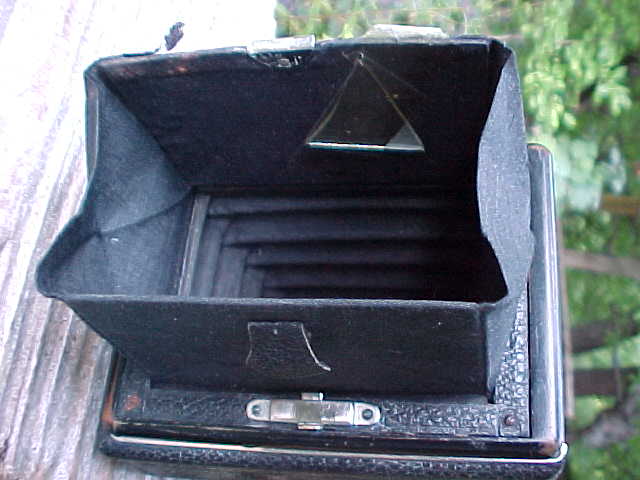

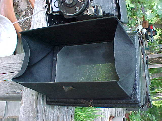

Roll film back?
Would it perhaps be easier to find a 120 back to fit this camera? (The middle one)
Oh, they're still around, I've seen a few on ebugger, but you still have to take a chance on what will fit.
