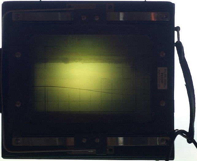

Haven't seen any 9x12cm Plaubel Plate holders in this thread:
They came with these old 9x12cm / 13x18cm Plaubel metal monsters like Universal or Supra, and what I have heard they will fit old (9x12cm) Linhof backs, too.
The structured parts are the base for plates or film, and the open frame as seen above will center the film; once locked, it will press him down.

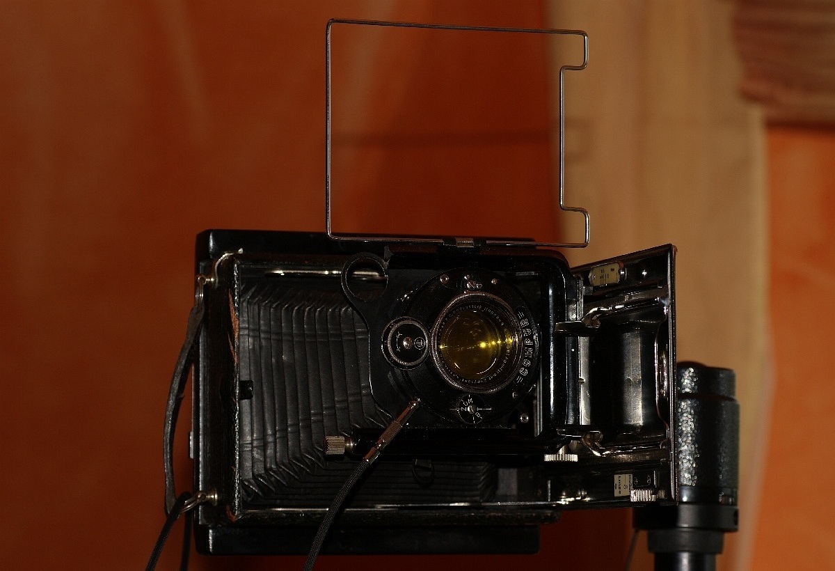

I love to use an old Plaubel 9x12cm back, married with a typical 9x12cm Plattenkamera.
Believe it or not - this plate/filmholders gave me sharpest pics ever, depending on superb film flatness.
Other than with typical ancient plateholders it's a real joy to load my film. It's a joy to use the Plateholders AND the camera :smile:
All I miss - I really have to give her some tilt function next..

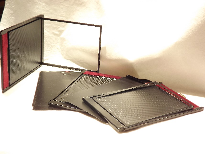

I have tree plateholders that came with my Orionwerke. None of them would appear to be right for the camera. Two have just the single rib on the side and no rib on the bottom and are just slightly too short so I can't lock them with the little lock that also holds the g glass in place. But they seem to be useable. The third is slightly too tall probably, matter of 1mm or so but above all it has a double rib (or so it appears) down the sides and a rib also on the bottom (which slips into the camera but combines to make the holder very hard to withdraw as it binds just a little bit. PITA when the slide moves when you want to take the holder out! It has a flap to lift up when loading plates and septums (and the septum works best inserted upside down - head first). But they are all useable, I think. I only have the septums since january and have done very little so far. I am using paper negs for the moment.
Reason for the post: I have a fourth plate holder that I bought on a chance in a Kamerastore sale. I judged on the photo (their announced dimensions are completely false!). It would be right size for the Orionwerke but it has slab sides and no ribs so no good to me. If it is any interest to anyone pm me and we'll check dimensions. I am stuck in the UK for quite a while and the bits are at home in France so no rush over this, I should have a passage at home end of April. If it's any good there are three or four I think still on-line at Kamerastore but it's a matter of judging from the photos, the information is off.
