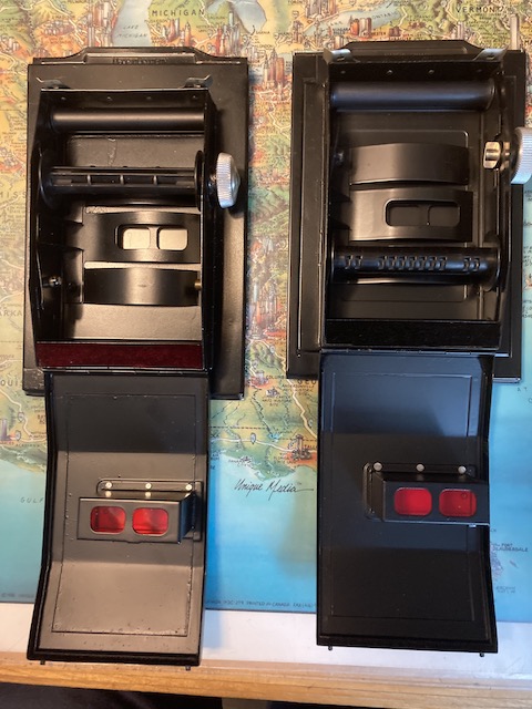

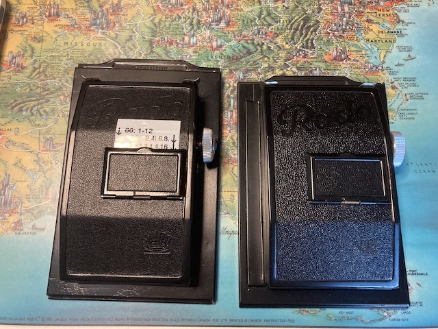

How does one identify the Rada Rollfilm Adapters?
I have two and neither has a Model No. or Name that I can find. The one on the left has the 'lip' which will slide onto the back of my Voigtlander 91x12; the one on the right does not have the 'lip' and seems intended to lock onto some other camera system - but which one?

I have a Rada RF back 6.5x9 and the original box and there's no identifying markings to denote what cameras it fits, Pictures of the other side would yield more information,
Ian
Ian
With front and with the covers open.
