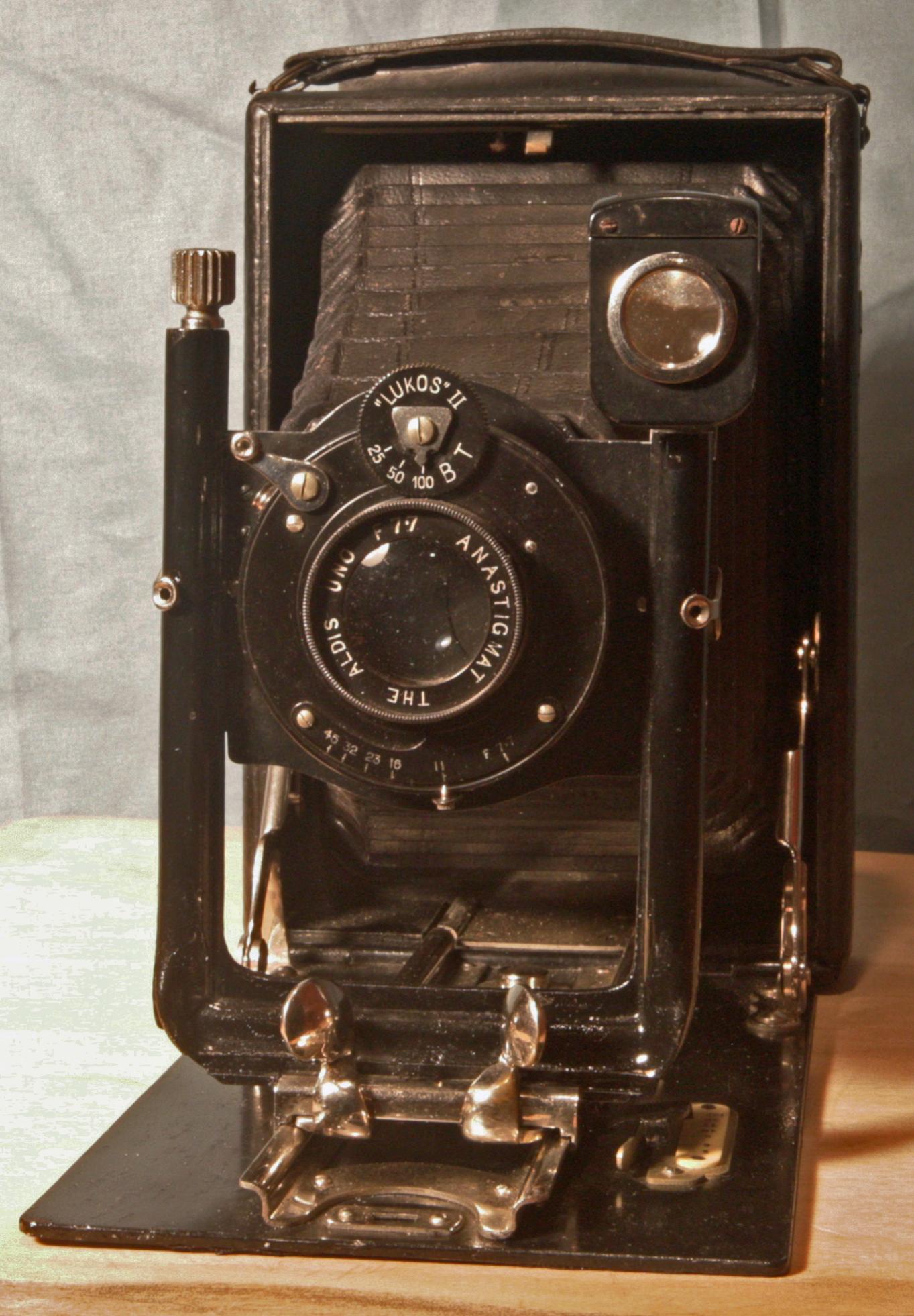

I'm posting dimensions again in the hopes someone has a plate holder or two in the size I need. The plate holder has a rectangular bump that sticks out in the back of the camera. It is 10cm wide or 3 7/8 inches wide by 16cm long or just over 6 1/4 inches long. That is plus draw slide handle and a 1/8 inch or 3cm lip on the bottom. There are pictures in the plate camera forum on page 9 showing the groove in the side. (there was a url link here which no longer exists)

I found two plate holders with the right dimensions, they have a grooved edge, and identified your problem, you don't have a 9x12 Cameo !
You have a Postcard size Butchers camera, I just checked the dimension and I'm 100% certain, that's why you can't find 9x12 holders that fit. Also 9x12 film inserts won't fit unless you modify the plate holders to hold them in place. They do fit width wise, at least the ones I've just tried.
Ian
You're right. I found a link this morning after I looked up the lens on the internet.
http://www.historiccamera.com/cgi-bin/librarium/pm.cgi?action=display&login=pocketcameo
the postcard size hit my eye.

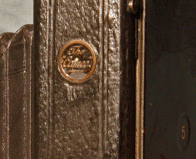

So, it's a Pocket Cameo, Model 1 with rise and fall and side to side movement of the front stand, in the 3 1/2 x 5 1/2 postcard size, made in England.
Great to know all that. Thanks all.

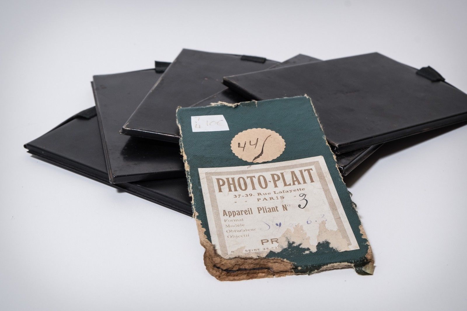

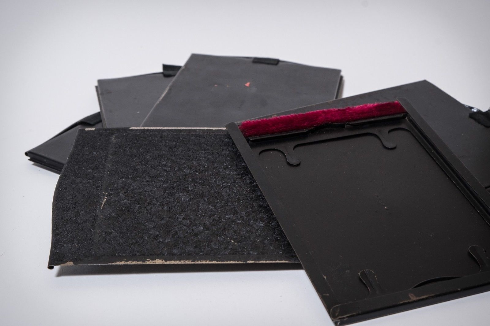

Just realized I should have added this to the "database":
Photo-Plait "Appareil Pliant No3" 9x12cm plate holders.
104mm wide
100mm wide (inside dimension
140mm long
4.7mm thick
1.0mm thick lip
Square bottom; no lip around bottom of holder.
(full disclosure: images taken from the auction in which I purchased said holders)

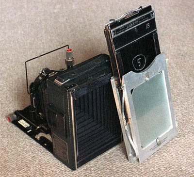

One solution is to get a spring back as shown in the photo. Unfortunately they don't take double sided film holders as shown in the photo, however they do solve the problem of proprietary plate holders as these spring backs accept just about all 9x12 plate holders as the back relies on a spring rather than a notch and groove.
I have a Feather-Lite Adapter For American Films Hollywood Photo MFG. CO. Hollywood 28, CALIF. U.S.A
There are other variations of this spring back made by small American companies such as this, they can be found on eBay often attached to cameras or some times more rarely sold individually.
Aside from solving the proprietary notch problem , the spring back allows you to focus and take your photo without removing the ground glass and swiftly trying to replace it with the film holder.

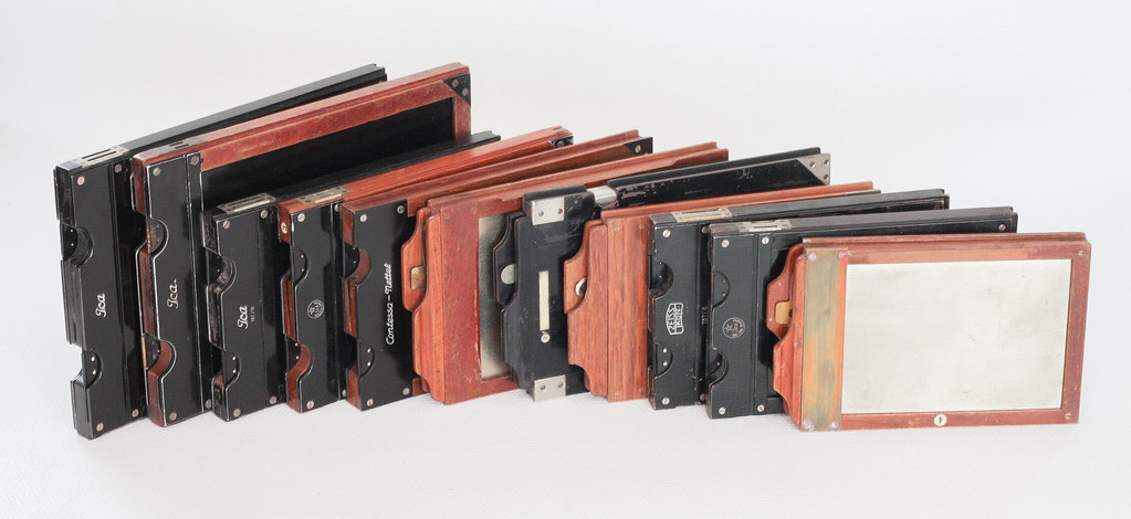

Found time to take a shot of my German double plateholders; they are not only 9 x 12 but thought it might be interesting to have them here:
by Ron (Netherlands), on Flickr
Click on the picture and you'll find some info on the holders below the flickr picture. I'll make a list with the German camera's to which they fit. Btw, most of them are not easy to find - my experience over the last few years is that they are not regularly offered for sale (not even at German sites).
