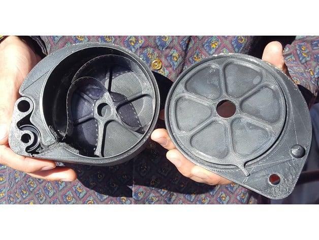

I like this. I found two 3D printable loaders. One loads direct from the 400ft roll to a cassette. The other is a 400ft to 100ft tool. The latter is the way I'd probably go.
Can you link to a source for the printable files (.stl or equivalent) for that? I've been looking for one of those almost since I got my Ender 3. It should just about fit on the build plate if they didn't go overboard on thickness, since a 400 foot roll is only about 6 1/2 inches diameter (and I have 8x8xalmost 10 inche build volume).
I've got the files for a roll converter -- pretty simple in general, but it's an "in the dark" operation, and you get a coreless roll unless you provide your own cores (those are pretty easily to 3D print as well).

Both types
printable 100ft loader

Thanks! That will complete my set (I've got the 100' loader and respooler files already).

It turned out I already have that 400-foot-to-cassette loader model -- but can't print it, because it's about 30 mm too large both directions to fit my build volume (and wouldn't print well standing up on edge). And that's bigger than it needs to be, I'm pretty sure. By my calculation, 400 feet of film at 0.007" thick on a 1" core shouldn't exceed 6 1/2" diameter. If that loader's chamber were reduced to, say, 6 3/4" (instead of just about 8") I'd be able to print it. I bet it's sized for film on a daylight loading spool, but AFAIK those don't exist in 35mm -- they're a thing in 16 mm and Double 8.
So I looked at having it service printed -- looks like I can get it in black PLA with sanded finish (why is that cheaper than standard layered finish?!) at 60% infill for about $103, same for carbon reinforced black PLA (which is likely to be a little more opaque). If I had a model that would fit my printer, I could print it for under $20 in filament (plus any failed prints, of course).
Sigh...
Back to trying to CAD one for myself with a 6 3/4" chamber.

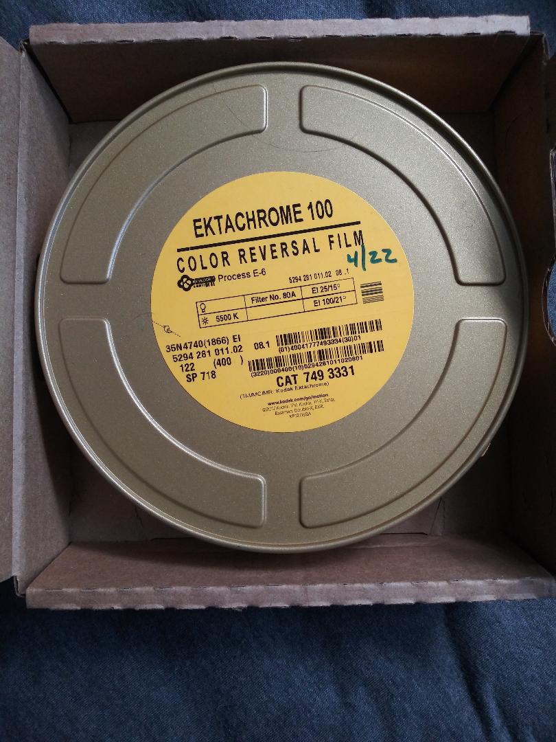

I shot 2 E100 rolls a few days ago and developed 1 along with some provia and velvia. the dye that came out was no different than any other e-6 film I've done, but maybe a little more intense, meaning it took an exta wash cycle to get the wash water to come out clear. very much like ektar or tmax when I develop it. So I have no worries about my chems. they were no different after the 4 rolls of velvia than they were after the E100. the 35mm film is just like the E100 I have shot in 4x5. for the price, I might buy another 2 or 3 400 ft rolls (there is no price break for 1000 ft rolls over 400 and the 400 are easier to roll to 100 ft lengths and store) before they raise the price on the film. seems twice a year now film prices get a significant price bump, but inflation is hitting everything it seems.
so the price break is a great buy compared to buying regular 35mm rolls. Just like it used to be when you bought bulk rolls of B&W film. too be honest, I might buy even more of the film if I didnt keep having thoughts that I would not be able to buy the chems and develop it myself at home. the thought of paying $10 a roll for development is insane to me.

I wrote the 4/22 to give me a purchase date that was visible on the can.
