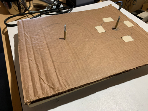

Can anybody recommend a safe and reliable way to split a 400' or 1000' roll into 100' rolls?
Easy-peasy. I glued together several layers of cardboard, big enough to hold both rolls and put screws through it for the cores. Tape marks the edge of the 100ft roll to tell when to quit. I do it in a darkbag.

Nice. I could probably make a nicer one from a 1x6 melamine shelf board with dowels glued into holes. I should work on that.
Oh, note to self -- be sure I have four 100' cans and bags handy before starting this, so I can just do it all at once.
You are certainly free - nay, encouraged! - to improve all you want on this rather slipshod prototype, thrown together from bits and scraps found around the basement.
