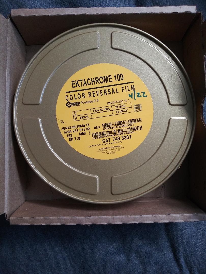

How much did you spend to get that reel?
Not to answer for him, but the last 120 m roll of Ektrachrome I saw was about US$650 before tax and shipping -- around 50% more than Vision3 in the same roll length.
pbromaghin
Sep 30, 2010
3,826
Castle Rock, CO
Donald's price is from B&H. From the link in AgX's post #91 in this thread, direct order price from Kodak:
KODAK EKTACHROME 100D Color Reversal Film 5294 35 mm KODAK EKTACHROME 100D Color Reversal Film 7294 16 mm Perforated One Edge Perforated Two Edges Super 8 Film for Cartridge Movie Cameras  Finish-to-Order (FTO) catalog number. Sold only in specific minimum order quantities or multiples of the minimum order quantities; non-returnable; US and Canada delivery time of approximately 3 weeks from receipt of purchase order. Other restrictions may apply. Contact your local Kodak representative for additional information.
KODAK EKTACHROME 100D Color Reversal Film 5294 / SP718 / 35 mm x 400 ft roll / U Core / BH-1866 7493331 1 1+ $520.00 02/04/2022
KODAK EKTACHROME 100D Color Reversal Film 5294 / SP718 / 35 mm x 1000 ft roll / U Core / BH-1866 7493349 1 1+ $1300.00 02/04/2022

I would potentially consider buying a 100ft roll from someone here. I'm not sure yet, though. I have never loaded bulk film before.
willfrancis
Aug 29, 2019
22
London, UK
From my part, cost-wise I would be able to commit to 100ft, perhaps 200ft depending on how many others were keen to chip in. However, I don’t have the facility to split the 400ft master roll down, which I suspect will be the key issue. Anyone U.K.-based have a 3D printer?

If I send you the 400 ft roll and some empty spool in their canister, could you respool it for me? This way whoever else want to chip in can.
YoIaMoNwater
Nov 25, 2020
235
UK
Kodak UK Order just got back to me and it’s £480 for the 400ft bulk roll. That’s a pretty damn good deal considering a single roll is like £20 now.
That's the exact point of buying bulk rolls. That's about the same price per cassette as Tri-X or T-Max 100 in bulk rolls. If you can process your own, it makes shooting Ektachrome competitive with shooting ProImage 100, or Gold 200.
