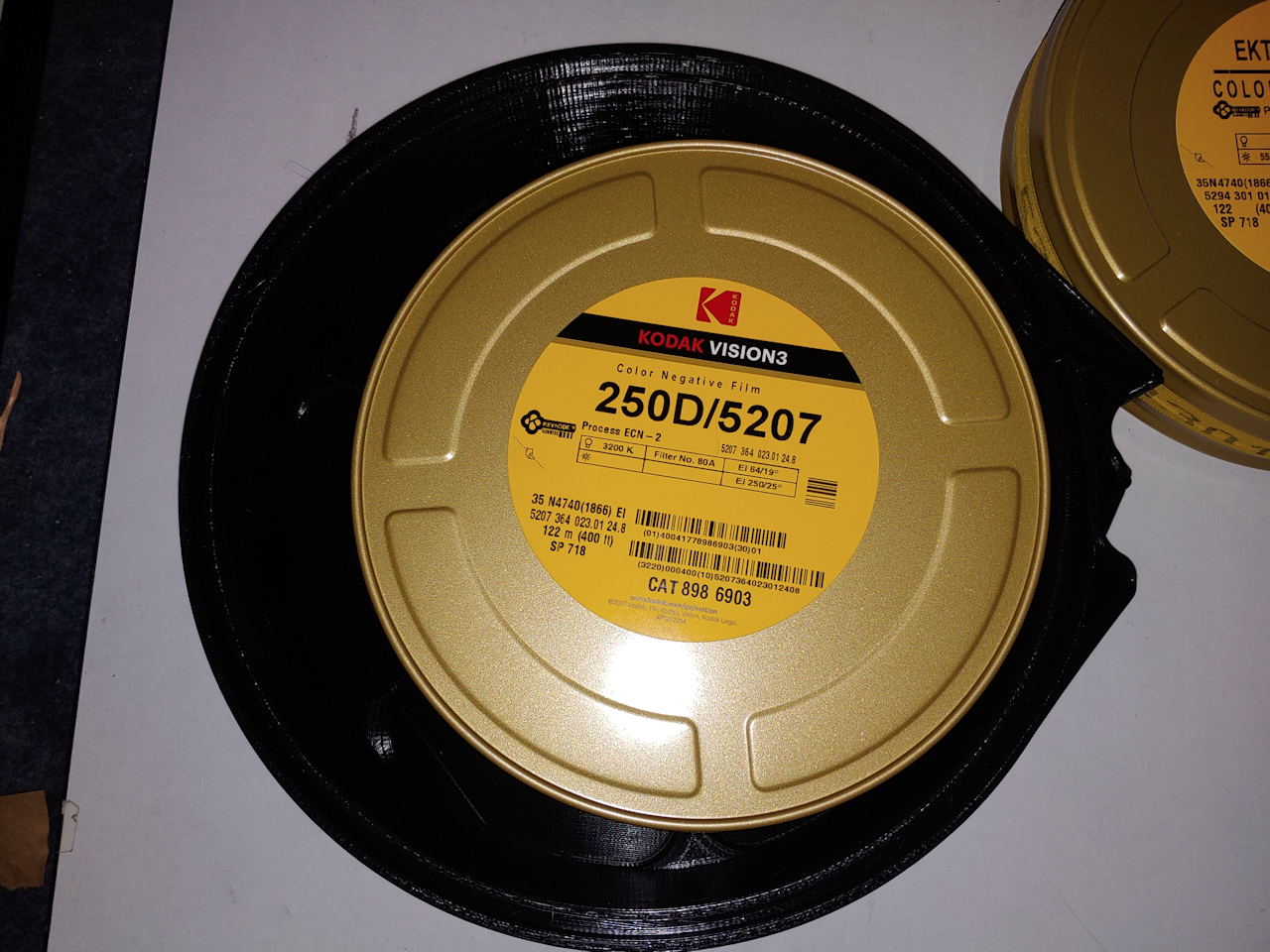

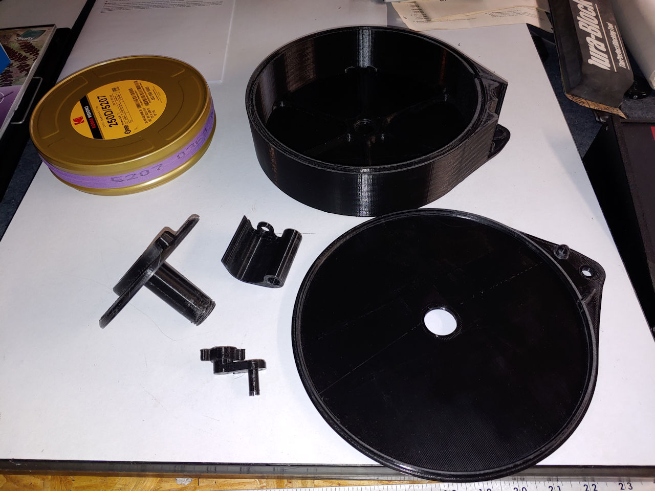

In another thread I mentioned I played with Vision3 film and was pleased with the potential results so ordered a 400 foot roll. I'm popping back over here because of the mention of bulk loaders and re-spoolers.
I decided to 3d print a 400ft bulk loader. There are two flavors I could find. I picked one and so far have printed the base for it, the other bits are printing as I type this. What I noticed is the one I picked is a bit bigger than I think it needs to be. The other is smaller. The bigger one is on cults3d.com and the smaller on thingiverse.com ( a remix of a 100 ft version ). So it ends up when I ordered the Vision3 250D film I also bought a 400ft roll of 100D ( so now I'm on topic ). Once this bigger version is done printing, I will print the smaller one to see how it looks. I have a third version in mind that I want to improve the light tightness of the film exit on.
I am happy with Kodak, I ordered this stuff on Tuesday, they shipped it Wednesday. When I called them, it was pretty simple and straight forward to order.
Here are some pics of the larger version base. As I make progress I'll update here. I will also update my Vision3 thread as I dial in my final process.

bigger is always better than too small. BE extermely careful of light tightness. that roll of 5294 is one expensive chunk of film.
Joel_L
Mar 12, 2011
580
Colorado
I still think this one is excessively large. The third design I have in mind will have a more positive seal on the film than what these two designs provide.
I plan on putting a length of B&W film in there to do a test roll with before the color film goes in.
Joel_L
Mar 12, 2011
580
Colorado
I finished printing the large version and put a length of B&W film in it and shined a light at it using various angles. I also opened the cover for the cartridge and shined a light into the film trap. I loaded a roll using the film and see no evidence of a light leak. I'm still not thrilled with the size of it.
I started to print the smaller 400ft loader but stopped it before it was done. The faceting on the curves was not done well. Looking at it more closely, I also did not like the way light traps were done. between the body and the cover. so I'll pass on that one.
I'm in the process of drawing up my own, have no idea when I'll be done. For now the big one is usable.

That's great news. How long did the print take?
Joel_L
Mar 12, 2011
580
Colorado
I printed it in three groups, the main body was about 19 hours, the cap screw crank and cover took about 4 hours, the lid and crank helper took about 7 hours.
Given that this is pretty big, I printed with a .5mm nozzle and .25mm layer height.. I had to do some fitting and sanding after the print to get it all to go together. Most notably was the film exit, I am using 1.5mm felt for the light trap. I had to sand it a bit wider to get both layers to fit and let the film slide through.
I think if I were to do another, I would use a .4mm nozzle and .2mm layer height.

What model printer do you have? I'd had trouble getting the one from Thingiverse (the smaller one as mentioned above) to fit the build space for my Ender 3 -- slicer keeps telling me it runs out of room (though I don't recall if I cut the skirt to zero).
