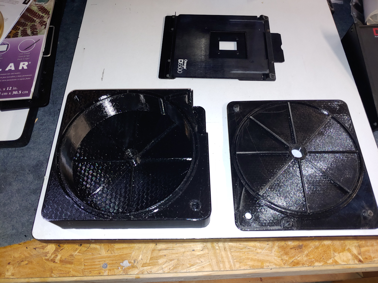

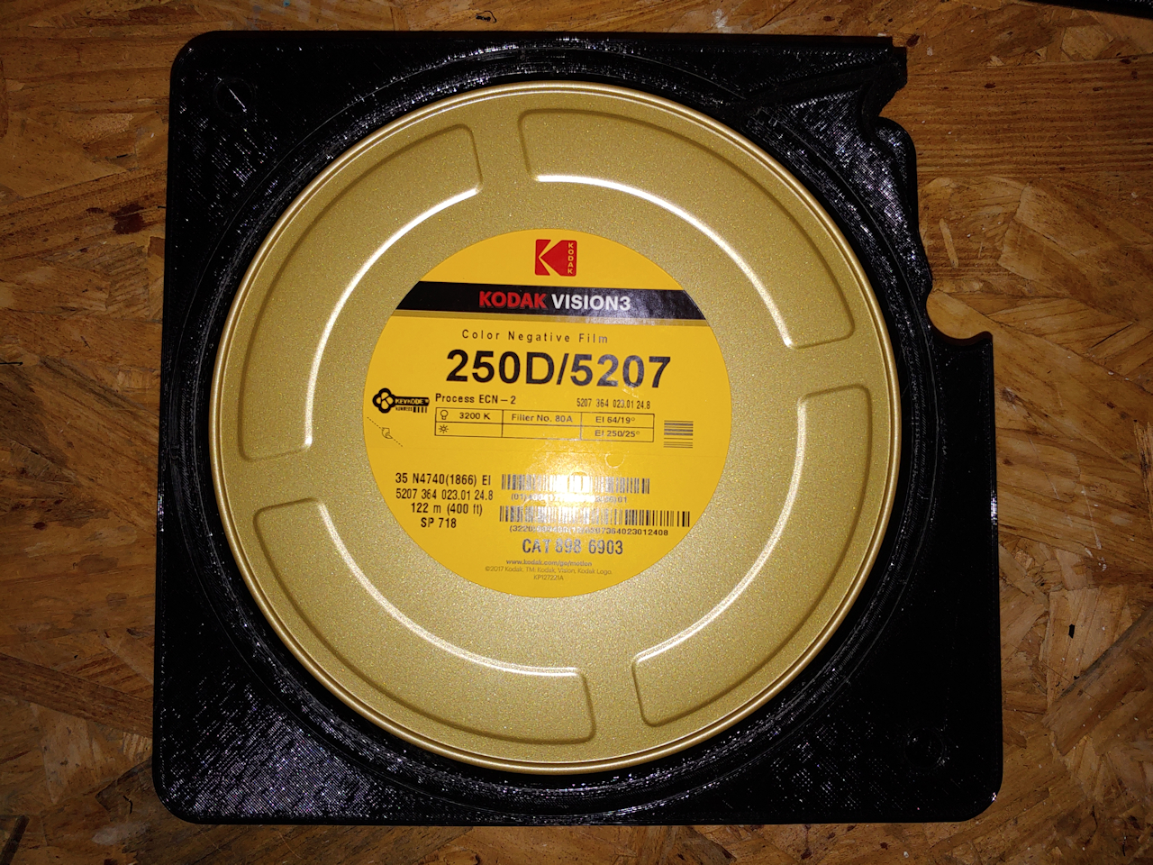

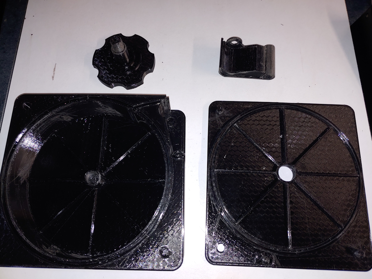

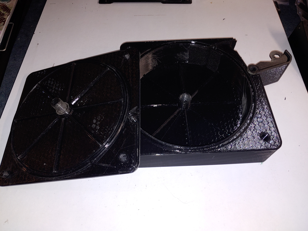

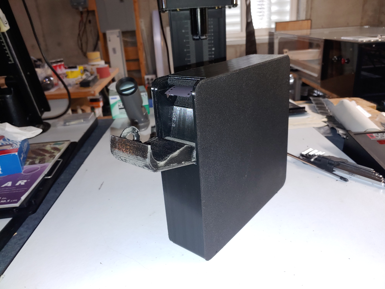

I'm almost done with my version of a 400ft film loader. I made it a bit smaller than what's out there and squared it up so it fits in my fridge better. I still need to print the hatch and the lid screw.
I'm printing these out of PETG-G. A little clean up when done but I think will be better than PLA or ABS.
What I'm finding I like it is I can shoot to the last frame and still get a full image. The Watsons and Aldens seem to waste about two frames.
Sorry Donald, it's still 220x234mm

I wonder if that could be shrunk a little more? I don't think the bulk chamber needs to be bigger than about 6 1/2 inches (plus a little clearance) inside diameter; it certainly seems like I ought to be able to make a whole unit that will fit my build volume even with pretty thick walls (for light tightness). I might have to learn a different CAD package -- FreeCAD has some issues that make it tricky to manage any sort of faintly complex shapes (like the curved film channel that acts as the light trap between the cassette space and the bulk roll chamber).

I made it just slightly larger than the can, not sure how much smaller the roll was.
Donald Qualls
Jan 19, 2005
12,343
North Carolina
The B&W bulk rolls I've opened in the past couple years are significantly smaller than the standard 100' can -- though 100 ' bulk loaders typically have a chamber close to the can in size.
Joel_L
Mar 12, 2011
580
Colorado
The can is 7 inches and I didn't make it much bigger than the can. I think trying to make it smaller would be problematic.
Freecad I never got along with. Good cad tools make this kind of thing much easier.

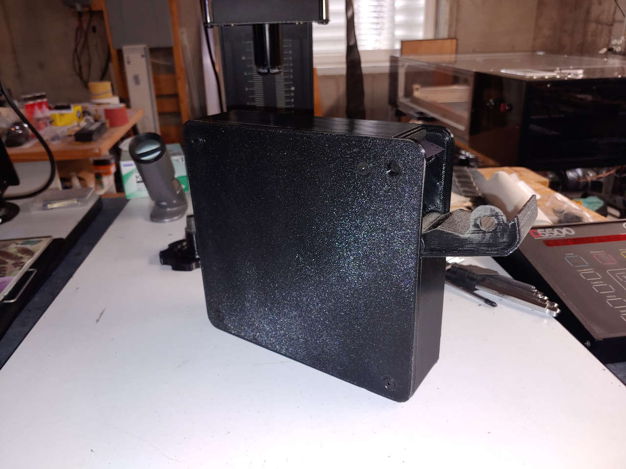

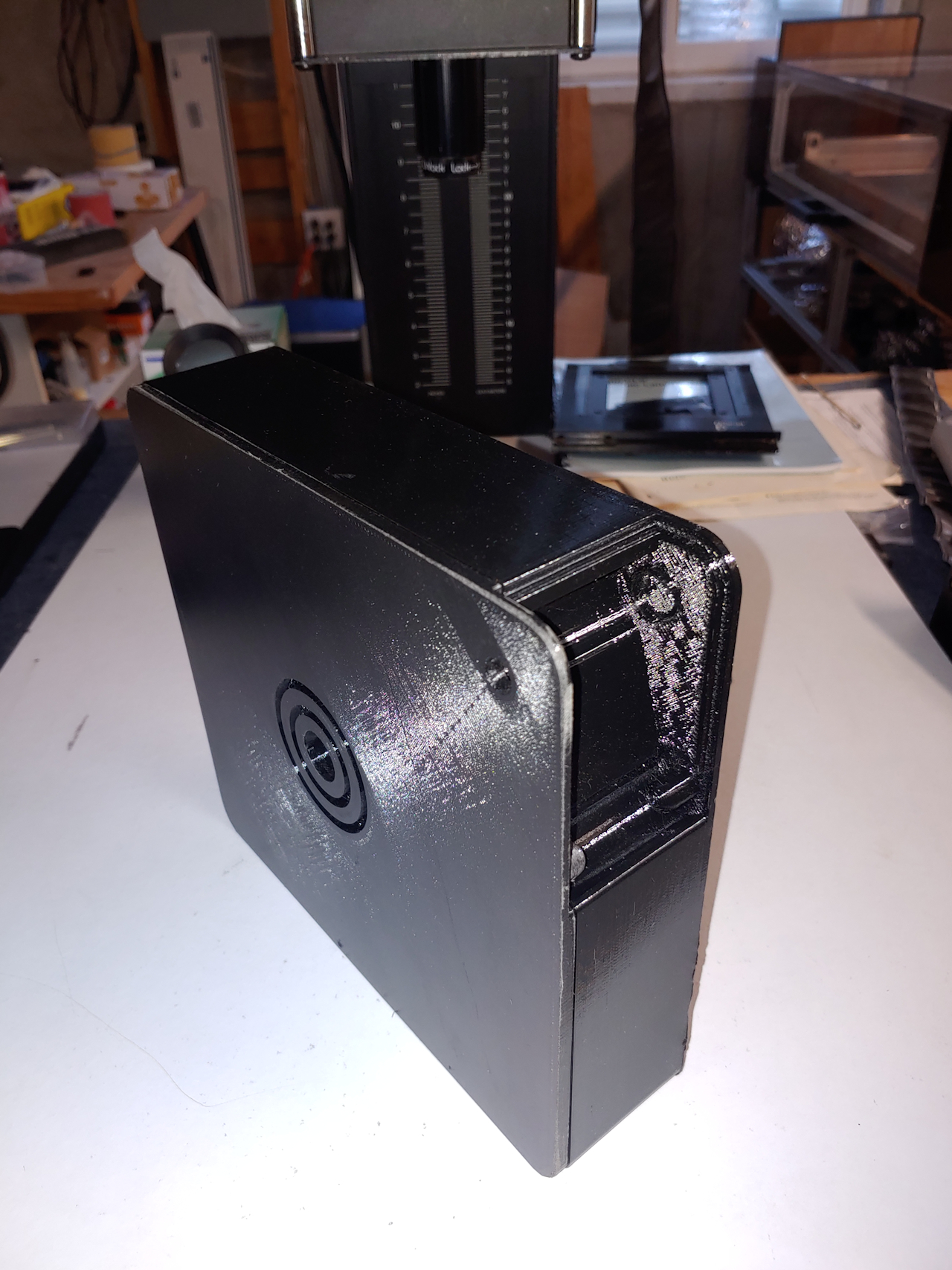

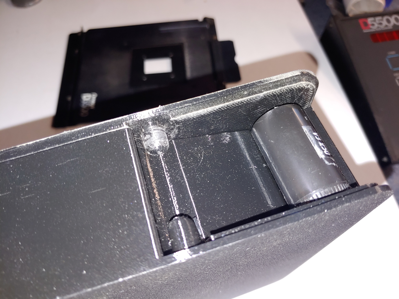

I did one more version, really just the lid. Instead of using the printed "screw" to hold the lid on, I put a flat head screw in each corner. This makes the loader fit in my fridge better. I left the cover open and set it under a bright light for over an hour with some test BW film inside. No light leaks. I have now moved my Vision three into this one and am printing another for the E100D.
Yep. I think I can accommodate a 7 inch film chamber and still fit my 8" build plate, if I draw my own.

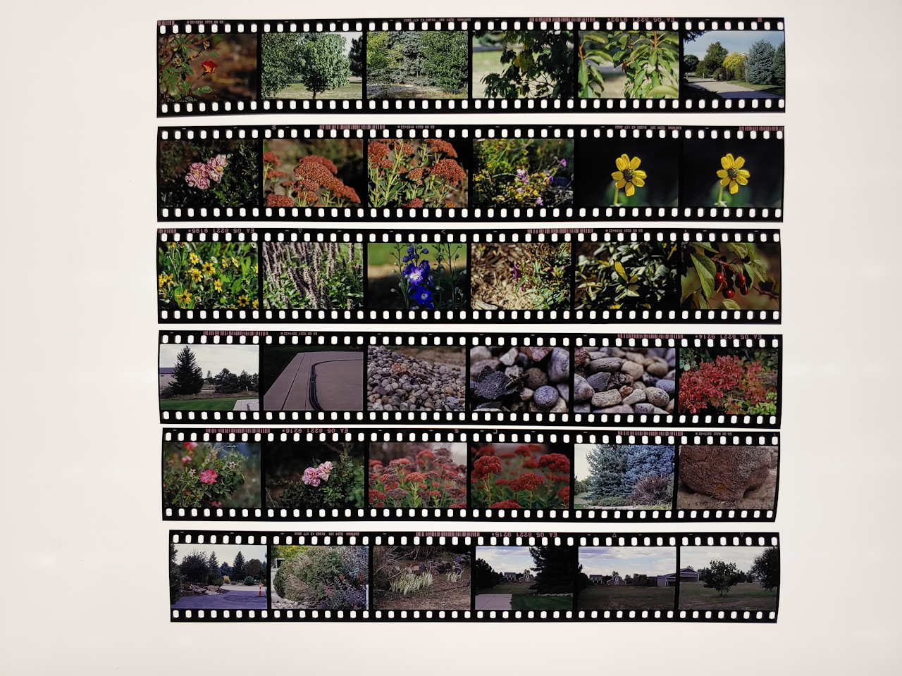

I finally put my 400' roll of E100D in a loader and shot a test roll around my house. Is was fairly dark and gray out when I shot the roll but things still turned out well. Processed in Tetenal 3 bath E6 chems, normal times and temp.
I notice the images are upside down vs the film edge markings, my Vision 3 is the same way. I wonder if Kodak marks movie film different than still film. I could modify the bulk loader to fix that, but then, it probably doesn't matter.
MattKing
Apr 24, 2005
53,505
Delta, BC Canada
Movie film would be exposed with the film at the outside of the roll going through the camera first.
Bulk loaded cassettes end up with the outside of the roll going to the core of the cassette, and therefore being the last exposed frame on the role (in most cameras).
So it would make sense that the edge marking would be different.

I guess another thought is, in a 35mm still camera the image is inline with the film. In a movie camera the image goes across the film. So the edge markings are what they are when in a still camera.
I will stop wasting cycles thinking about it and just be happy I now have a bunch of slide film.
