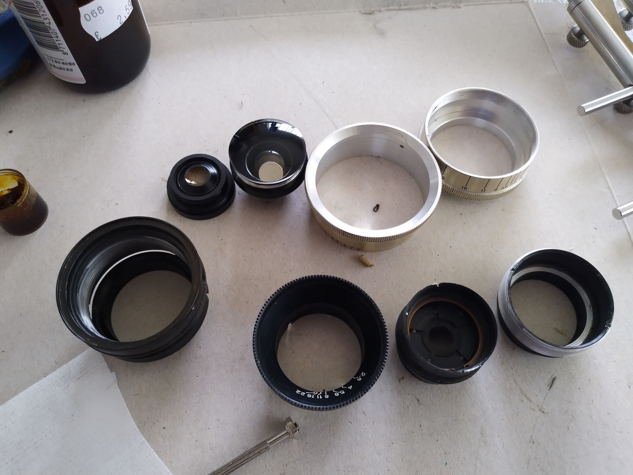

A Kern-Paillard Yvar 75-2.8, actually still at it because I can’t seem to be able to separate the innermost two tubes that enclose the diaphragm. Glass is good, rest of mechanics, too.

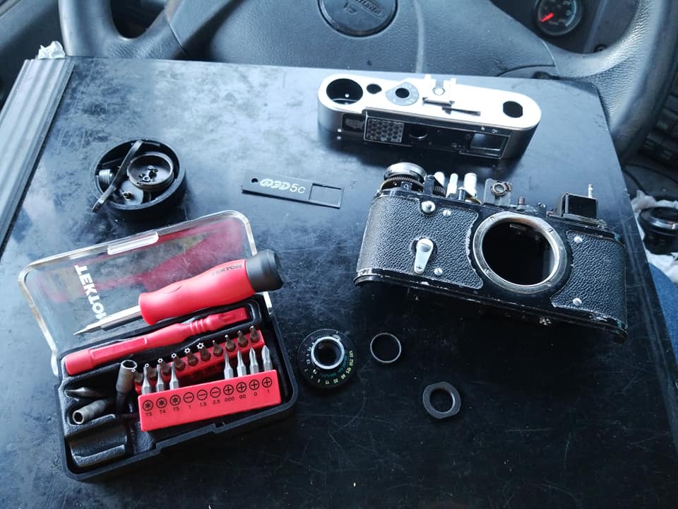

A FED-5c that I've had for a while, and got on here years ago that had all kinds of bad stuff going on. RF was way out of alignment and so was the focus cam when I got it. I fixed that when i received it and shot years on it, then the self-timer got loose and I fixed that.
The ASA dial came loose recently on this old comrade and that required me to remove the top off and re-attach it. Hardest part was actually re-assembling the winder arm but I figured it out. The vertical is slightly out of alignment but I need a special tool for that so I'm going to purchase it.
To date this is the most involved repair outside of a general CLA that I have not only attempted, but did successfully on the first try.

Are you repairing cameras in your vehicle these days? I stand in awe.
Andy
I am, I drive a semi-truck OTR so this is kind of how I kill time between loads, we were on a Tyson chicken load that was late and they were taking too long to load me so I popped the tools out and fixed this old girl, it's doing great now and everything seems to be tight.
Most of my repairs I have done on the truck. Under my seat I also have a pretty serious air blower for blowing out dust, it's therapeutic and gets my mind off of the job
That is just great! I feel like I've done a major thing if I clean a camera from my easy chair rather than desk! I do have a tray (actually a lid from a plastic bin) with a layer of rubber shelf liner on it, that just fits in my lap while I'm in my easy chair. Stick a couple of auto parts metal "part dishes" on it, and I'm both comfortable and fairly stable. I just love the thought of your sitting at a loading dock at some Wal-Mart in flyover country and fixing a Leica Copy rangefinder!
