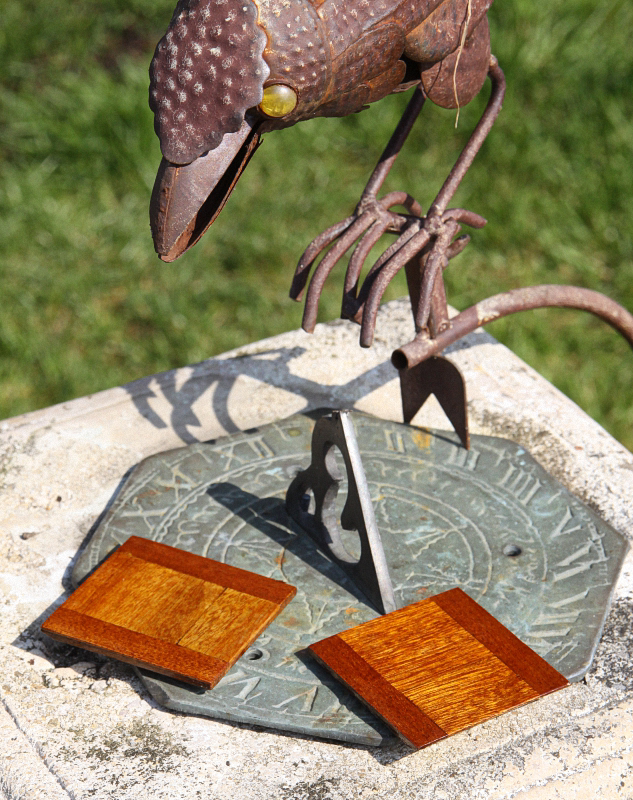

Despite being small there's 6 pieces of wood in each, could be 5 but as I was using offcuts the centre of the top is made up of two rather than one. I'm waiting for more wood to arrive at the moment.

Thanks for posting this outstanding craftsmanship! ...and I know it is quite laboursom too.
May I ask which procedure you follow for the french polish and which polish you're using....
Ron, I make up my own French polish, I buy flaked shellac, three different colours and dissolve in either Methylated Spirits or Isopropyl alcohol. I only but Methylated spirits when the dye has faded, or I'll leave in direct sunlight for a few months alternately I repeatedly filter through old water softening cartridges that does remove most of the dye. IPA was cheaper until the current virus outbreak. I seal the wood with shellac based sealer.

I see...well methylated spirit here has a blue shine, so I would only use the alcohol. Did you ever try dewaxed blond shellac - guess it has less color left in it?
For sealer I use eggwhite, making a slur with wood shavings when fine sanding.
Yes Methylated spirit has a Blue-Purple dye added in most countries, this will fade in the sun. Filtering though activated charcoal is a good efficient way to remove the dye but I just look for simple and what's on hand :D
Yes I do use De-waxed Blonde Shellac, as well as Lemon, Button, and Garnet. sometimes you need to add Tumeric aor Dragon's blood. Tumeric is added to shellac for varnishing brass work. Dragon's blood is a red resin pigment made from plants, it's added to shellac to give a reddish finish. I've partially restored a Butcher Whole plate camera that had an opaque distinctly reddish finish, it's just waiting for bellows, and has been for about 3 or 4 years. I used Inkjet pigments to get the right colour match and it worked well, I should buy some Dragon's blood though :smile:
Ian
Thanks for the extensive insight. I'm just going to finish a self made (5 piece) lensboard for a Perken, Son & Rayment camera which I'll use a transparent finish for - although even with that finish I'm afraid the wood will still be darker than the rest of the camera :-(
