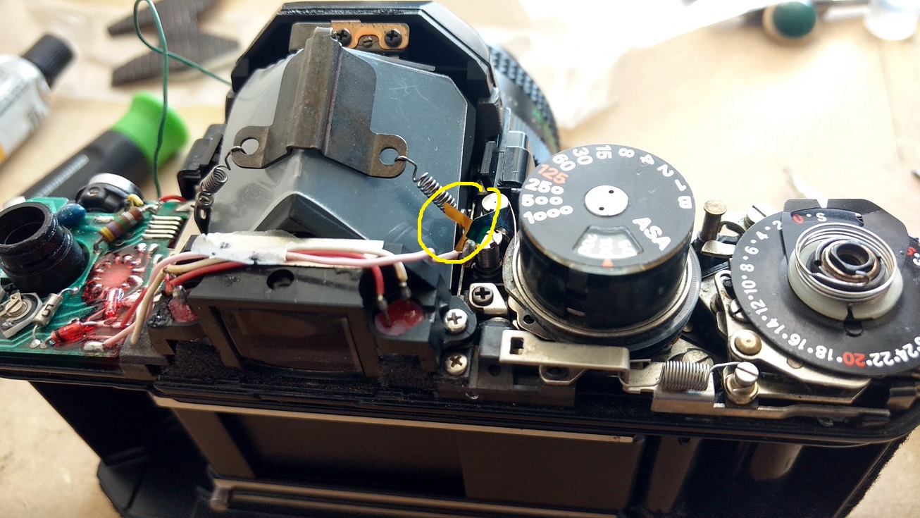

My Nikon FM had issue with film counter stays at 'S' even though the film door was closed. So I remove the top plate and found a small lever arm was lazy to return and failed to catch the gear on the film counter dial. I put some naphta and it didn't work so I put lubricant and now it works normally.
But now another problem appears, the light meter is inconsistent and when it works it seems to show 4 stops under. I tried to play with speed dial and ISO but didn't fix it. Any idea what could be the problem?
I also notice a small thing that looks like flexible PCB hanging free (see circle in picture) is this supposed to attached to somewhere?
