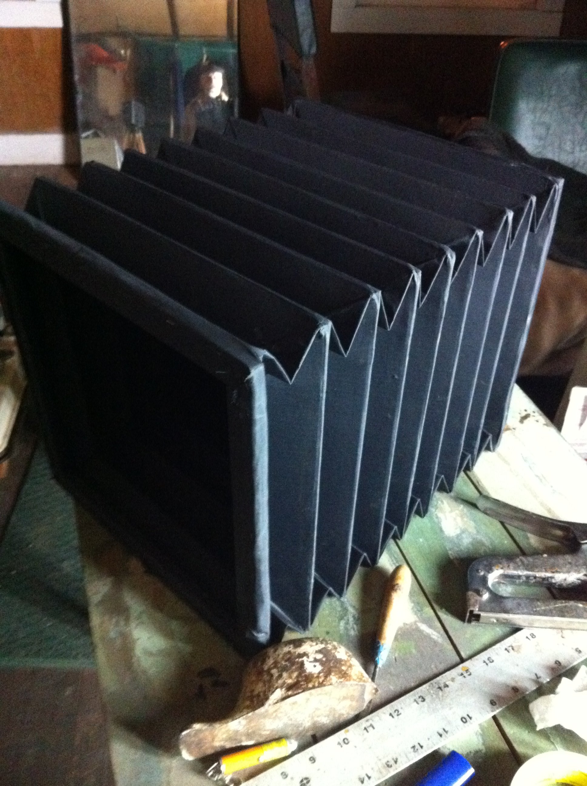

Made two camera bellows

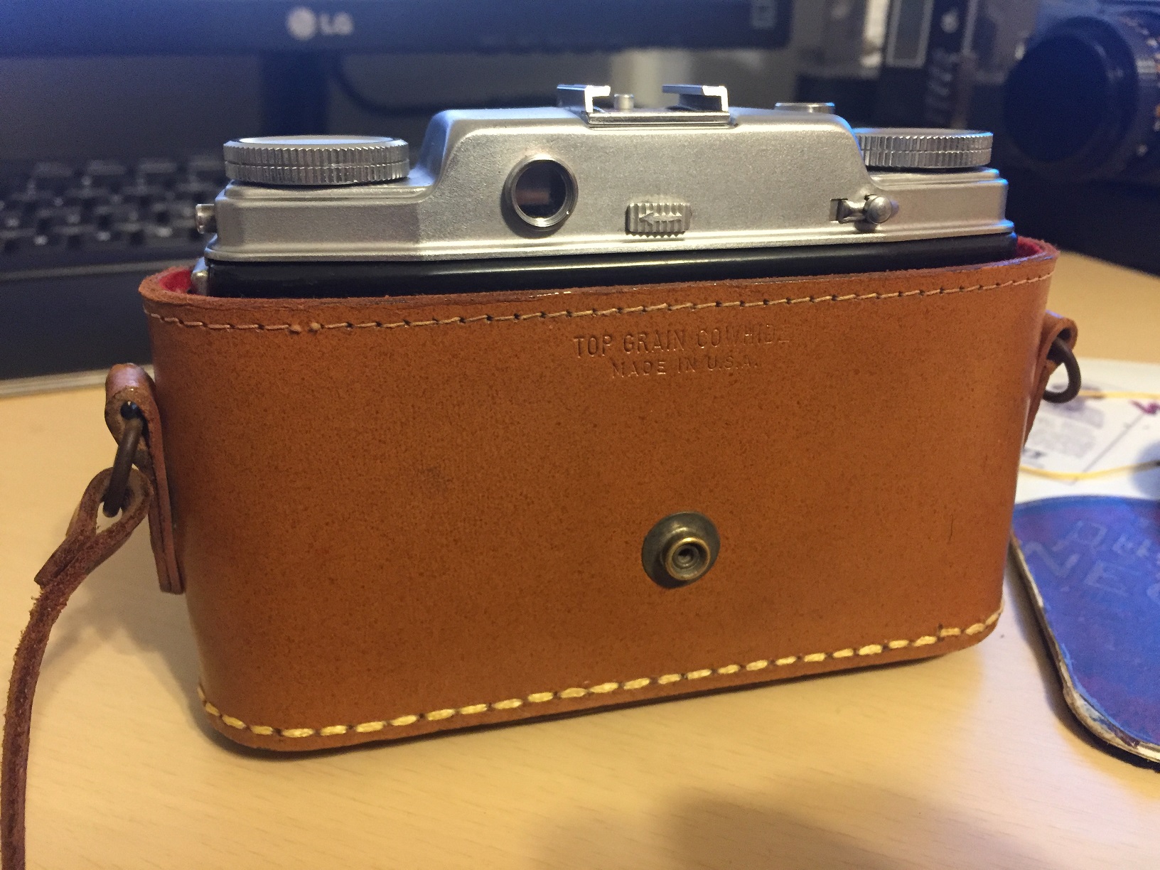

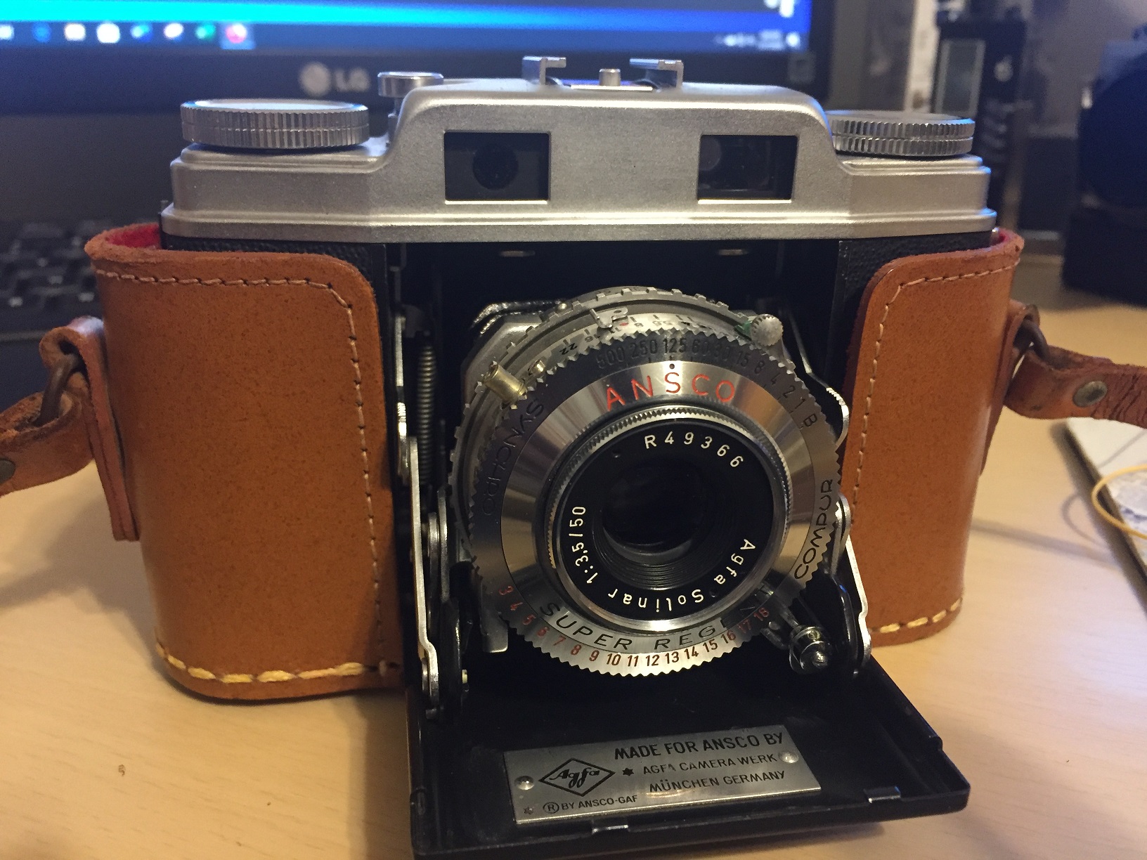

Restitched the bottom to the leather case of my Ansco Super Regent. Now I know why the lining is red; to hide the blood...
I know your pain!

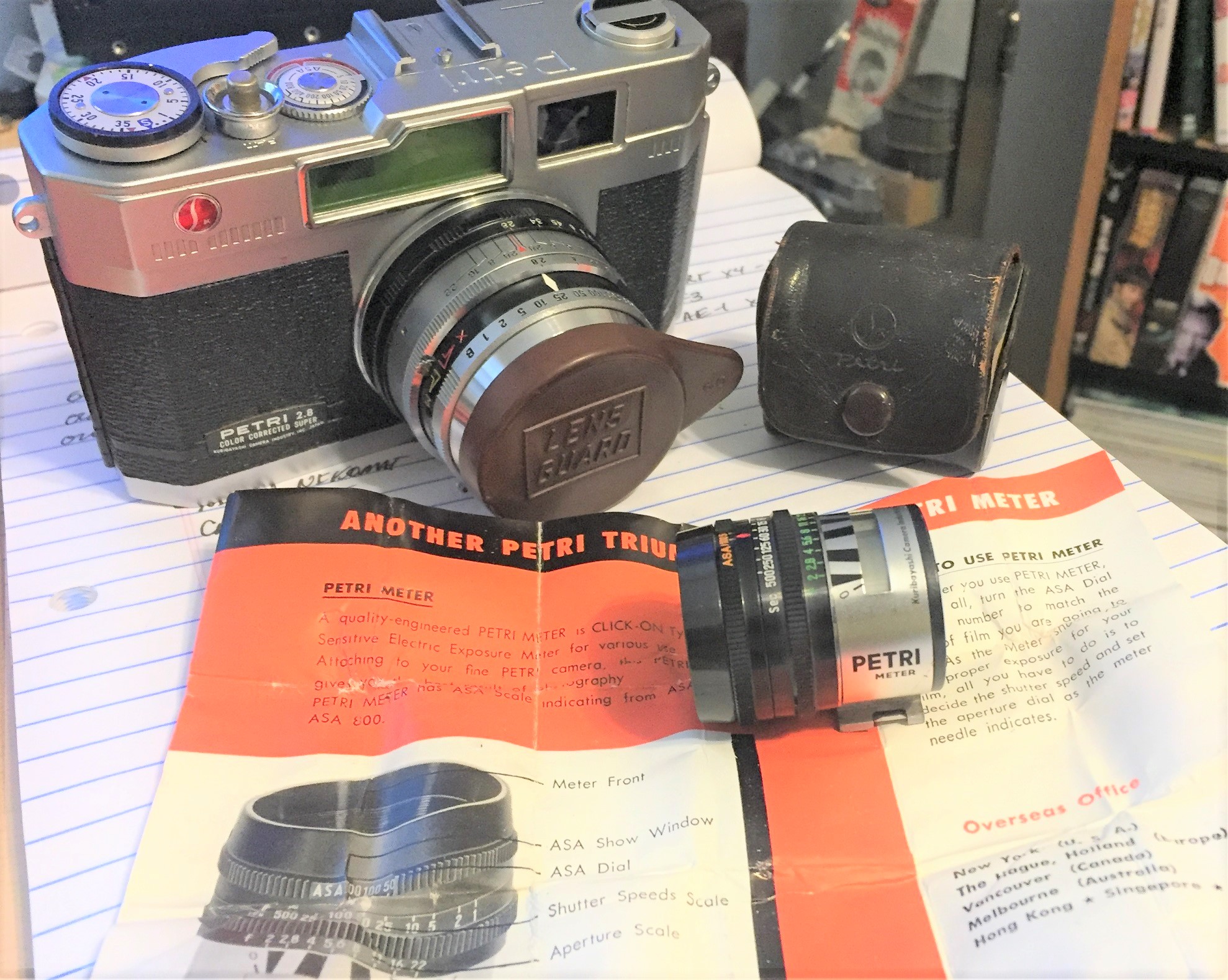

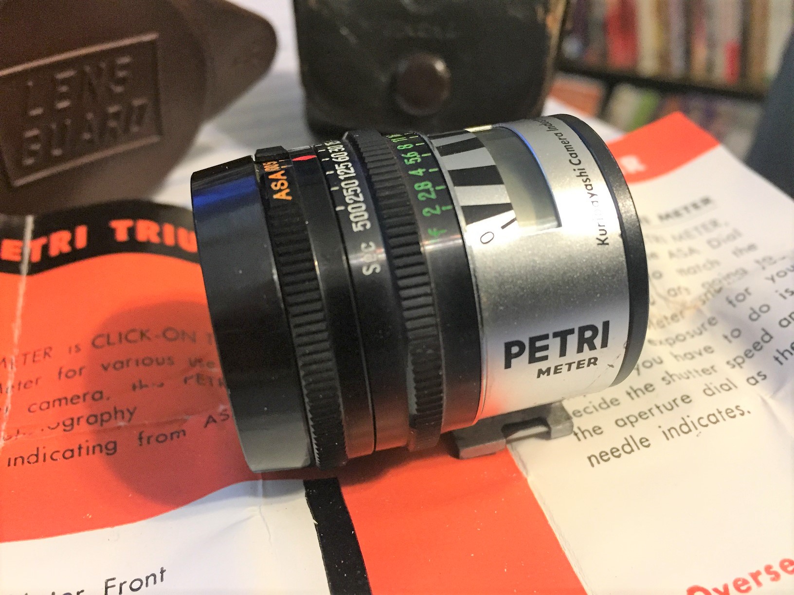

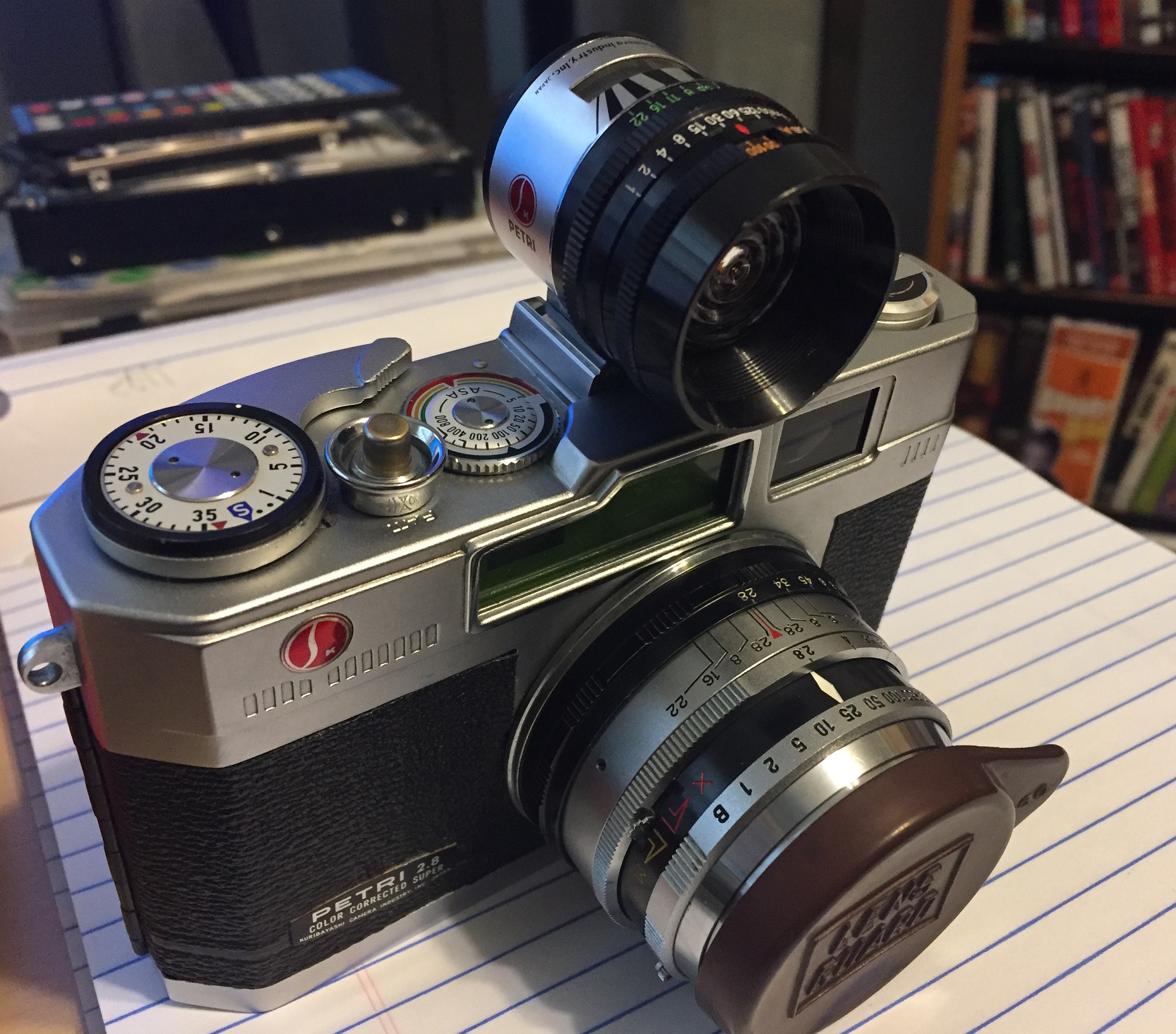

Got a non-functional Petri clip-on light meter for my Petri display and managed to get it working again by dismantling it and putting the movement back into the pivot point. The meter now deflects, but I am sure it is not accurate, but I don't really care as it is for display, as is the Petri Color Correct Super 2.8 that it will reside upon. The rangefinder has a detached film advance and heavy deposits on the rear element, but I have several other functioning Petri Color Correct Rangefinders of the same era, so I'll just let it look pretty in my display case...

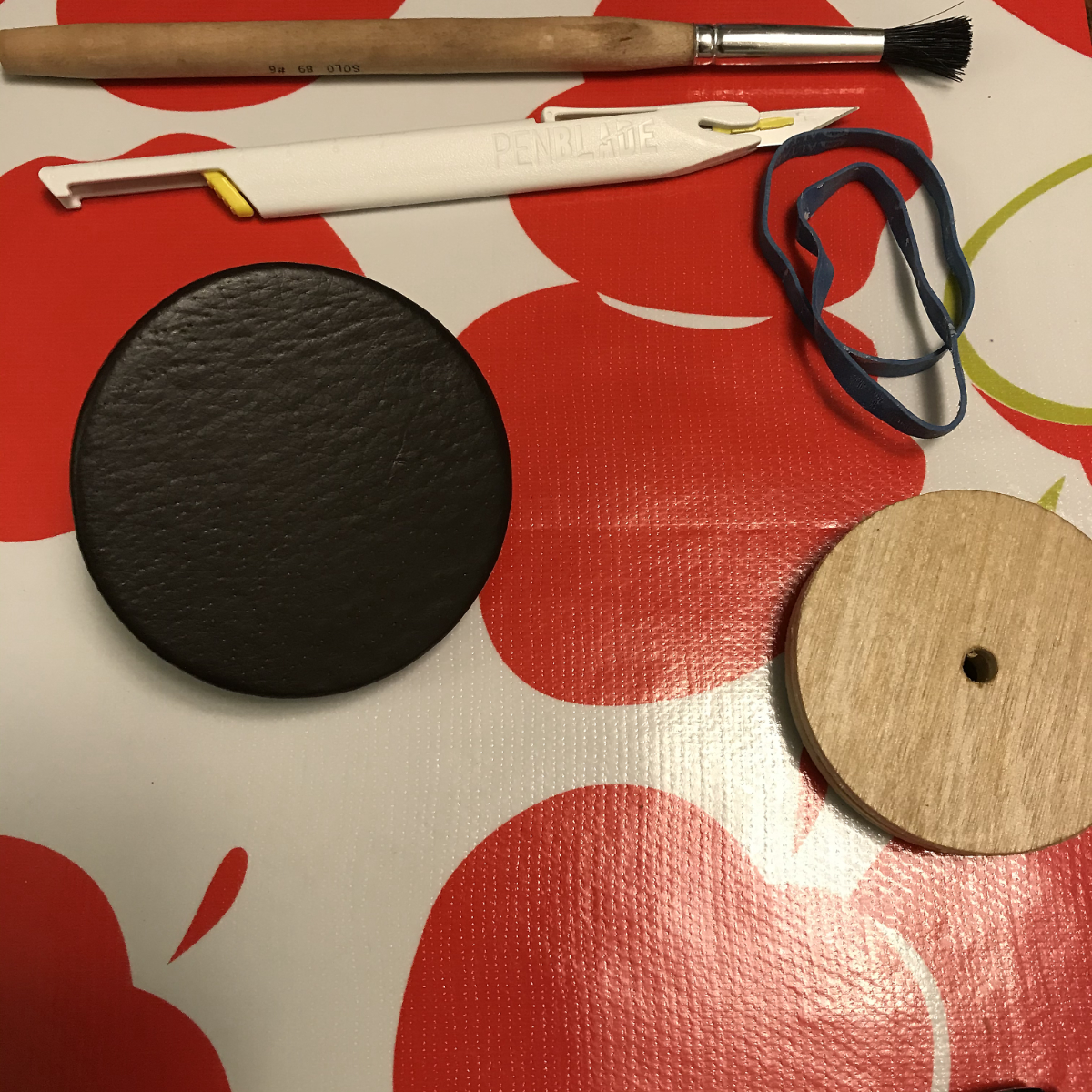

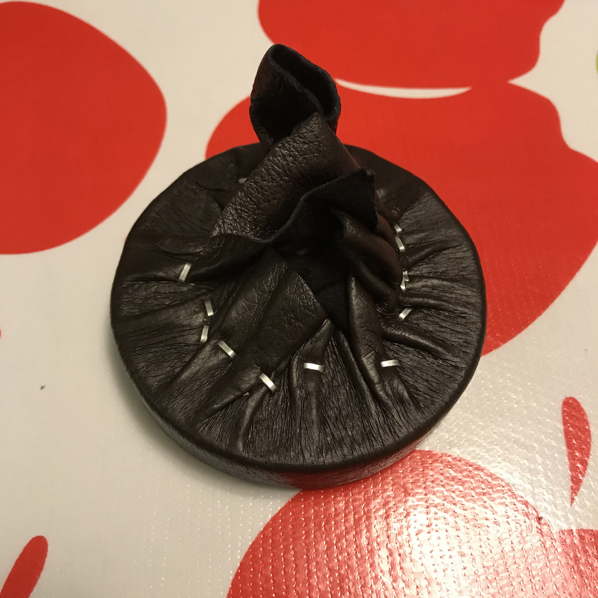

Haven’t fixed anything today, but I am almost done with my first leather lens cap, which will also serve as a shutter. The is for a nice 270mm Schneider Xenar in a black enamel brass barrel. I think my leather is a little thick but it should work. I do have a thinner piece of leather coming from Italy for my next attempt. I'm waiting for the glue to dry, which will take awhile because I soaked the leather in water for an hour before stretching it in the cardboard cap. Just have to be patient. I should have it finished tomorrow.
