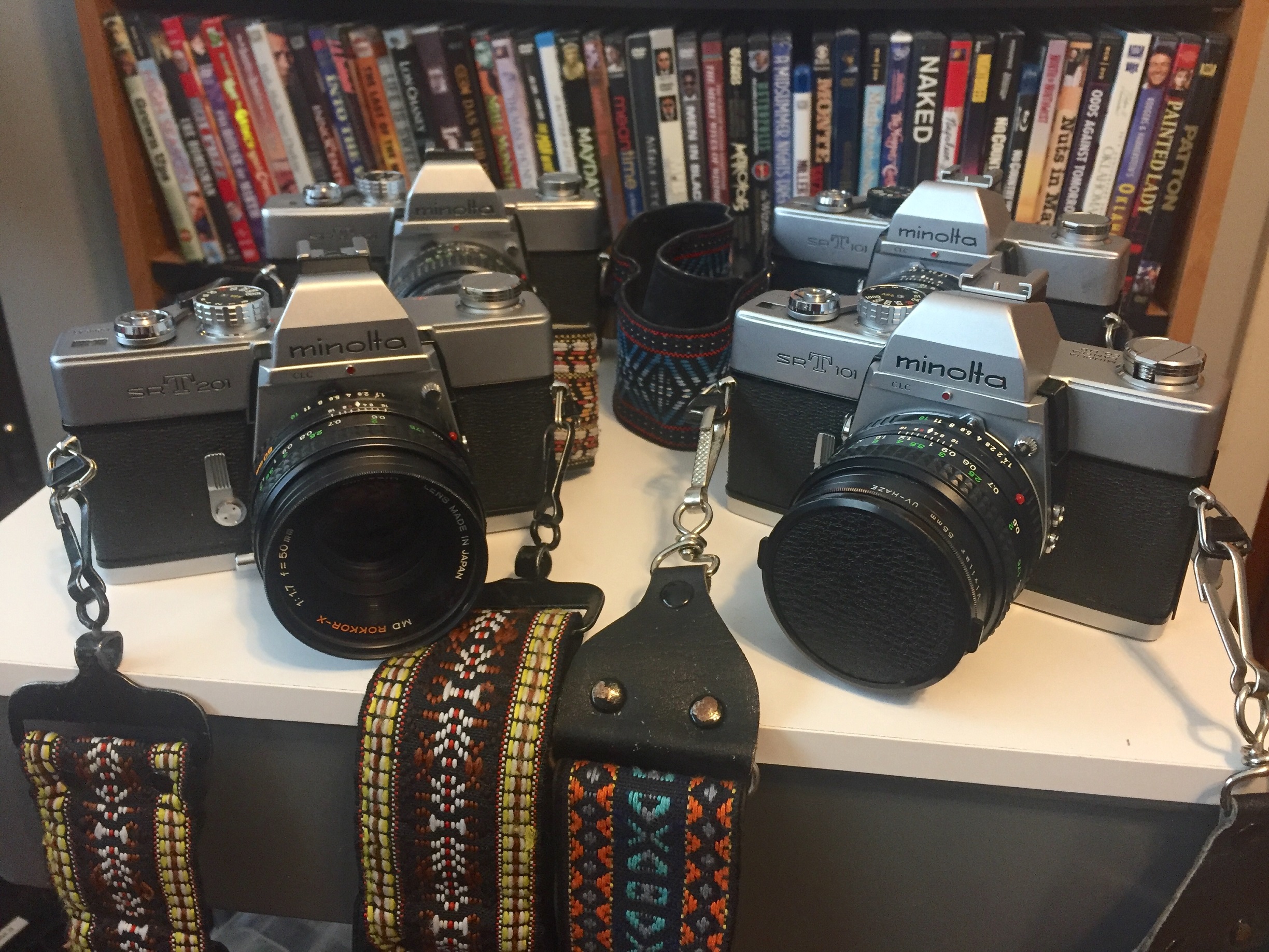

My son in college has finally expressed an interest in film photography; him and 3 friends, so with the assistance of Jon Goodman's superb refoaming kits and a bit of cleaning and digging through parts drawers, I am now shipping 4 Minolta SRTs (2 x 101s and 2 x 201s) to them. Just waiting for 4 x Wein cells to show up before I ship.
It's nice to put these cameras in the hands of newbies, if only to keep interest in Film alive.

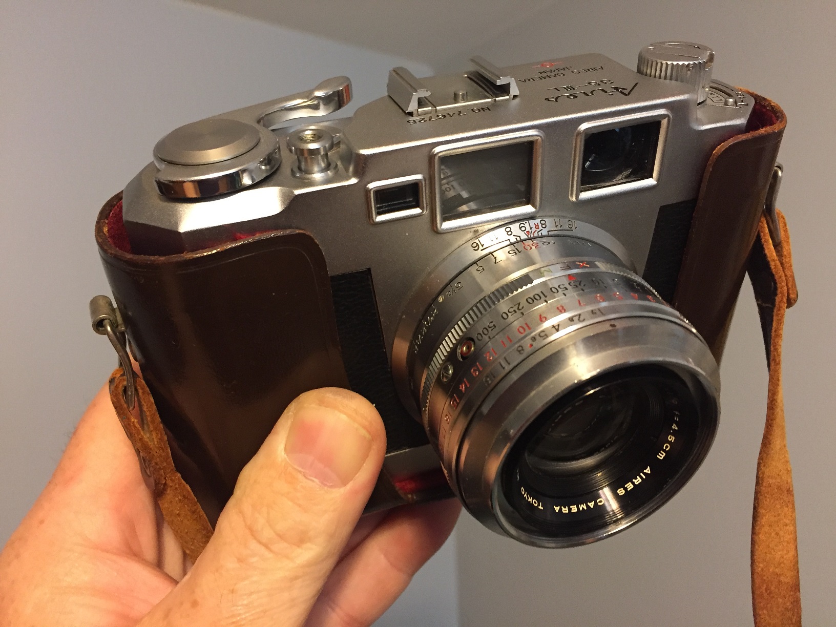

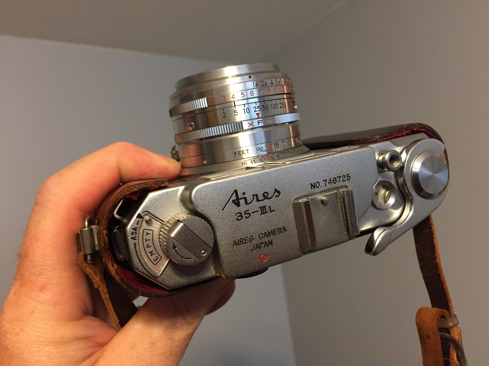

An Aires 35-IIIL I ordered for a friend's Christmas gift came in today, so I pulled the lens, cleaned the shutter and optics, polished it up and it's good to go! Love these cameras..

Best looking example I've ever seen. Your friend is lucky!
Most of the examples I've seen have a lot of corrosion on the metal finishes.
Andy
Andy
Even better than it only cost $15...

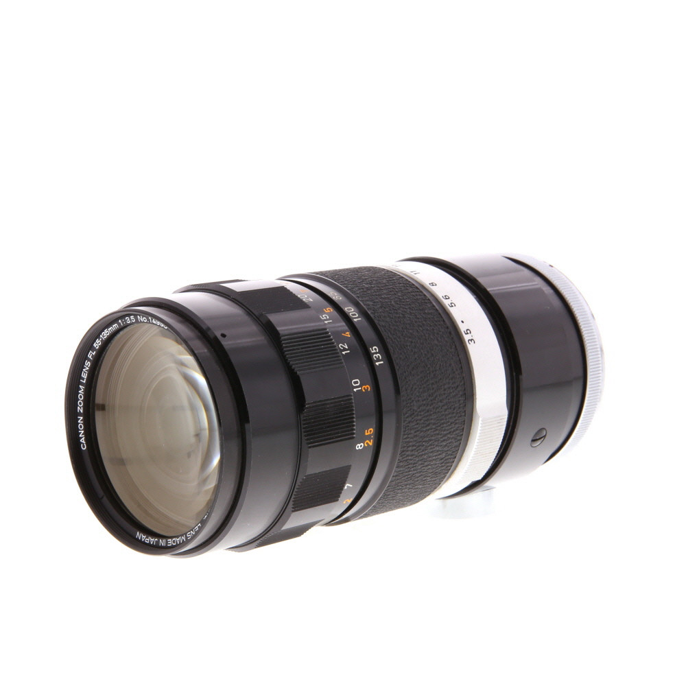

Bought a "AS-IS' Canon 55-135 f3.5 FL lens from KEH for $6 and when it arrived, it was in near mint condition other than the front lens barrel being loose.
Spun off the front elements, located the screws that couple the front focus barrel to the rear assembly and had to spend about 15 minutes playing with just how much to tighten these screws before I had a really nice working example of this early Canon lens in FL mount.
I found that if you tighten these 6 screws fully, the helicol and zoom lock entirely and will not operate. I had to back them off to a really loose state and then apply some flexible glue to the heads to lock them in place, but after drying it works fine.
The focus helicoil was pretty dry, but luckily enough of it is exposed behind the front elements to apply a small amount of helicoil grease, which smoothed-out the focus ring.
It's a pretty impressive lens. Should be fun to shoot.
