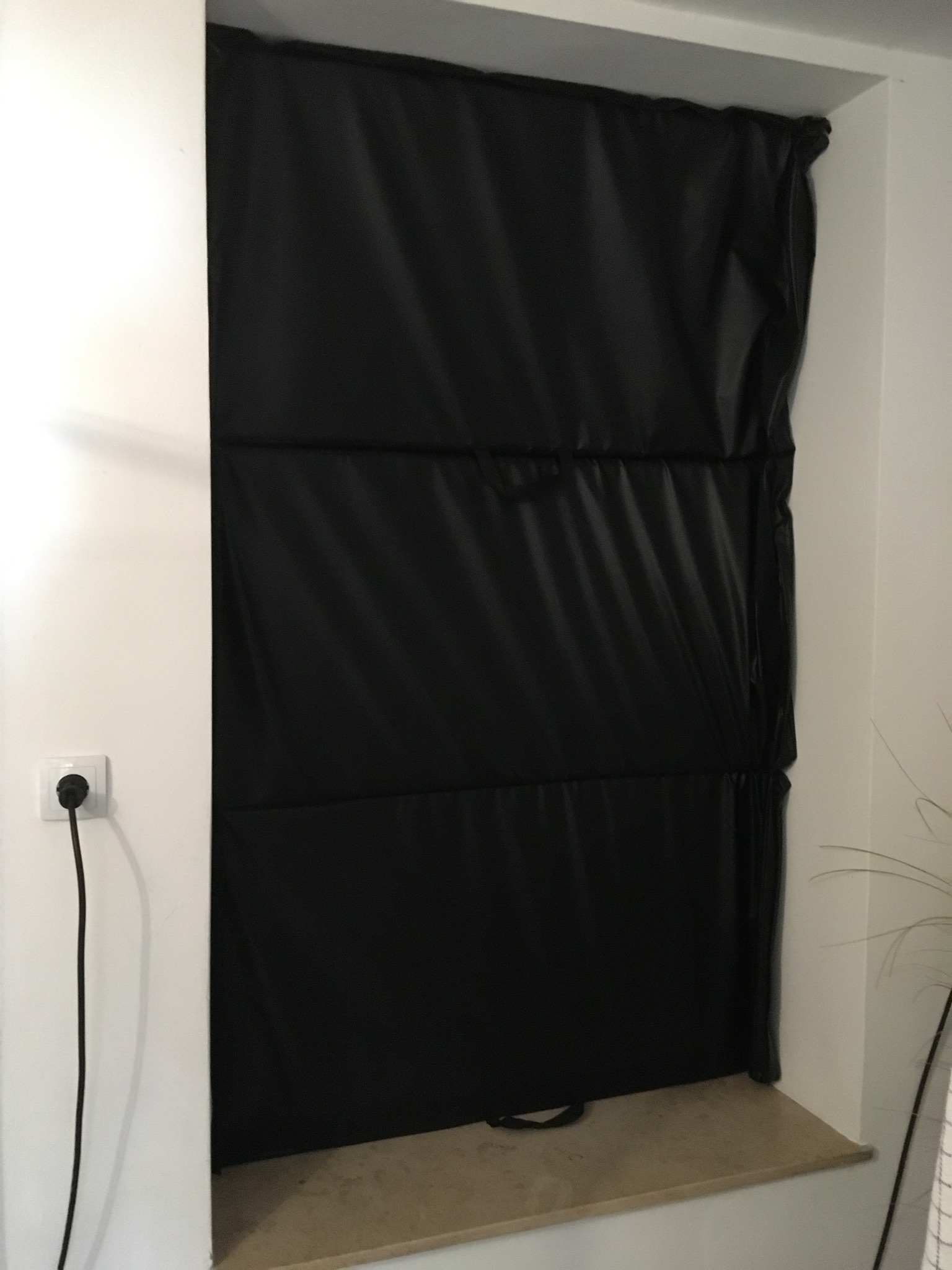

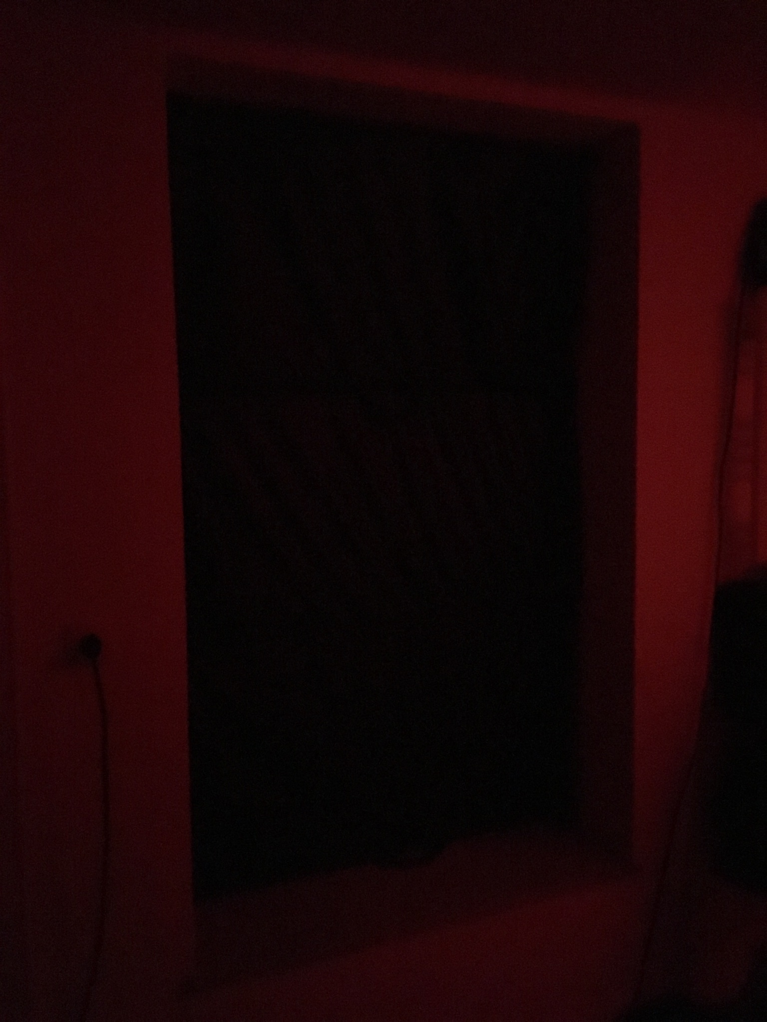

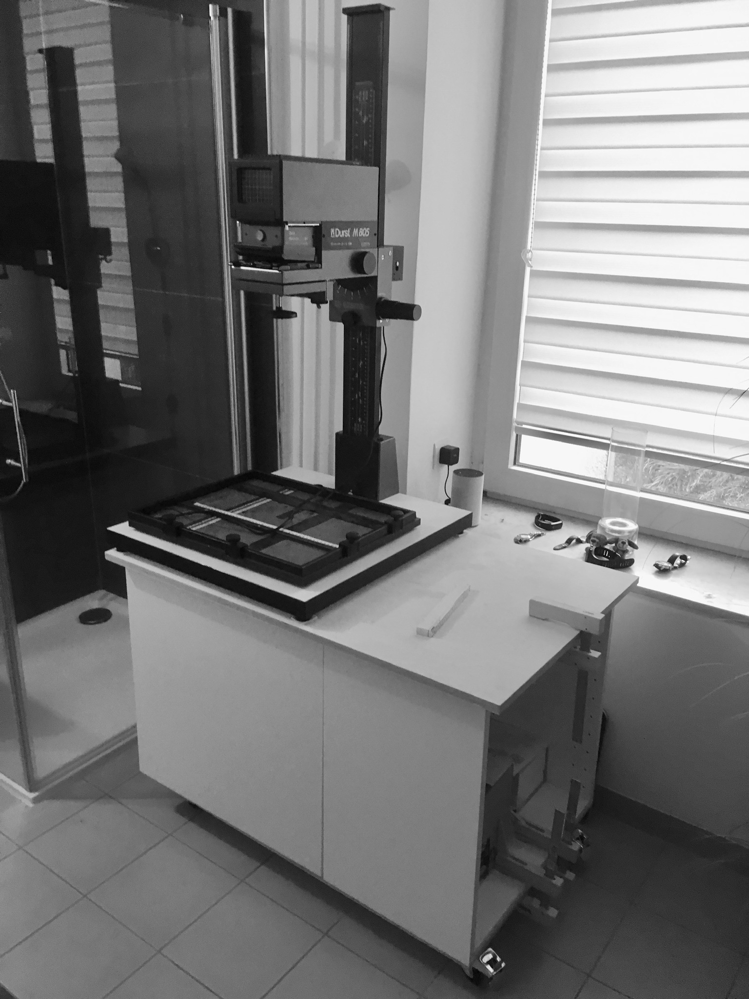

Yesterday I got an exercising mat that I cut to press-fit in the window reveal. Hooked up my darkroom lights temporarily, seems it works out fine. Looking forward for the first print made at home.
2E100E78-7DF4-46F3-A9AC-BF4BC41B023A.jpeg 8A43C23A-2362-40CB-B6F1-986E05F52BEC.jpeg C862CDE5-9532-43FD-8F38-F7CDCDB1E4AB.jpeg

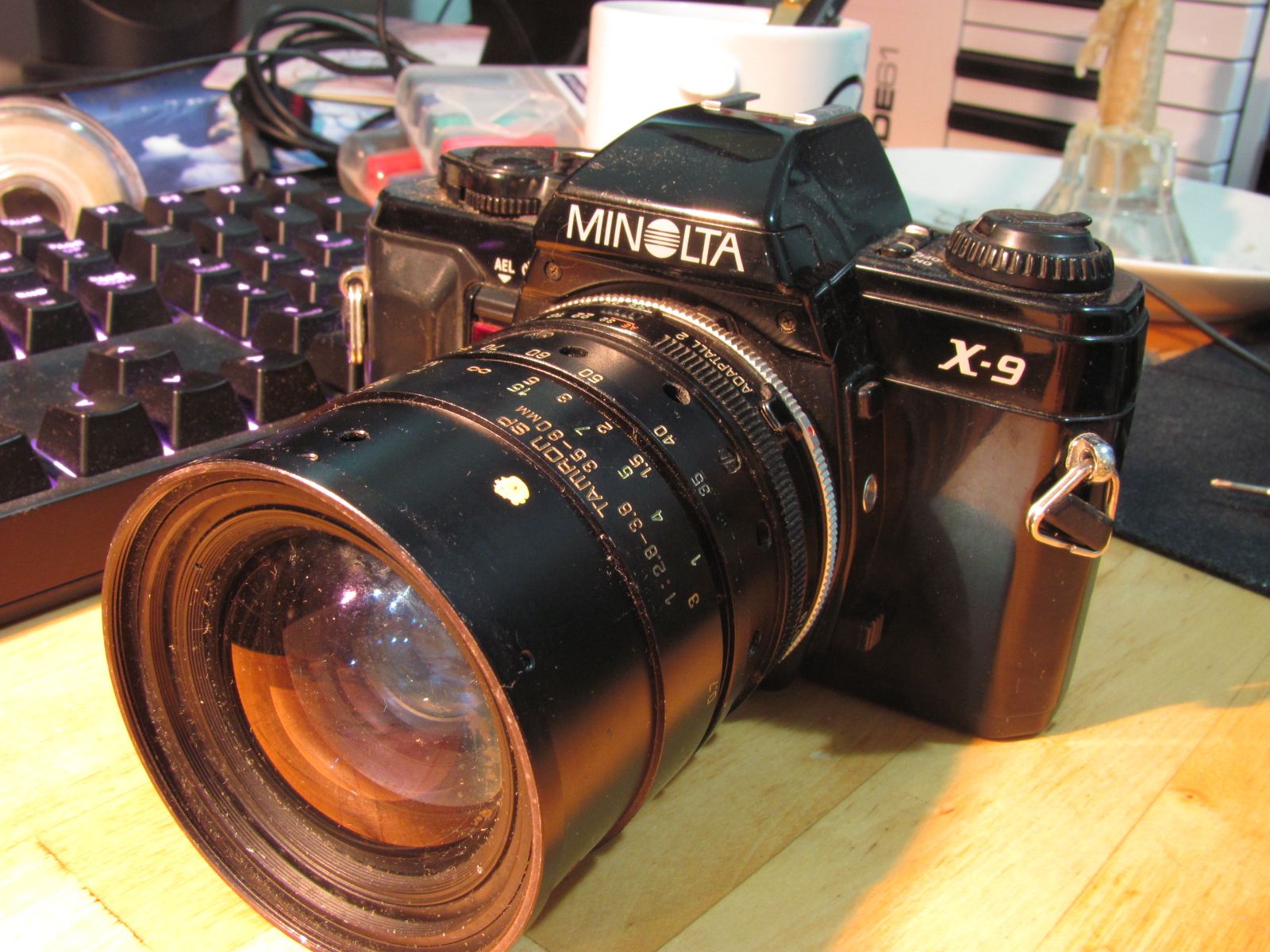

More interestingly, the other day I did the capacitor fix on this Minolta X-9. I had to learn how to solder to do this, and when I first tested it with batteries from my Minolta XE-5 it didn't work at all. I thought I'd fried it. Then I remembered that I had some spare fresh batteries and put those in - shutter works, winder winds, all good. This is the first camera that I have resurrected from a non-working state rather than just improving its function, so even though it's a relatively basic fix I'm pretty pleased.
(That lens is a project for another time. This camera and two Tamron lenses came to me from a shed and they kind of look like it.)

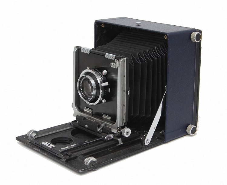

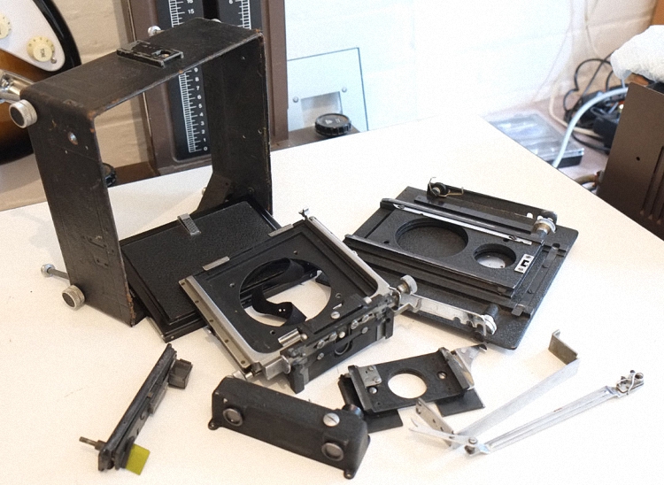

Back in 2016 I bought an MPP MicroTechnical MkIII this is a British camera based on the WWII Linhof Technika, it was cheap £70 and came with most of a second camera.
The bits sat in a box until Tuesday afternoon. I decided to firts re-cover the body in a dark blue material.
Then I re-assembled it making the missing track linkages. I still need to fit the fittings for the carrying strap but as one's missing will wait until I find or make something. I decided not to refit the Range-finder as I never use them. There's also a finder sight to repaint and fit on the top but I don't have the optional wire finder.
The restored MkIII, the original MkIII, and a MkVII.
Ian

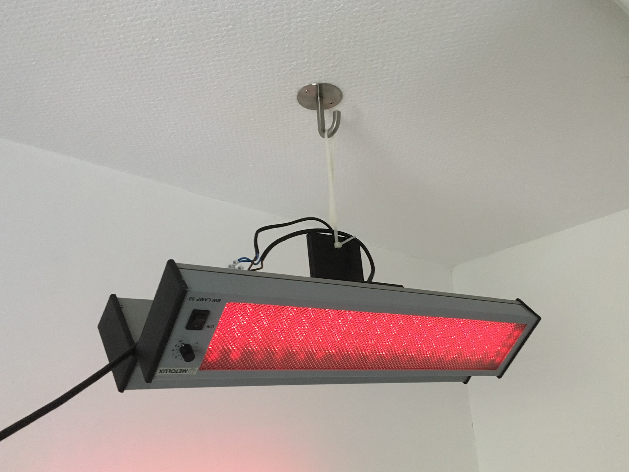

I modded my Rayco timer to power a safelight and turn it off when the enlarger is on.

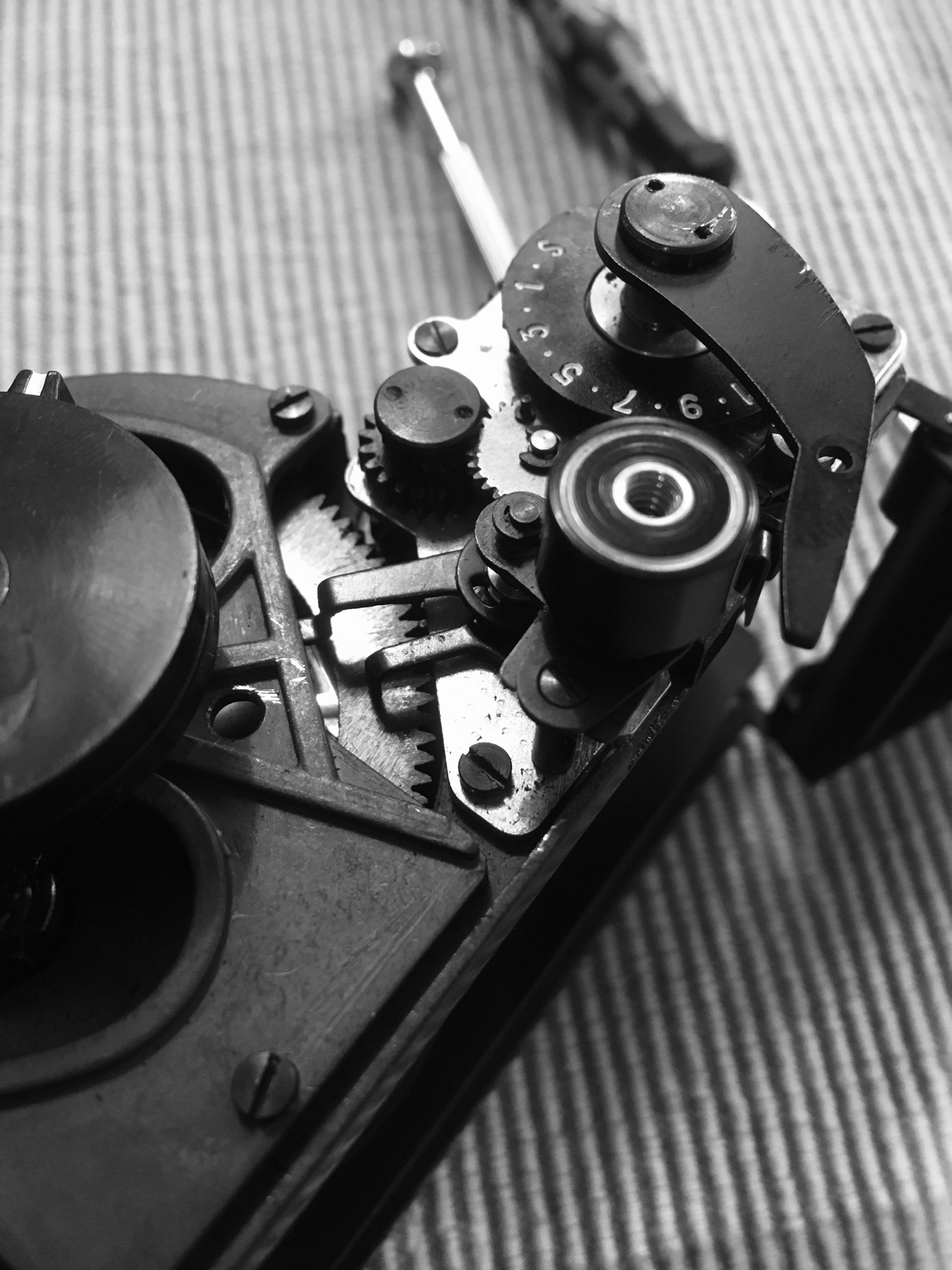

Hi guys, I’m currently trying to fix an Instamatic 714 which fires only at 1/30 f/2.8. I was thrilled when I received it because it looked very clean but soon found out that the battery power was going nowhere. I figured there was probably corrosion/verdigris somewhere, and I was right. Now I’m stuck because the part bellow looks pretty much done... any advice would be welcomed.
This looks like a potentiometer. It also appears one lead is detached. You could probably hit it with some detoxit or other aerosol electronics cleaner and re-soldier it back in place.
When you clean it, be sure to note it's position (the dimple in the metal band that runs around the edge of the resistance band) and return it to the same position.
Worth a shot...
Worth a shot...
Thanks for the reply. As I started to brush off the layer of calcium & verdigris, the part with the metal band fell off (Aaaah!). The good news is that I was able to disassemble the rest and clean all the parts. I was expecting that thing to be corroded and brittle, but the metal is still good. There’s hope.
