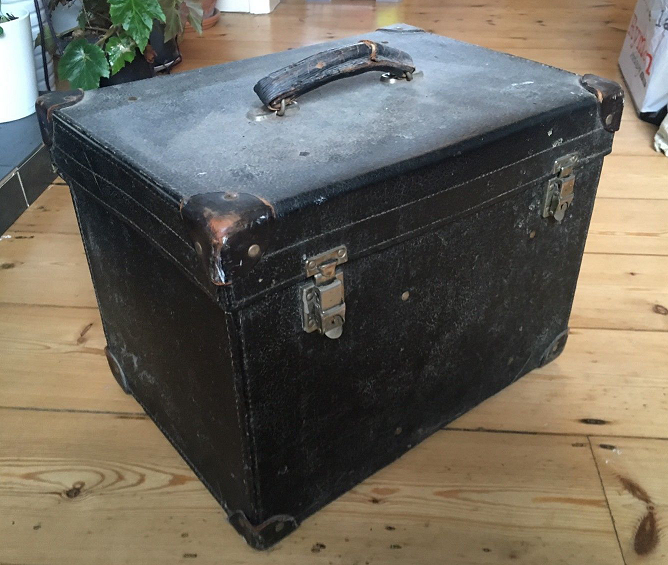

Sewed up the case of my Yashicamat 124, not a perfect job as it's not leather rather some king of compressed cardboard type material.
Then much more successfully and far neater I sewed up the top edges of the case of my Half Plate Kodak Specialist II View camera.
The case's handle is an issue but with quite a bit of Super glue I've made it solid and functional again/ The case itself has has a coat of black acrylic paint so looks smart again :D
