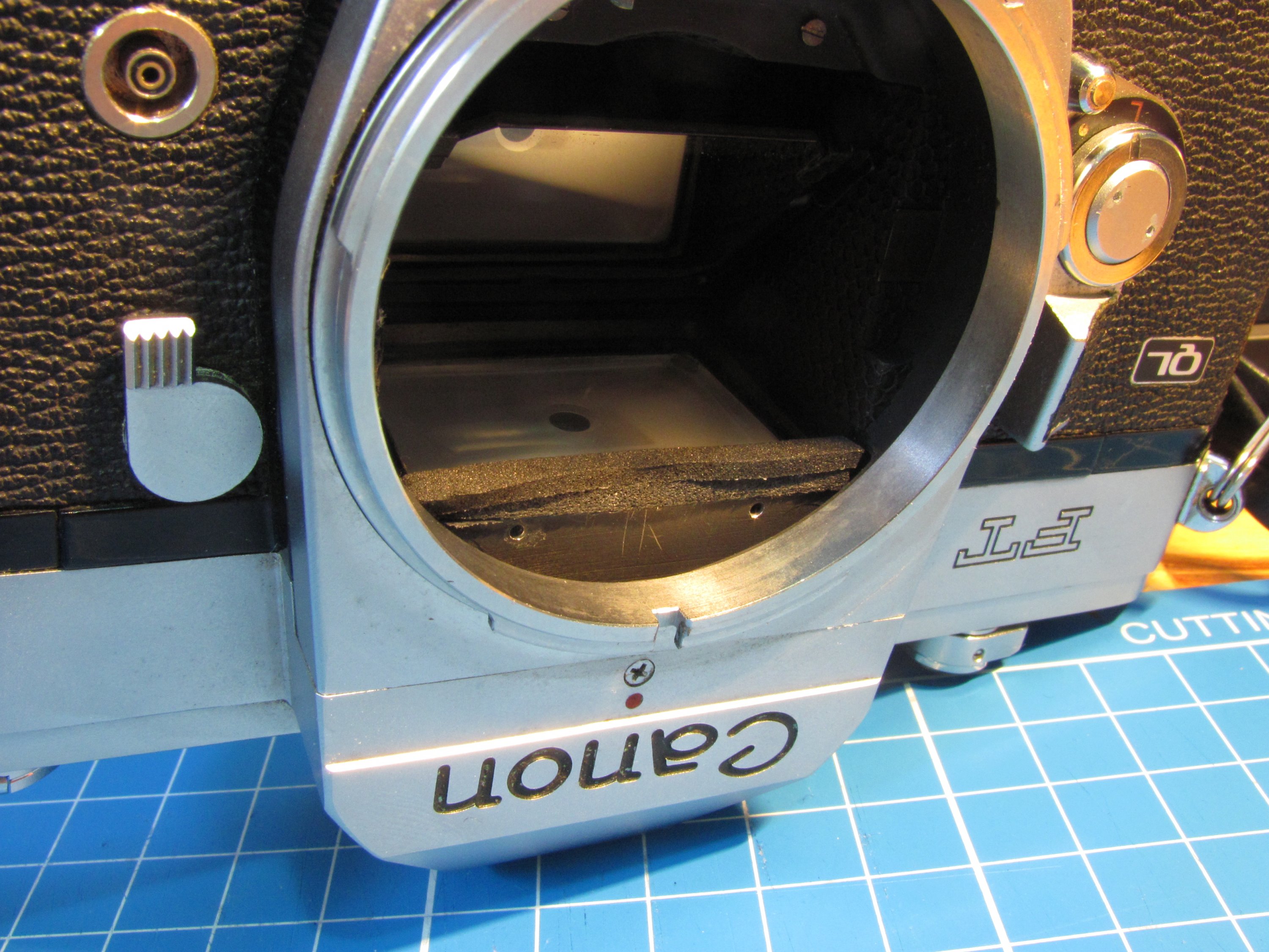

Yesterday/today I replaced the mirror damper on my Canon FT QL.
I wish I'd taken a before shot. The damper foam was so degraded it wasn't sticky, just dry and crumbly, and mostly crumbled away. I honestly thought it had been taken out in a service decades ago and not replaced.
After:
I've used a hand-cut piece of 2mm craft foam, glued in with PVA. It's quite rough to be honest (forgot to use a ruler), but the mirror contacts foam instead of bare metal so that's an improvement. I'm not quite sure it's thick enough, but anything's better than nothing. It also seems a little quieter, but I'm almost certain that's just my ears playing tricks.

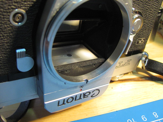

I put in another layer of foam, because it wasn't quite stopping contact with the focusing screen frame.
If anyone who's fixed a mirror damper on a Canon FT thinks this looks too thick, let me know. I have never seen the original in place and in one piece, so I've nothing to go off.
(also, contrary to how it looks in this photo, it is actually flat)

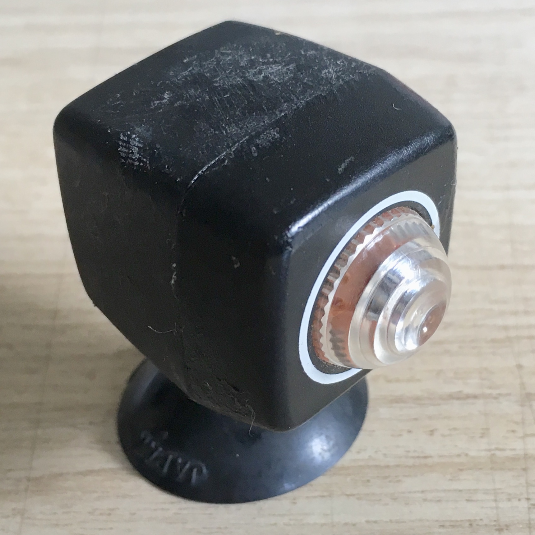

Found an old optical slave in a drawer a couple of weeks ago. Tested it immediately and it didn’t work. Tossed it in the “photo paraphernalia drawer”.
Today, I took a deep breath, cracked it open and found out it was just a broken wire (at its solder joint). Resoldered and tested it... working as good as new!

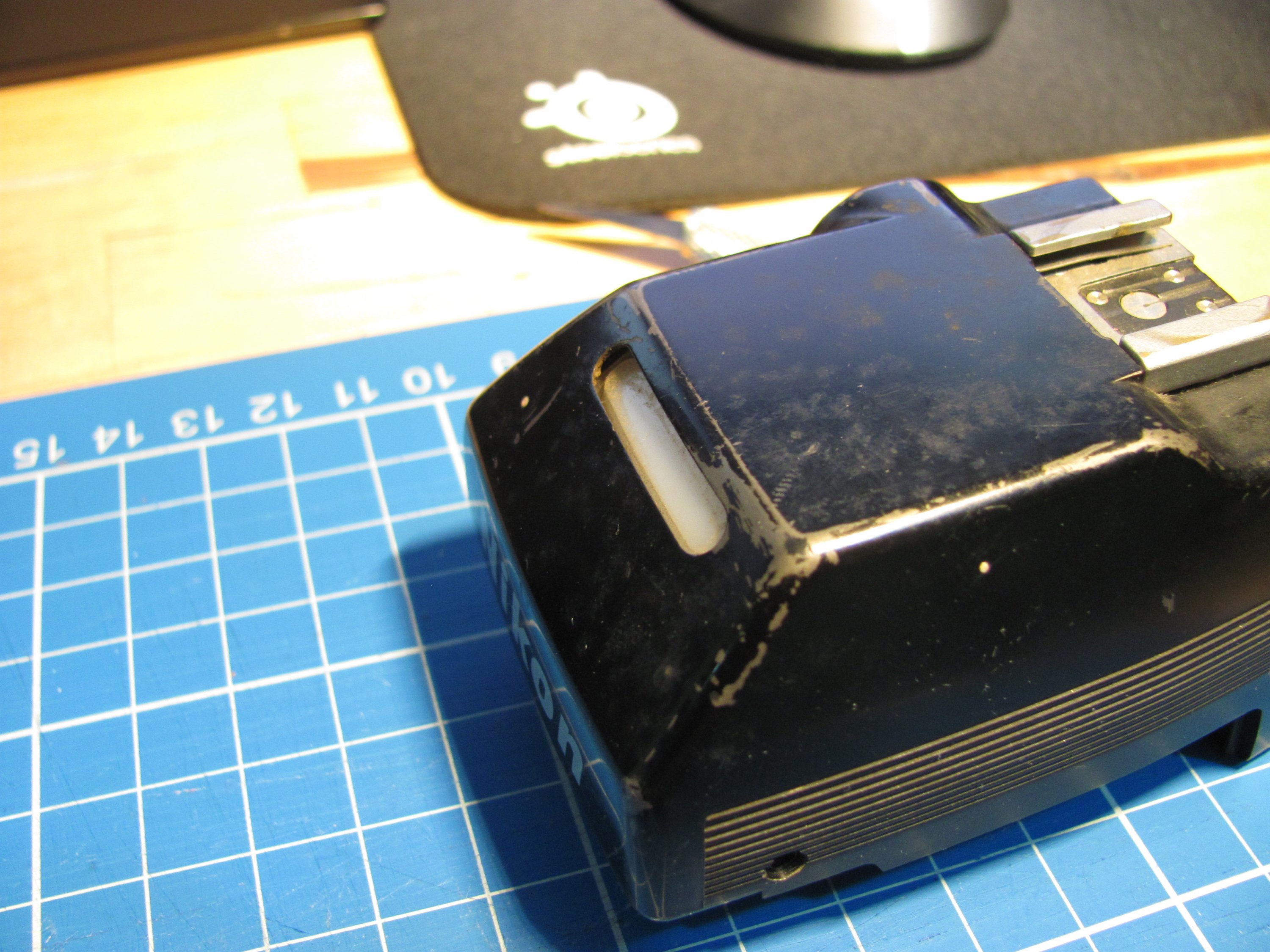

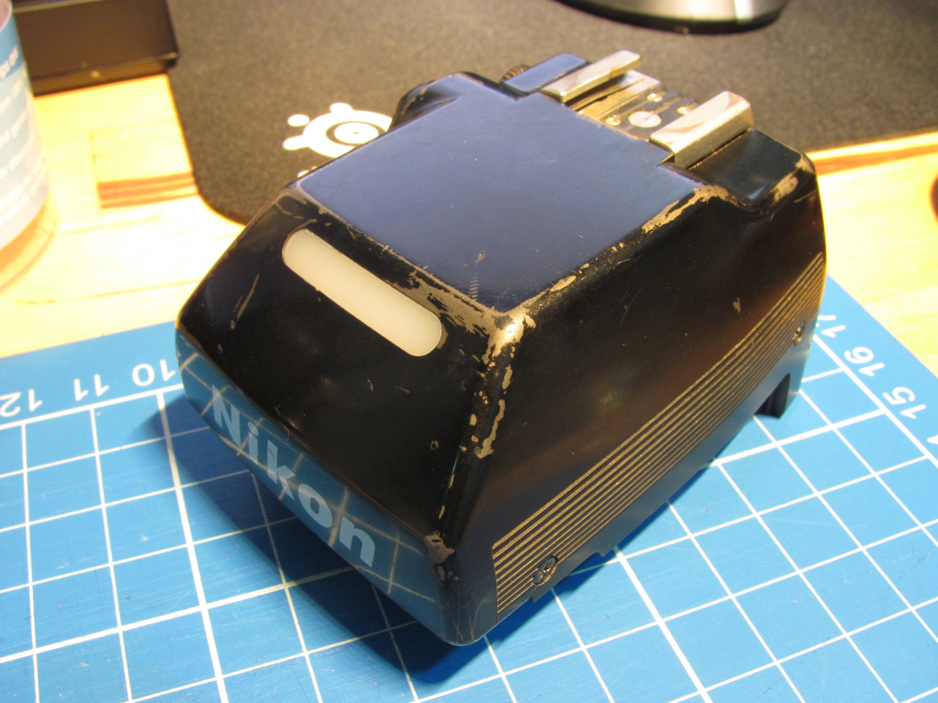

Today I reattached the translucent window on the front of a Nikon DP-20 viewfinder (for the F4) which had come adrift. I also gave the finder a bit of a clean.
Before:
After:
(Let's be honest, this one's never going to be pristine.)
I also cleaned the red stripe on the F4's grip. Q-tips and small dabs of water. It actually looks red now, which I didn't think would be possible. You do not want to see the Q-tips. Interestingly, though, there's a tiny crack running right the way along the red stripe that I only noticed post-clean, but my work log photos show was there before as well. I suppose it's a natural weak point in the rubber grip, but I was surprised nonetheless.
