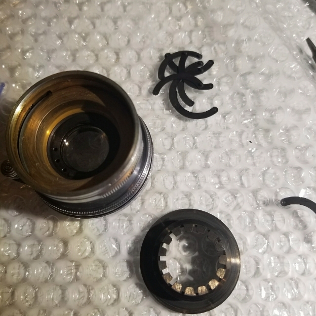

15-16 bladed aperture of a cannon serenar 50mm f1.9.
I did not know the retaining ring was loose until I turned it over and half of the blades fell out.
It took me over 2 hours and many words. But I was able to finally get them back into place.
Aperture mechanisms are work of the devil, make sure you’re not using magnetized tweezers!

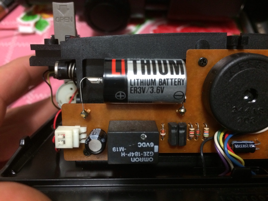

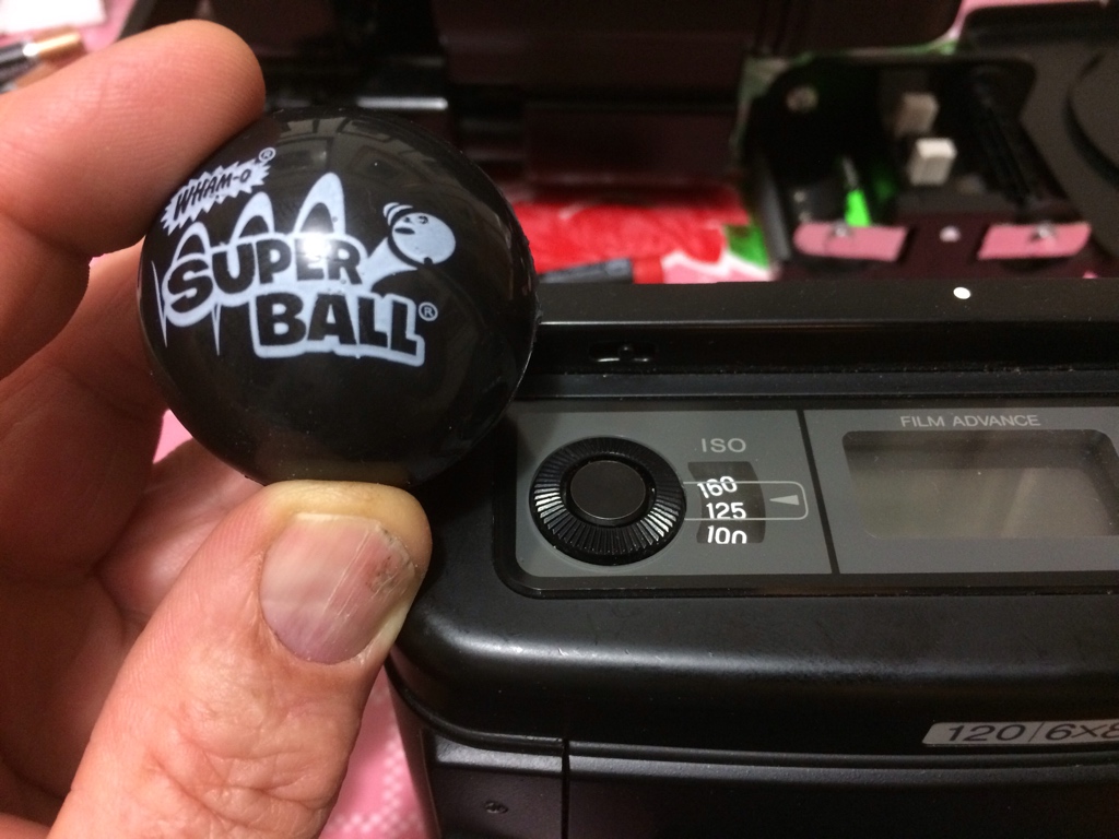

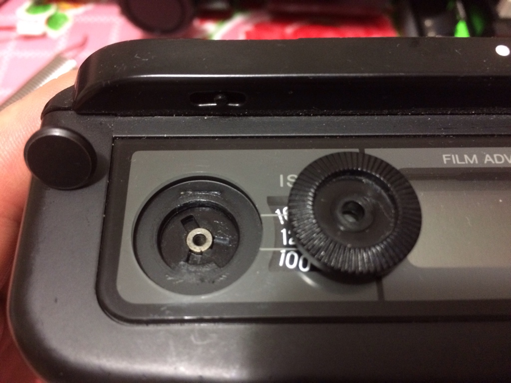

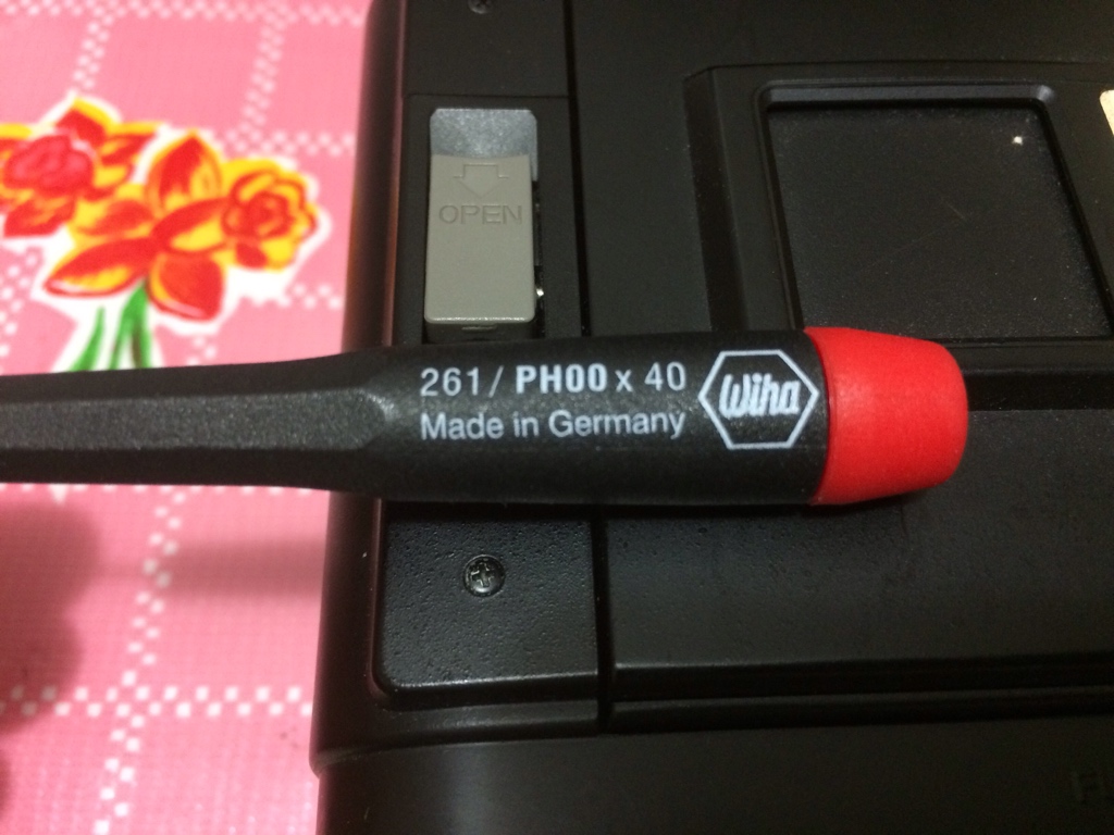

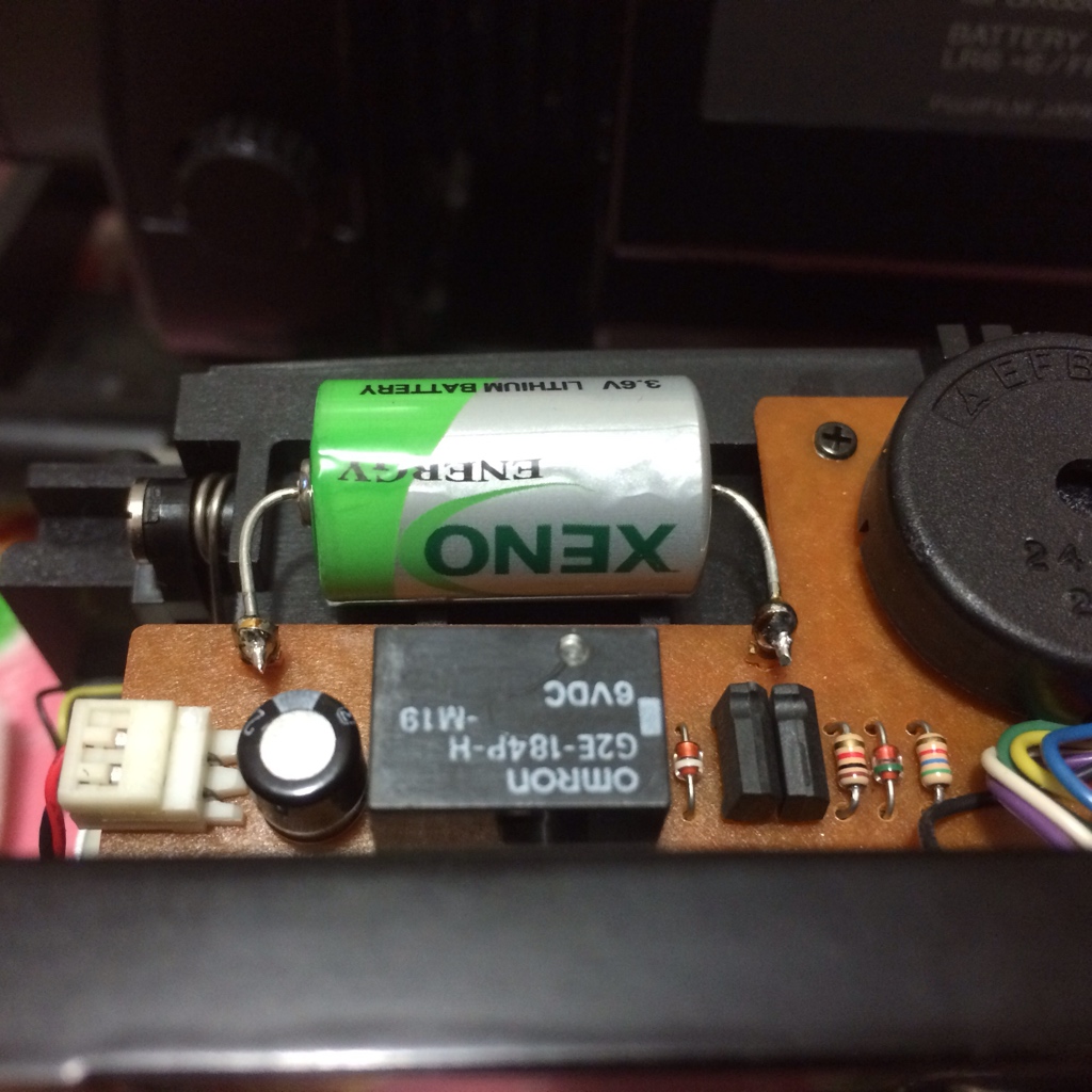

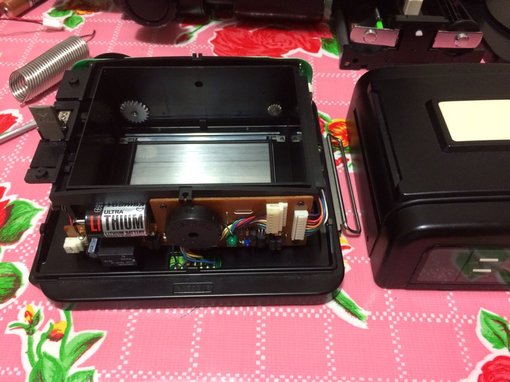

Just replaced the 1/2AA Lithium backup batteries in my 2 GX680 film backs, the ones that are soldered in that hold the memory when the camera is powered off. The hardest part was removing the "flathead" screw at the ISO dial, the one that lacks any kind of a slot or recess for a screwdriver. I tried pressing and turning with my thumb to no avail. Some internet research revealed the Superball method which with a little persistent worked like a charm. Some people have had to resort to more extreme measures like drilling pin spanner holes or cutting a slot for a screwdriver. Who would have known that one of my favorite toys from when I was a kid would be a useful screwdriver 50 years later. Once the "flathead" is removed it's pretty straight forward to replace the battery. 6 small phillips screws, remove the cover, desolder the old battery, solder in the new one, and reassemble. I was able to find the batteries online and ordered them. But being a bit impatient, I ended up find the locally before my order arrived. One of the nice thing about living near Silicon Valley. If anyone needs batteries I'm going to list them in the classifieds shortly.
Here's a few photos. The original battery is the Toshiba and the Xeno is the replacement.
Roger
Few more thoughts. Rosin core solder, make sure the 1/2AA battery are 3.6 volt and have leads, Phillips screws are two different lengths so pay attention to where they go.
Roger
