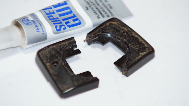

The eye piece design of a Nikon F2 DP-1 Finder is prone to splitting in two especially if fitted with a large rubber eye cup. There is no strength in the old plastic to hold the middle circular threaded holder and any knocks against it will cause the crack. The plastic will not stick together successfully as the side screws cause it to bend in the middle. So I have drilled corresponding fine holes into the plastic and inserted a metal dowel with epoxy glue. Then added glue to both halves and squeezed together for 24 hrs. I have also spot glued in the circular eye piece holder to give it some more strength. I'll stick with the small diopter from now on.
