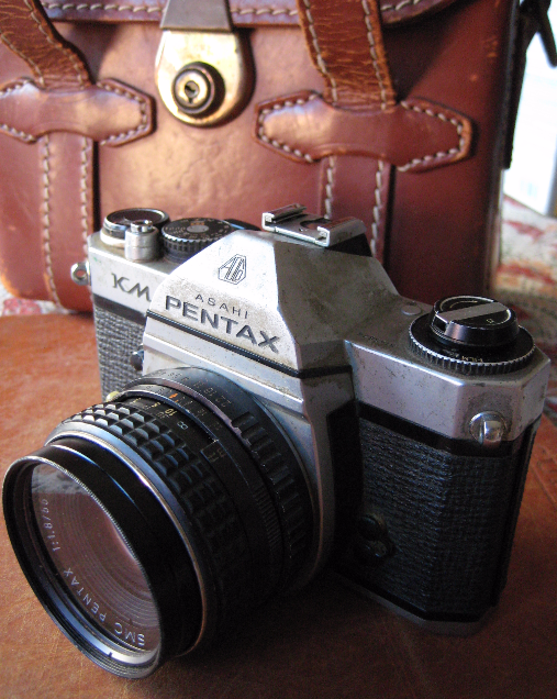

One very grimy Pentax KM... My sister-in-law's camera, given to me by my brother-in-law at Thanksgiving. Going to a party at their ranch tomorrow and seriously thinking about giving it back to her.
Insides were clean (nobody ever touched the mirror). Replaced the light trap seals and tightened the front of the lens which was falling off. Meter's not responding to light, but battery connection is good (needle rises slightly with battery in) and "battery check" (needle jumps up at certain ASA/Shutter speeds) works. Not using in-camera meters these days anyways so not going to try to fix meter (unless it's easy and someone knows how).
I decided the camera looks too cool with the patina, so I cleaned just a little and tried to keep the look.
My wife picked up on the vibe too... my sister-in-law made a funny face when she said it was her old camera... (as if he should have asked her first before giving it away).
My wife also made that same funny face when I told her I liked the grimy look.
The meter started working, guess the ASA resistor was just a little dirty.
So back to the rag and towel... to finish the cleanup...
Dang the meter keeps kicking in and out for no apparent reason. Battery check always works...
Narrowed it down to the baseplate... tapping the baseplate would make the meter work intermittently.
Then it occurred to me... what kind of electrical connection would be intermittent and would make/break by tapping on the baseplate?
Even though the battery compartment was clean, the solder joint looked a bit white from what might be corrosion.
So I resoldered it and now the meter seems reliable.

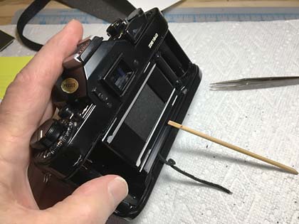

Today I did the light seals on my new Praktica L, I used wool for the door's slots and also added extra stripes of open-cell foam to the inside of the door and the hinge. I also adjusted the latch mechanism and re-engaged the frame counter's mechanism.

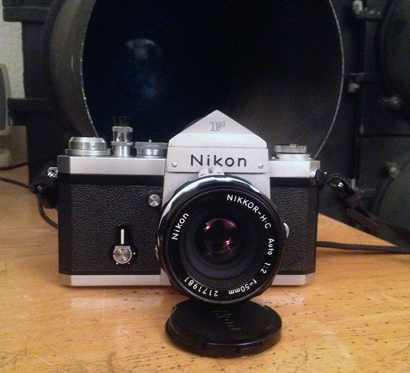

Converted a 50/2 Nikkor-HC to AI on Friday night. About a 5 minute job, since I had the factory kit handy. That said, took me another 45 minutes to fnd the modified 9/64" slotted screwdriver (profile of screwdriver shaved down to fit the thin slot on older Nikkor lens mount mounting screws).
The resultant AI'd 50/2, mounted to my F:

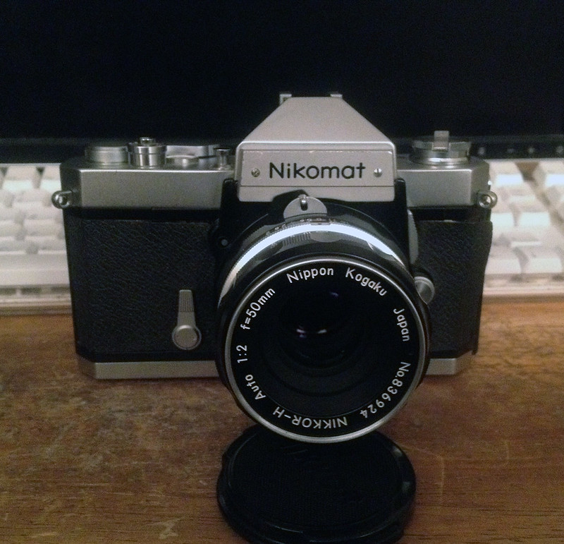

3-4 days ago, the parts FT3 arrived. Pulled the nameplate and put that onto the FT3 I already had. Then, I remembered that I still had those two Nikomat FTn bodies lying around. First time, took the mirror box from the chrome parts body. Swapped it in. Everything synched up and the shutter worked along with the mirror. But, while trying to reinstall the focusing screen assembly, wound up breaking the string for the shutter speed index strip. That wouldn't do. Next evening (Tuesday), I grabbed the black FTn that I turned into a "panda" camera. Pulled all the parts necessary to remove the mirror box without removing the prism, focusing screen, etc. Removed it. Swapped it into the FT3 chassis.
The result. Looks like an FT2 with FTn nameplate and all-metal advance/self-timer levers. Also has the early FT series mirror box rattle, so it sounds like a pre-42xxxxx serial FTn when fired. I have a black baseplate. Just need to find a black top cover and an undamaged black Nikomat FTn nameplate (may use a black Nikkormat FTn plate - have one that's clean). Leatherette needs to be glued down. Will do that once I have an extra late FTn rewind-side piece - The FT3 piece is cut for the black lens release button surround, which is larger.

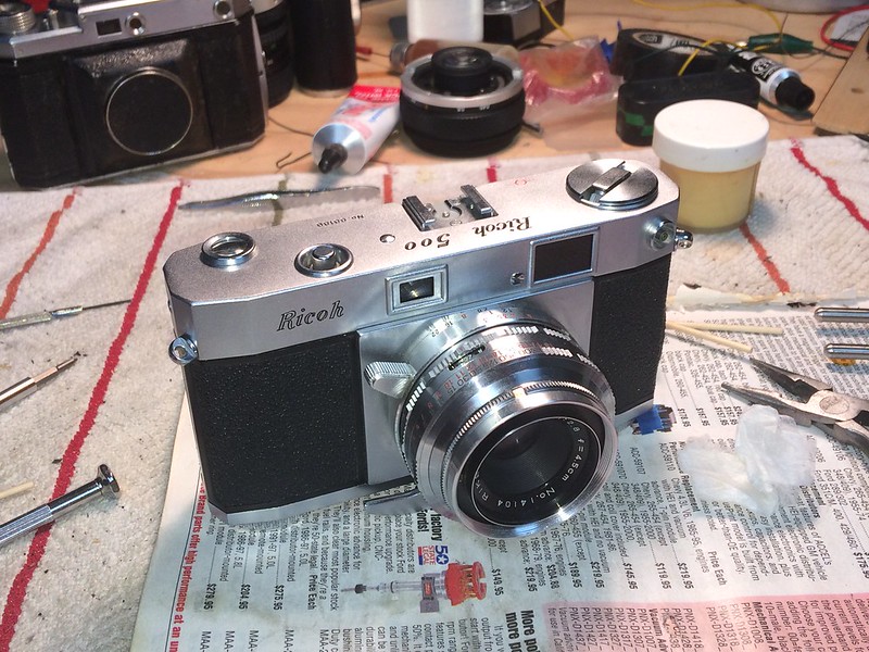

Been pretty busy fixing stuff lately. This was today's project. Ricoh 500 with a stuck shutter. Just needed a good cleaning and everything works fine. I read that these were mid level cameras in their day. I'm curious to see how it shoots.
