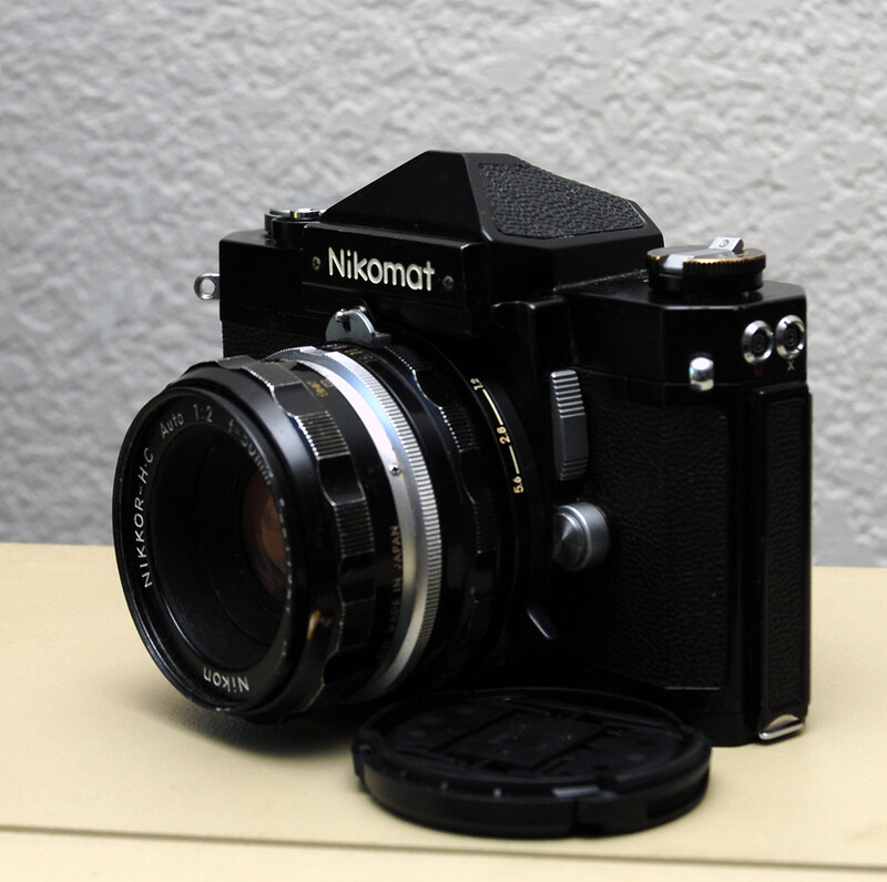

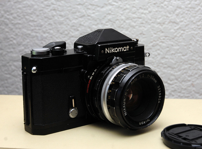

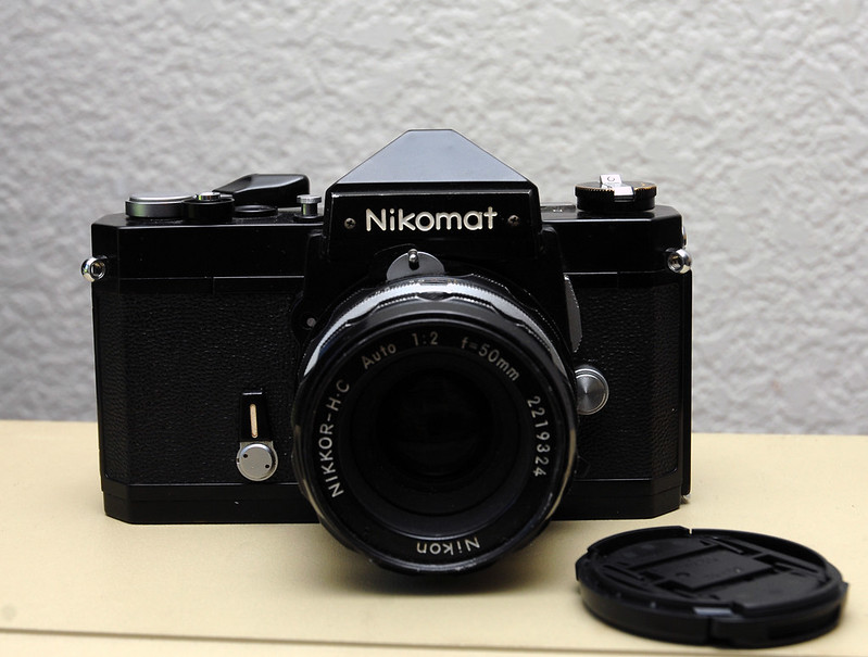

Yesterday's project... Cosmetically fixing the Nikomat FTn. Picked up a second black Nikomat FTn, which arrived yesterday in the mail. Checked it out, and it worked, but meter wasn't that great (very erratic if you moved the shutter speed ring, but smooth with the aperture ring). Slow speeds were almost dead when I first tried it, but fired the shutter a few times, and they came back.
Anyway, when I got home from doing a trip over to Glazer's Camera for some batteries and film, I started tearing both bodies down. Swapped top covers. Since I didn't have my soldering iron handy, the sync terminals are disconnected on both bodies, but at least everything's together. Photos of the second body can be seen in my for sale thread. I wound up converting it over to a Nikkormat FTn.
Pics of the resultant Nikomat FTn:
Much better. There are three dings on the front of the prism cover, and a minor impression where the leatherette is, thanks to a flash unit that must've been bumped forward.
-J
