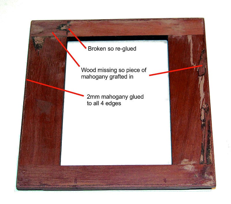

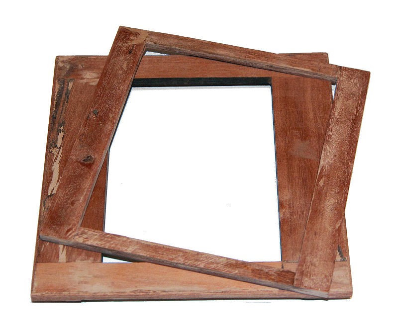

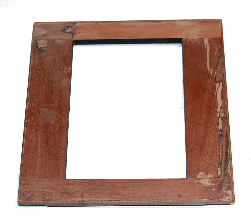

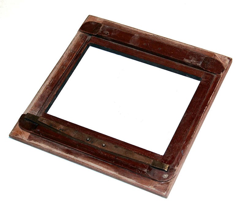

Well it's work in progress - a 7x5 back for my parts Seneca City View.
Last year I bought a 7x5 Seneca New Improved View which came with a parts only City View, meanwhile I was sent a second City View which needed less work. Last Sunday I bought a load of LF camera parts including 3 half plate backs however it turned out one was actually a 7x5. It was broken and slightly too small for the Seneca but with a little work :D
So this now fits the Seneca, the inner part is still to be attached but seen in the 4th photo this forms the light seal.
Luckily the Seneca is black (ebonised) so with a coat of paint it'll match perfectly (I've made lens boards etc0. I'll plate the springs later.

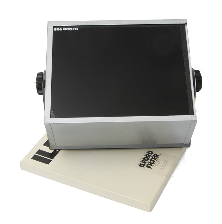

Restored an old 10x8 safe-light casing, re-sprayed the inside and outside, added new bulb holder and then fitted a NIB Ilford 906 safe-light screen (from 1984) that I picked up before Christmas at a camera fair. The case is at least 40 years old now ideal for Harman Direct Positive paper.
Ian
