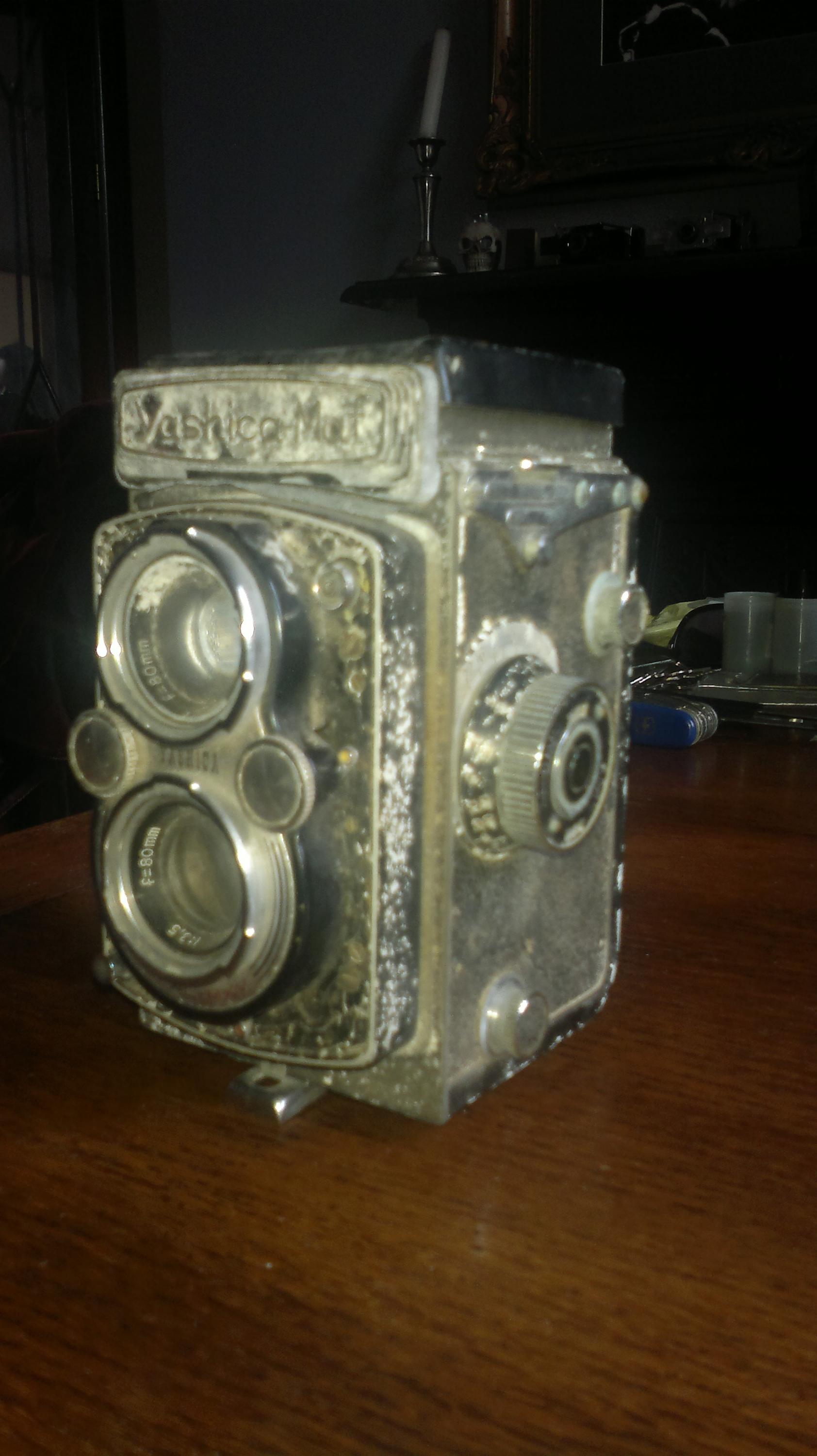

Got a beater camera posted over from India. I call it my Bashicamat:

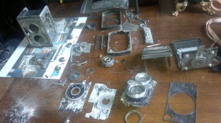

Here's the "during" pic. Nobody sneeze!

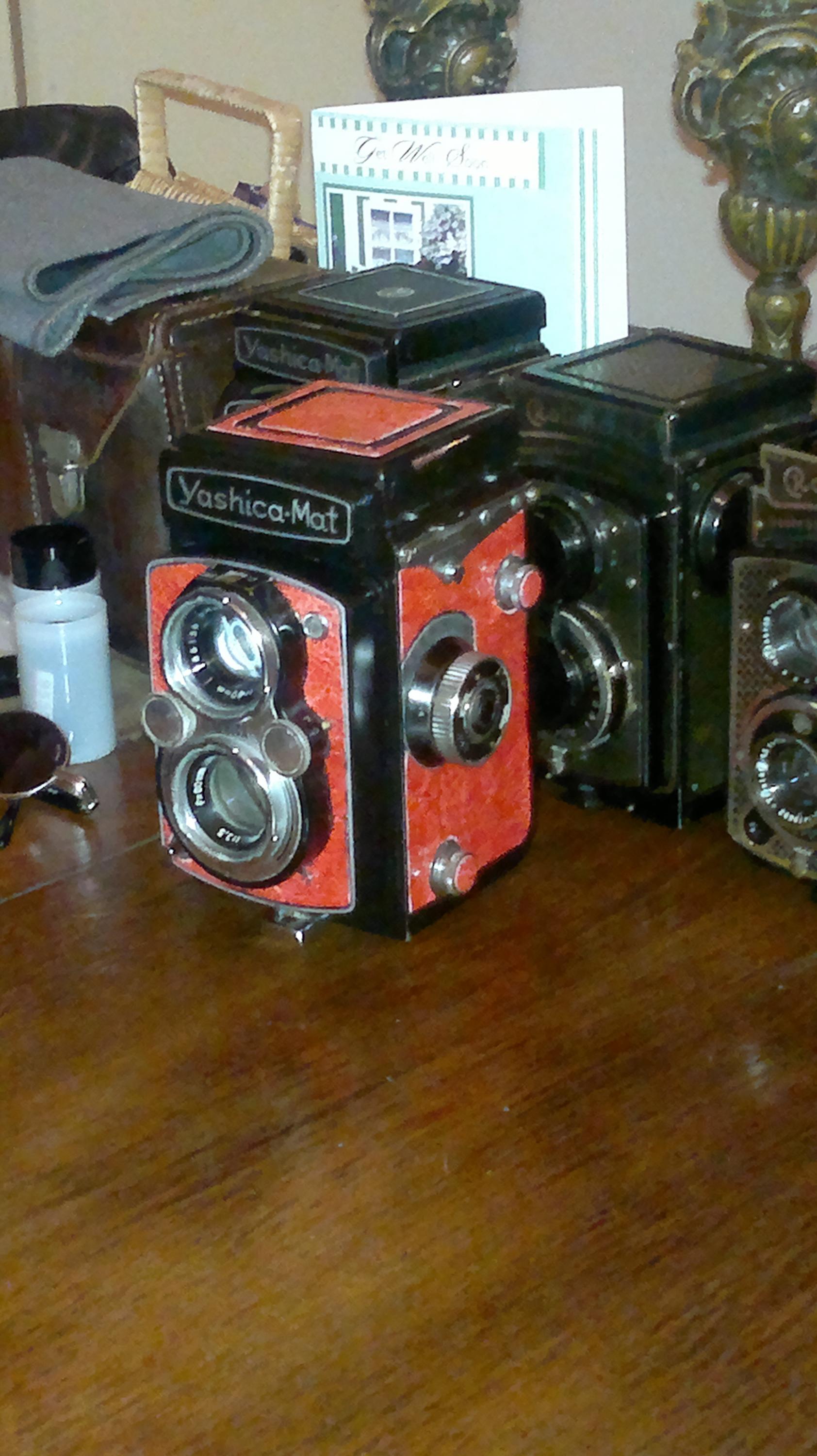

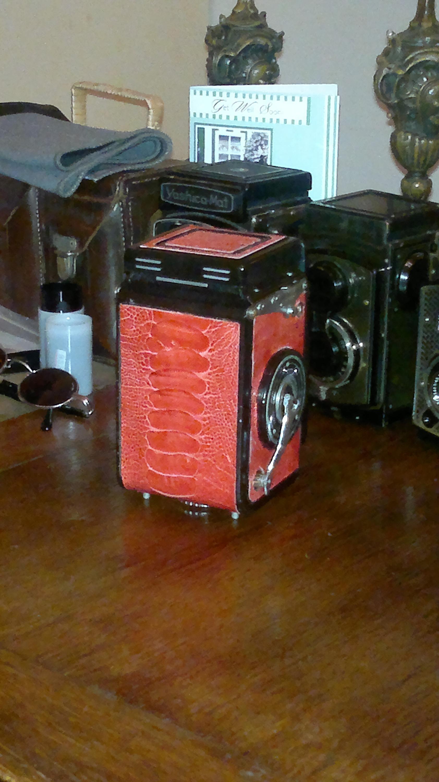

After covering with some red dyed ostrich leather:
Just need to tidy up the leather edges but she's looking much healthier now!

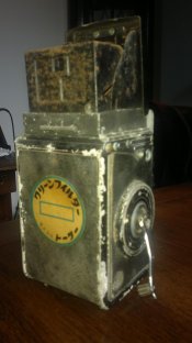

Impressive restoration. Was it corroded from humidity? Looks like the lenses were ok, though.
This camera sure had a rough life.
There was a lot of corrosion which made removing the old paint a little easier.
The film advance lever was held on with a mangled paperclip and it was a mess inside and out. Luckily, the only missing part was the pin on the winding lever.
The Yashinon taking lens was stuck solid, had corrosion around the front ring and cleaning marks. I replaced it with a Yashikor lens.
Everything works well but I did not repair the self-timer as I never use them but that mightl be a job for another day.
