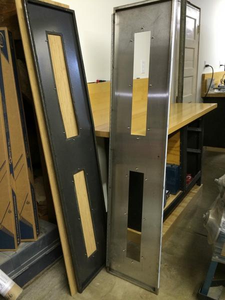

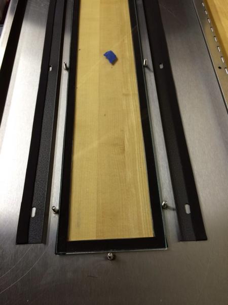

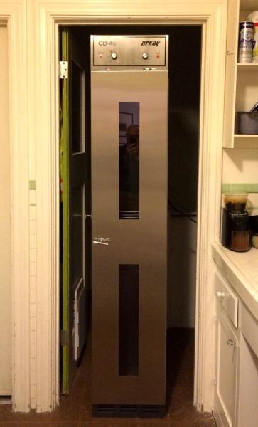

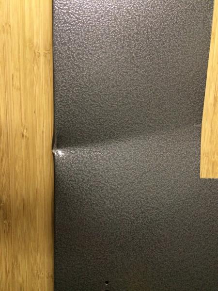

A while back I was given a Arkay CD-40 film drying cabinet. Cool right, well you're right it is cool, but free is rarely free. The catch was that the cabinet had been dropped during a move, badly denting the door and breaking one pane glass.
My brother works for a sheet metal shop that specializes in stainless steel fabrication so I had them make a new door. The door is basically a clone of the old door except in stainless. Everything fit perfectly. I addition to the door and glass I also replaced all the "weather stripping" for the glass and door perimeter and the air filter. So long story short, the Arkay lives!!!

That's cool! My film drying cabinet is either my garage or an old cabinet therein.

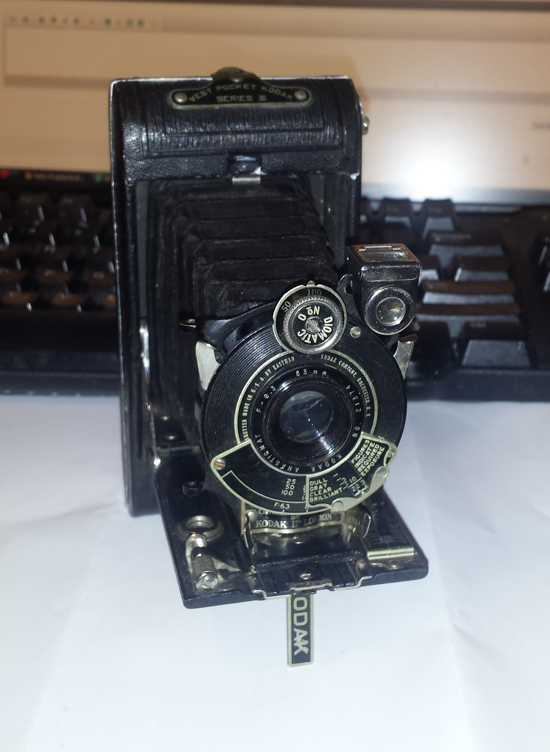

attempted to fix the moldy lenses on this Kodak Vest Pocket Series III that came in the mail today.
Got 4 of 6 surfaces. the rear element comes out, but it appears to actually have 2 pieces of glass in it, with no obvious way to separate them, like they're pressed into the metal housing, so there is still a bit of mold on the perimeter inside, but none in the middle. The front element is cleanable from the front and the rear using the bulb setting to keep the shutter open.
