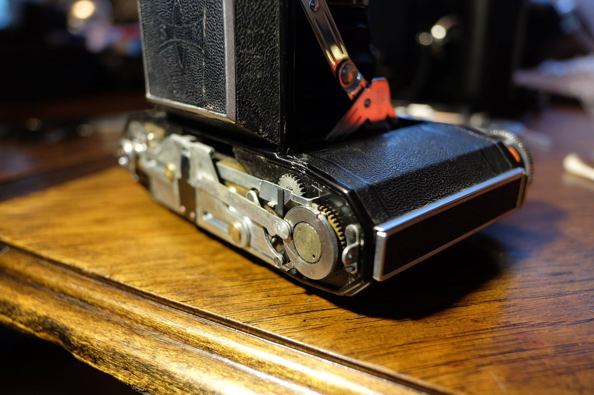

Took apart a Mamiya Six to see if I could see what the automatic shutter cocking arm kept falling out of sync. It would keep coming to rest in a spot that would prevent the shutter from actually firing. I cleaned a bunch of gunk off of the parts that seemed to control the timing and it has been operating perfectly since.
Hi Sjixxxy, I have just finished cleaning nearly all of the optical surfaces in my Mamiya Six IV and have just processed the first test roll. I checked the TMX 100 negs on a light box and the results are stunning. Consistent exposures over a range of aperture / shutter speeds, nice even frame spacing, no signs of light leaks and best of all the negs are very sharp. Did I mention that the negs are SHARP. Gotta love that Zuiko Takatiho lens from the late '40s.
Next maintenance item is the rangefinder. The lens that faces the viewfinder is hazy on the inside which means that the viewfinder is usable but I can't see the rangefinder patch very well. The lens is cemented in, (supposedly with shellac), and will have to be uncemented, cleaned and then replaced. Probably use nail varnish to secure it. Most of the test roll were shot at 30 feet to infinity focussing. Look forward to using the rangefinder properly.
