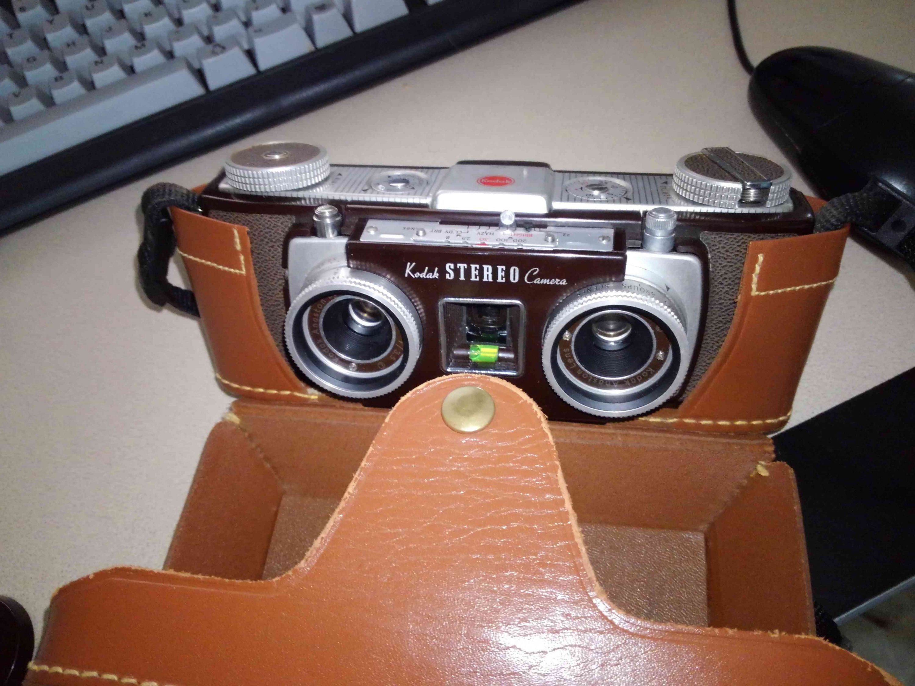

I just got back from a trip to Toroweap with this kodak stereo camera. I had to rinse the shutter assembly several times with a slurry of graphite and lighter fluid. I broke one teensy lens retainer though and had to buy a parts camera on fleabay. Surprisingly easy camera to disassemble, very few parts / screws.

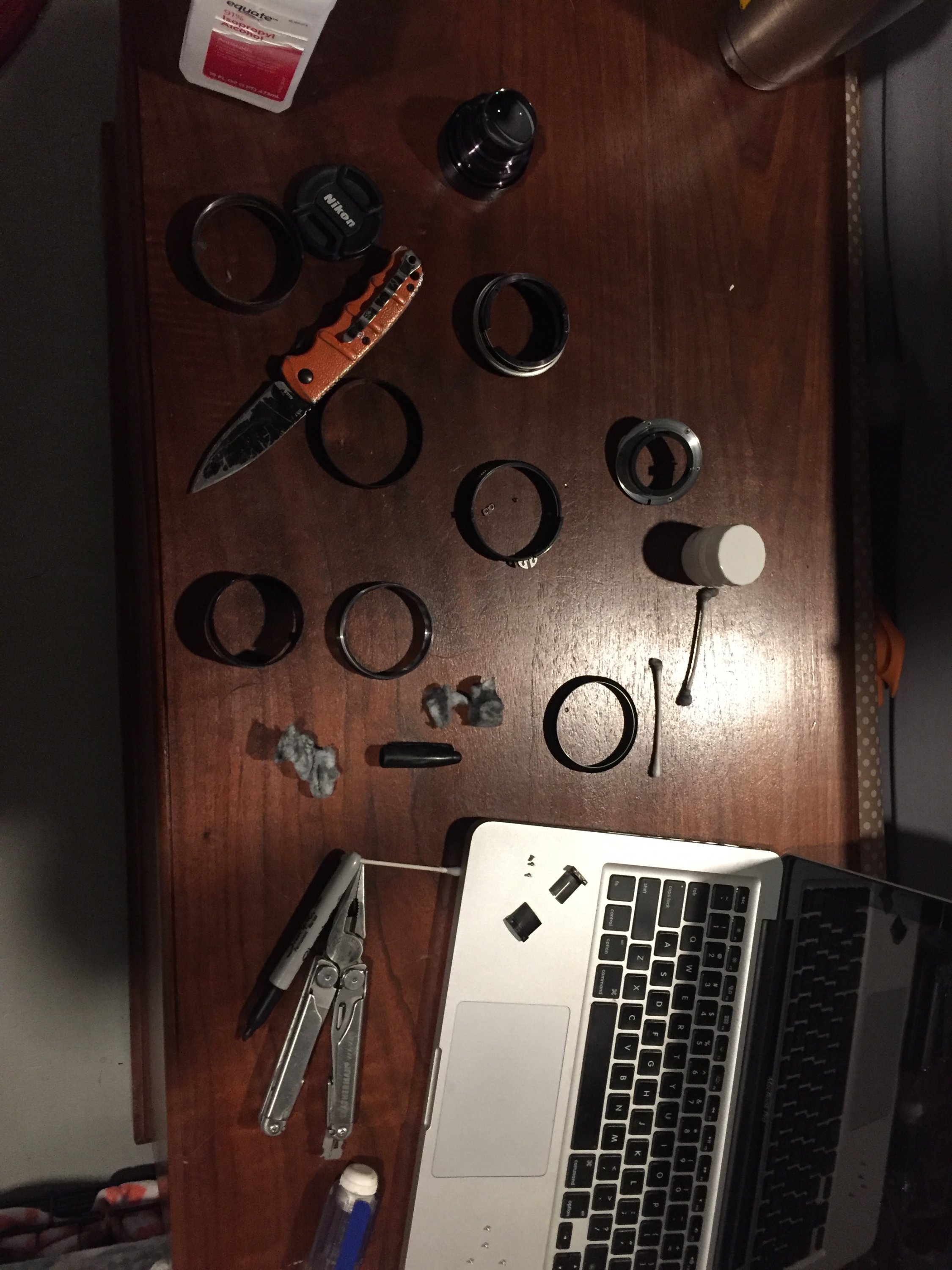

Did my first cla on a lens. 50 1.4 ai. Focus was stiff and had slop in the helical. Ordered some #10 grease from japan. Had to guess on the helical alignment. After thinking about it. I don't think the outer helical matters on alignment. The inner one just needs to have the one turn out from bottomed out, so it has enough room to rotate to focus. At least that worked for me.

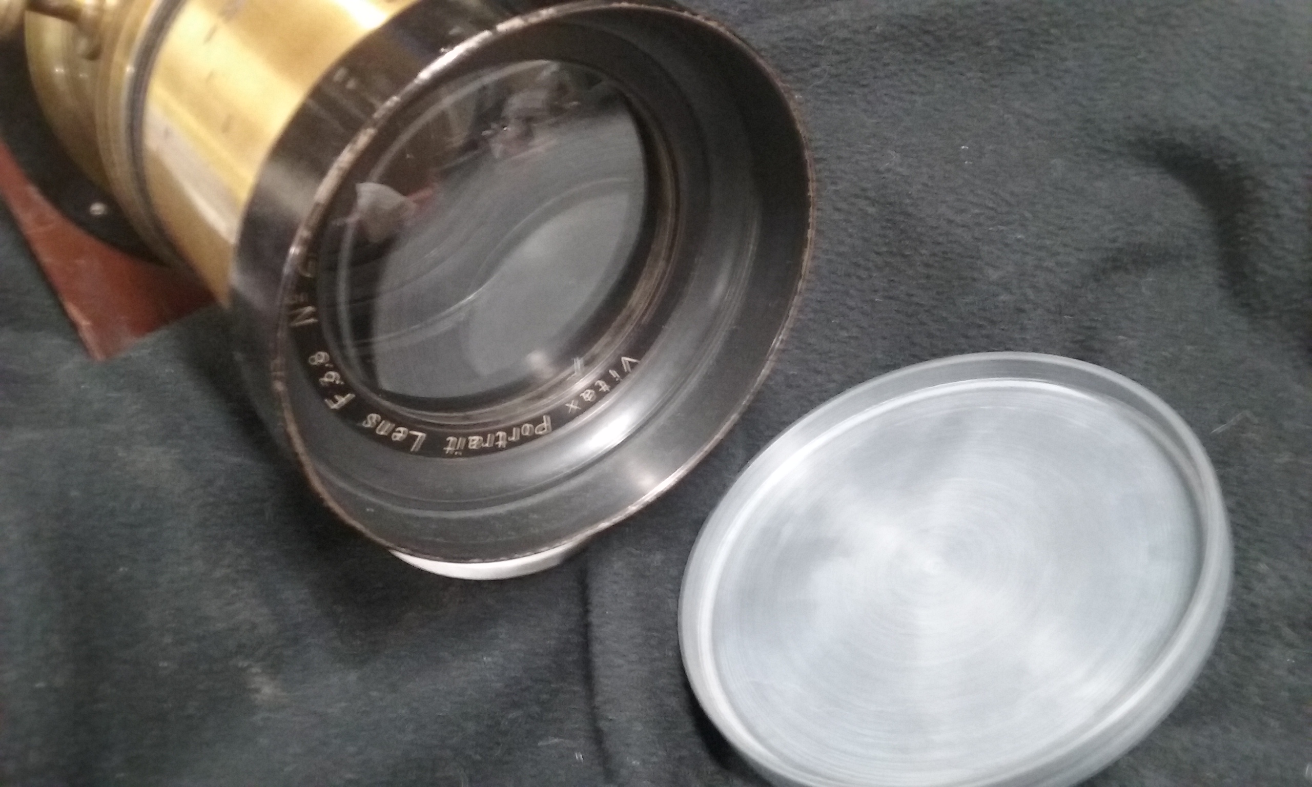

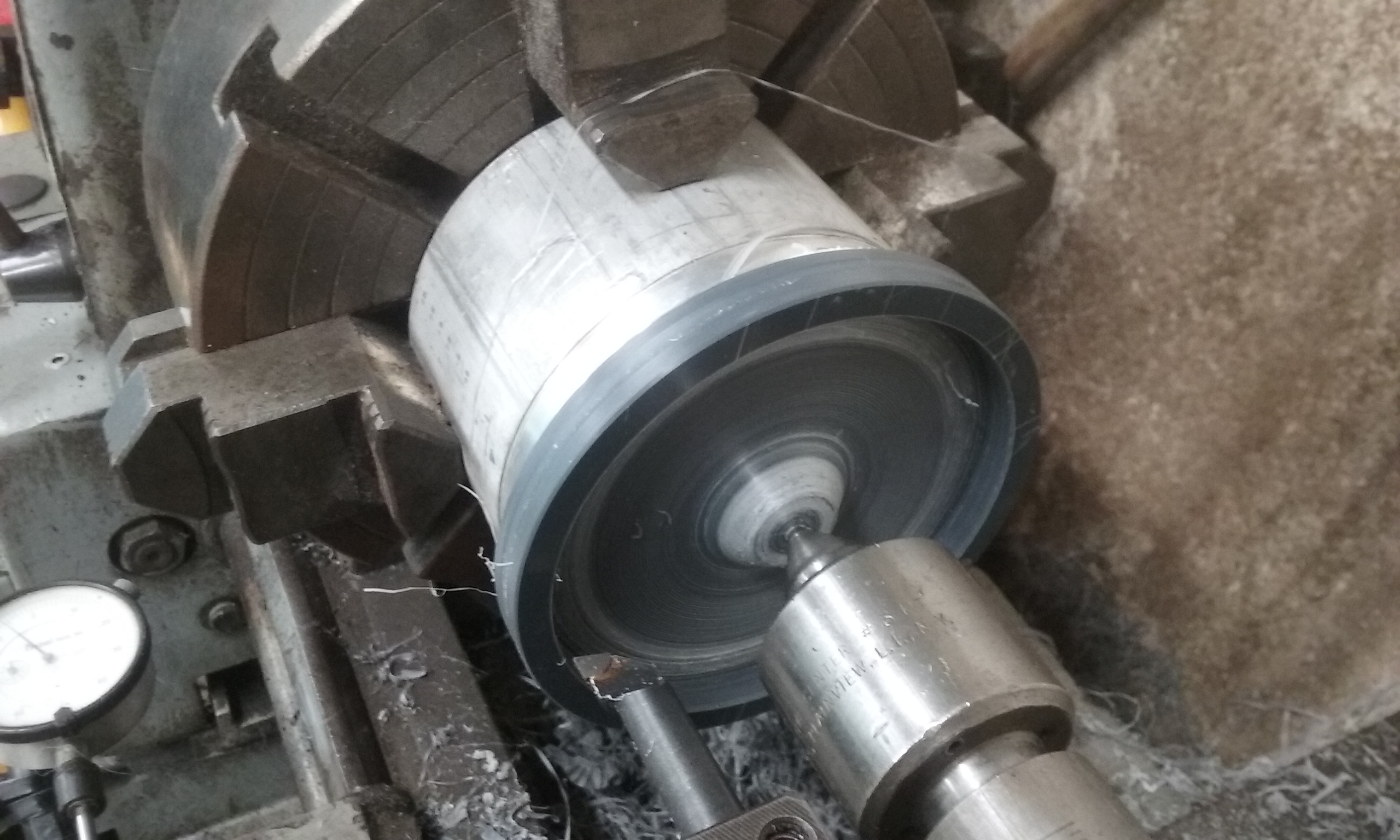

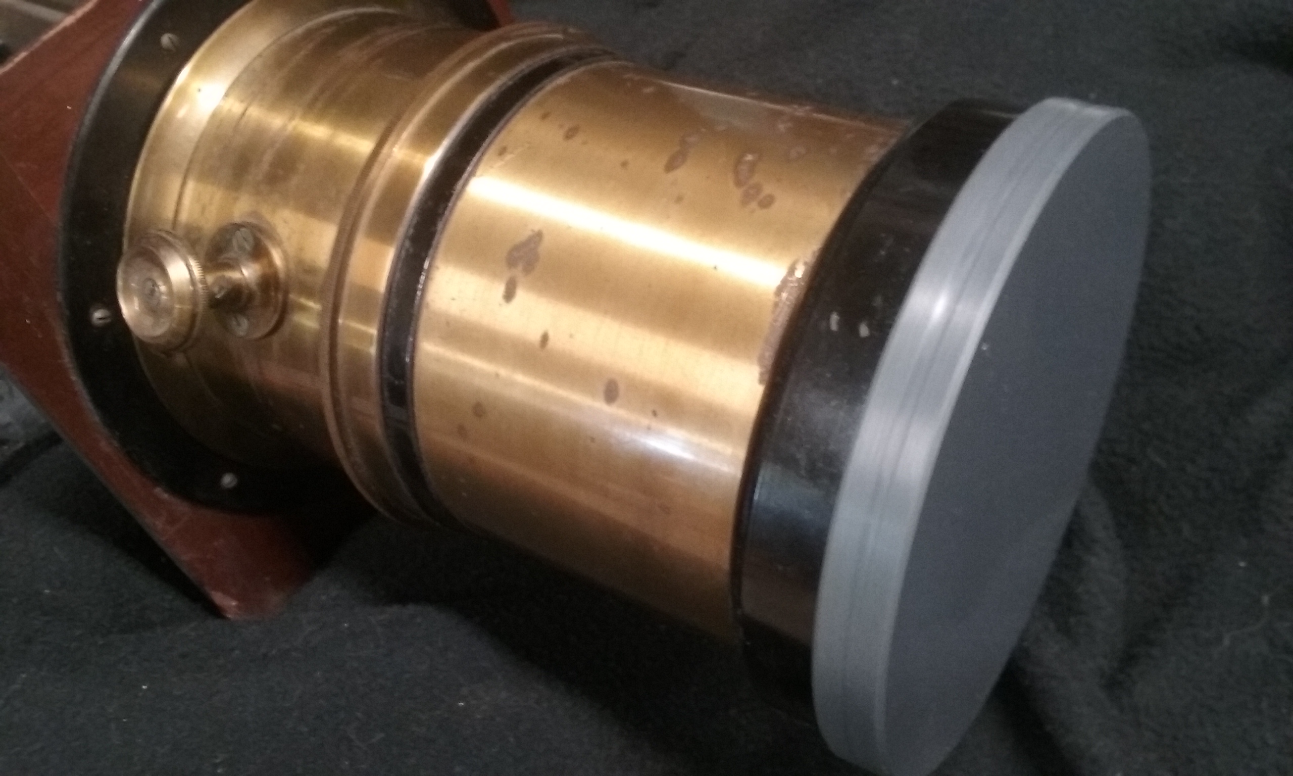

I recently acquired a couple nice lenses from an estate, of course there were no caps to be seen. Time to see if I remember how to use my lathe. Found a source for 1/2 inch thick PVC, took some measurements and started turning. The front came out nice, a snug slip fit. Hopefully the rear will come out just as good.
1564772981109-426071074.jpg 15647731149612053779233.jpg 1564773174430-2117052367.jpg
Front is done, rear on the lathe.
