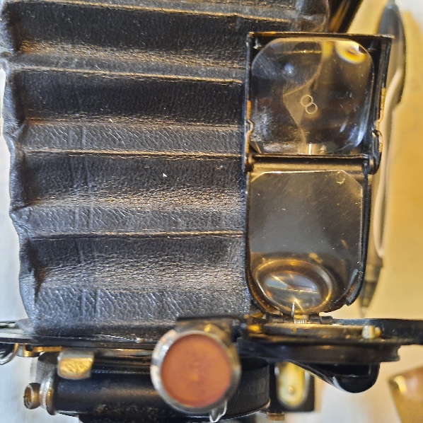

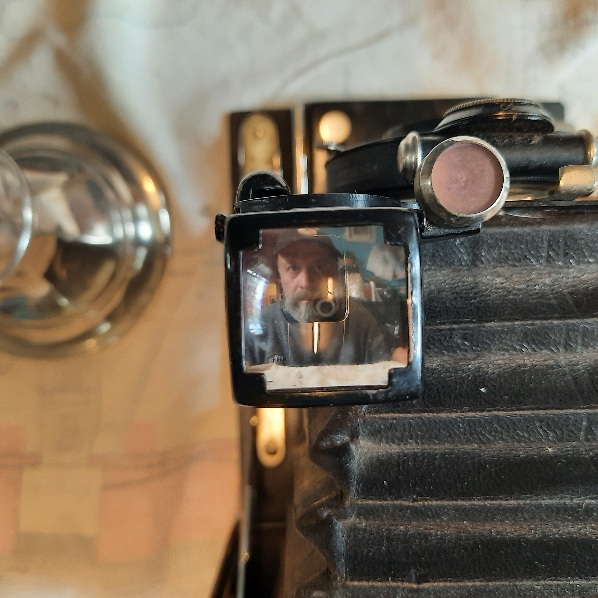

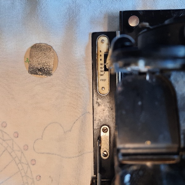

Replaced the mirror in the view finder on my little 1/4" plate Klimax with a little mirror disc I found in the third draw down. Cut to shape using mums good sewing scissors (dont tell her). All good to go. Even found the right size film holder in my stash. Just need to make a new ground glass and she will be right to go.

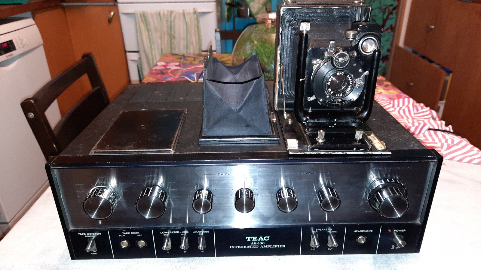

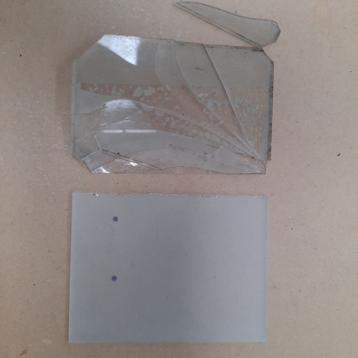

Replaced the glass.
Also fixed up my old TEAC as 100 amp while I'm in a fixarama mood.
The preamp hadn't worked for about 5 years, amp worked fine, after spending a lot of time checking stuff I started on the capacitors, lucky for me it was the first cap on the control panel I tried, just a bad solder joint. All running again. Might put it in the darkroom.
