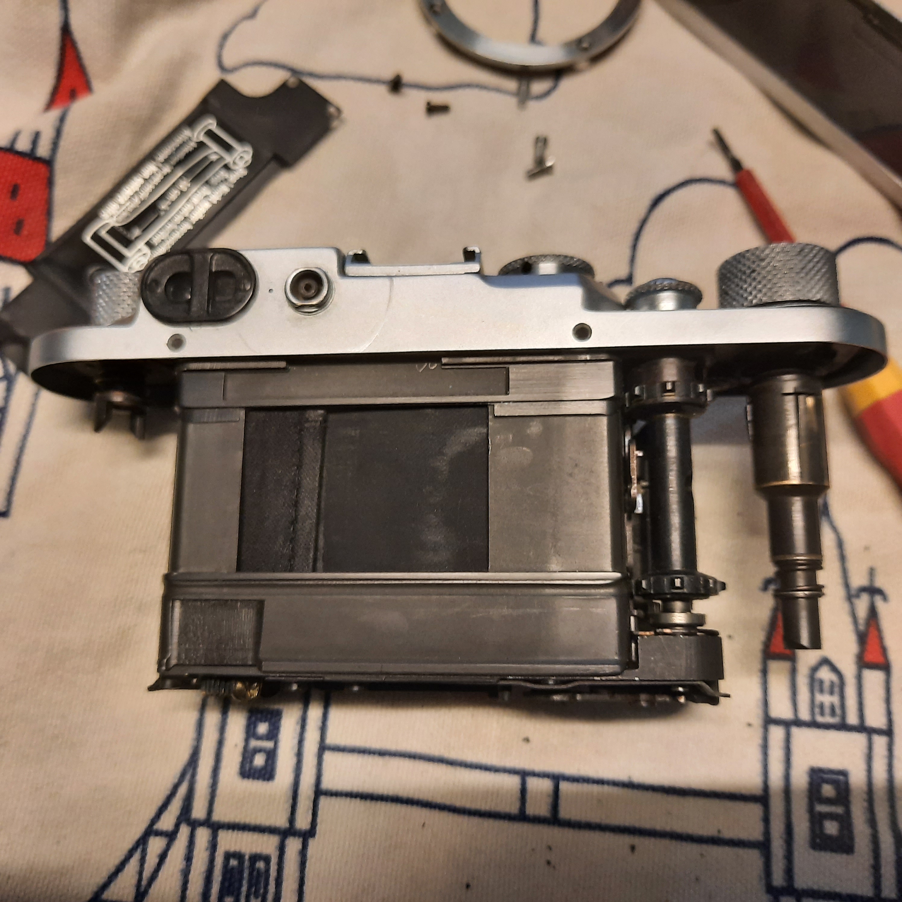

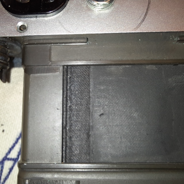

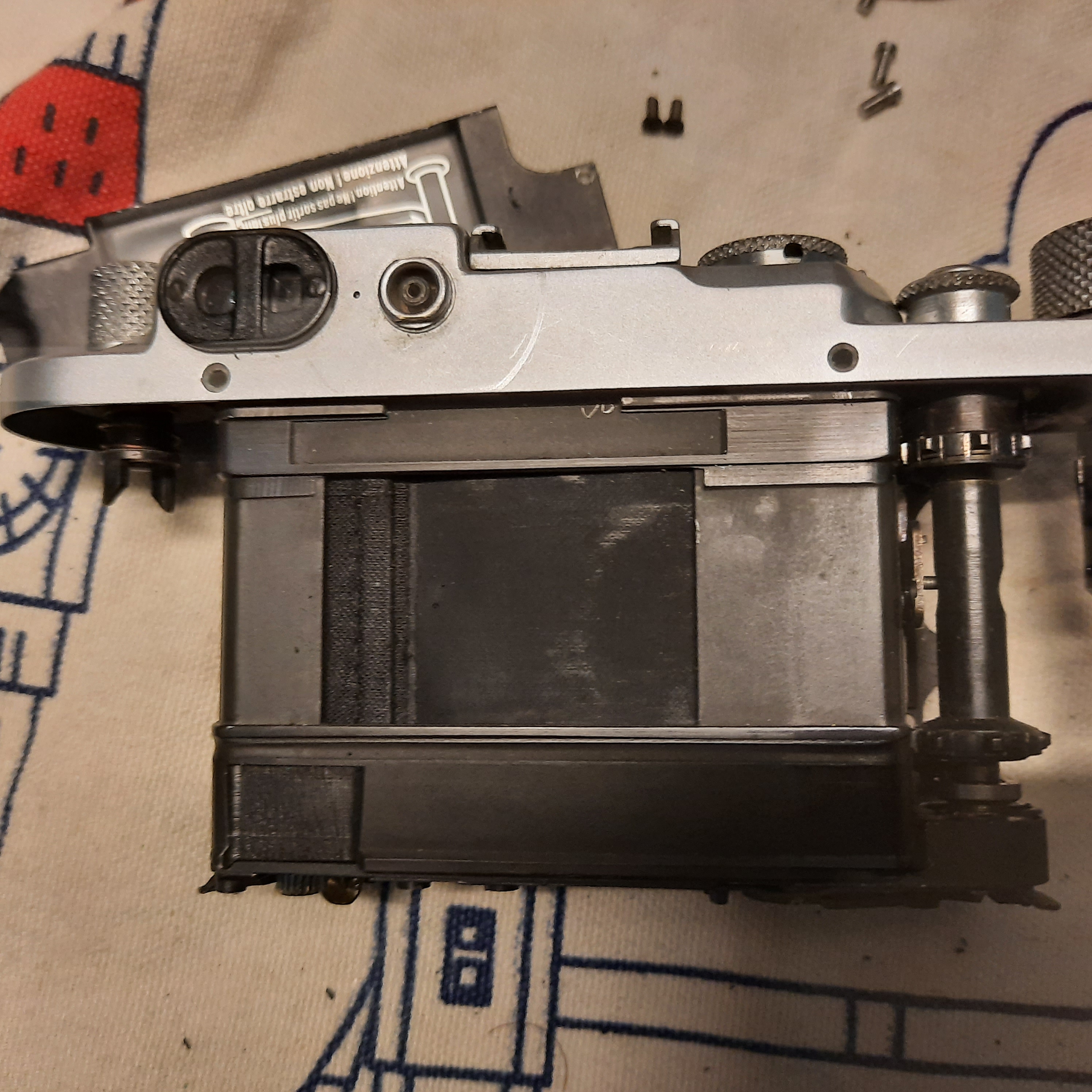

My new iiif I bought with shutter issues arrived today. Was hoping the shutter curtains not opening would be something simple, like a piece of film stuck. Took the case off and after a bit of manipulation managed to get the curtains to open. After a lot more it opened a little further, then finally got them working again, but unfortunately the curtains are shot and will need to be replaced. Rest of the camera is in really good condition.
