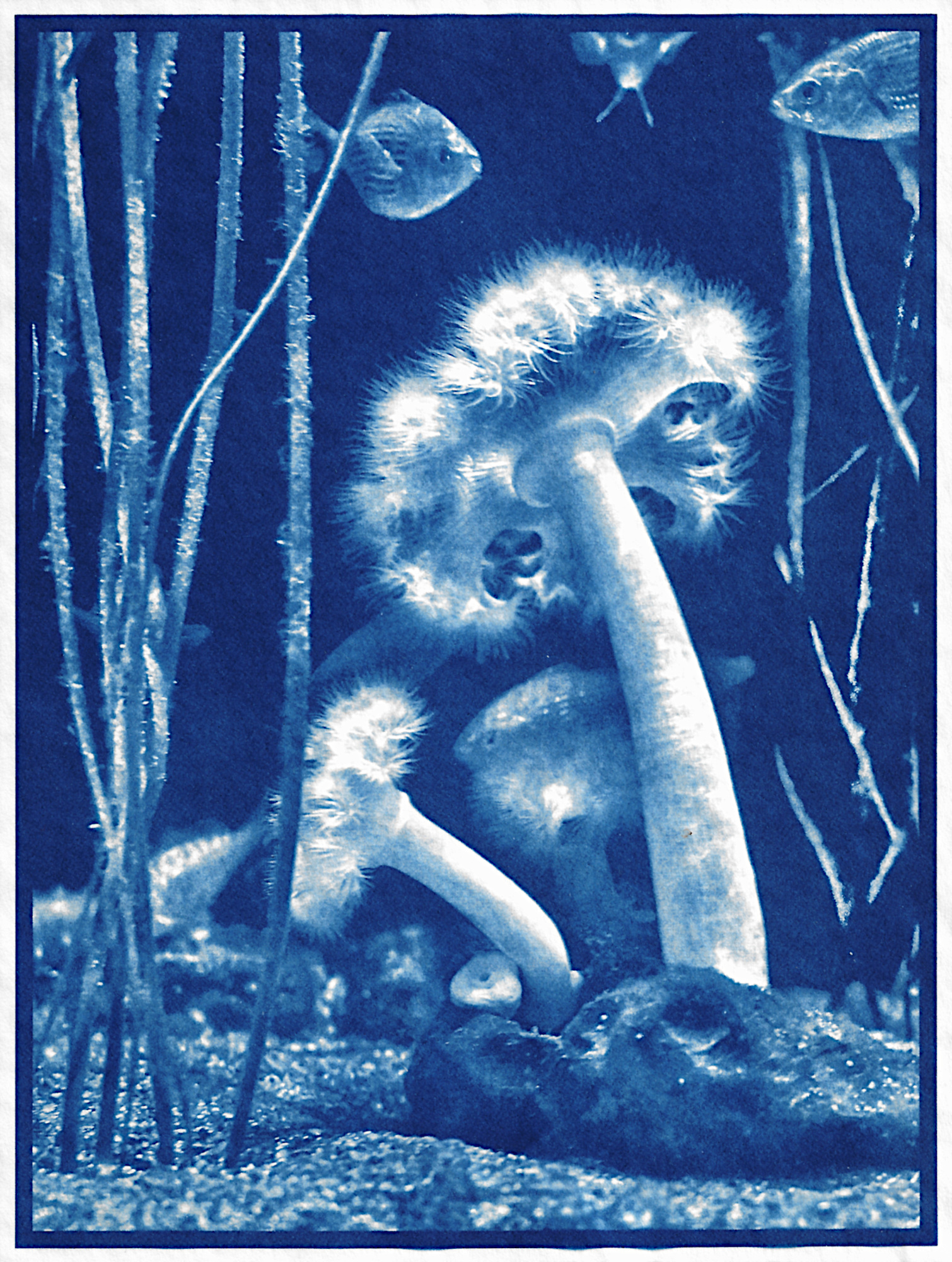

I printed this on Thursday. Sea Anemone and friends at the Seattle Aquarium
I missed this somehow....another nice one, Ned. Marine life totally suits cyanotypes - may be because we relate to the blue ocean.
:Niranjan
Very nice... especially for an early attempt.
And yes, the aesthetics (pinkish highlights and red-brown hue) don't work with every image but they do work well for some, including this one.

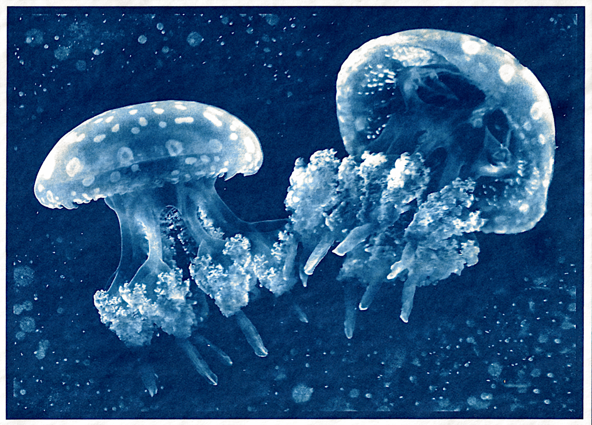

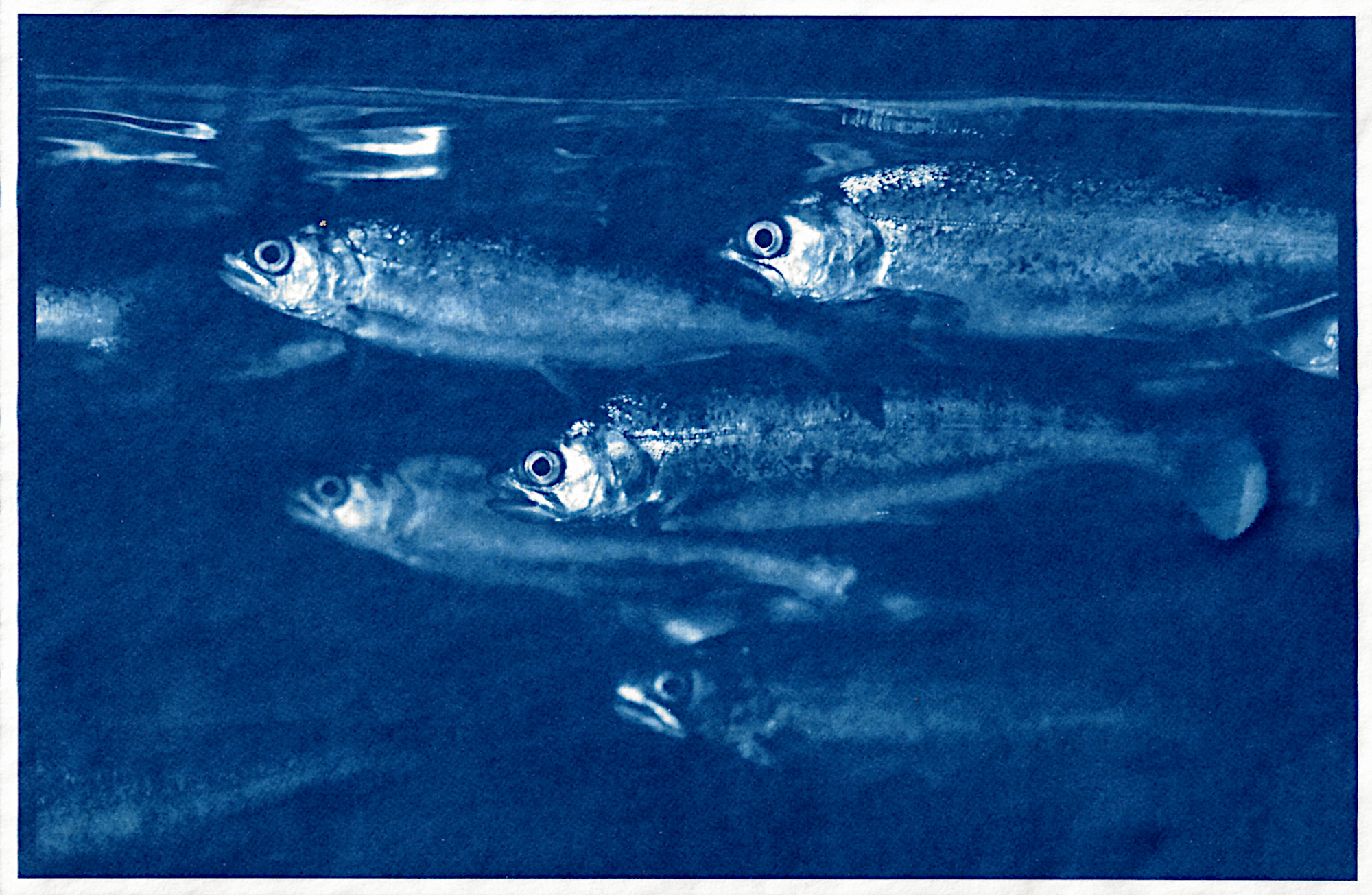

A few more digineg cyanotypes printed in the past few days.
Spotted Lagoon jellyfish and salmon fry at the Seattle Aquarium.
Salmon print was difficult and took 3 tries making the negative. I'm going to try a very different version of it later....

Another nice set.
It could just be a scanning artifact, but does the first one look a little yellowish in some spots (as well as overall move to more cyan tone.) Perhaps not completely cleared. Are you using acidic bath or plain water?

Thanks Niranjan. You've got a good eye. I almost wrote "the 1st one looks better in person than my scan"! I just did a poor job on the scan, it's the same nice dark blue as the 2nd one. I do keep an eyedropper of 20% citric acid at the sink where I process them, and I put a little into each change of water before using it. The last wash is always with RO water, and I usually add a bit of CA to that too, but not always -- by then the print should be totally cleared anyway. I probably wash cyanotypes more than most people ( leftover paranoia from salt prints :smile:

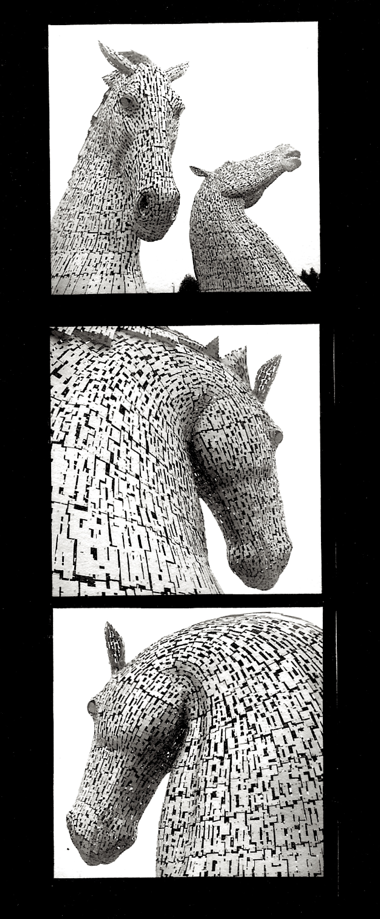

Doing a little pt/pd printing this past week -- 5x7 negatives and some 120 film (6x6 and 6x10).
Here's the Kelpies in Sterling Scotland -- 100 foot sculptures. A single strip of film..the Rolleicord does not always space images evenly, but I like the way it worked for this print.

Vaughan - as usual really nice work, I really like the contrast in these images

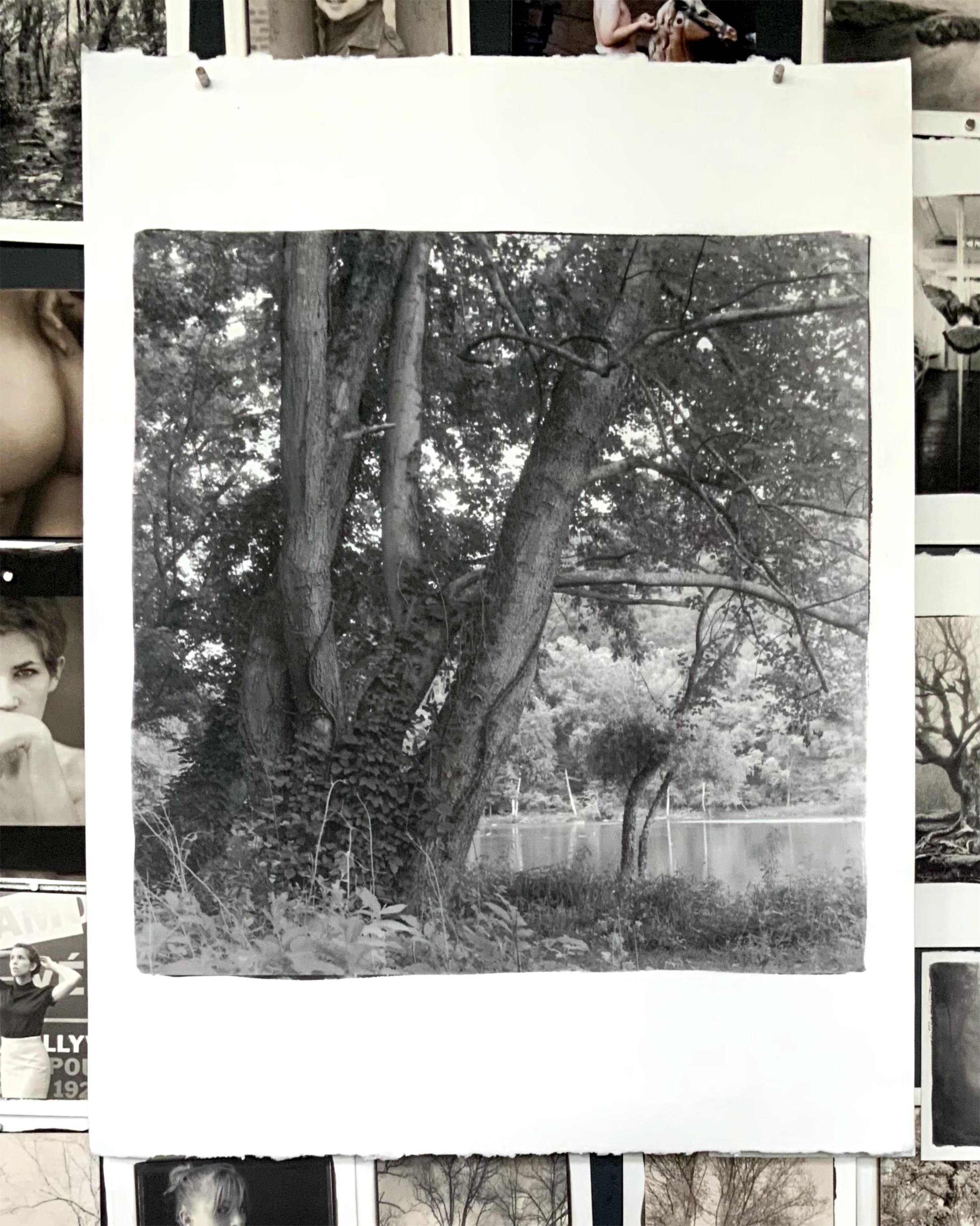

I've been setting up my darkroom to make larger prints. Last night I reprinted this image of the French Broad in the Pisgah Forest onto a 17x22 sheet of Revere Platinum paper. The print at this size has a dimensionality that the smaller print lacked. This is a platinum-toned kallitype developed in sodium acetate -- original shot with a Rolleiflex Automat onto Fomapan 200 (EI 100) film and digitally enlarged on Fixxons with an Epson P900.

Sanders that is beyond impressive - I didn't know Fixxons made film that large! The logistics of printing/handling the negative, coating the paper, contact printing and multiple development steps at that scale just boggles my mind. The prints looks great, deep blacks/some pure whites and good tonality and at that size it must be striking. You must have modified your original "two bank" UV setup to get this kind of coverage I would think.

As I've gone along, I've assembled most of the stuff needed to make bigger prints: The P900 printer for making negatives 16-17 inches wide; a 30-inch guillotine and a 24-inch rotatrim for cutting sheets of Revere Platinum to size; flat files for the big sheets. I have a 17-inch roll of Fixxons, which works well for me. My vacuum frame can accommodate 20x24 sheets, and my UV bank is big enough to cover 15x20, with additional lights on hand to expand up to 20x30. Still, it's taken me some weeks to collect all the necessary stuff, notably trays and drums.
The hardest thing about scaling up has been coating such a large area of paper with my two-inch brush. My usual print size requires 6 drops of each solution. This monster required 54 of each. I need a bigger brush.

I hung a couple of large black metal chalkboards on my living room wall, on either side of a large print of a photo I made of central park. I use tiny magnets to mount my prints on them. I didn't know where else to put the big print -- both boards are full of smaller prints -- so I just mounted it over top of the others. Some day I have to figure out what to do with them all.
