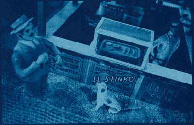

This is what I am talking about. Minox images from the last few years from my Schlimkimmelfitzen project. I should probably do something like you are doing. Much nicer to see finished prints on the wall than in a box...

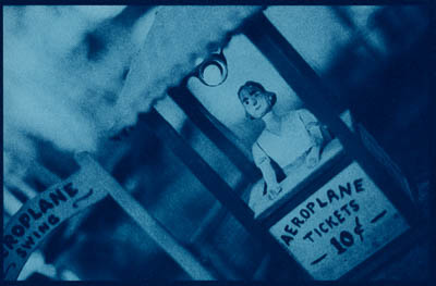

About 20 years ago I shot a bunch of images in the Musée Méchanique in San Fran. I never did anything with them in all this time but I thought they might make decent cyanotypes. I don't think these are successful though so I was wrong. I think the second image says it all. El Stinko. Lol. These might work better as salt prints or Kallitypes. I believe I used Canson XL Bristol which has become my "cheap" paper.
Well, I'm not sure I go so far as "El Stinko", but there is certainly room for improvement. Clearly, the highlights need some work.
You say the images were made 20 years ago. Thus, I assume they are film negatives... true? If so, you could scan the negatives and adjust the contrast to suit cyanotype with a curve.
You could also try a shorter exposure and then develop in 1-2% vinegar. The shorter exposure should help get to near paper white in the highlights. Vinegar development would help with contrast in the midtones.
Or, as you say, you could try a different process... I'd suggest salt prints (given their long scale) but I haven't seen the negatives.
The images are interesting so I think it will be worth investing some effort.

If the negatives don't have enough contrast for cyanotypes, there's no hope at all for salt prints.
Yep. I would also go to the opposite and wash in tap water (neutral or slight alkaline even, not enough to form iron hydroxide though) for longer period (try different lengths.) Sure it will bring the Dmax down, but do a much better job on the highlights as well. I guess it depends on what part of the print one wants to accentuate.

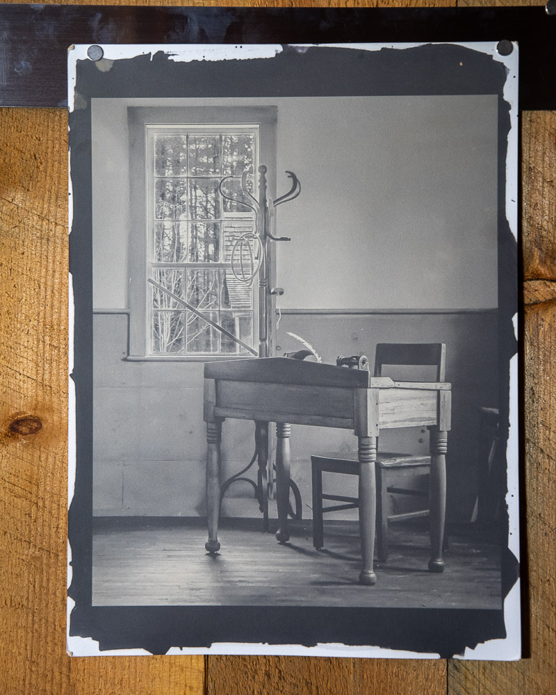

Back on 7 Sept, I made the largest salted paper prints I have attempted to date. I was not as bold as Sanders though.
My images are 10 x 12.5 inches on 11x15 inch Hahn. Pt Rag paper. I buy most of my paper as large sheets when available. HPR and many other papers are available as 22x30 inch sheets. Thus, these sheets cut down to four 11x15 inch sheets with no waste.
Additionally a 10 x 12.5 inch image (125 square inches) is a bit over twice the area of my typical print (6 x 7.5 inch, 45 square inches on 8x10 paper) which, in turn, is a bit over twice the area of my smallest prints (4x5 inches, 20 square inches on 6x7.5 inch paper). It makes a nice progression!
Here are photos of the three prints, hanging via magnets on a stainless steel strip. I have a number of these strips (both 24" and 36") hanging in different spots in my studio and dim room. I wish I had the space for a large sheet of steel.
Those of you who participated in the recent print exchange will recognize
this one...
Here is a gold/bicarbonate toned version...

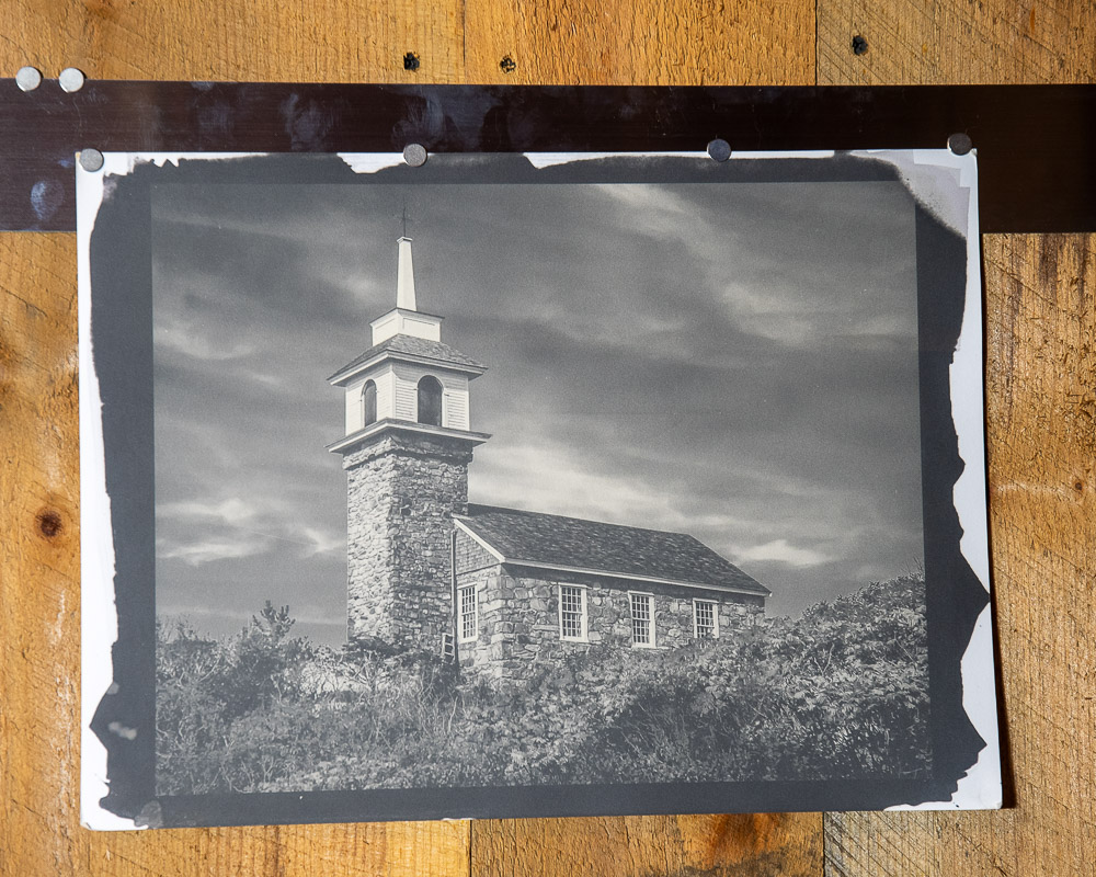

And another gold/bicarbonate toned print...

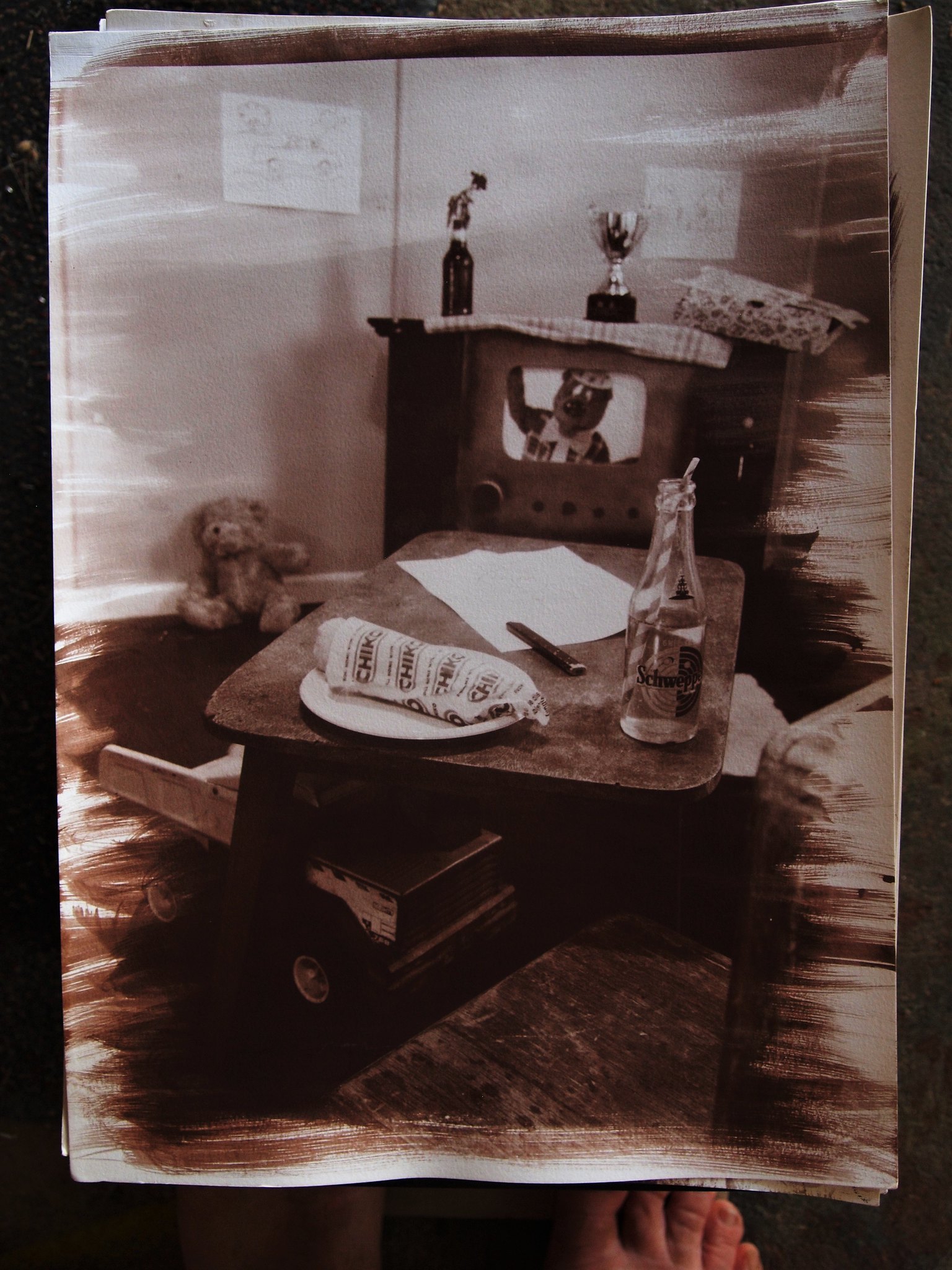

14X17 Vandyke Brown contact print on a3 art paper. Sun exposure, wash and toned in gold and selenium.
Home made 14 x17 camera with fuji 250mm lens, f64, xray film in pyro hd
