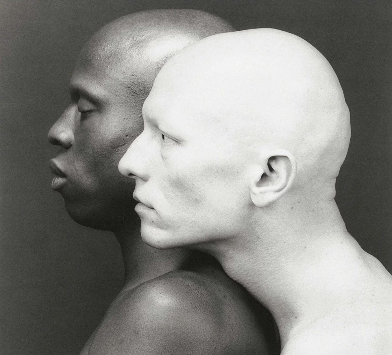

It’s taken me three years to get to this point. And I still have work to do. I think of the big platinum prints that Mapplethorpe made, and marvel at how he made them. (Without benefit of digital negatives!) But now I am beginning to realize that part of the impact of those prints was their scale. Not only because they were big (really big) but also because the textures (paper texture, and how the metals sit on it) smooth out somewhat in a bigger print.
If you’ve not seen it (I saw it at the Guggenheim’s Mapplethorpe retrospective ages ago — it’s what piqued my interest in working with platinum), here’s a reproduction of his “Ken Moody and Robert Sherman (1984),” a 22x25-inch platinum print:

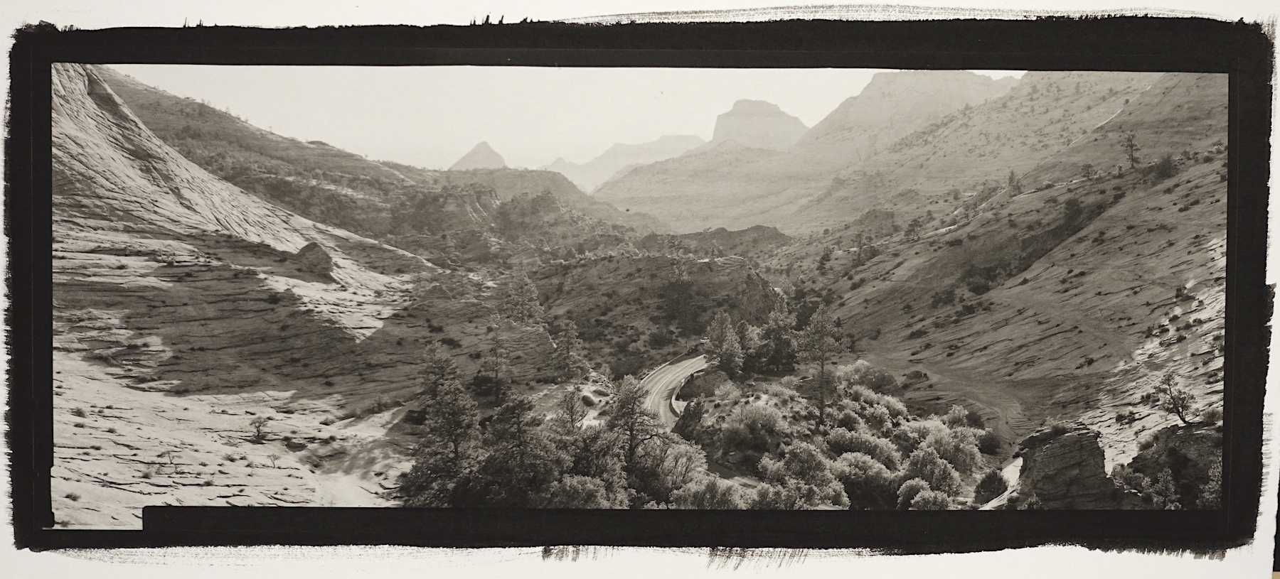

5.5"x14" Platinum/palladium print
Checkerboard area of Zion National Park, 2019
This is an image I had wanted to make during my Artist-in-residence in Zion in 2018, but I doubted my ability to get the 11x14 to this spot at the time (heart issues). I decided not be be disappointed with the haze and the resulting lighting, and instead go with it and use it instead.
I guess I was too excited about the image at the time to write my usual notes about the image. But I would have used a 360mm Fuji W lens with FP4+ (PyroCat HD developer), using a modified darkslide to get two 5,5 x14 images on a single sheet of 11x14. There is a black dot (probably a bit of rust perhaps) on the print -- fortunately not on the next print. What's fun and cannot be seen on your screen are three or four bighorn sheep on the rocks on the right -- hard to see on the actual print without a magnifier.

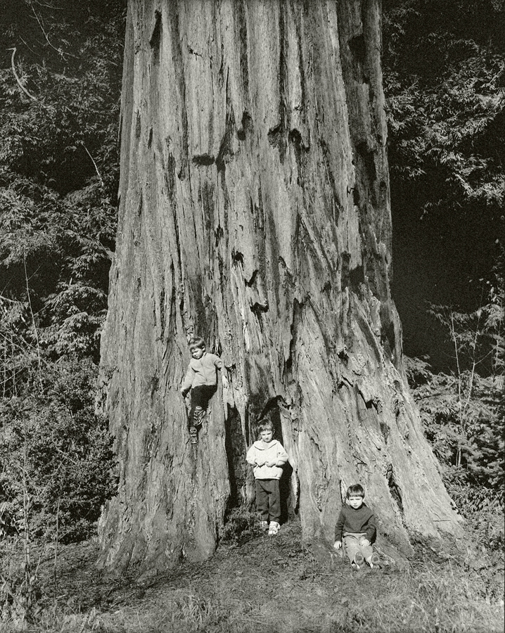

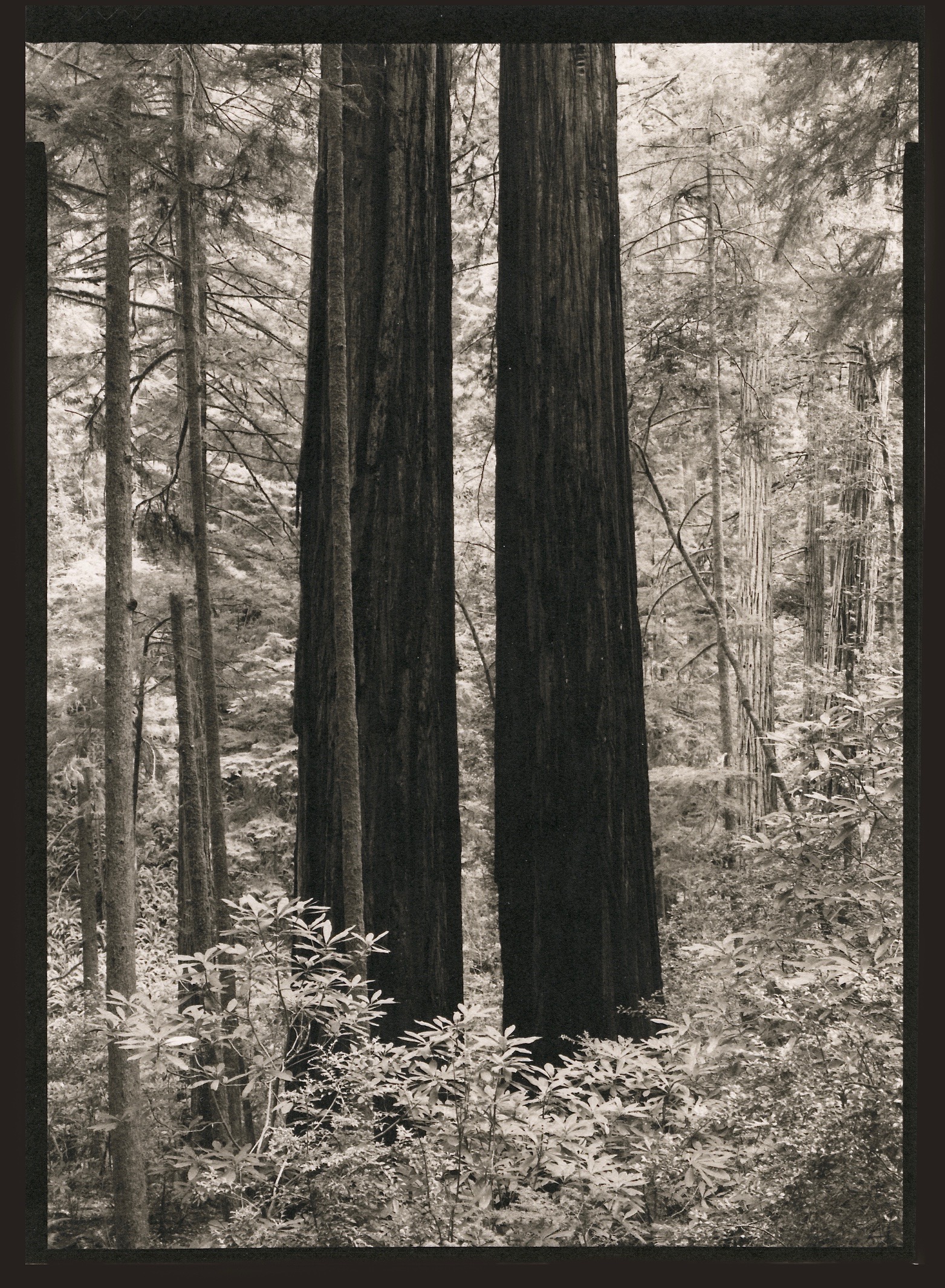

Thanks, all! I was just was working with the file of this image, so you get stuck with another image. I seem to like photographing Redwood in pairs, so another Two Redwoods for you. This a 5x7 platinum/palladium print from a 5x7 negative.
Taken on a long day hike with friends many years ago (camera was stolen in 1995, so before then -- have replaced camera relatively recently).
Two Redwoods, Emerald Creek Drainage
Redwood National Park

Vaughn, This is a wonderful print both the composition and the printing - a naïve question: did you tone it to obtain that ( to my eye) light sepia or is that the way Pt/Pl just looks on that particular paper/chemical combination. I always thought it was more neutral.
Dave
Vaughn
Dec 13, 2006
10,293
Humboldt Co.
Dave
I can not claim that the image is exactly the same color as on your screen, but it is warm -- I develop in warm (100 to 105F) Potassium oxalate which will yield a warmer print than with cold PO -- and much, much warmer than Ammonium citrate.
And thanks to all who appreciate the image. The scale is difficult to judge -- the two redwoods are seen starting about 20 feet above ground level as the the slope is steep, and the diameter of the trees where we see them rising out of the rhodies is probably anywhere from 12 to 15 feet. Below is an 8x10 pt/pd of my boys (6 yrs old) and a redwood for size comparison. Not a great reproduction of color or print quality

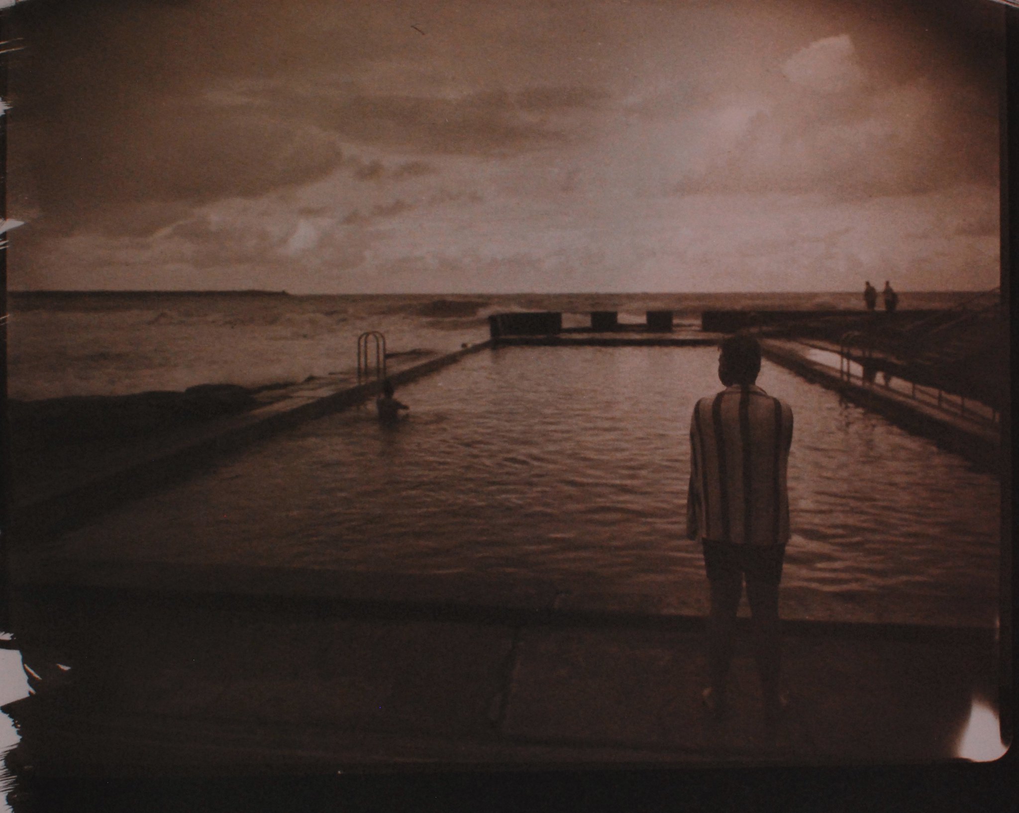

This was from an old negative that I revisited and enlarged and printed Saturday.
Original negative: Ilford Delta 400 120
Camera: Hasselblad with 80mm lens, tripod mounted and stopped down but settings not recorded
Location: somewhere in Germany
enlarged on to Pictorico Premium and cropped to be a horizontal
printed with my platinum/palladium/gold recipe on Arches Platine

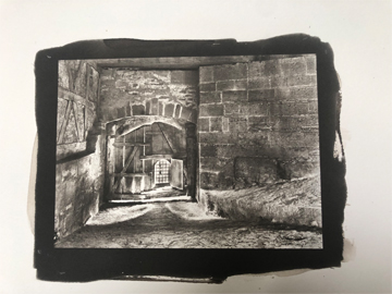

Vandyke Brown print on 11 X 14 Berger 160 COT.
Sun exposure for 8 minutes contact print
24 X30 XRAY FILM IN d76
German made 1890 24 x 30 view camera.
Fuji 250mm lens
Paul, I am slow to comment but I really love this print -- it makes me think that maybe I should take a dive into Van Dyck prints. Did you use any toning agents, or was this a straight VDB print?
awty
Jul 24, 2016
3,711
Australia
Thanks. No toning, they seem go dark purplely using the Berger paper while drying. Nothing exacting in my process.
VDB is easy peasey, you probably already have the chemistry.
Gold theo toner works well if you want something even deeper P/P type of tone.

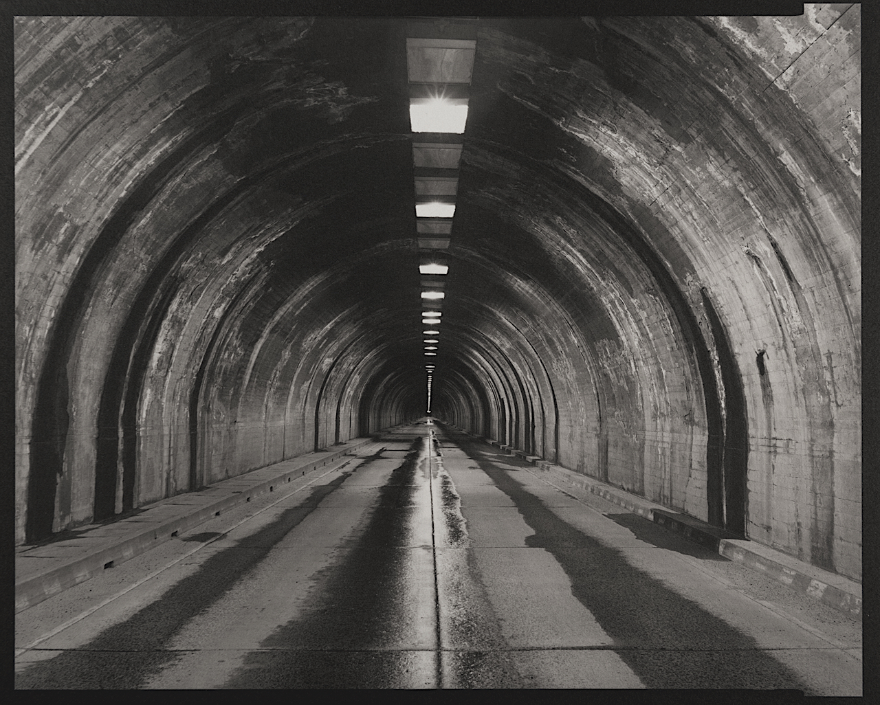

A different take on "Tunnel View" in Yosemite National Park -- a fun image made a few years back. I drove up to the tunnel from Yosemite Valley around midnight in February and set the camera up its far entrance. I was in the middle of the road and I did have to move the 8x10 out of the way one or two times...taking note where my tripod 'holes' were. Fortunately in the quiet of the night, I could hear tires on the roadway behind me a couple minutes before the vehicle would arrive. The tire tracks from the wet snowy conditions added to the image...sometimes it is timing, most of the time, luck.
Wawona Tunnel, Yosemite National Park
Platinum/palladium print.

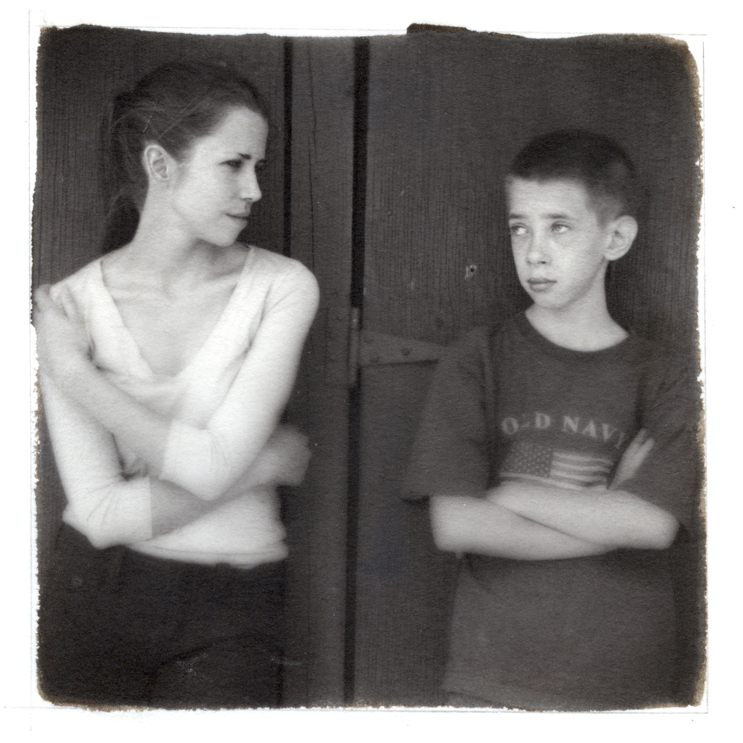

I goofed a print today but it came out unexpectedly well. I use a vacuum frame under a UV light array. Today, I turned the light and vacuum pump on at the same time, leaving the negative loose on the paper for the first part of the exposure. Surprisingly, the faces in the print turned out sharp, while blurring the bodies a bit. I'm attaching the print here -- I don't think this is a reproducible effect but it was an interesting result this time.
