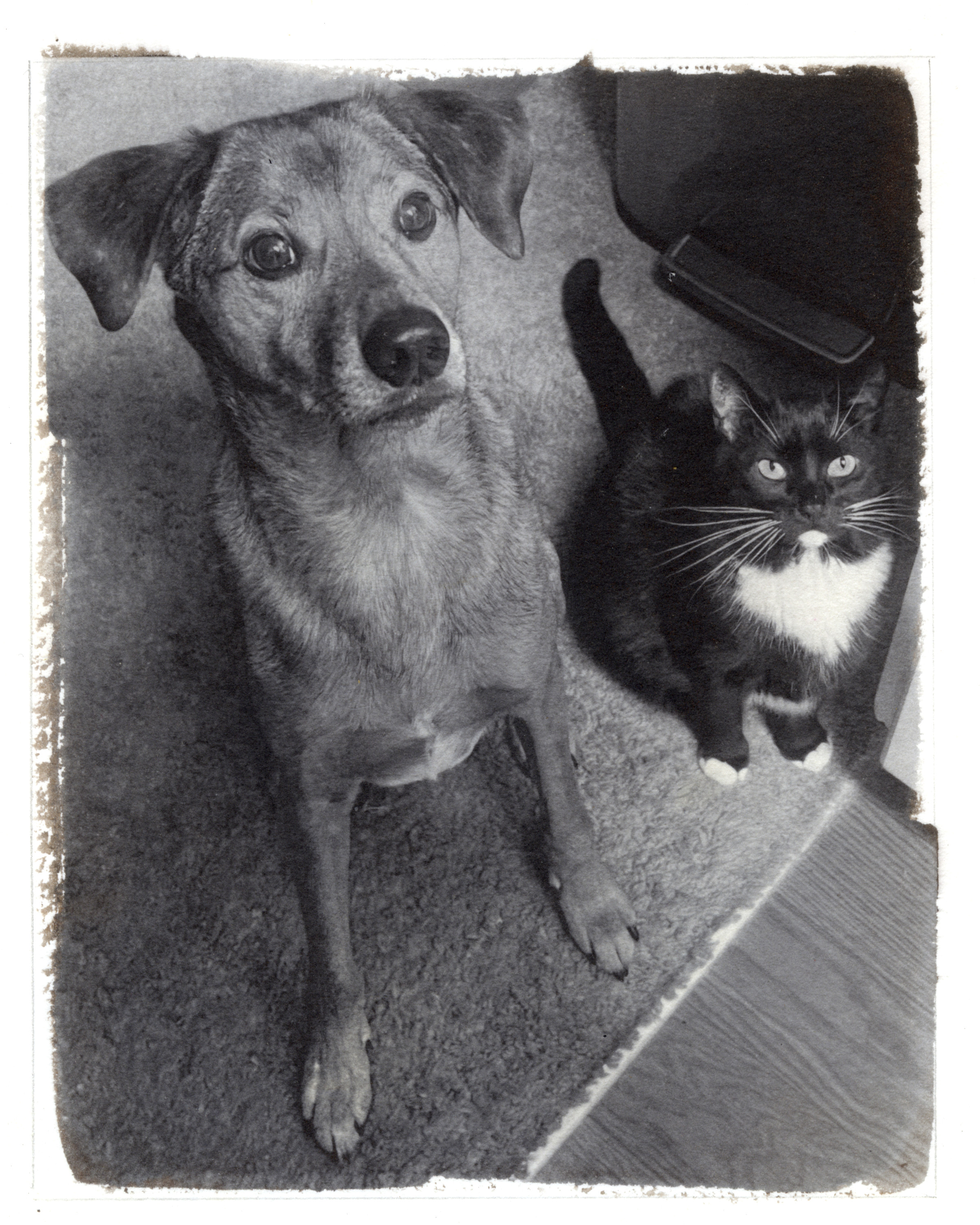

My other kallitype today is a Christmas present so it can't go up on Instagram -- Mose and Noodle waiting for their treats:

It will be a loved present!!

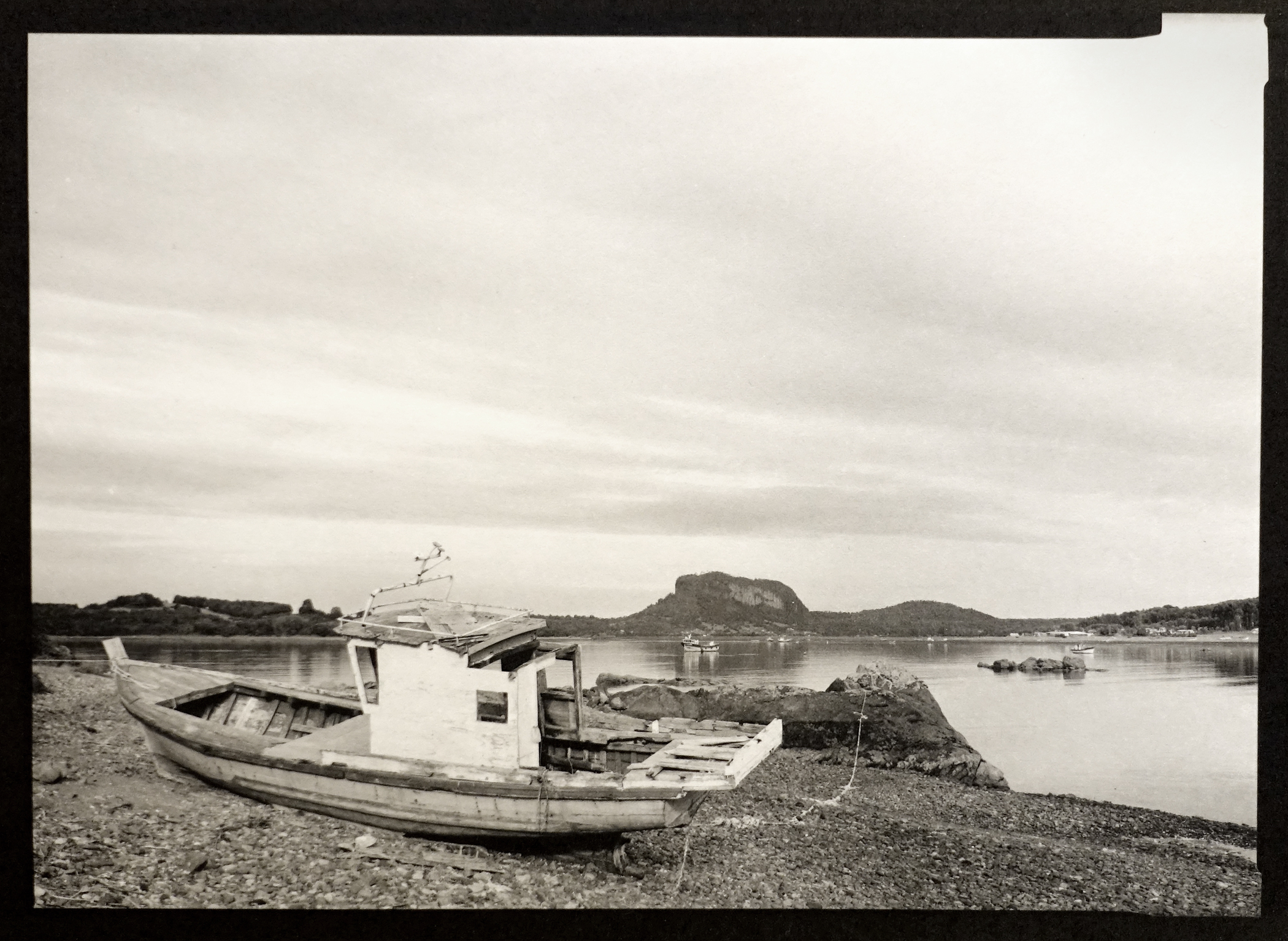

As close to a tourist image I have made, I think. Loved the light when I woke up -- my sons and I were camping on the shore just a hundred feet or so away.
Boat, Hualaihué, Chile, 2019
F22 at 1/8th second with a yellow filter, 5x7 FP4+, PyrocatHD
Platinum/palladium print

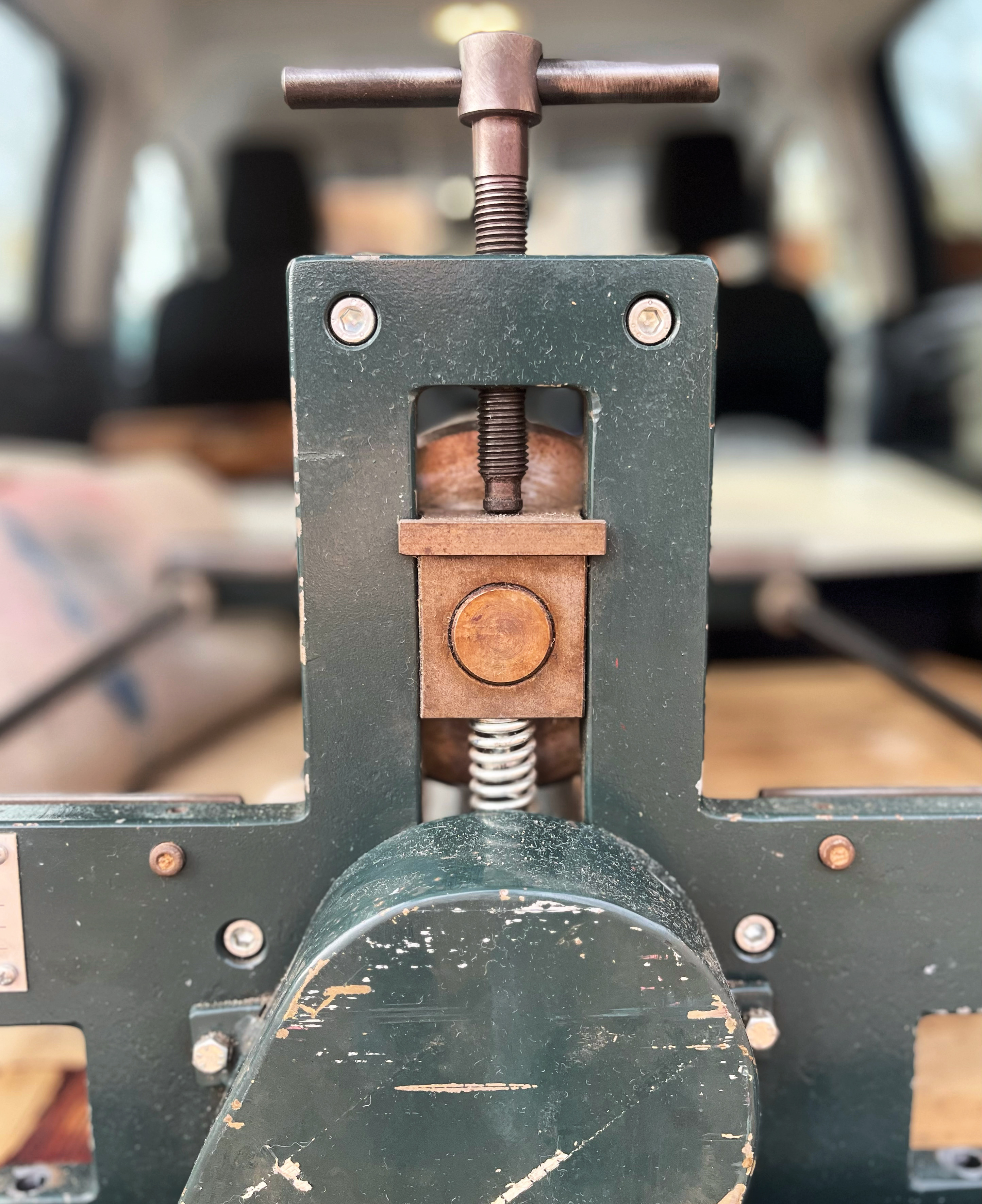

I've been wanting to dip my toe into ink for a long time now. Last week I located a used etching press near me, a 24x47-inch geared Polymetaal press from Holland. We agreed to a trade -- some cash, some prints -- and I will pick it up later this week.
Murray, if you were nearby we could join forces. I am starting with the press. Now I need to figure out the process. I have a lot to learn.
Lucky you for finding a press!
Are you suggesting that 49 hours of driving is too much for you to load up your press and bring it here so I can use it once in a while? kitimat to mars hill nc drive
I put out a search locally and there's a scruffy & somewhat abused looking 24" wide geared Ettan press in a middle school storage room that may be for sale, but the person hasn't gotten back to me.

Ah bronze bearings! Looks a bit like the press I once had - which was of course also Dutch.
You didn't take it apart for transport? I didn't either when I got it, but when I sold it off, I took it apart together with the buyer and the parts turned out to be surprisingly portable. The rollers are kind of heavy, but still doable.

I don’t know how to work it yet, but I now have a timeless work of Dutch engineering.
Congrats.
Living where I do, far from the madding crowds and in close proximity to wilderness has its benefits, but a small & thinly spread population makes such finds almost impossible.
I will now go pout in a corner for a while...
I took off its bed and base (not shown here) but otherwise left the press itself intact. It is elegant in its simplicity. Nothing showy, but beautiful in its functionality. But the bronze bearings are a nice touch. 😀
