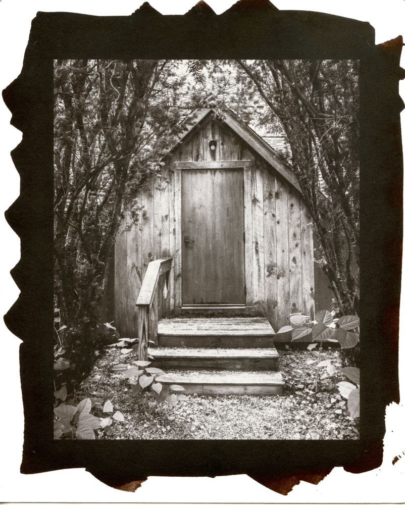

Things have been slow in this thread so here are a few salted-paper prints I made yesterday.
All are on 8x10 inch Hahnemühle Platinum Rag and the images are 6x7.5 inches or 6.5 inches square.
"The Back Door" (untoned)

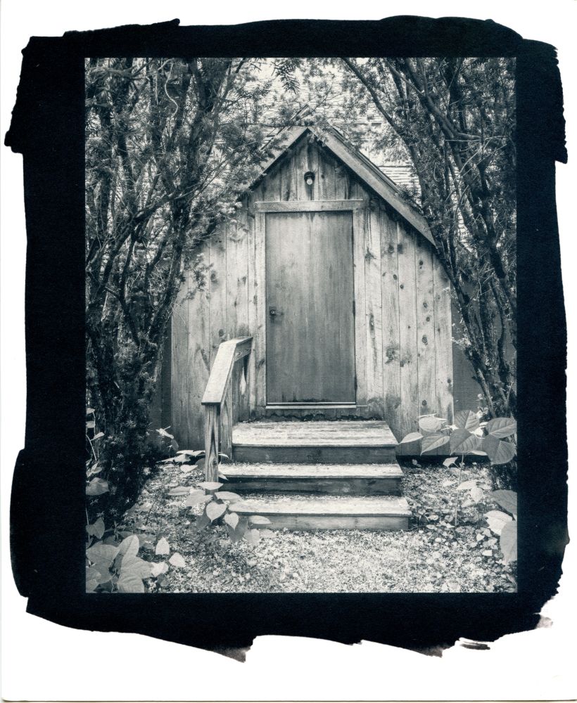

The Back Door (gold/bicarbonate toned)

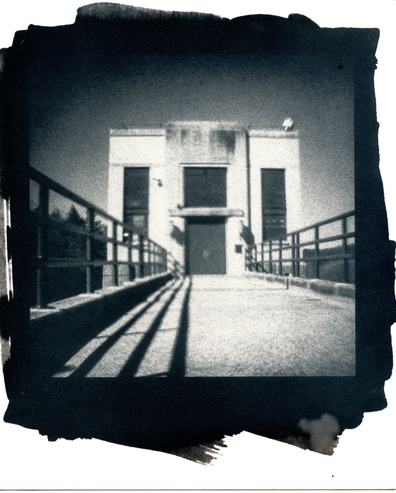

MacDowell Dam (gold/bicarbonate toned)

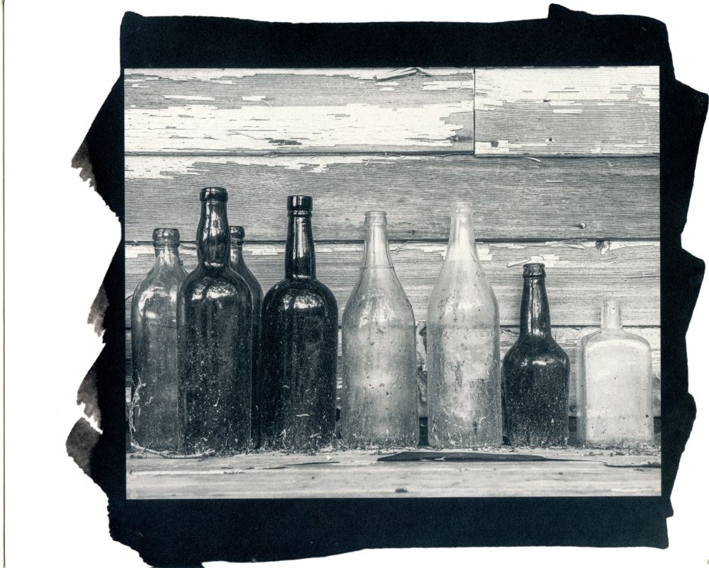

Bottles (gold/bicarbonate toned)
Thank you both for the kind words.
Yeah, wonderful prints and images., Frank. Interesting that the toned prints move almost to cyanotype blues (or is it that my eyes tricking me or may be digital duplication is doing the tricking.)
:Niranjan.
:Niranjan.
Niranjan,
Thanks!
The gold/bicarbonate prints in hand are certainly a neutral, bordering on cool gray. I'm not sure I would go so far as to say they are blue though.

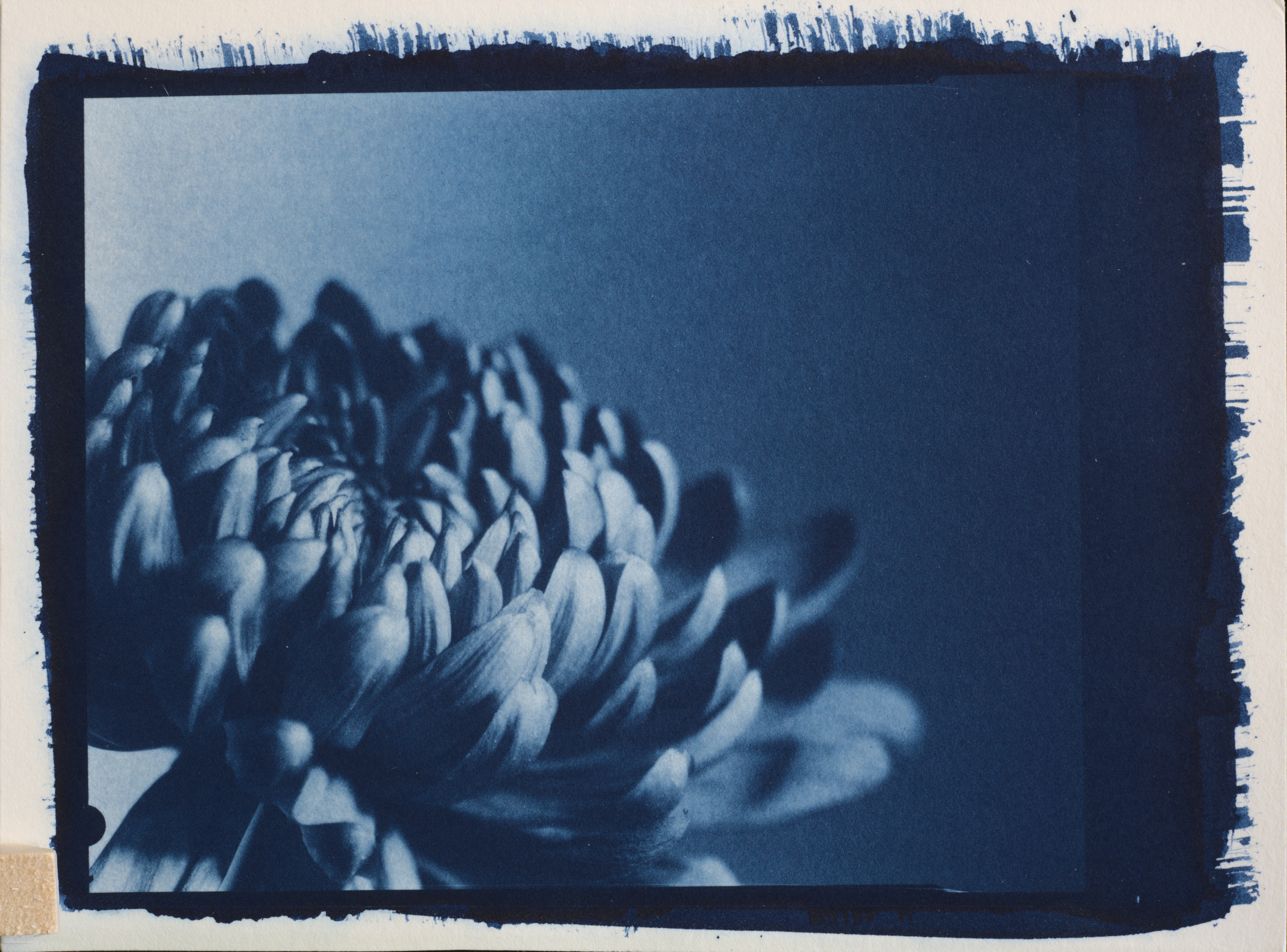

One of my first cyanotypes from a silver gelatin negative that I'm pretty happy with. Printed on a 6" by 4.5" sheet of Arches Aquarelle hot press paper.

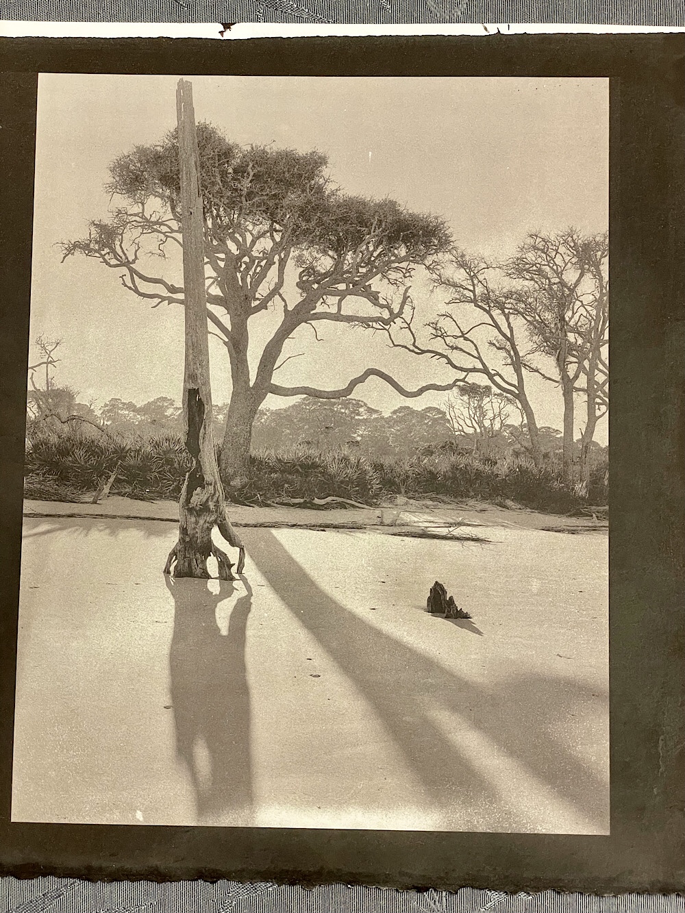

Digital negative from a 4x5 neg scan. Heavy coated van dyke. Finally got good shadow density. Possibly at Hunting Island State Park.

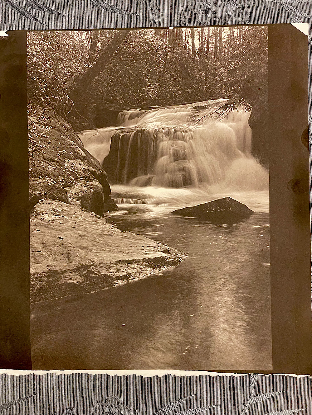

This concentration seems to give a better coating with no speckling with my puddle pusher. I plan on playing with a few other papers I have on hand.
This one is on Stonehenge.

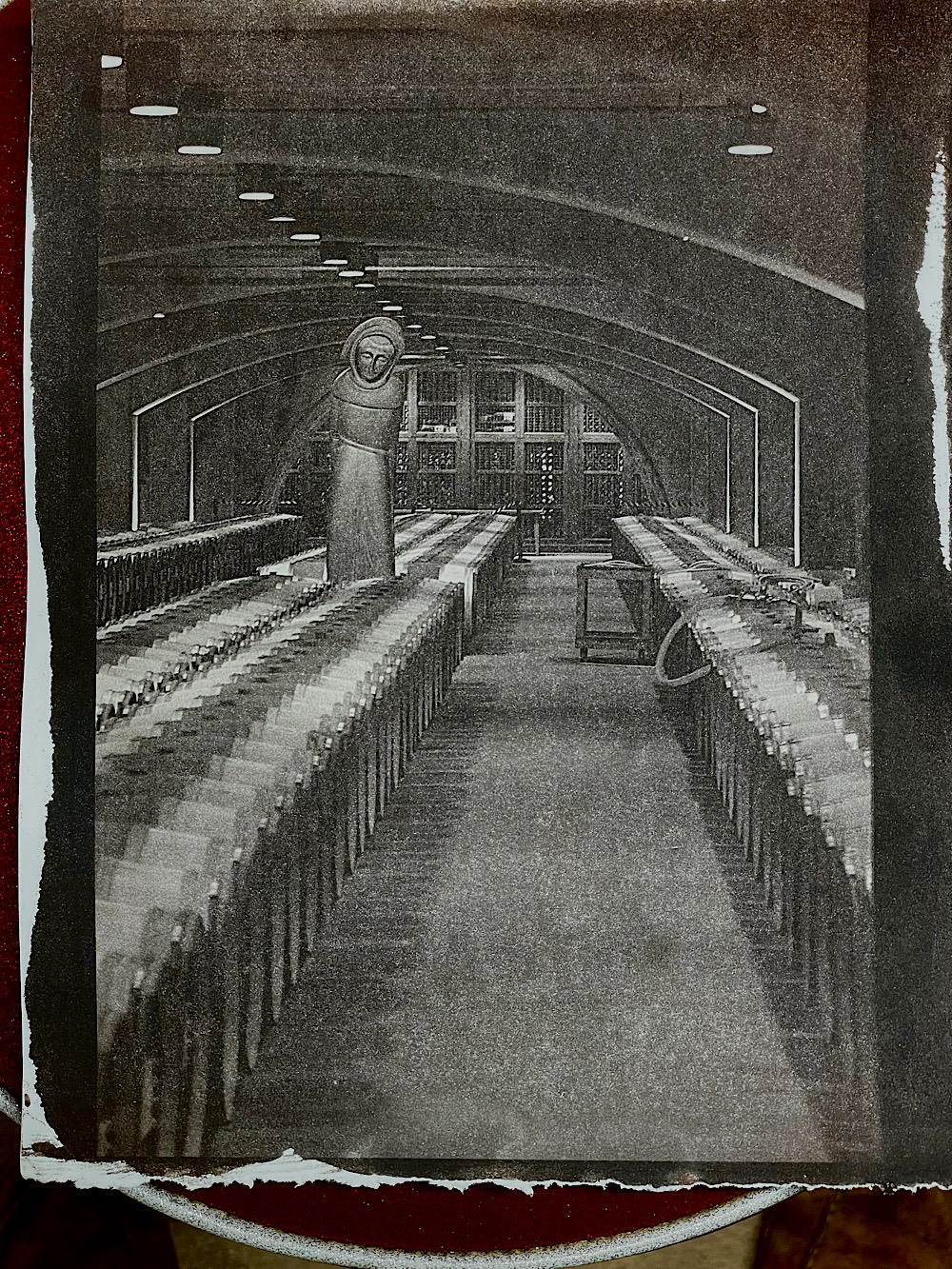

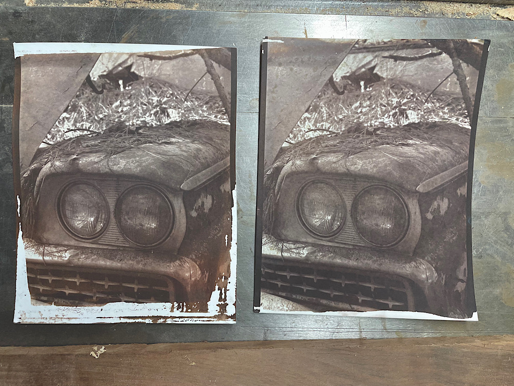

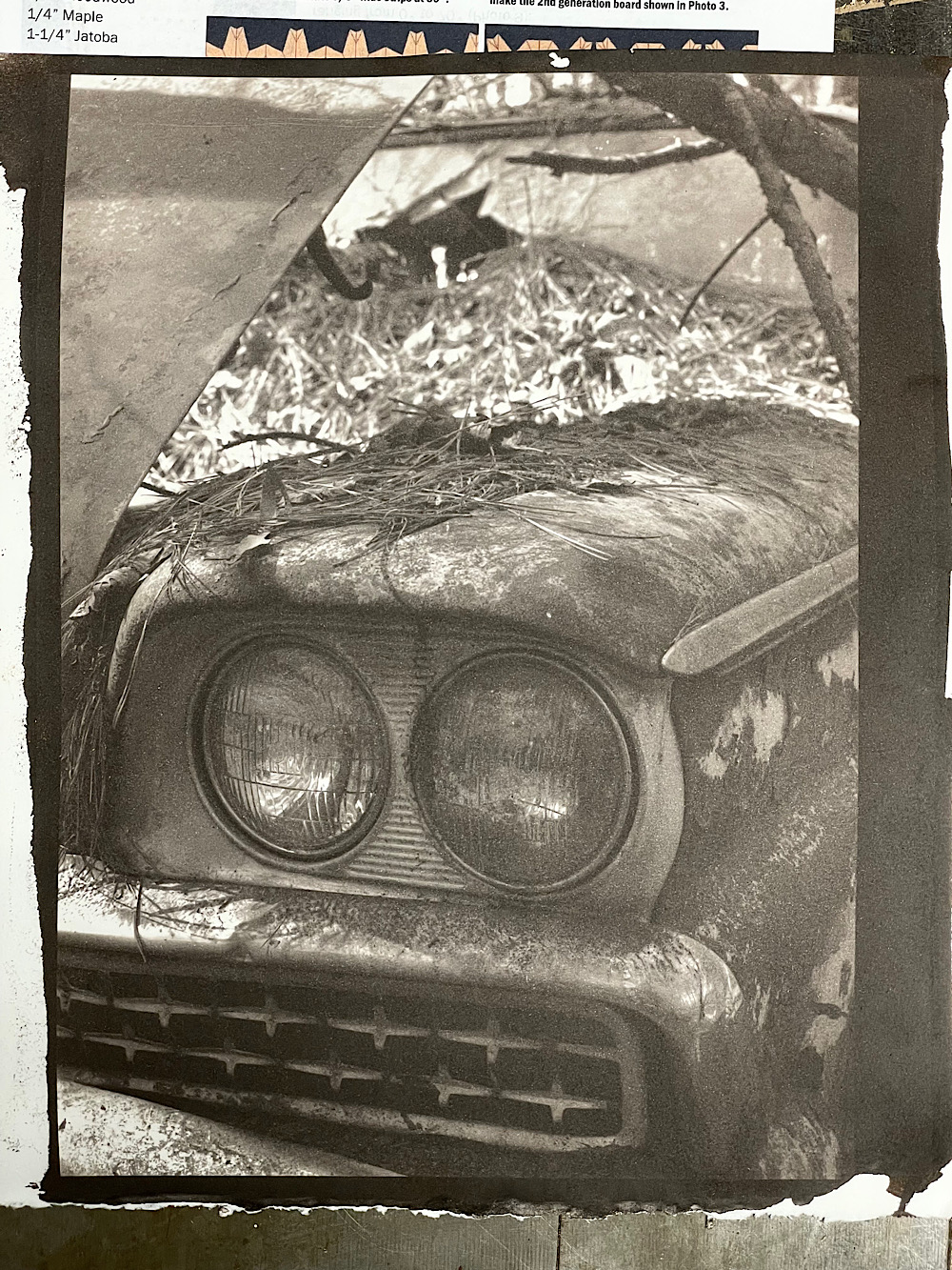

Heres todays efforts. I printed one on my Legion Stonehenge paper
then printed one on a unwashed sheet of Westminster Rag Board and one on a sheet soaked in a citric acid solution. The unwashed is on the left.
The unwashed has a distinct orangy tone while the washed sheet is closer to neutral a slight bit warmer than the Stonehenge. That may be a result of retained moisture even after two hours of drying in a heated drying cabinet. That is pretty thick paper.
