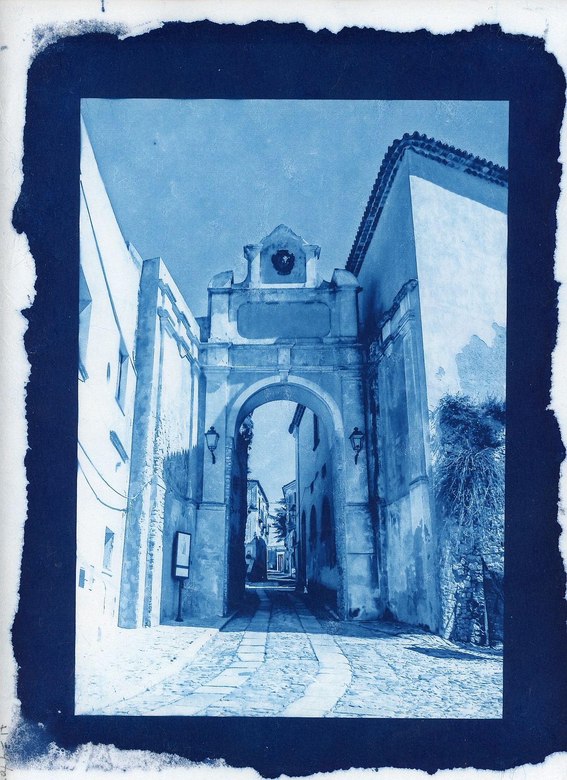

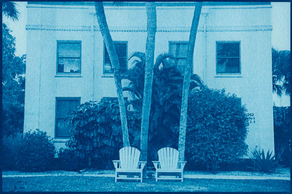

Yes I agree, my results are so variable based on paper ... here is one I made over the weekend on some 30# Kozo ( mulberry paper). I bought it on a whim in an art store, pretty difficult to coat but the results are really interesting. Need to fix my curve the highlights are a bit blown but not terrible. City gate, Gerace Italy (Calabria )
Nice prints Patrick. I really like the first one....

Thanks Dave.
30# is pretty heavy Kozo! I've had some heavyweight Kozo in the past. These days I use Thai Kozo from Blick which is fairly thin but is pretty inexpensive and works great. It holds up well in the wash though it can kink sometimes. The Hosho can tear easily so I usually give the image a larger border. Sometimes I pick it up and the corner just falls off. I make small prints too so I'd imagine larger prints would be a big problem for Hosho. This time around I intend to make some larger prints. I have made some 12" prints in the past but just for shits and giggles. I think larger prints on Kozo would be nice. Wish I had a bigger printer and contact frame. 14x17 is my max for my contact frame but my printer only goes to 13, so realistically, 12x16.
When I coat Kozo I use a hard surface like a sheet of plexi and let the chems permeate the paper. It is easier that way. I've been thinking about using a roller as well but I haven't tried it yet. I use a roller when I make gum prints. The roller would probably waste a lot of chemistry for cyanotype though.
Andrew, yeah, paper! I've tried over 100 different ones at this point. Kind of stupid really but variety is the spice of life and all. I really need to get my pile down to a couple that I like and that work. Thinking about buying a bunch of paper before the prices skyrocket too. We all know that is coming.

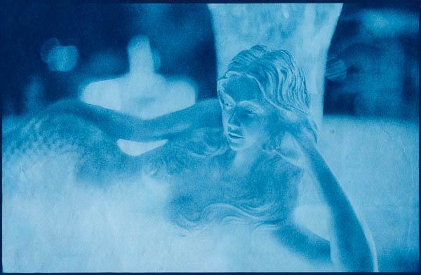

I was able to make a few new prints. It is funny how much we forget when we aren't exercising the knowledge. Getting back on track though. I still need to calibrate the negatives for each paper but that is so dull and I just have fun printing by best guess, though that results in a lot of waste. I did do a deep dive with the thousand or so prints I've made. Decided to limit the number of papers I use to make life simpler. My selections ended up being Kozo, Hosho, Somerset and Revere Platinum for cyanotype. Fabriano Studio for salt prints. Stonehenge for Gum and Gum overs. Fabriano Unica for Cuprotype. I like Bergger COT but I was buying the 16x20 and cutting it down. There were a lot of seams in the paper that were annoying. They showed up as a ripple and I couldn't get them flat. Otherwise it is a good paper. Maybe I'l try it in smaller sizes.
The first one is on Kozo. The second is on Bergger COT.
Interesting.

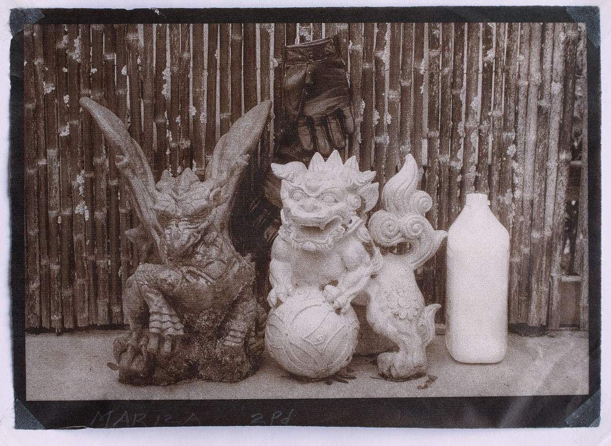

On coating thin Kozo or Gampi papers...
I haven't figured out how to get the typical brush patterns (black brushed edges with clear white paper beyond the brush strokes) typically seen with thicker papers when using thin Kozo or Gampi. Is it even possible?
What I've been doing is tearing the paper just past the image area so as to give the image a thin black border.
On a sheet of glass, the Washi gets thoroughly wetted out with distilled water ensuring it is completely flat and uniformly wet. Next, I take a piece of plain brown newsprint and press it down on the Washi, making sure not to soak up too much of the water. Wipe up any excess water from around the paper.
Then the sensitizer gets brushed on making sure not to apply too much pressure with as few strokes as possible, while ensuring even coverage...some surfaces are easily damaged. Wetting the paper first ensures even sensitizer spread.
A fan then blows air over the sensitized paper while still on the glass sheet for about 20 to 30 minutes. Mine stays stuck to the glass, gets peeled off easily with the help of a razor blade at a corner, and comes up completely flat.
Plan is to mount these using a traditional Japanese wheat starch glue onto a heavier sheet of Kozo, or maybe a western paper.
Palladium toned Argyrotype on 21gsm Gampi: (Jug handle there for pure white, glove shadows for pure black)

I've found the coating spreads on Kozo and Hosho. I doubt you could get a brush mark to set and be sharp.
I use wheat starch to mount my Kozo prints on thicker paper like watercolor or bristol. I usually just do the top corners and let it float. Before mounting I cut the prints near the border to clean them up.
I'll have to try your top corner method and compare it to a full mount onto a backing/support paper.
The 21gsm paper I'm using is so thin that if it isn't pressed right against white backing paper, the whites in the image go very bland. Subtle textures also seem to get lost. Full wheat starch mounting would make sure light passes through the Washi & reflects back to give a good white and would also provide protection. The stuff is surprisingly strong, but looks like compressed spider webs.

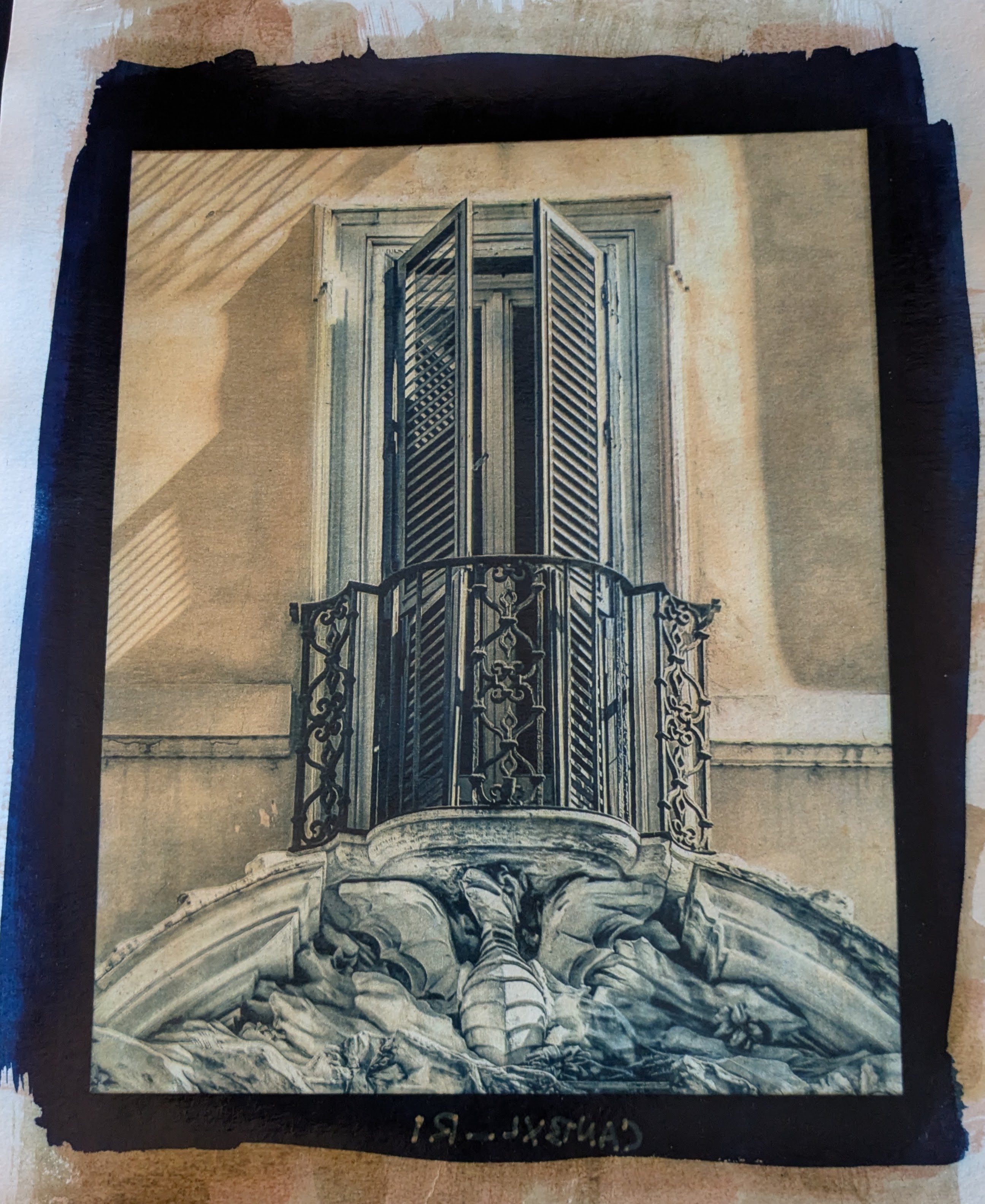

Patrick— Paper choices are making me feel like a rat in a Skinner Box, but I was curious how you salt (and acidify?) your Fabriano paper? I’ve got some Revere Platinum and COT 320/160 to play with but I really like the textures I’ve seen from the Fabriano.

What Fabriano paper are you using? The Studio paper is different from the Artistico which is different from.... The Studio paper is pretty inexpensive so I appreciate that since I am just futzing around these days. I use the Hot Press version.
For Salt I just do it the normal way and don't acidify it. Coat the salt, let it dry, coat the silver.... If I am going to acidify for cyanotype then I usually use Sulfamic Acid but sometimes I get lazy and just use Citric. I leave it in the acid a little while after the paper stops bubbling. All straight forward. Usually acidifying the paper speeds it up and gives better tones. I don't recall any papers that didn't improve with pre-acidifying for cyanotype.
For Fabriano Artistico a 5 min bath of 3% NaCl + 5% H3Cit, followed by coating with 15% AgNO3 works nicely. No pre-acidification needed.
Or you can float COT 160 in 40°C 3% NaCl + 5% H3Cit + 1% gelatin for 30s, and get a slightly higher Dmax.
