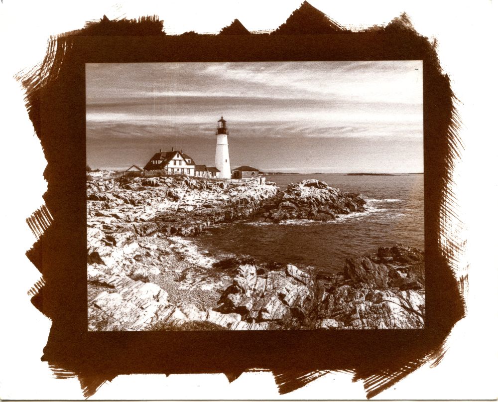

Any way... here are two new salted-paper prints made this afternoon.
Both are 4x5 inch images from digital negatives on Hahn. Pt Rag paper. I am aiming/hoping to eventually make 11x14ish images. (If I get there, they will be the largest salt prints I have ever made)
Portland Head (Maine) Light - from an exposure made several weeks ago.

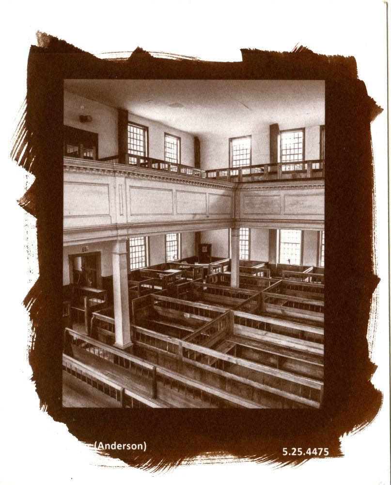

Meetinghouse Interior (Rockingham, Vermont) - from an exposure made about ten days ago.

Excellent prints, both of them, great subject matter and comp. I like the tone, I have seen some salt prints that are more "ruddy" sort of a bit of reddish color to them - while these are a what I would call a warm black ... I am assuming no secondary toning. Be interested in seeing how they come out at 11 X 14, I have never tried to make any larger than 8X10.

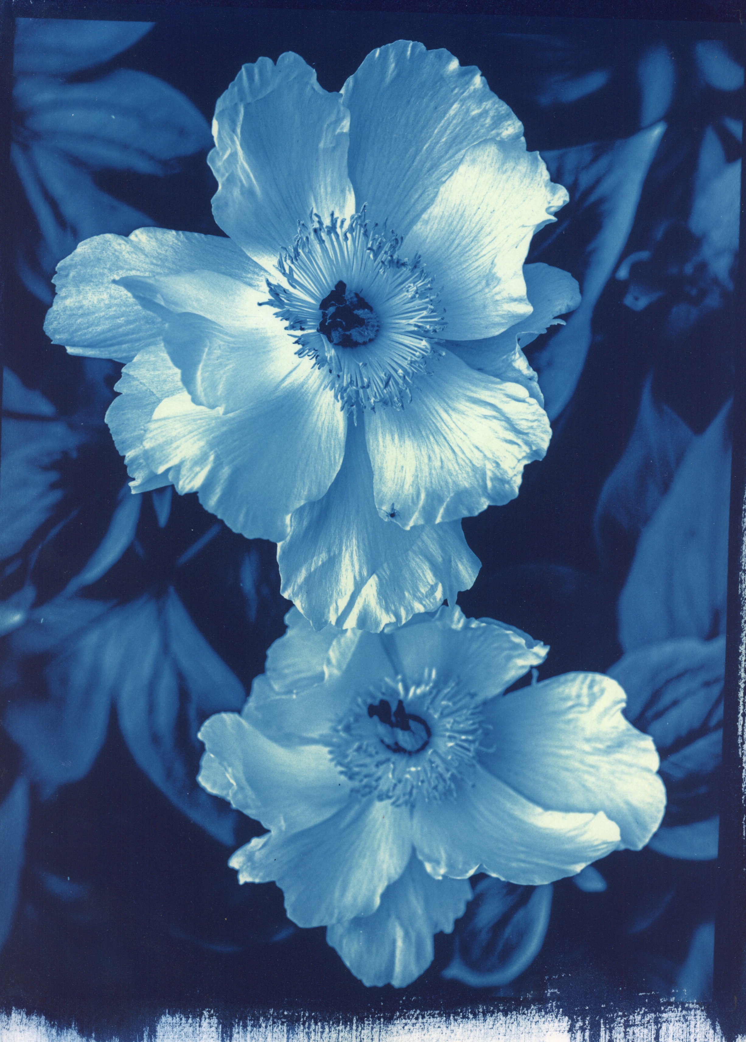

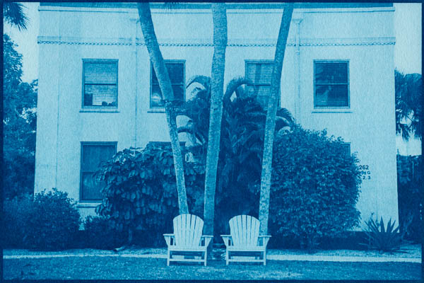

Coincidentally, I just made some cyanotypes for the first time in several months - I purchased a bottle of the " new cyanotype" with some other supplies I was ordering and printed this print on Arches watercolor ..... I will say I like the really deep blues it produces.

Nice Dave. I've never tried the new Cyanotype method. Quite striking. Almost looks unreal! Curious how you would compare it to the traditional method.
I bought some Arches watercolor paper in my last stack of paper purchase. I'm going to blame you if it doesn't work out! Lol.

Patrick,
The "new cyanotype" is somewhat ( maybe a full stop) faster than the traditional, is a single solution and is developed ( according to CZ Anderson) in either a dilute sulfamic( 1/2 tbs/liter) or citric acid. Also it doesn't develop mold like the traditional - if you mix your own.
I purchased a 100 ml bottle from Mountain Intaglio ( Clay harmon's studio) for about $20. A cheap way to get started. Clay has told me that if you mix it 1:1 with water the resulting color is more like traditional cyanotype. HoweverI really like the deep blue/black.
Arches Watercolor is a great paper for cyanotype however it is buffered and it works best with cyanotype ( trad or new) if you add a drop of 40% citric acid for every ml of solution... this gives the best results for me.
@Patrick Robert James
Also relevant to mention in addition to the above is that the NEw Cyanotype response curve is totally different from classic cyanotype; the latter works well with negatives with a tonal range of around 1.5-1.8logD whereas New Cyanotype requires around 2.1logD. In my experience, New Cyanotype requires a strong acid (albeit dilute) to properly develop without staining; e.g. it may not work well with dilute acetic or citric acid (dilute hydrochloric acid e.g. 0.1% works well). New Cyanotype is much more finicky w.r.t. paper chemistry; papers that work great for classic cyanotype may not work well (lots of staining and low dmax) for New Cyanotype.
Properly made, the color and intensity of the blue on New Cyanotype is the same as for classic cyanotype, but there is lots of variance in cyanotype dmax among practitioners due to process and material variations. The difference are not inherent to the chemistry, however.
Thanks for the kind words.
No secondary toning. Not sure how I get the tone I do, but I like it!
My usual 'large' print is a 6x7.5 inch image on an 8x10 inch sheet.
I'll probably use one quarter of a 22x30 inch sheet of HPR for a larger print... in other words an 11x15 inch sheet. I guess that would mean an image of 9x11.25 inches.

This is a spectacular cyanotype. Really great dynamic range.
I've been using the classic cyanotype formula but your print has me thinking that I should investigate the newer options.
Patrick,
I have had good luck with cyanotype on many papers, including carbonate buffered ones, by using a solution of 10% vinegar as a 'developer'.
Prussian Blue is hydrolyzed under alkaline conditions. My guess is that the citric acid you use or the vinegar I use neutralize the carbonate buffer in the paper quickly enough that little if any hydrolysis occurs.

I had some free time on the weekend and used it to make the large salted-paper print I mentioned above (post #804).
The image is 9x11.5 inches on a quarter sheet (11x15 inches) of HPR. I used a 3" brush for coating and a single tray for processing. I usually use multiple trays which allows me to be more efficient when making multiple prints in a single session.
However, I only have a few trays large enough for an 11x15 inch sheet of paper nor do I have the counter space for enough trays that large. Furthermore, since I was only planning on making two prints efficiency was not critical.
Anyway, here is a cell phone photo of one of the prints laid out on the floor. I don't have a scanner large enough for an 11x15 inch sheet either! 🙂
Rockingham VT Meetinghouse Interior 9x11_5 image on 11x15 paper (1000 pxl ls).jpg

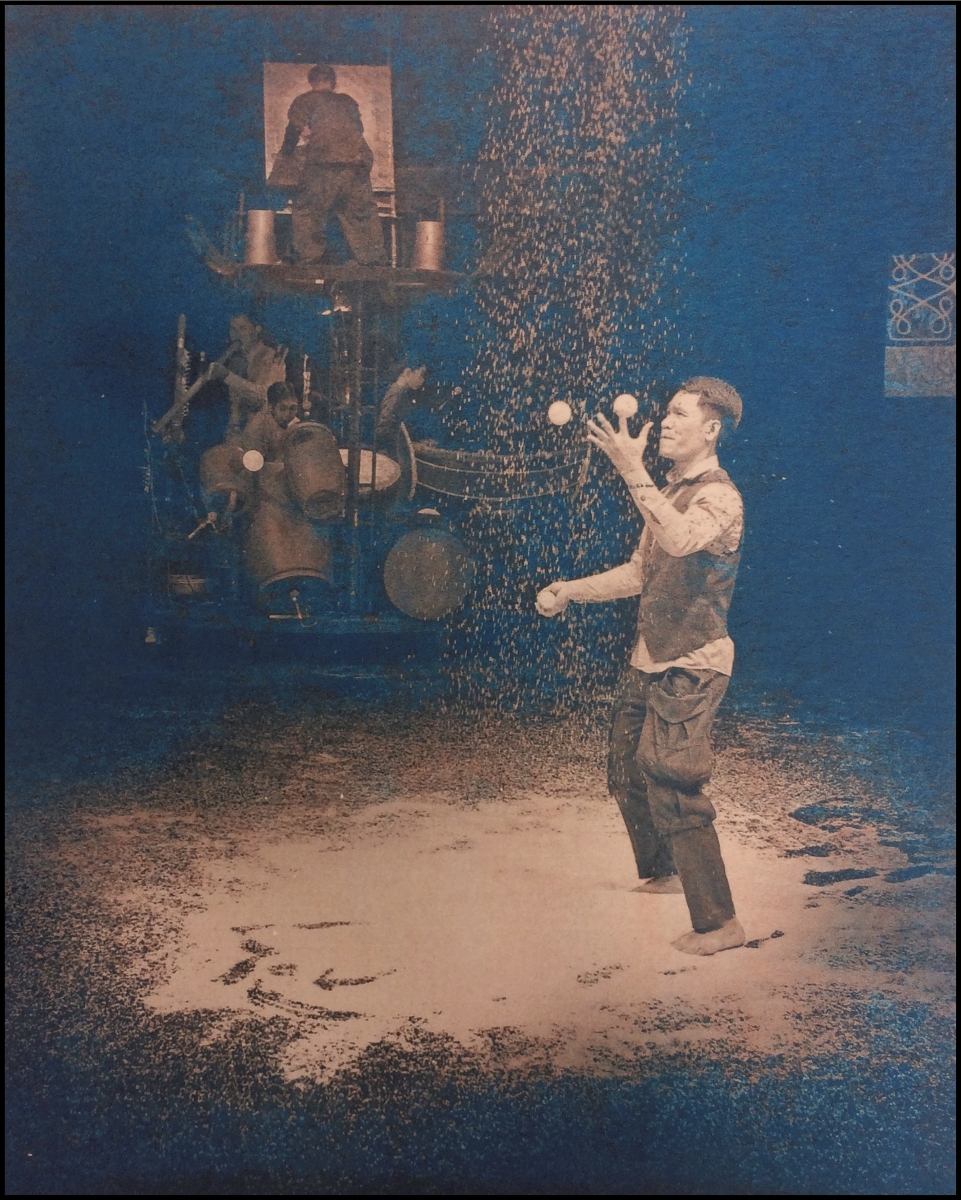

@Debanjan loaned a few of his digital negatives for me to print in FerroBlend process. Debanjan is an ace gum printer and dabbles in a number of alt processes effortlessly making very compelling prints with distinct aesthetics. Nevertheless, he gave me complete freedom to print his negatives as I saw fit. Thanks @Debanjan.
Here are two FerroBlend prints, a kind of variation on the same theme, from one of his negatives.
