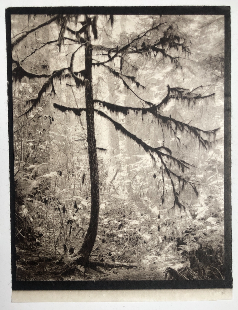

Last print of 2025 - platinum & palladium toned kallitype(sodium citrate) on 8x10 Bergger COT 320

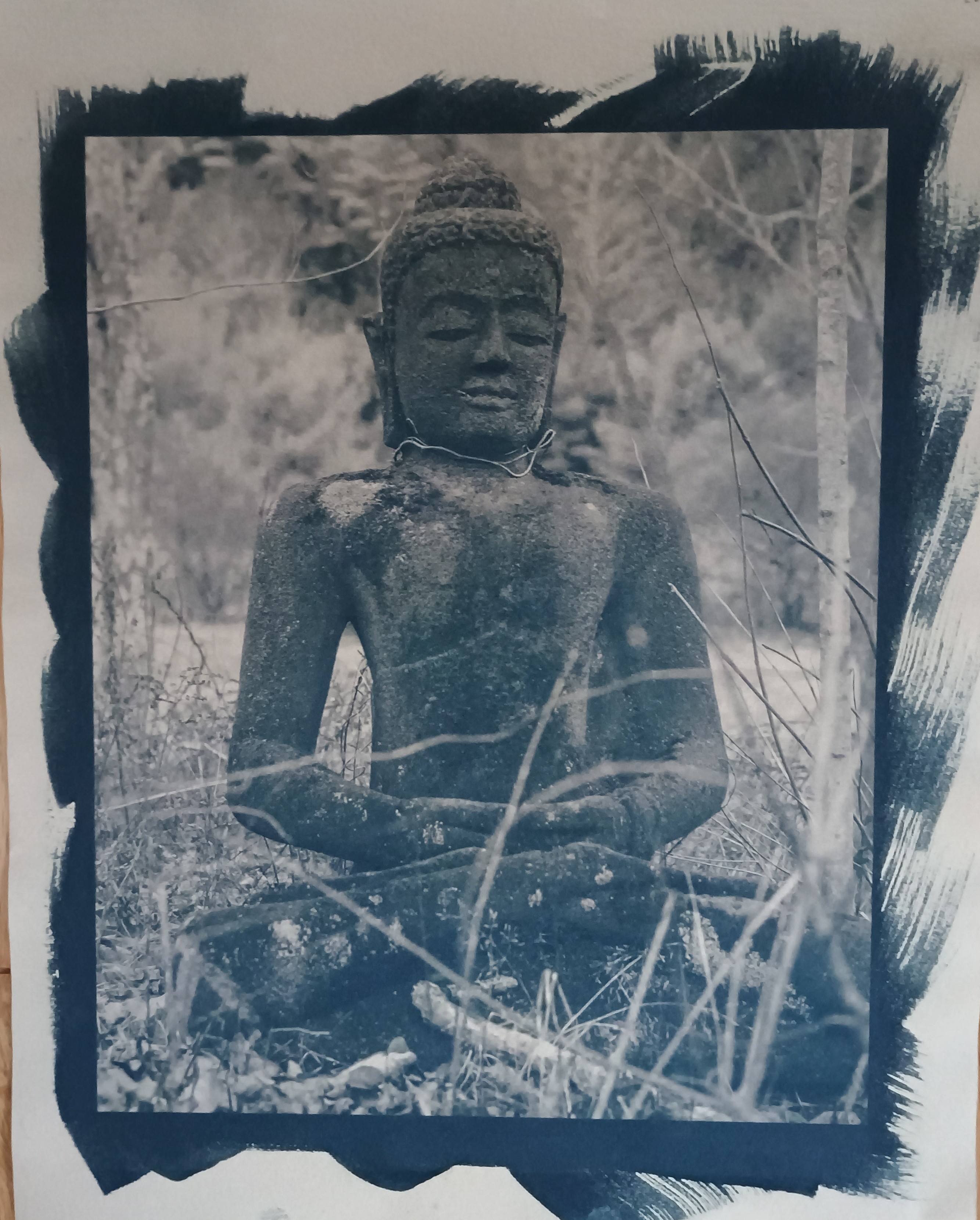

Here's one such cyanotype, coffee toned. I've printed this before in smaller sizes and without toning and I think the untoned version actually looks better for this subject so I might make another one.

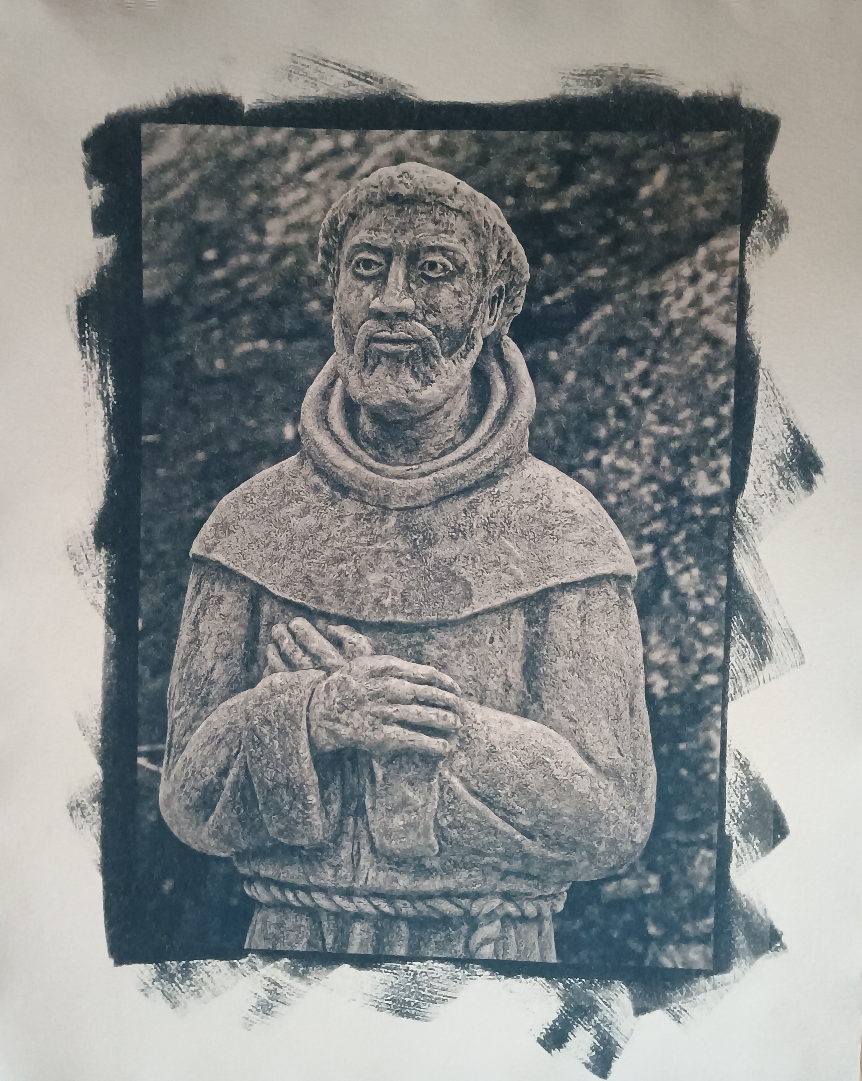

Stone Friar
(image about 8x10 inches on Hahn. Biblio paper)

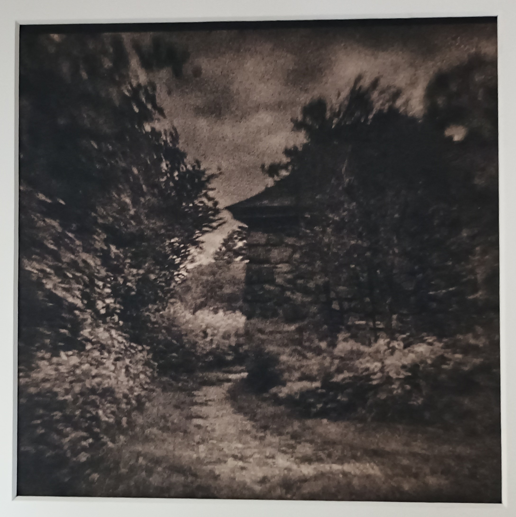

Two more... cyanotypes toned with sumac.
Garden Path
(image about 9.5 inches square on 12 inch square Fabriano Studio HP paper; it is already in a mat)
Garden Path, Harris Center (cyanotype toned with sumac on Fabriano Studio HP).jpg

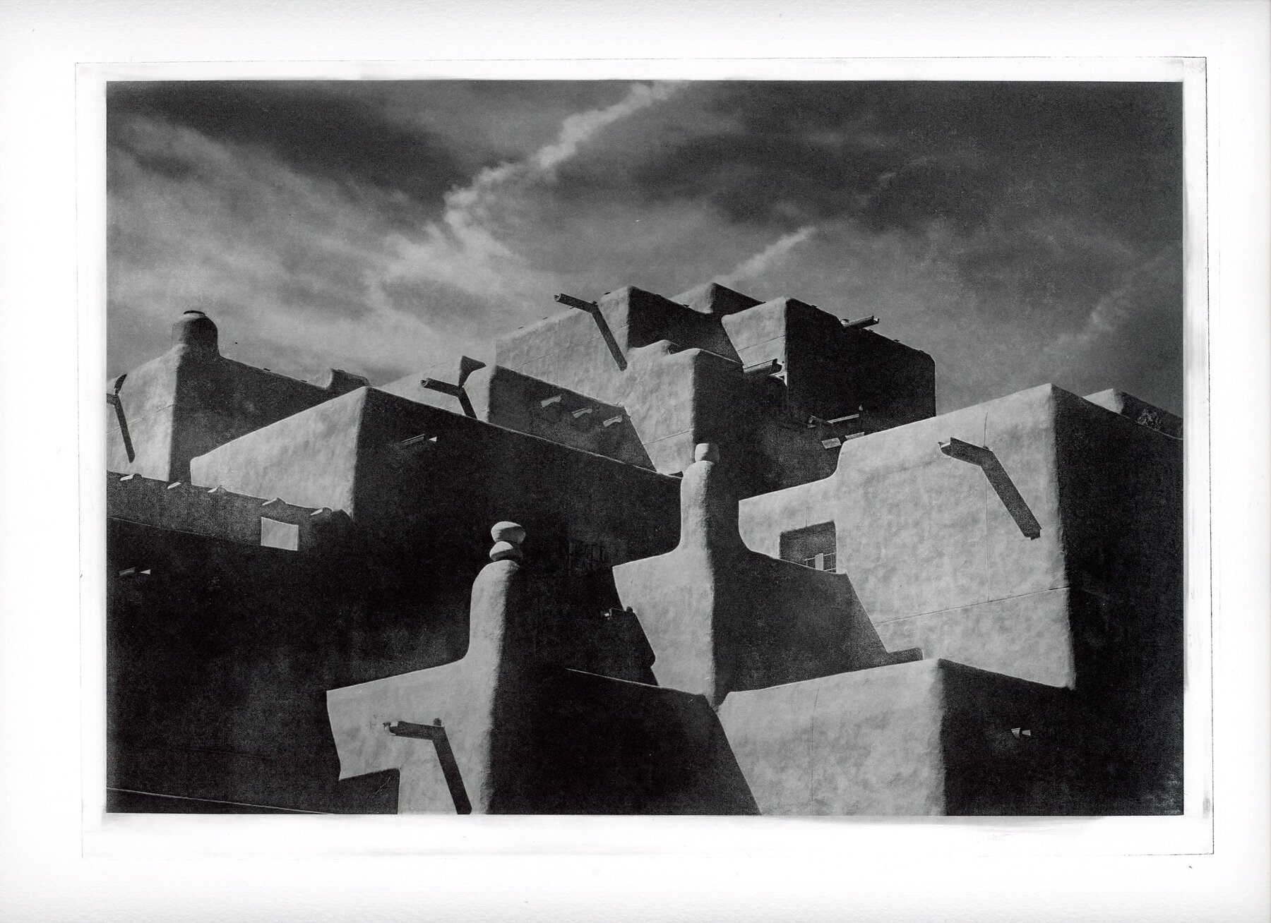

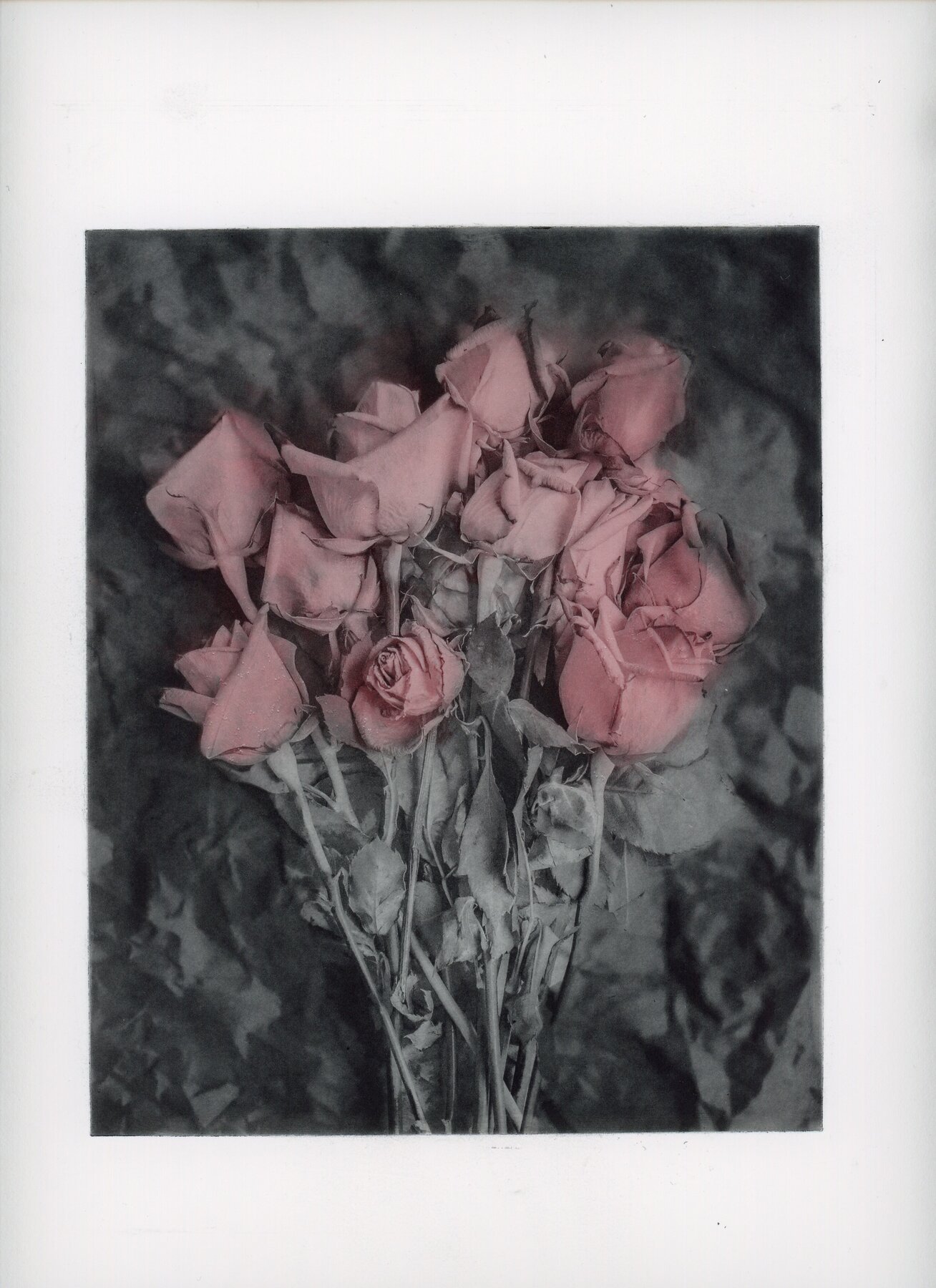

Two recent photogravures, one from Santa Fe and some wilted flowers à la poupée. Both on Hahnemuhle Durer. Have some cyanos I want to tone with recently collected birch calkins - will see how that comes out ...
