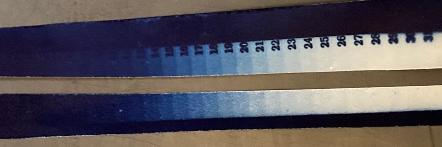

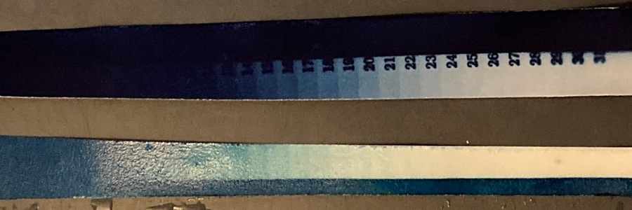

Reporting back.
  • Ascorbic acid works. Well. First pic below shows result of 1% ascorbic acid for 30 seconds.
  • That was too strong, too fast. Next time 0.5% or less.
  • A big plus: the color is preserved, in contrast with bleaching with carbonate.
Second stage: hydrogen peroxide. 0.3% solution (3% medical grade, aka "10 volumes", diluted 1+9) for 30 seconds.
  • Just undoes the action of ascorbic acid and reverts to original state.

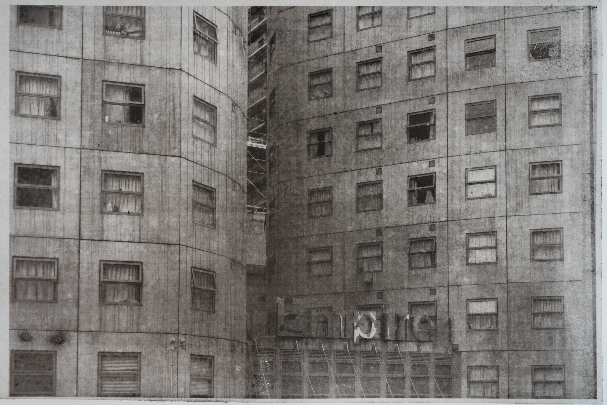

Finally starting to get some reasonable results from my PVA-SbQ photopolymer process. Still a lot of work to be done but I appreciate the gritty feel of the current print, at least it works for this subject. 4 layers of pigmented PVA-SbQ (variable pigment load per layer), coated and exposed one-at-a-time and then developed once at the end. Coated on hardened gelatine sized HPR. It's a small print, about 8x10, and I think it would look really nice printed bigger.
This stuff is perfectly suited to exposure via projection. A cyanotype of this size would be about a 30 minute exposure, and this was about 18 seconds (cumulative across all 4 layers). So something like 100 times faster than classic cyanotype. I bet that you could do in-camera exposures with it, but then I don't know how you'd get a good tonal range.

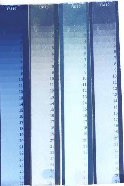

Test result below. Left-to-right 1-2-3-4.
  1. New cyanotype sensitizer, 0.8cm3 + 1 drop citric acid 20% + 1 drop PhotoFlo600 1/30. Developed in 1% HCl 2 mins with agitation. Wash ~10min with agitation.
  2. Ditto + 30 s in 1% w/v sodium carbonate. (overcooked?). Wash ~10min with agitation.
  3. Ditto + 30 in 1% w/v ascorbic acid. Wash ~10min with agitation.
  4. Ditto + 3mins in 0.3% hydrogen peroxide.
Notes.
  • Carbonate 1% is too fast acting. Should reduce to 0.5% or 0.2%.
  • Ascorbic acid. I did not reduce the concentration, with the thought that Prussian white must be eliminated and any fading of Prussian blue should be reversed in the next stage. Still difficult to know:
    • How much/long is enough
    • Any adverse effects from doing that stage more than enough
  • Hydrogen peroxide restores (qualitatively) the density resulting from step 2. Also restores some, but not all of the blue color that was present at stage 1.
More work is needed IMO to make this a tool. And, anyone is free to find the tone at stage 2 or 4 (not 3, which I understand is not stable in the presence of atmospheric oxygen) interesting/pleasing.
