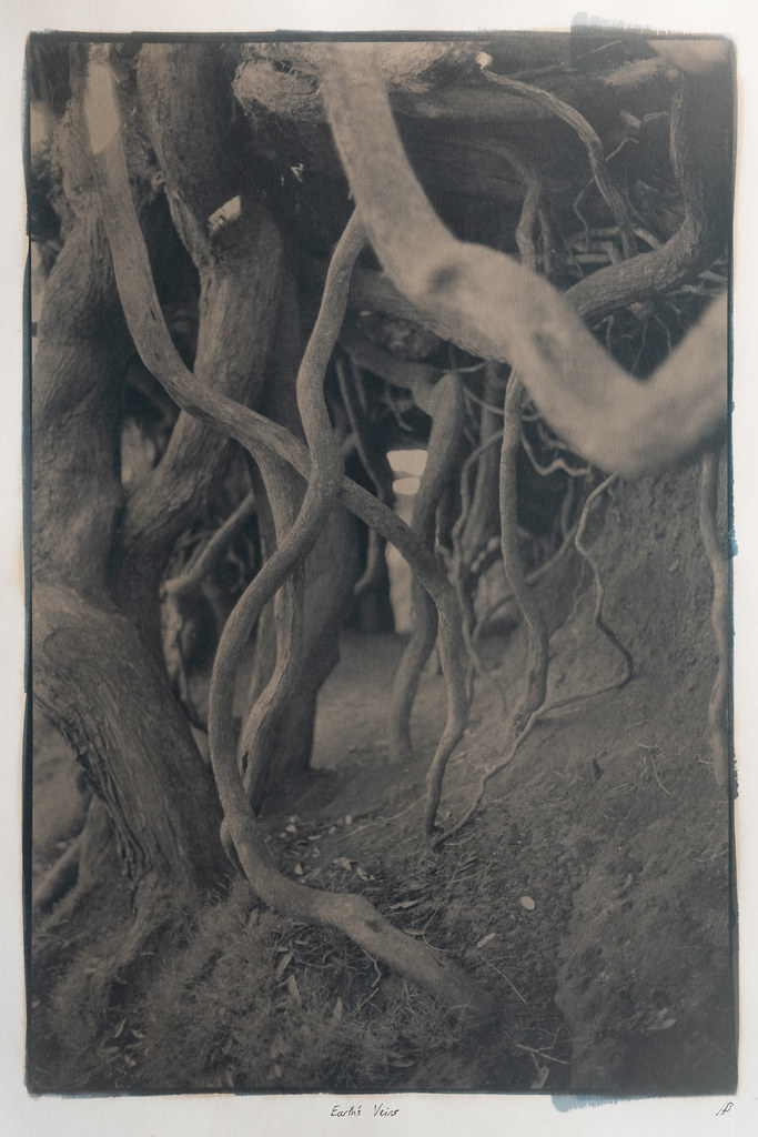

I have a bunch of 11x14 negatives I'd like to print so I made a couple pt/pd work prints last night to get the cobwebs out of the system. Several of the negs are from Zion NP. A good start; some techniques to refine (I've been printing small recently) and other changes to make (use a bit more solution, for example) to fine tune pt/pd and get into the groove again.
This image worked out pretty sweet, but need to live with it awhile. Will re-print.
The Checkerboard Mesa area of Zion...It was quite the climb with the 11x14 (Fuji W 360/6.3).
Pt/pd on HPR, developed in warm Potassium oxalate

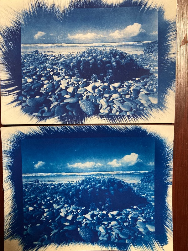

Nothing really to show off, but a progress report. I went back to (New) cyanotype after a long interruption.
Some information:
  • New cyanotype sensitizer is long-lived. Mike Ware states in one of his documents "4 to 5 years". Mine was 11 years old and worked to my full satisfaction.
  • Canson Lavis Technique paper works well without acidifying.
  • Adding citric acid --to keep the sensitized paper nice and yellow-- really works. At first the paper turned to lime color when drying; adding one drop of 20% citric acid per cc of sensitizer fixed that.
  • Cheap OHP transparencies on a cheap inkjet (Canon 4250) can deliver digital negatives suitable for New cyanotype, provided, in the print setup, I enter manual color/intensity and push the Intensity slider to max. This might be exceeding the absorption capacity of the transparency, and I'll try better ones from Novalith.
Sample results. And, yes, I know, the brush strokes at the edge are considered bad taste.
Some questions: I made a second batch of printings of the same negatives, same chemistry, same exposure, but the prints in the second batch seem to be darker than the first. Only difference was: for the first batch, I dried each sheet, after coating, with a hair drier, while for the second batch I let the coated papers air-dry for ~1 hour. I remember reading something about hygrometry.
  • Anyone knows which way it goes: more humidity ==> {darker | lighter} prints?
  • Recommended method(s) to ensure consistent hygrometry (I won't buy a cigar humidifier!)
  • Anyone knows a method, similar to Farmer's reducer for silver prints, to lighten a cyanotype without altering significantly the color?
Top: first batch; bottom: second batch (still damp from washing)
Yeah, that's how (darker) I would expect.
You can make your own humidity chamber with saturated salt solution which corresponds to about 77% RH, the kind they use for Ware-Malde palladium process.
Prussian blue is soluble in solutions of Na/K oxalate. It will take density away from everywhere though. You can try that. Of course you can also "bleach" it with an alkali but that turns blue into yellow ferric hydroxide, shifting the overall color a bit towards green depending on extent.

Habib Saidane has a video in his YouTube channel where he takes an overexposed New Cyanotype print, bleaches it a bit with Sodium Carbonate and then redevelops in Peroxide to get a more acceptable print without the yellow that one usually sees after bleaching. I haven't tried it but could be relevant in this context.
It also looks like the slow-dried sample printed faster.
I've personally not found it necessary to control humidity of the paper with New Cyanotype provided the paper is compatible with the process and the chemistry is in order. The fact that the sensitized paper shifts in color without adding citric acid suggests that you're using a carbonate-buffered paper and you may find that if you neutralize that buffer before printing, the printing becomes more consistent.
I feel it is equally important to control the humidity in the paper before coating as well, if not more. My process for classic cyano is to equilibrate the paper in salt chamber overnight before coating and then after coating, air-dry the paper in a box for 15 minutes whereby the surface becomes matte followed by 8-10 min in a 50C environment for about 10 mins at which point it is bone dry. Expose right afterwards.
I watched the video
and tried this on my "second batch" (too dark).
  • reduces density as advertised
  • but also de-saturates the characteristic cyanotype blue
  • and hydrogen peroxide does not do much
I guess I'll have to pay more attention to "details" such as hygrometry.

Yes. All I have is a plastic container with a lid at the bottom of which I put some water and enough salt so that not all is dissolved. On top of this there is a platform where put my paper and close the lid tight. Then the container goes into a big cardboard box lined with styrofoam with a temperature controller hooked to a incandescent lamp that keeps the temperature at 77C. However, RH over saturated salt has a weak dependence on temperature so perhaps one can forgo the temperature controlled box and leave the plastic container out in the room as long as the temperature does not have wild swings (as it did in my old place.)
The 50C environment is nothing but a commercial toaster oven with a convection fan that I calibrate with a temperature probe. It can take 9x12 or so size paper. I normally do one print at a time so this set up works, but someone making several print at a time might have to DIY this too.

Regarding cyanotype and humidity...
In my experience cyanotype is probably the process that is least sensitive to humidity. I have made successful cyanotypes with the ambient relative humidity ranging from 32% to 80%. I don't know if these are the limits as my records don't show values outside of this range.
The temperature in my unfinished basement dim room varies from about 80 deg. F (at the peak of a summer heat wave, which is also when the humidity is highest) to about 45 deg. F (during the winter when the humidity runs 40-45%). Below about 45 deg. F, I start up the wood stove and get the temperature up to the mid 50s but this lowers the humidity to below 40%.
None of this seems to affect my printing of cyanotypes. This is not the case for salted paper printing which I only attempt when the humidity is above 45%.
My un-sensitized paper is stored in the space where I print and thus is equilibrated to the ambient humidity (and temperature) at which it is printed. I have never noticed any drastic differences in how paper coats with cyanotype sensitizer and I have used many different papers.
The only accommodation I make regarding humidity is a crude adjustment to the drying time (i.e. the interval between coating and exposure). My standard drying time is 1 hour. (i never use forced air to dry coated paper.) If the humidity is above 70%, I'll add 15 min to the drying time before exposing the first sheet of paper. If the humidity is less than 40%, I'll subtract 15 min.
I say 'first sheet of paper' above because I often coat paper in small batches (say 6 or 8 sheets) for one printing session. Thus subsequent sheets are printed after longer drying times (up to maybe a couple of hours, although I do not keep detailed records on this).
