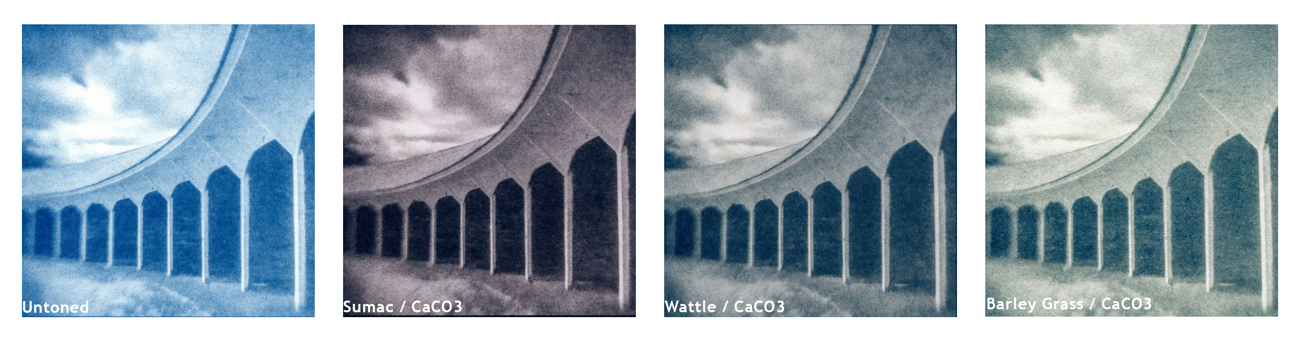

I am working on an edition of twelve cyanotypes for a group portfolio... one print from each of twelve people; each contributor receives a copy of the complete folio.
In working on this project, I am trying to decide if I want to include the untoned cyanotype of the image I have chosen (which I like well enough) or whether to tone the prints. Toward this end, I have done some testing with the results shown below.
The prints were toned with the indicated materials using the method described by Annette Golaz (see: https://www.taylorfrancis.com/books/mono/10.4324/9781003093169/cyanotype-toning-annette-golaz).
Comments appreciated. Thanks.

Gorgeous! That scene works so incredibly well in this process. Very well done.
I agree it's a lovely scene in each of the tonings you've shown, but I remain partial to what you're achieving with the Sumac. Also in this case. For me, that one is really a leap ahead of the pack.
My choice would be the Wattle version, because of the shadows.

I like the wattle version - the best blacks are in the Sumac, however I do not care for the slight purplish tinge ( at least on my monitor) the wattle blacks are almost as good I find the overall tint most pleasing.

Nice Andrew. You can bleach cyanotypes with sulfite if you want to make them lighter.

Yeah I've been avoiding bleaching these prints because I don't like the loss of shadow density I seem to get. Once I get more of the fluid paper in I'll have a good comparison (unfortunately it's out of stock in the entire country so I had to order it from overseas).
Frank, all prints look great to me. If I were to pick only one, I would vote for Sumac with Wattle being a close second.
@koraks and @Raghu Kuvempunagar
Thanks for your comments. The sumac toning is interesting... folks either really like it or hate it. Personally, I like it for many subjects.
Thanks for the comment. I agree the shadows in the barley grass are too light. But I do like the color.
This is the first print I have toned with barley grass so I had no clue what to expect. It clearly bleaches the cyanotype some. Next time I try it, I'll over expose the cyanotype and see what happens.
Thank for your comment. The sumac toned prints are definitely a purple-brown tone. As I said above, some folks really like it others don't.
Regarding bleaching/toning... you don't say what you have used as a bleach. Most folks use sodium carbonate (washing soda) which is probably the strongest (most alkaline) choice.
By switching to a weaker base you will get different effects both in terms of the density and the color. Other choices of base include ammonia and bicarbonate. See this post for some examples: https://www.photrio.com/forum/threads/on-the-toning-of-cyanotypes.175185/
Most recently, following Annette Golaz' method, I have been using calcium carbonate (chalk) in the same solution as the toning agent. Thus 'bleaching' and toning occur simultaneously.
Calcium carbonate is quite insoluble in water and thus this limits how high the pH can go, so the pH is much lower that when using sodium carbonate.
I hope that I am not offending anyone by repeatedly mentions Golaz' toning method but it is really a new and different from the traditional methods of toning cyanotypes. It is, in my humble opinion, well worth considering if you like cyanotypes.
I'm not currently bleaching at all, just straight into toning the print. I tone twice for 10 minutes each time and the tone seems to get stronger which each cycle of application and wash. I believe my tap water is acting as an extremely weak bleaching agent due to its chlorine content as soaking the prints in water makes a notable change to the tone of the initial cyanotype (changes from a darker blue to a much lighter cyan colour after a minute or two in tap water) but not really any change to overall density.

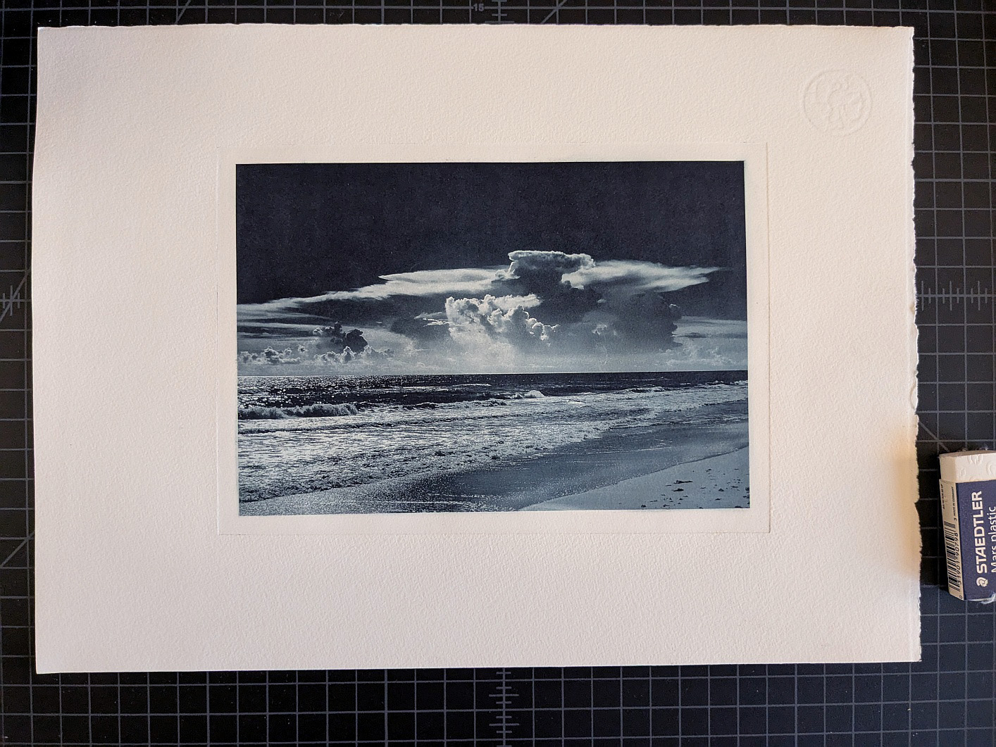

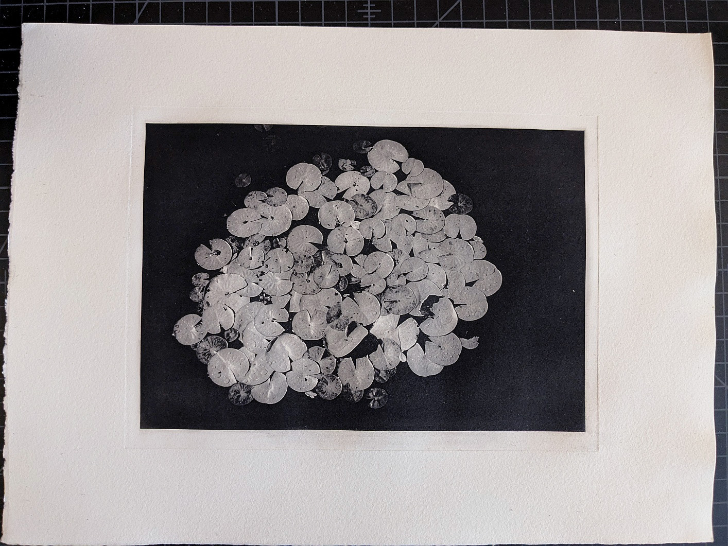

Printed some new photogravures over the weekend - using a new three part QTR profile Clay Harmon has developed with Richard Boutwell (B&W Mastery) it seems to work pretty well. I photographed these with my phone and downsized - seem to have some artifacts in the jpgs but overall I really like them.
As an aside to Andrew - I just had some fluid HP delivered today - going to make another pass at toned cyano's - I really liked yourresults, hopefully using this paper/process will help.
Dave
Dave

Very nice, do you have any more information about your process? I think I'd like to try photo/photopolymer gravure sometime but there seems to be 100 different ways to do the process and I know nothing about it...
I've been waiting for 2 weeks for more paper now, had to order it from the UK because it's out of stock everywhere in NZ (in the sizes I want at least).
Andrew - Photogravure seems to have undergone several advances in the last few years and I can understand why it appears there are so many processes. I took a course from Clay Harmon ( Asheville, NC) who runs a small studio and teaches the DTP ( Direct to Plate) method. Essentially it is using a photopolymer coated thin steel plate, and directly printing on it using an Epson printer. The photopolymer plate is a "positive" process and once it is printed with the right curve/RIP profile, it is then exposed to UV ( must be 365nm, the 380-400 nm doesn't work). It is developed in tap water with a soft brush to create the relief on the plate. Then it is back in the UV to harden the plate. Printing is done by inking the pate and "wiping" it with several stages of cloths and/or newspaper. The plate is then placed on the bed of a press ( usually used for intaglio or etchings) covered with dampened paper and the usual "blankets"
Here is a link to clay's pages about the process https://clayharmonblog.com/posts/dtp-quick-start. I believe it can be done with a ""positive" on inkjet film as well but requiring an messotint screen - I really don't know much about that, it was an earlier process before DTP. Intaglio presses are pretty big and expensive; however in the US there are a lot of printmaking studios around in larger cities - I belong to one for a monthly fee. The plates are relatively expensive they cost me abou $17 for an 8x10, I purchase mine from Clay at "mountain Intaglio"... Jon Cone ( inkjet mall) in Vermont also runs courses and sells materials - he has some good videos as well https://shop.inkjetmall.com/DTP-ZOOM.html#attr=. Hope that helps
Dave
Great work, Andrew, but I’m most impressed with the last—I haven’t seen a cyanotype “sort” a heavily vegetated scene like this…almost a split tone effect.
Cheers, yeah the split-tone comes from toning the cyanotype without bleaching, meaning the highlights tend to get more of the warm brown colour of the coffee stain while the shadows retain the cooler blue of the original print. Bleaching would make a more neutral tone but I like the split-tone effect for the most part.
