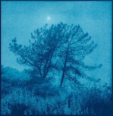

3,425

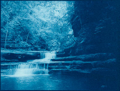

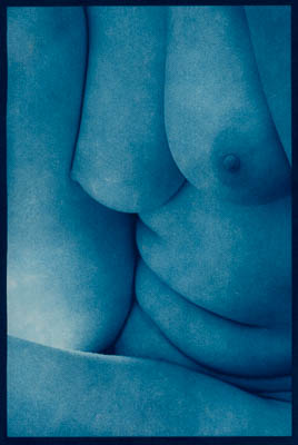

Cyanotype on Revere Platinum, 4m exposure. Nothing fancy on this one. My notes say 7/7/7/3 which means the mix was 7ml A/B, 7 drops 50% Citric Acid and 3 drops of dilute LFN. Standard Citric Acid first wash then tap water. I've only made a couple prints on Revere but it looks good. I've been printing a ton lately on Bergger COT which is nice, although I just saw that Bostick says not to use Tween with the paper. Next batch I'll try it without the LFN. The Bergger gets a bit velvety on me which I don't like but it does make good prints. Maybe the LFN has something to do with the velvet darks. The Revere by contrast is very smooth.

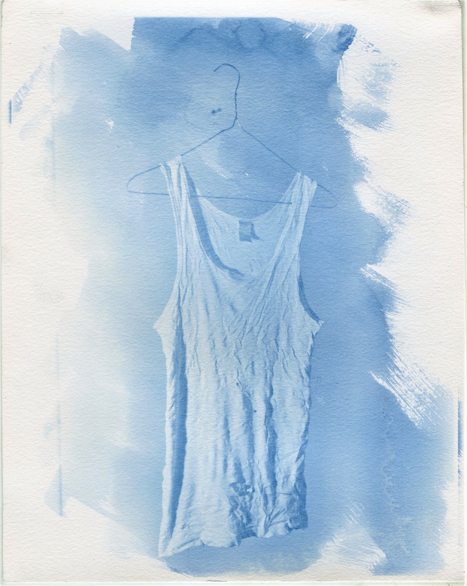

Really nice picture.

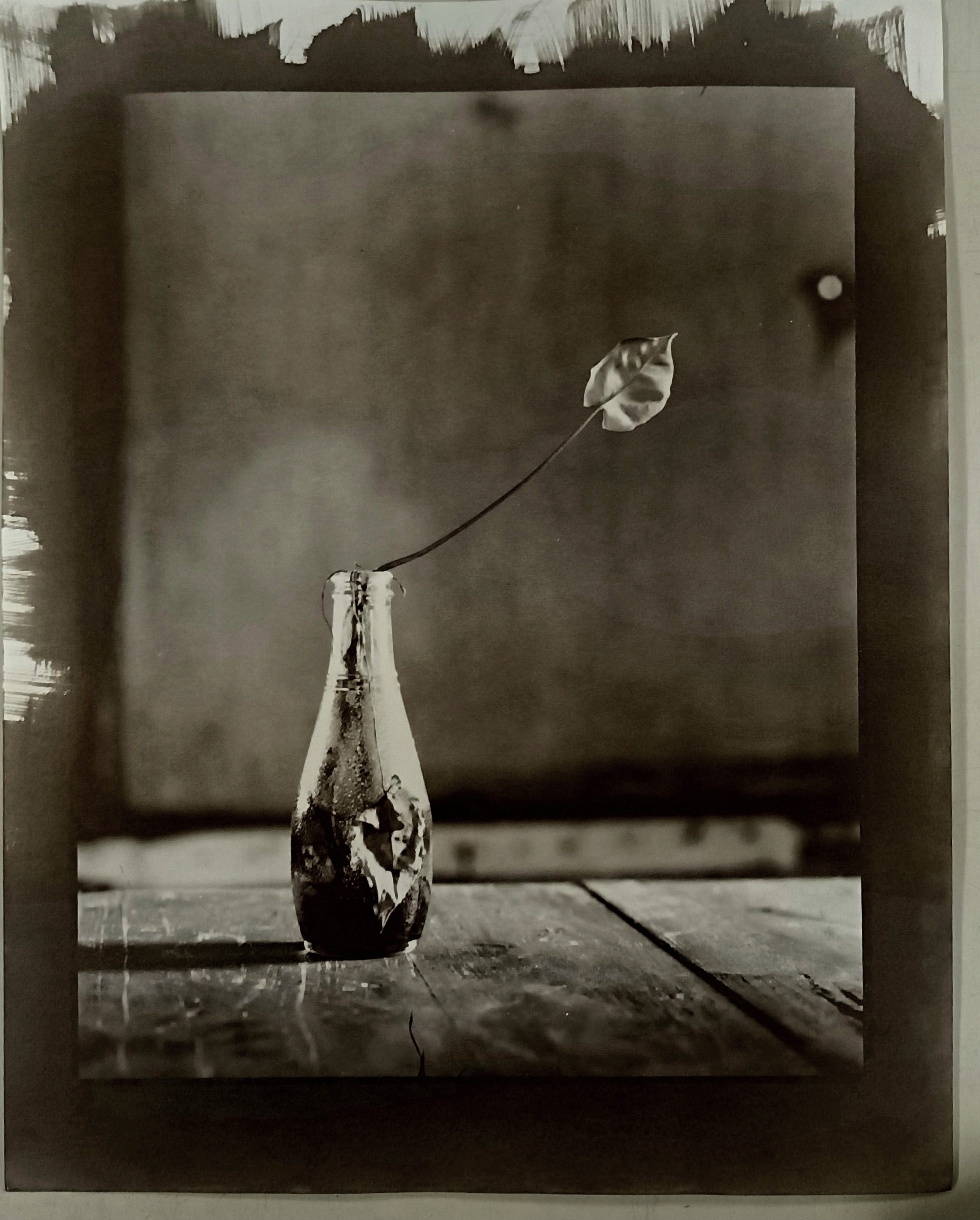

Vandyke brown print on Bergger cot 160.
24 x30 cm camera 1890, Fuji 420 lens
Xray film developed in home made pyrocat hd
Home made Vandyke brown emulsion hand painted, camera negative contact print exposed to sun for 2.5 minutes.
Washed in water with citric acid.
Fixed in sodium thiosulfate.
Cleared in sodium suffice.
OMFG beautiful

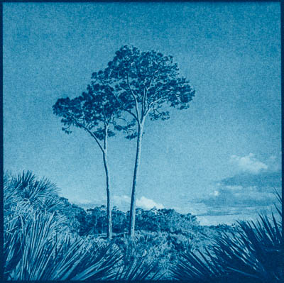

I finally figured out my density problem. Must be something with newer Photoshop and the Canon drivers, or I should just say Photoshop. Negatives printed from Print Tool showed a remarkable increase in density compared to the ones I printed through Photoshop. I'm pretty disgusted with Adobe right now....
Anyway, new negs. Easy prints. Finally getting about what I want. These are printed on Bergger Cot 160. I omitted the LFN but I'm still getting the velour type finish in the dark tones and the lighter tones aren't as smooth as I'd like. I might omit the Citric Acid next time. A couple years ago I did notice the same velour like surface after I acidified one paper leading me to believe too much acid might be causing the issue. Mixed it 5/5/5. 5ml A&B, 5 drops of 50% Citric Acid. Exposures are 4/5m with the new negs.

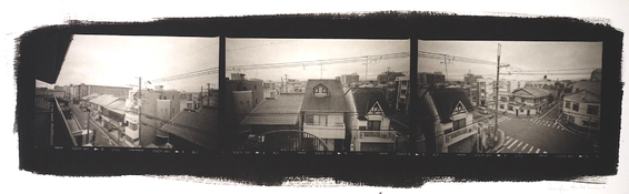

From my son's apt on a rainy morning in Kyoto several years ago. Three 6x10cm negatives (Veriwide).
Platinum/palladium
Platinum/palladium
Vaughn, spectacular. I love to see places like Kyoto that are well-known, yet obscure in many respects. I have a Veriwide -- I am divided about it because the vignetting toward the corners is significant. You used that aspect of the camera to advantage here. Thanks for sharing.
Vaughn
Dec 13, 2006
10,293
Humboldt Co.
Thank you, Sanders. Right before I left, a friend offered the Veriwide to me to use on the Kyoto trip. Not necessarily the best decision to take an unusual camera/format on such a trip, but the other camera I took (a Ciroflex) with me was not a great choice either, so I ended up using the Veriwide more than anticipated...fun camera.

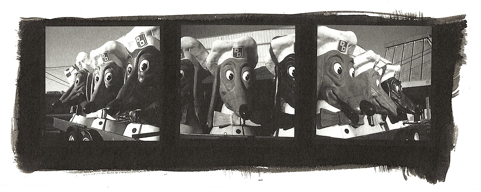

An older pt/pd print using the Rollei: Doggies, Treasure Island

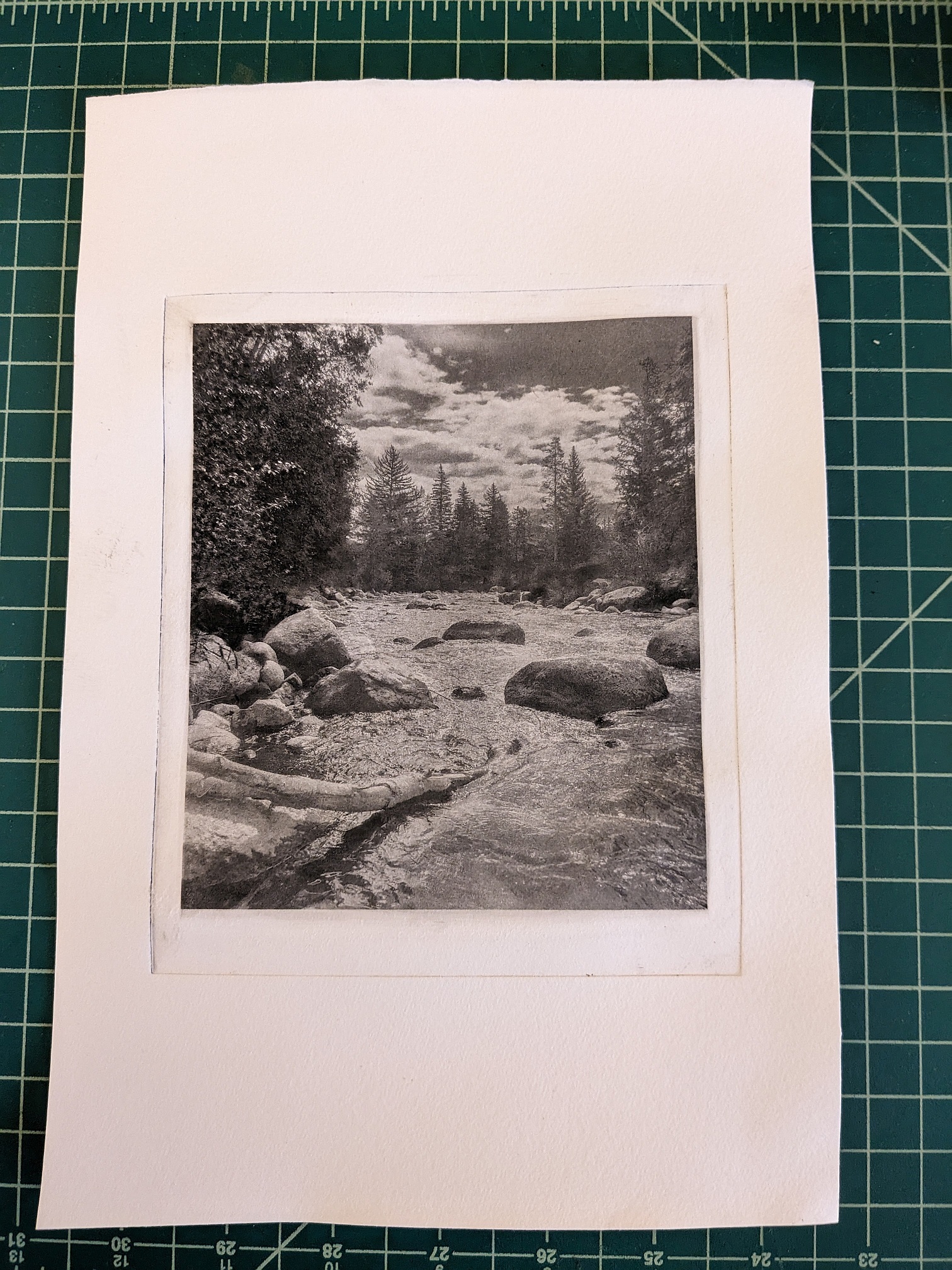

Another photogravure intaglio, the image is about 5 X 7, on Hahnemühle Dürer Copperplate, 250 gms - spent some time working on my QTR curve for this process, not quite there but getting close, and learning how to operate an intaglio press. Thanks to Clay Harmon for being such a great instructor on this process. - Gore Creek outside Vail Colorado. Need to work on cleaning up the margins.

Excellent, I think photogravure is probably the most elegant print medium out there—though it probably requires more infrastructure than I can handle right now. Along those lines, though, what kind of press are you using?

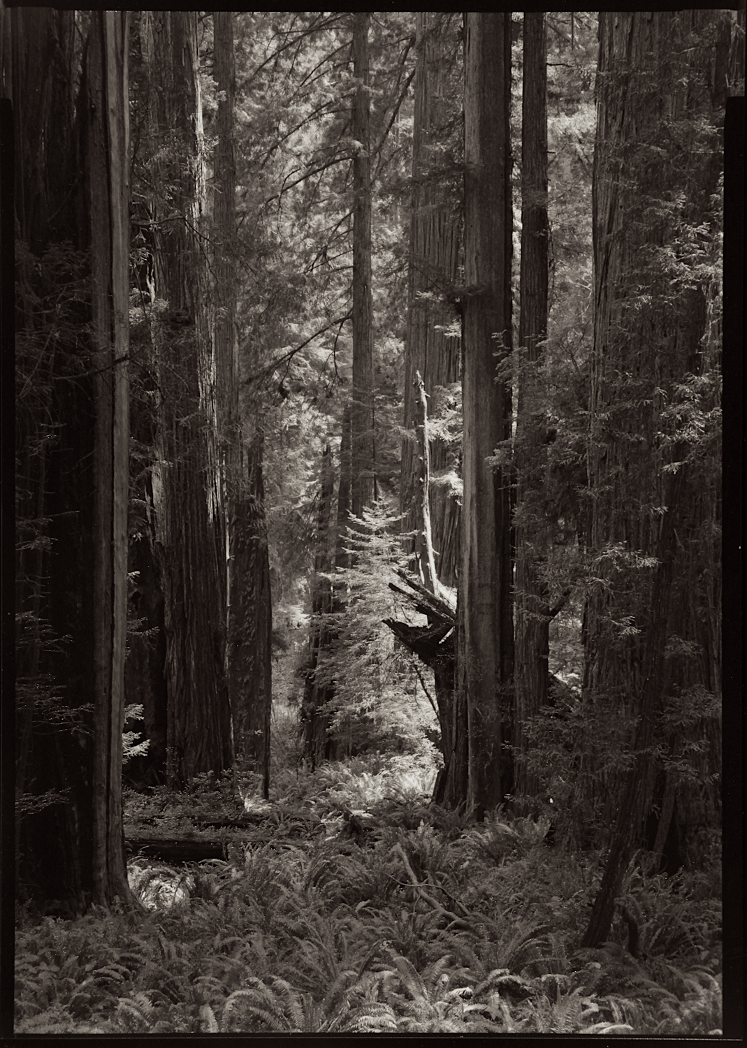

Bringing out an older print.
Redwood Cathedral
Prairie Creek Redwoods State Park
5x7 Carbon Print from camera negative

It is a great way to print - I am still learning a lot about the press and how to ink/process. I have joined a local printmakers studio, they have several presses - I use the Rembrandt Pelican etching press (24″ x 48″ bed size). They also have a UV burner that uses BL tubes, kind of slow compared to the UV LED burners that others are using for the plates... but it seems to work. I have to admit I don't quite get the deep blacks that I am able to print with Kallitype, but as I said I am still learning some of the subtleties of the technology.
Redwood Cathedral
VAughan,
Really excellent print - the blacks are great, it really makes the image. I have been experimenting with a lot of alt photo techniques and I would love to try carbon printing, however all of the steps are very daunting, maybe next year.

Vaughn
Dec 13, 2006
10,293
Humboldt Co.
VAughan,
Dave
Thank you. I am not 100% sure carbon print belongs in a "HCWP" thread. The carbon tissue is hand-coated, in my case, by pouring warm Jell-O (food grade gelatin, sugar and pigment) over a plastic substrate /support.
There are a few steps to carbon printing, but fairly easy ones and not as complicated as many alt processes can be.
But in one sense, carbon printing can produce what I like to call silver prints on steroids.
The carbon print above is straight from the camera negative...no burning/dodging, but using the contrast controls of pigment and sensitizer strength.

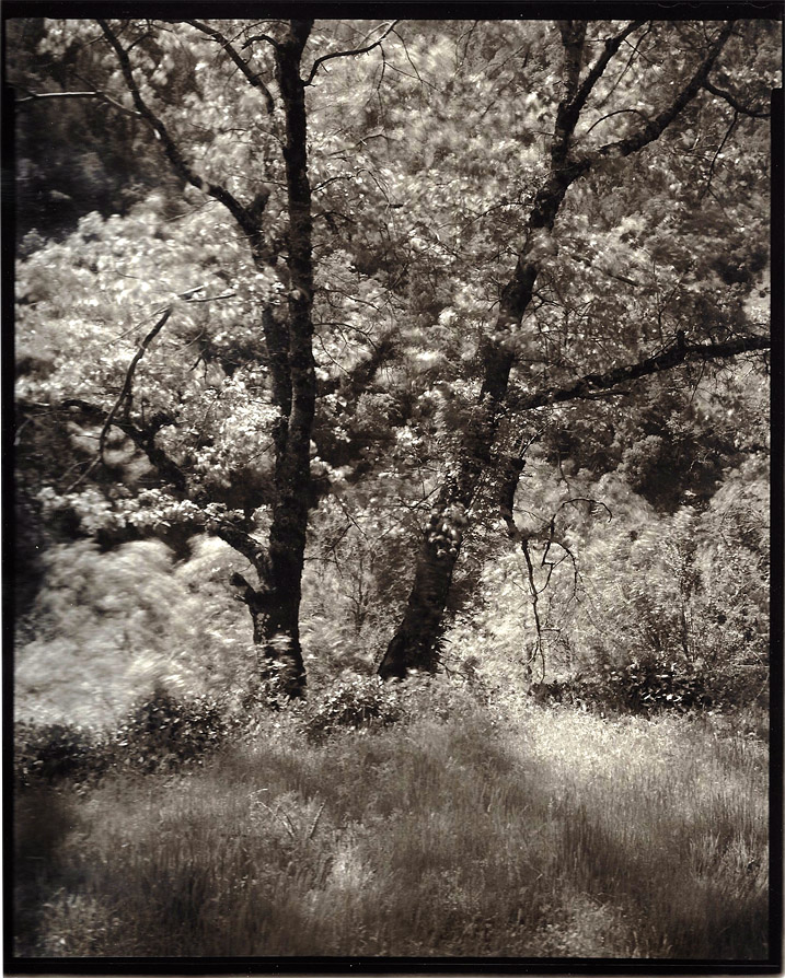

A more recent carbon print.
Along Highway 299, Wind
Trinity County, CA
8x10 Carbon Print
Lens was a Fuji W 300/5.6 (but maybe a 250/6.7 -- can't find the notes)

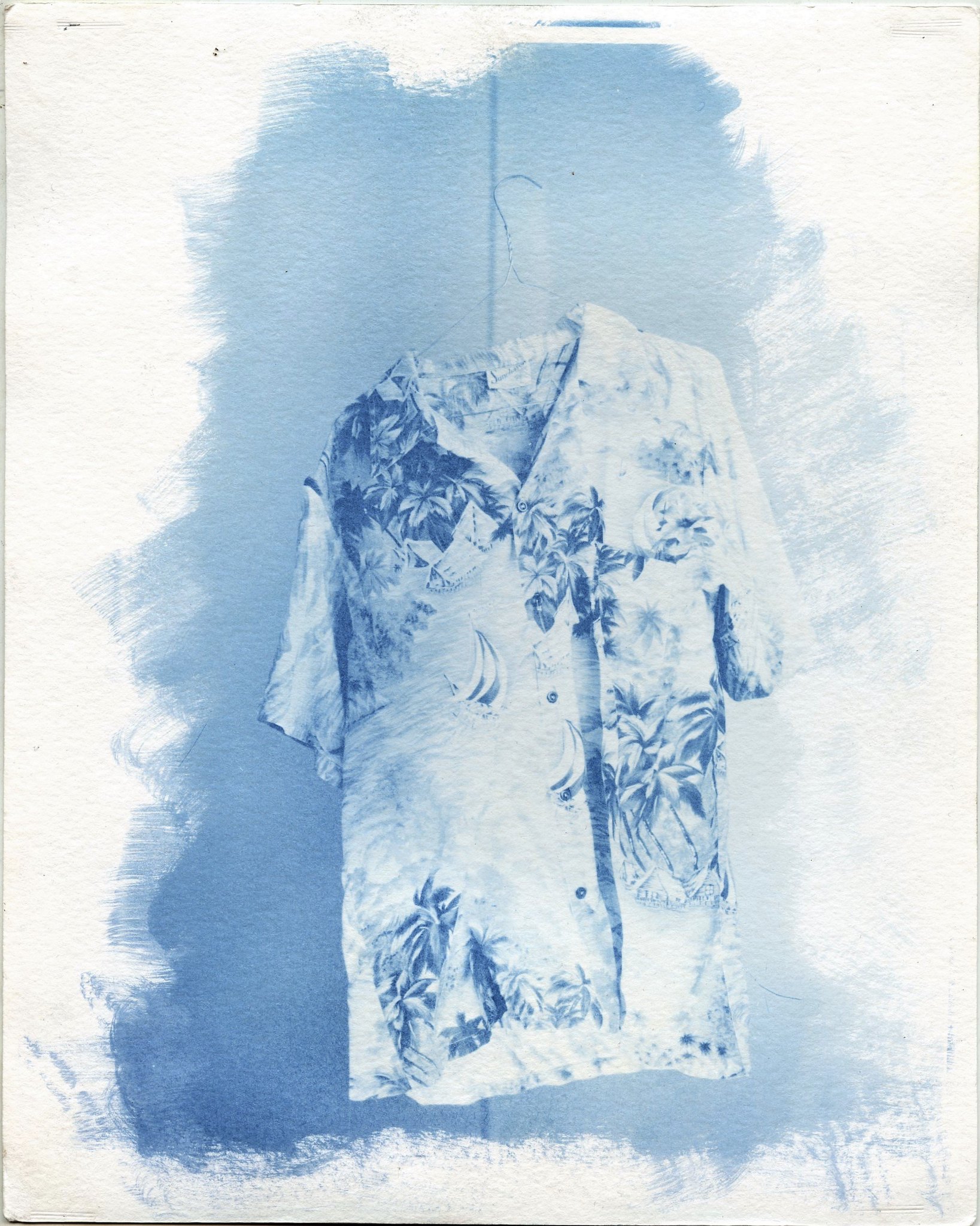

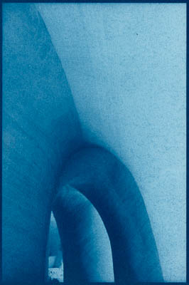

Cyanotype on Kozo. This was from a digital image. I thought I'd give it a go just to see what it would look like in the event that film ever took a dirt nap. Standard cyanotype chemistry with Citric Acid added plus LFN, then a first bath in Citric Acid. I really like the Kozo for certain images. Works great for nudes. Not so much for landscapes.
I finally ordered some Salt chems from Bostick so I am looking forward to doing some of those.
