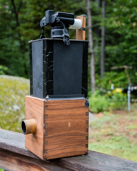

Ned,
Thanks!
My camera obscura actually has a simple biconvex lens rather than a pinhole. The lens is mounted in a brass tube which can be slid in and out of a hole in the wooden body to adjust the focus.
I also 'cheat' by putting a fresnel lens under the ground glass. This evens out the illumination on the ground glass considerably.
Here is a photo of my contraption...
