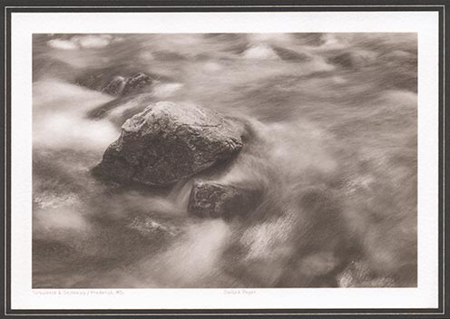

8 x10 F250 pinhole camera 35 minute exposure. Aristra edu 100, compensated for reciprocity. Developed in Pyrocat HD 2+2+100 for 10 mins in drum roller. Dense negative.
Handmade Vandyke Brown sensitiser on Hahnemuhle 300 Platinum Rag. contact print, 45 minutes under UV lamp, 5 bath wash, 4 minutes in gold toner, fixer, hypo, wash, dry.
