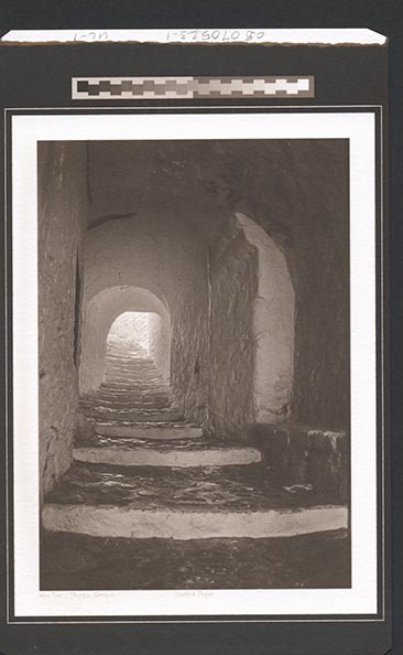

Nicely done, Niranjan. That stairway in Greece looks to have wonderful light to play with!

This kallitype eclipses my earlier attempts to print this negative. It is a challenging negative to print. I'm glad I went back to it.
Thanks, Vaughn. I think I could have made the end of the stairway a little bit brighter to increase the impact. But I didn't want to lose the details and blow it out. So I didn't push it.
:Niranjan.
:Niranjan.
The top of the image might be a little heavy, but the composition still carries the weight to get our eyes up there.

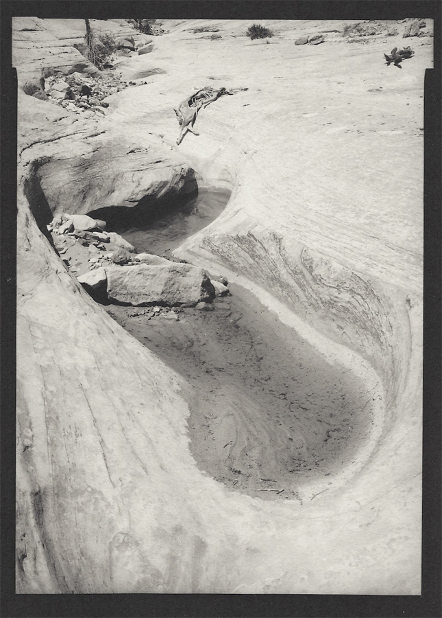

Here is something a little different --
Dead Big Horn Sheep, April 2019
Zion National Park
5x7 negative
Platinum/palladium Print

It took me a while to find the sheep...good way to make the viewer explore the whole picture.
I guess this is the kind of an image that Pt/Pd excels in, with the majority of the tones in the upper zones. I wonder if something like carbon can reproduce a high-key image like this as well. Salt can probably do it.

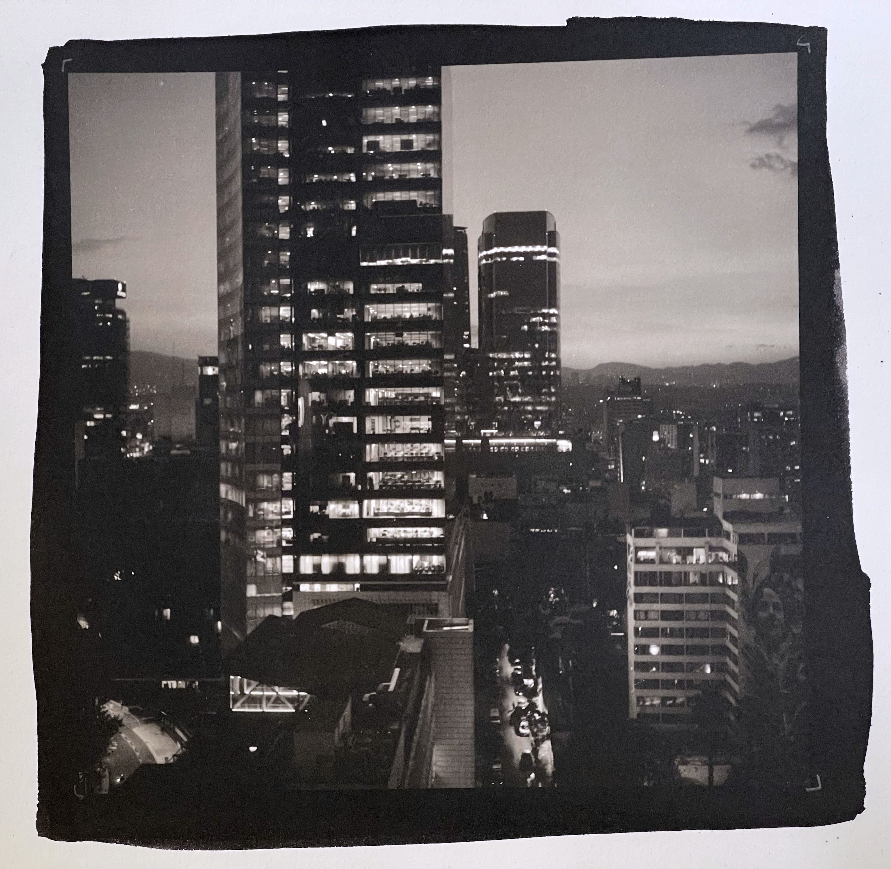

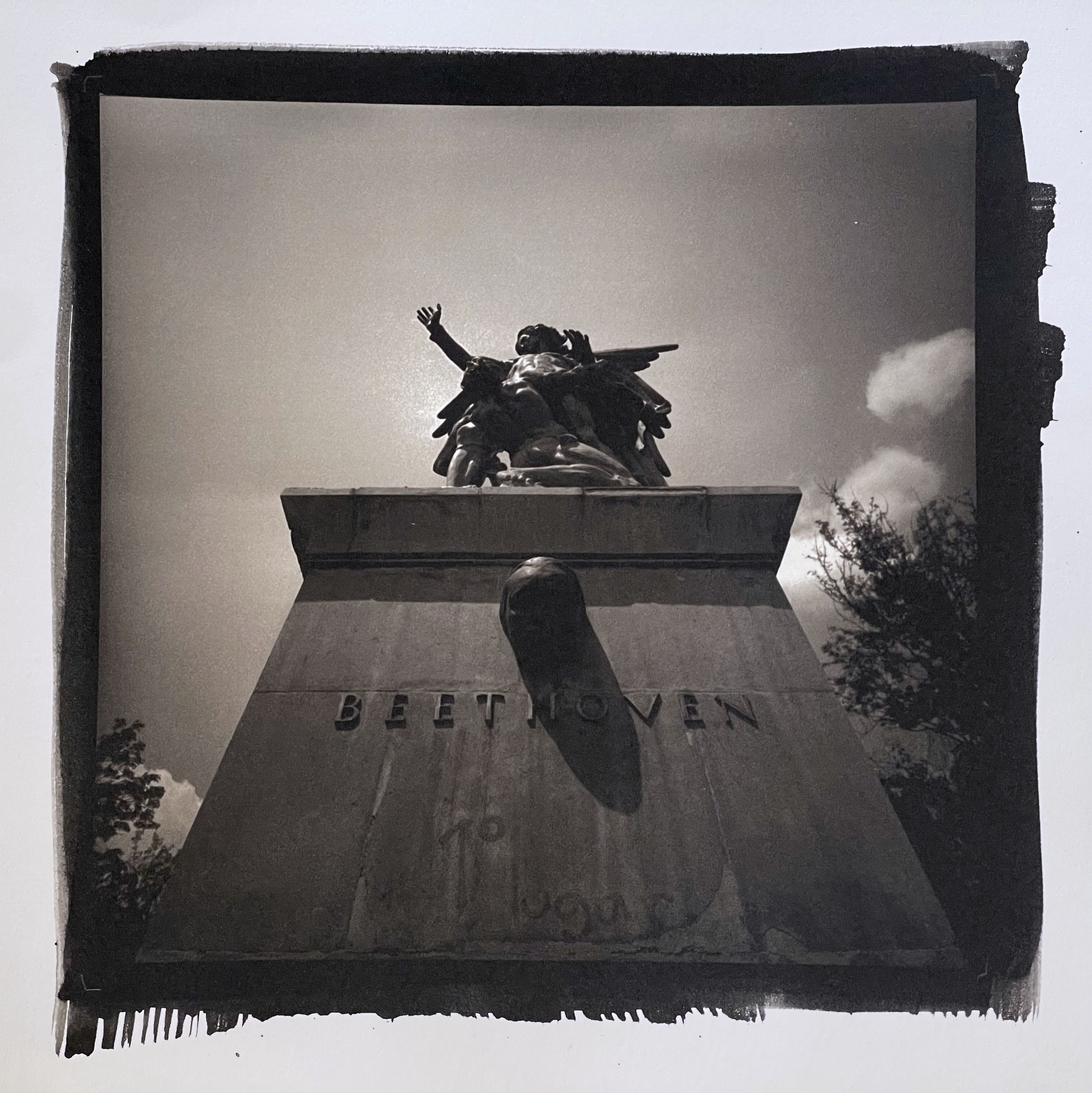

A trio of platinum/palladium prints. All three are a pt/pd blend - approximately 60:40 Platinum/ palladium. All three on Bergger COT320.
Intriguing images, Scott. The second on seems to have a reflection of the first one. What camera - Holga or something funky like that?
:Niranjan.

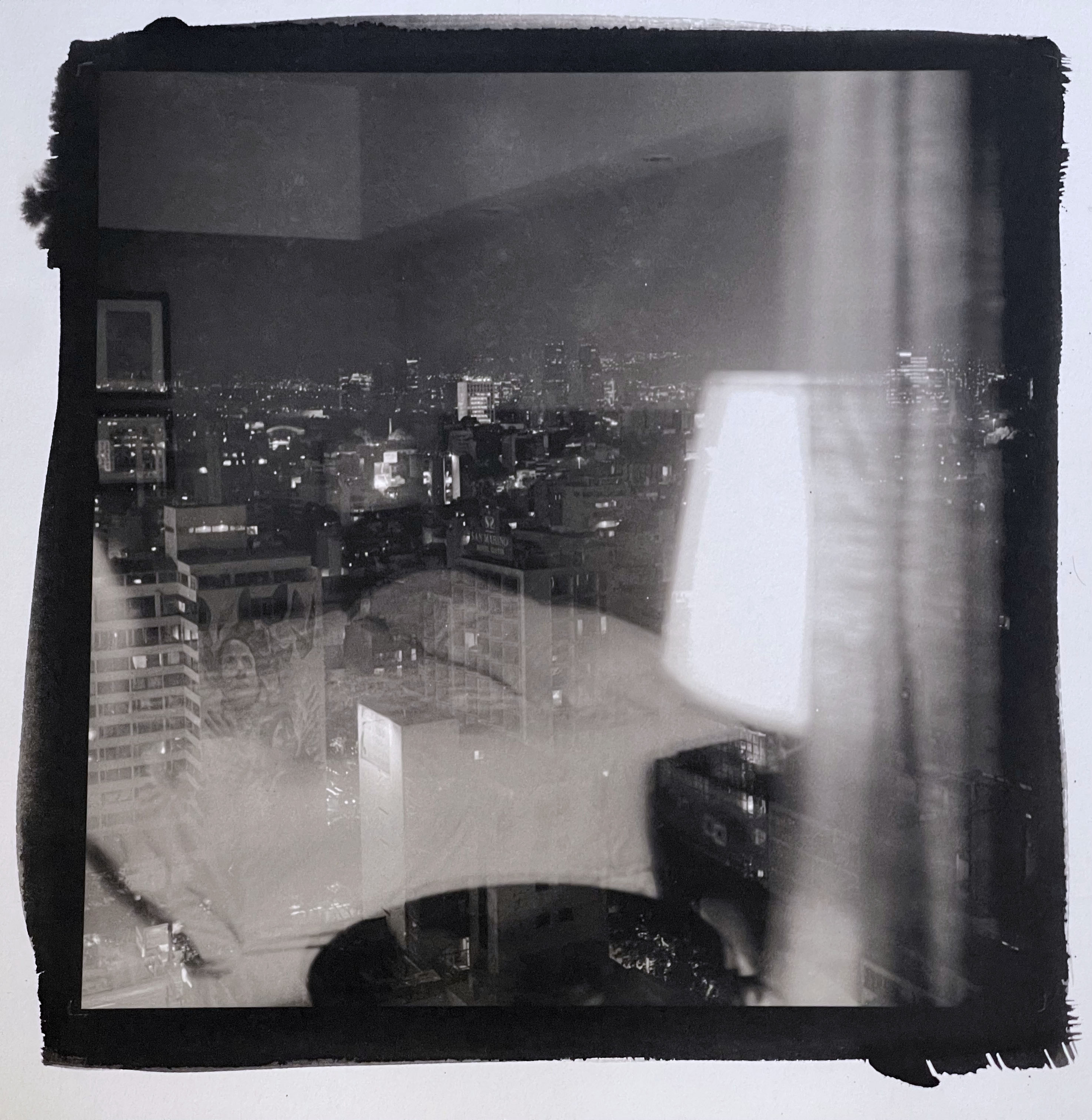

:Niranjan.
The second one is more or less the same view as the first, but it includes the reflections in the plate glass window of the interior of my hotel room. They were both shot with my Kodak Chevron, a 6x6cm on 120/620 film camera (it takes 620 or if you use 620 takeup spools, you can load 120 in the feeding chamber if you trim the reels down a little with nail clippers). The hotel is the Sheraton Maria Isabel in Mexico City. I was in a room on the 21st floor of the new tower of the hotel, with a view to the west/south of the city.

I see...that the reflection of the room as you are shooting through the glass. I thought it was the other way around...visual dyslexia...🙂
Oh, the image is deliberately hard to read - I want people to think about what they're seeing. Challenge perceptions and all that.

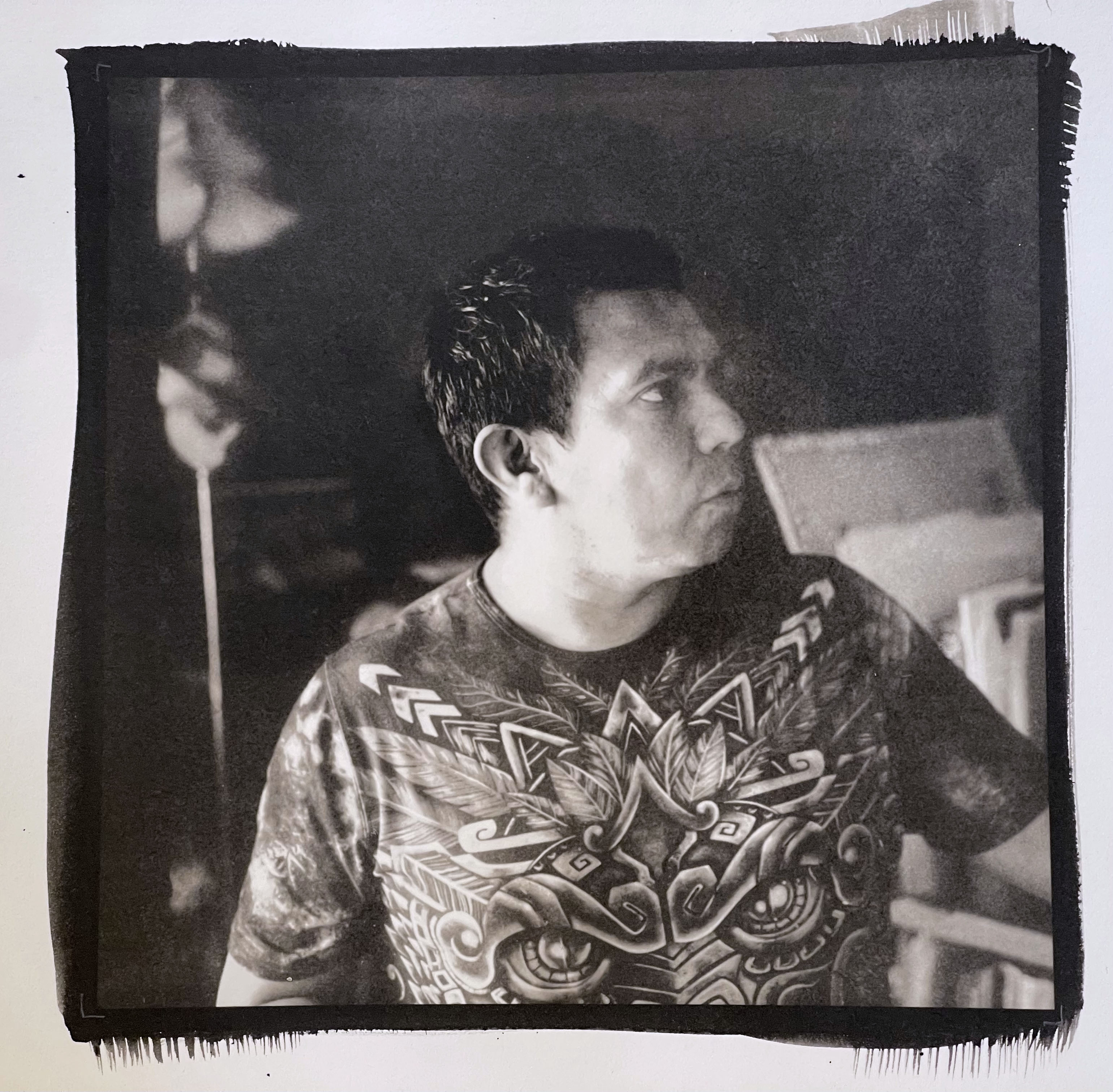

two more, portraits this time. The first one is Arturo Talavera, the Mexican photographer, in his studio. The second one is Gabriel Barajas, my collaborator on the Foto Inter/Cambio conference. Both were shot with my Kodak Chevron when I was down in Mexico City in March of this year. IIRC both were shot on Tri-X, although the one of Gabriel might have been FP4+. Again, 60:40 Platinum / Palladium mix. The print of Arturo is on COT320, the print of Gabriel is on Revere Platinum.

Scott, I print tons of Revere but have never used COT320. How do the two compare, in your experience?
In terms of overall color and contrast, they're quite similar, as is the amount of chemistry required to coat. The Revere is slightly warmer - the COT320 is bright white. I feel like the Revere is also slightly heavier and stiffer than the COT320.

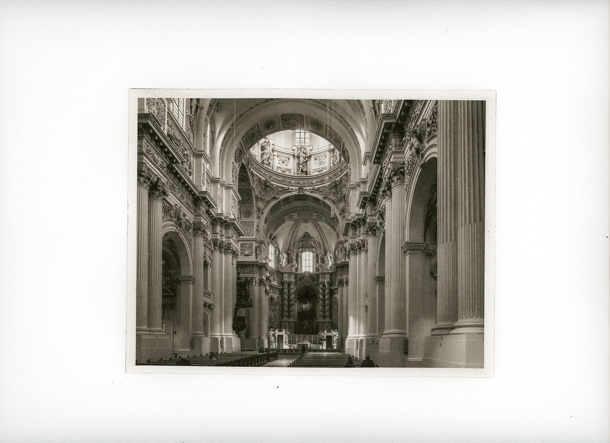

Not sure if this belongs here - technically not a hand coated wet print - but a photopolymer intaglio print from Clay Harmon's workshop .... printed on Hahnemühle etching paper with a mix of black/sienna ink. The interior of a cathedral in Munich ( I can't remember which one). Image captured on a Fuji X-T1, 18-55mm@18/F2.8 - ISO 3200 1/25. Printed on Jet photopolymer plate, UV exposed and developed, hand inked and intaglio printed. Image is about 5X7, scanned on Epson V600. I really like this process; however it requires a rather expensive intaglio press.... even more expensive that the alt photo chemicals/equipment!
